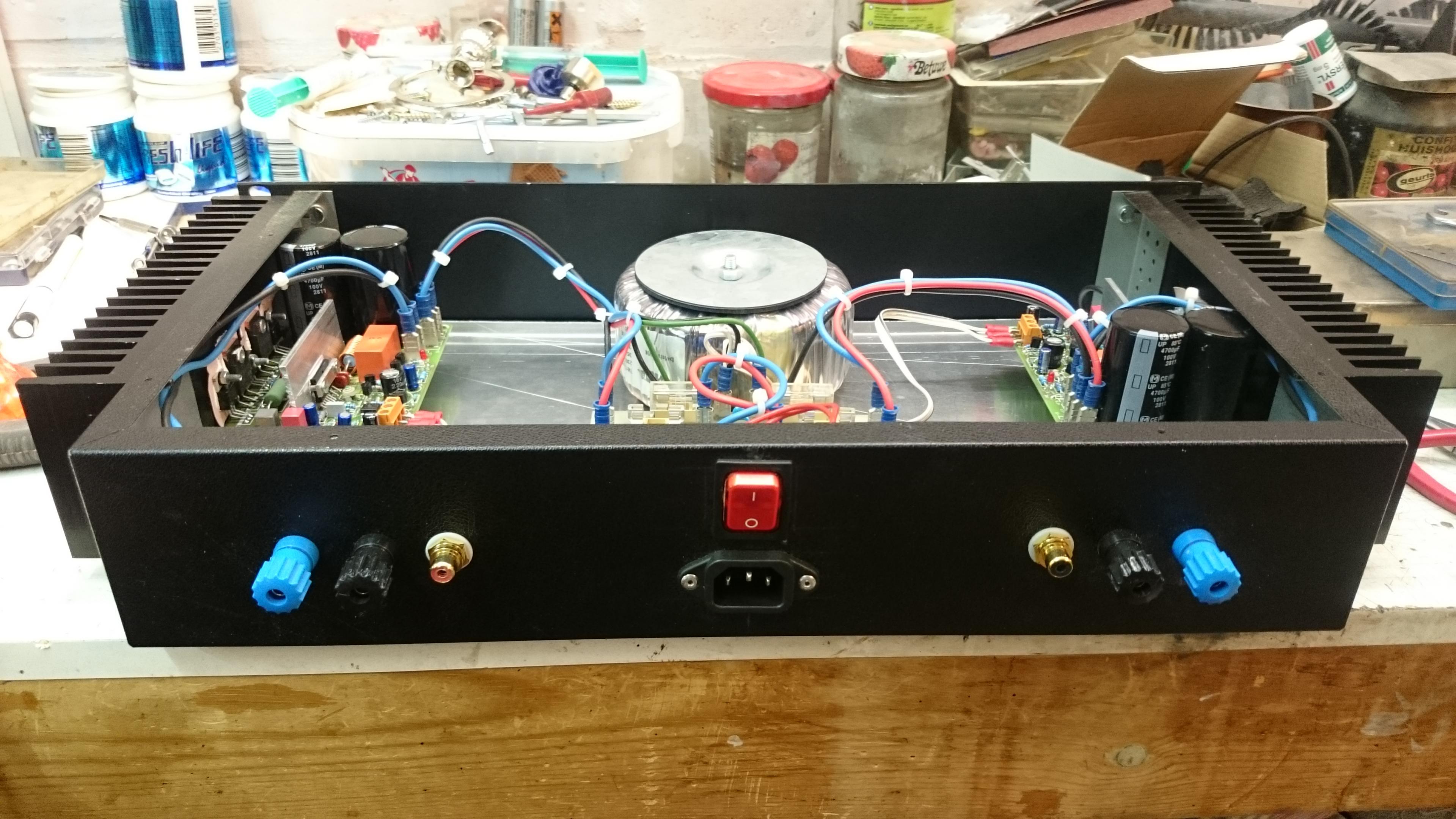

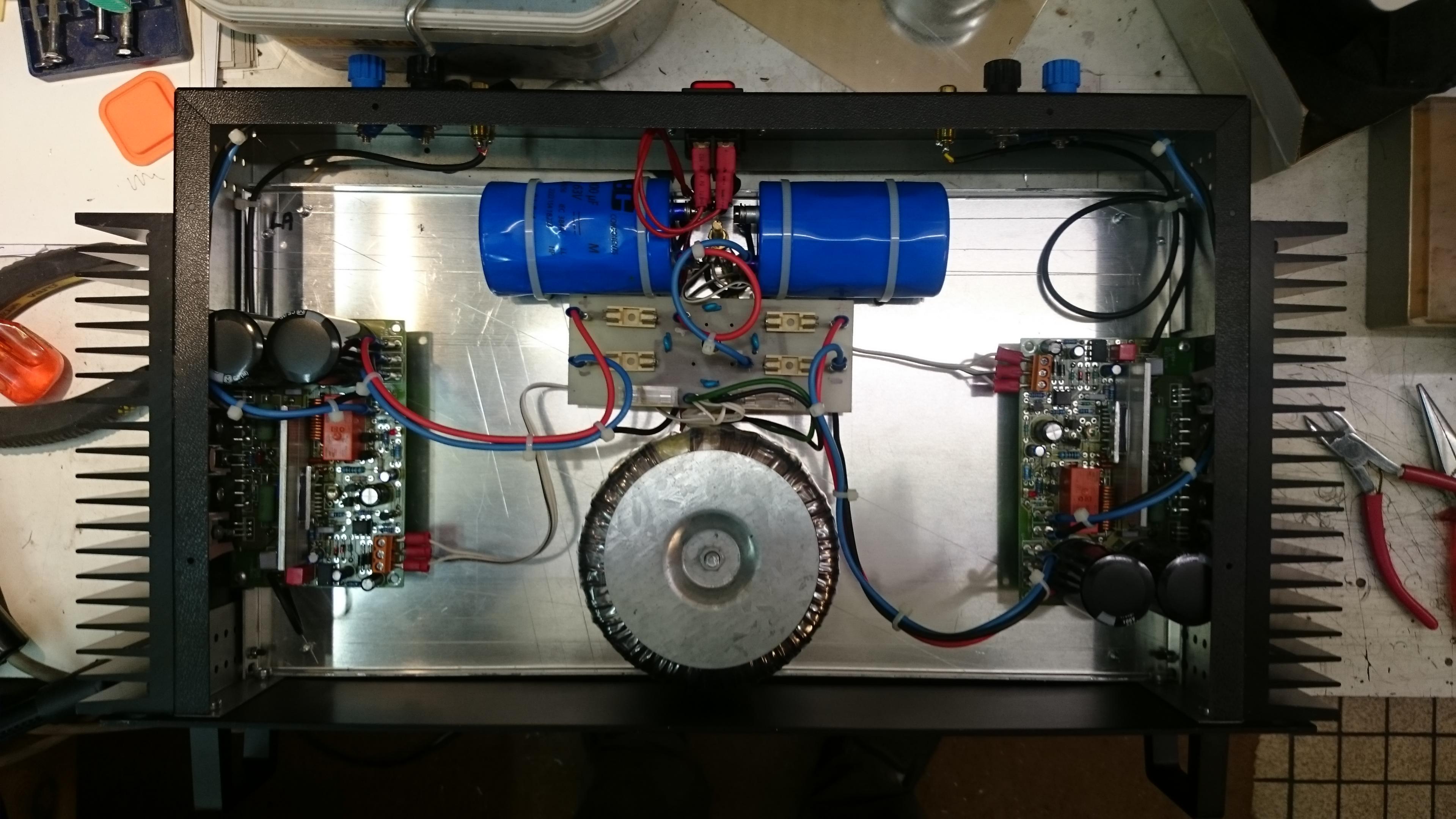

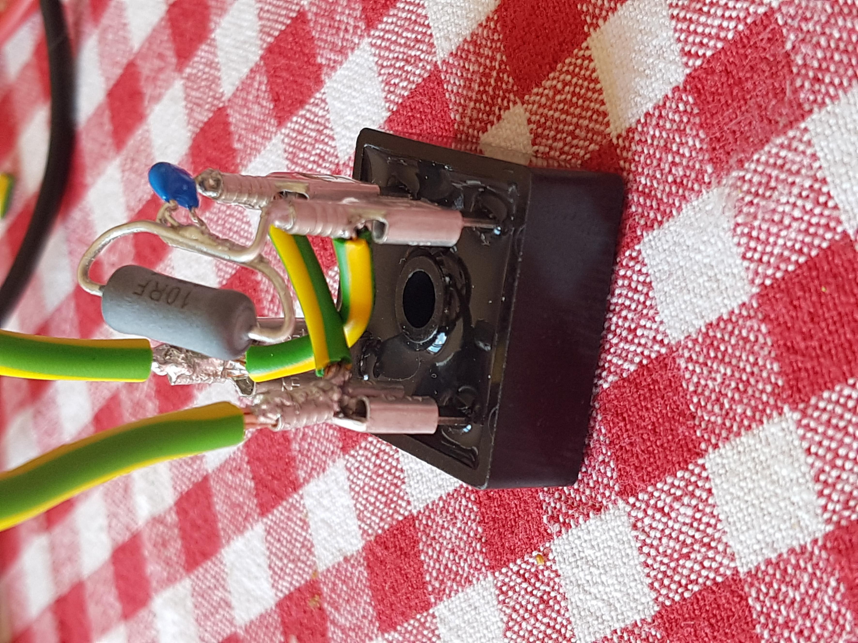

After more than 2 years of daily use, I took the Q-Watt out of service to tackle the bass 'buzz issue'.
I was inspired by Rod Elliott's 10-Ohm ground loop breaker, and I suppose I always intended to include one but never got around to it. I made up one loop breaker using the structure of a 35A bridge rectifier, and placed it between the common power supply ground and the mains earth connection.
I should say straightaway: that did not work. Buzz remained at a very low level, unchanged. This confirmed my suspicion that the earth loop was local to the amp-preamp pair, circuit being formed by the common ground in left and right channels.
So, I made another identical ground loop breaker. This time I placed them between each PS ground and the common star ground such that there is now 20 Ohms isolation between left and right 'ground', and 10 Ohms between each channel and mains safety earth.
In case of a fault drawing high current, the parallel 35A diodes breakdown and allow sufficient current to trip the 2.5A mains fuse.
And... it works!! Now there is absolutely nothing to be heard from the bass driver when source is paused or off.
I listened for a month now, and I think it sounds better now that the empty periods are truly silent, but I'll be honest it's a highly unscientific test.
Anybody struggling with ground loop on a Q-Watt, just remember: 1) use independent power supplies for left and right channel and 2) consider a Rod Elliott 10R loop breaker in the earth connection to each channel.

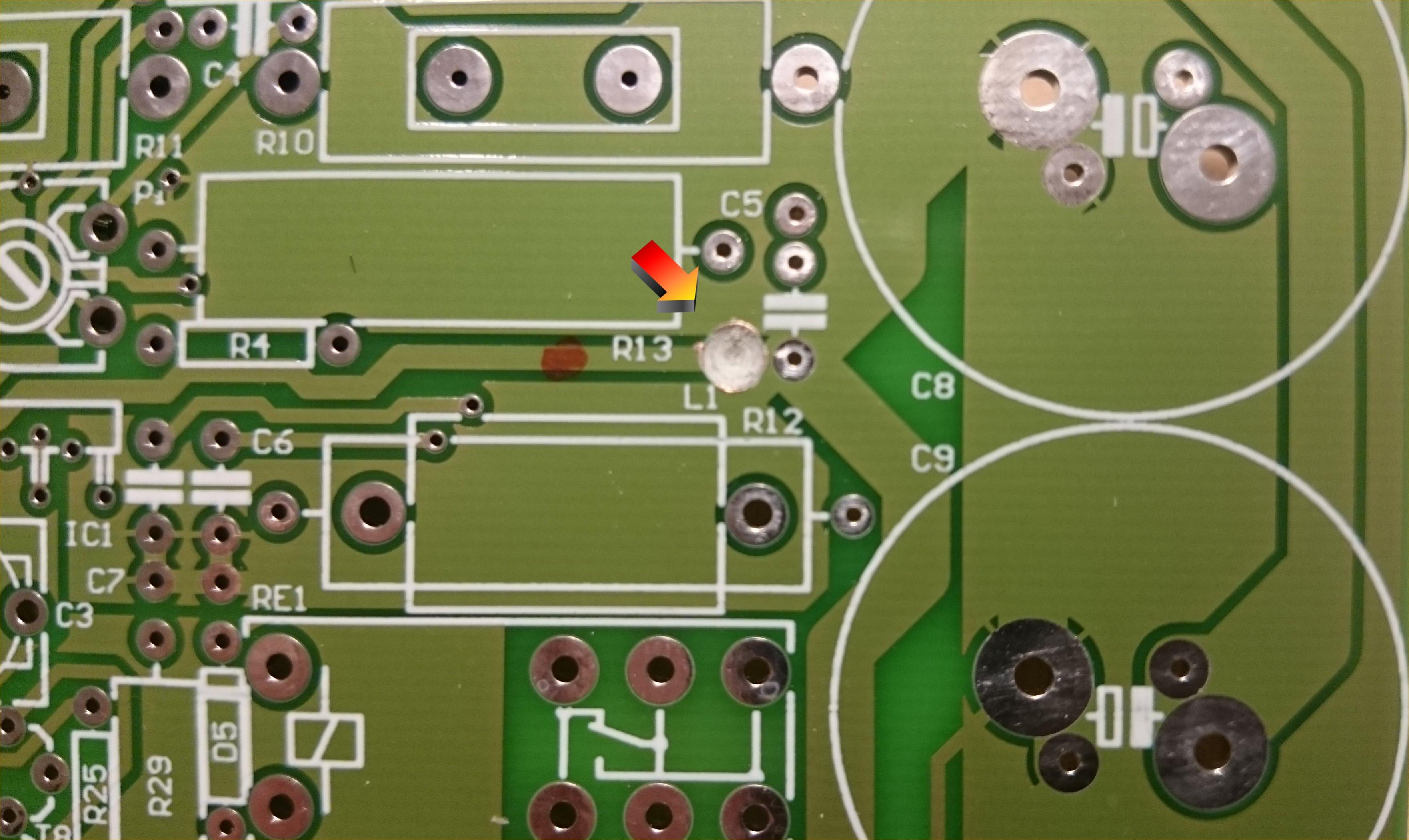

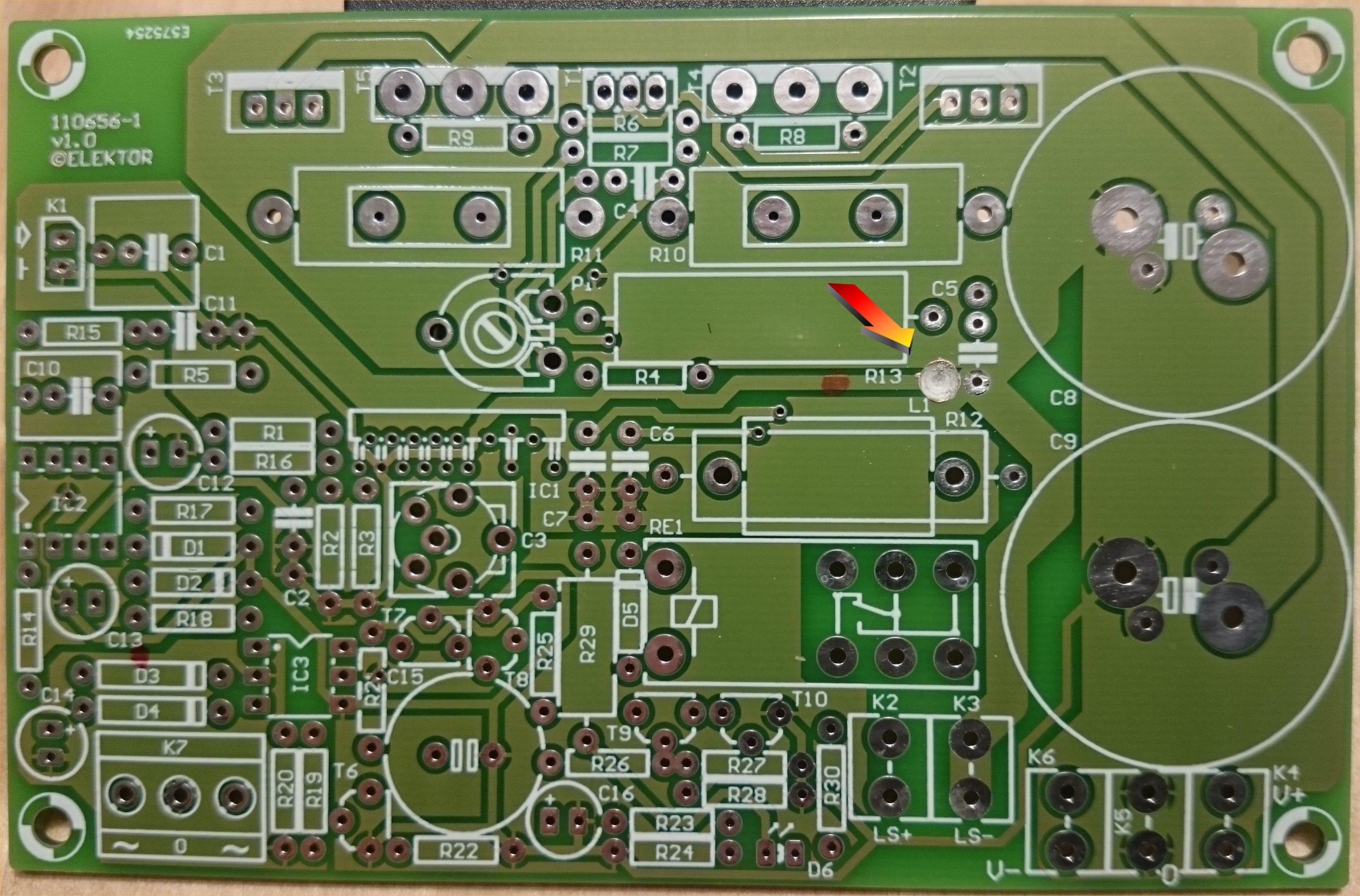

I have also build a stereo power amplifier with two Q-Watt modules and also have this terrible hum problem due to the ground loop that is very difficult to avoid with this design where the power ground and signal ground are both interconnected on the PCB. I think the PCB should isolate both grounds by inserting a low value resistor (like 10 Ohms or so) on the PCB's between both grounds and connecting both the low level input ground at the RCA inputs and the power output ground with heavy duty stranded cable directly to the star point between both large electrolytic buffer capacitors. This resistor is only needed in case one of the two ground connections to the star point is accidentally broken. This resistor assures that the large PSU and loudspeaker currents flow to ground via the direct galvanic connection and hence stay away from the sensitive input circuitry.
I think Elektor should address this problem, as almost all stereo amplifiers have a single supply and hence have solved this hum problem.
I have solved the hum problem of this amplifier in stereo configuration with one power supply by cutting the earth connection on the PCB next to capacitor C5, between resistors R12 and R13, and grounded the input circuit via a 6 mm2 solid copper wire to the earth connection of the input connectors. The hum in the speakers is now unaffected by the input ground loop.

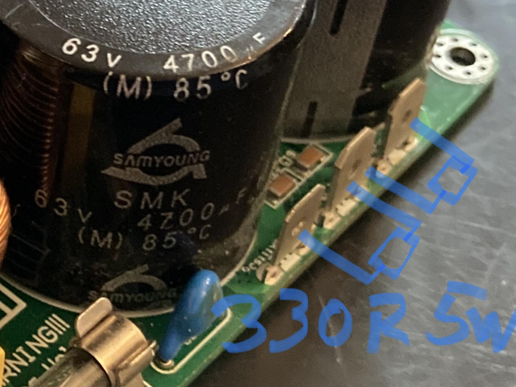

delange and calpe, can you give a little more detail on loading the SMPS500R main outputs for testing the aux outputs?
Just to mention that anyone using a SMPS (switched mode power supply) need to apply a load so that they supply the current stated for the SMPS.
I used two 330R 5W's on the 55v o/p's to ensure that more than 110mA was drawn.
One resistor connected to each + and - main outputs? Then both to GND output?
