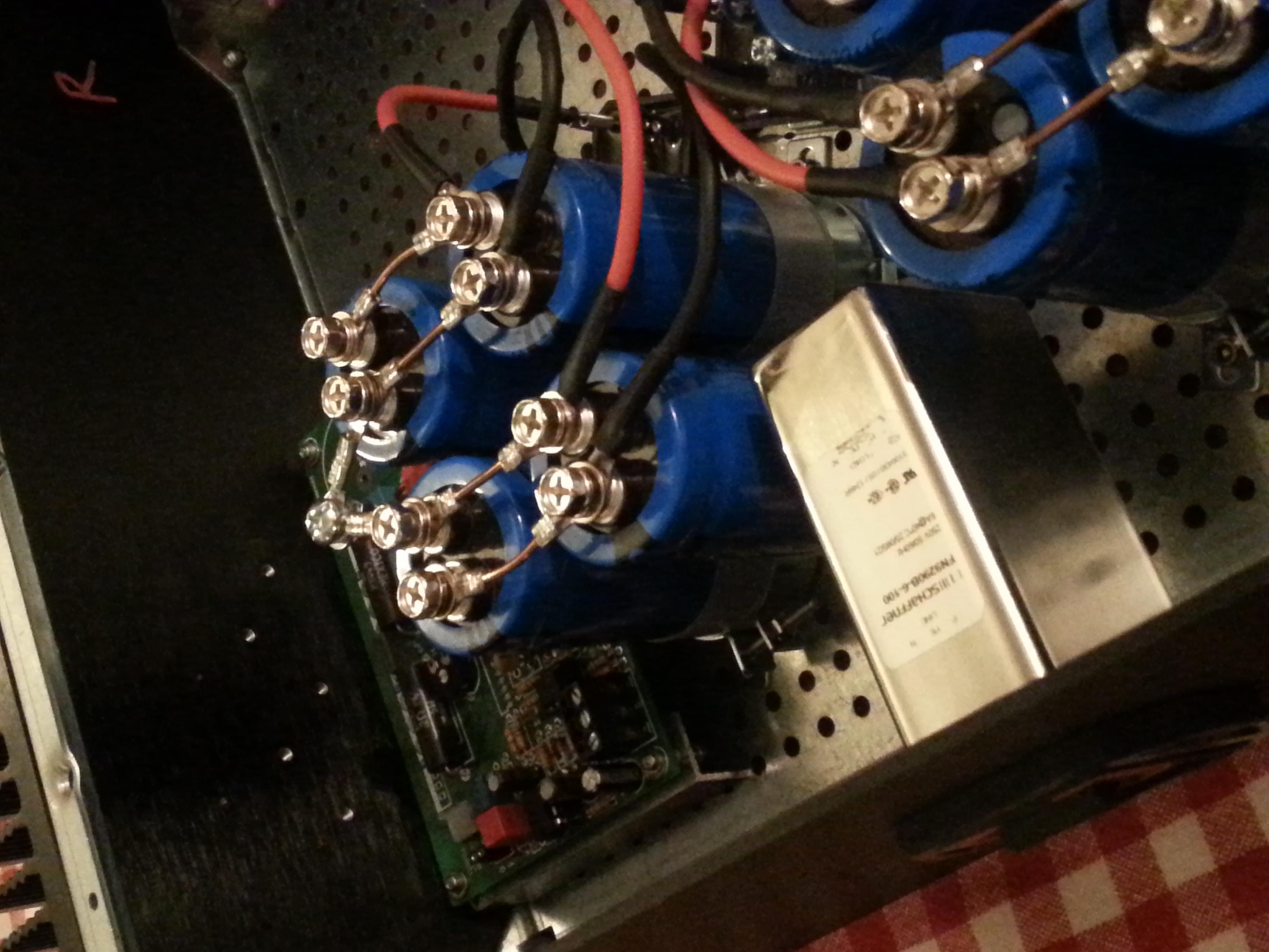

Might twist the wiring between the rectifiers and the 1st filter cap. What do you think?
Pops.
...........Might twist the wiring between the rectifiers and the 1st filter cap. What do you think? ................
definitely twist your wiring.
Every LOOP acts as an aerial, transmittting and receiving interference.
See the two parallel copper wires running between your capacitors. They are forming loop with big areas. They are emitting emi every time the current changes.

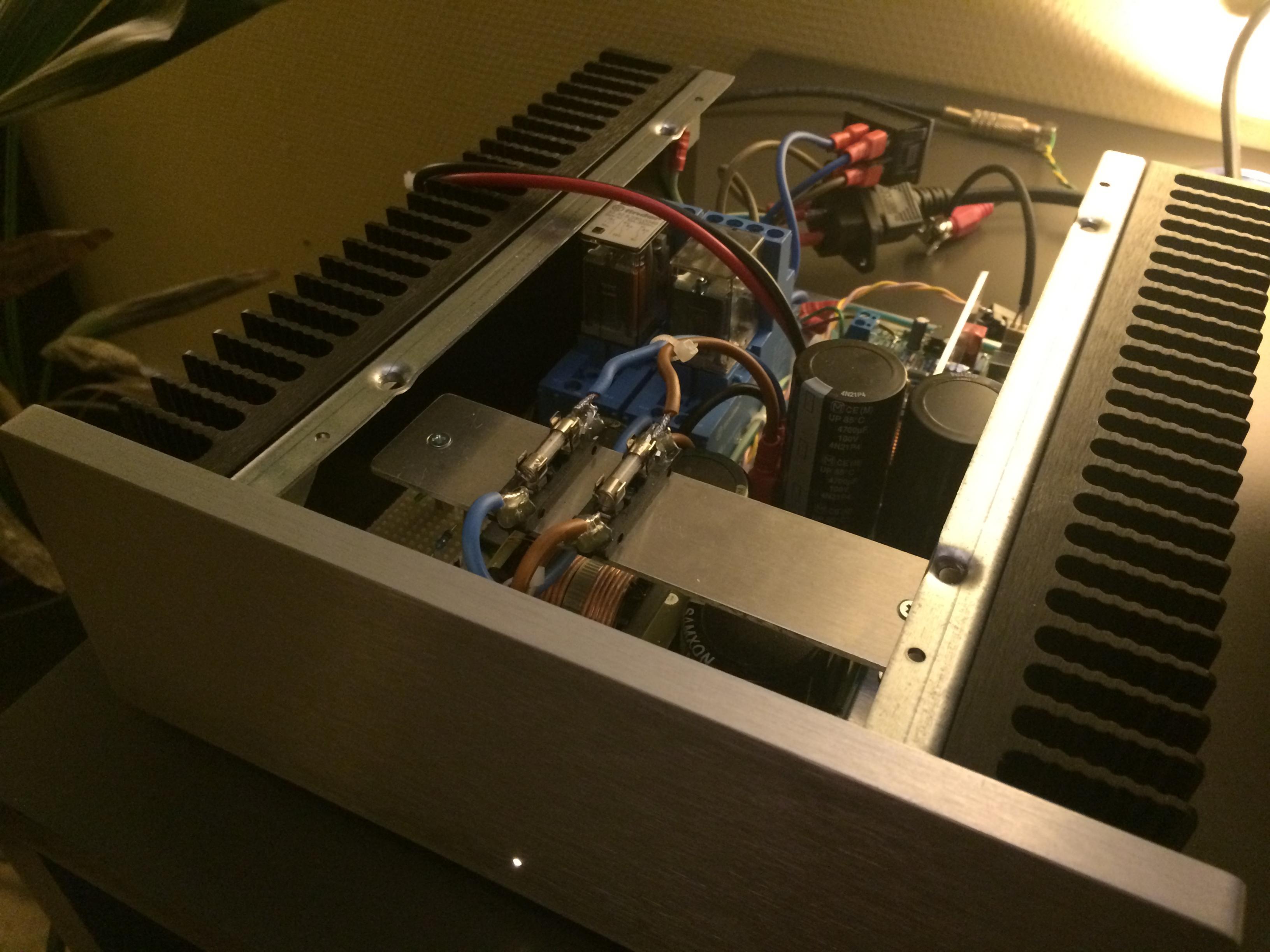

Yes those rubber feed are cheap but I personally don't mind them. They do a good job keeping the enclosure steady on a surface. The feed are also quite invisible underneath the enclosure and I like that.
The base of my headsinks are 8 mm. I drilled some (threaded) holes in there because they now hold my base plate. I don't use those metallic strips at the bottom because they take up to much useful space.
My amp has been running the whole day yesterday and the heatsinks don't get hot; they do seem to work very well in terms of heat dissipation. I'm using a 2 unit high (8 cm) enclosure and they are fine for the Q-Watt.
I don't like the way they mount the front and back panels though. I didn't change the front panel but I will mount the back panel in the heatsinks as well. I've make my back panel plates are a bit lager to make that possible.
As you will see when I put up some pictures, the front panel is very difficult to mount when there is not a lot of free space inside the enclosure...
Other than that, I'm very pleased with the mini disipante. It is a very nice looking enclosure. I attached one crappy foto as a teaser 🙂

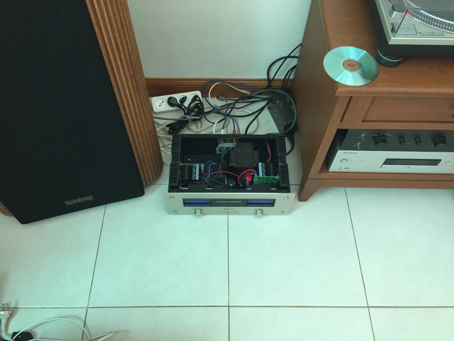

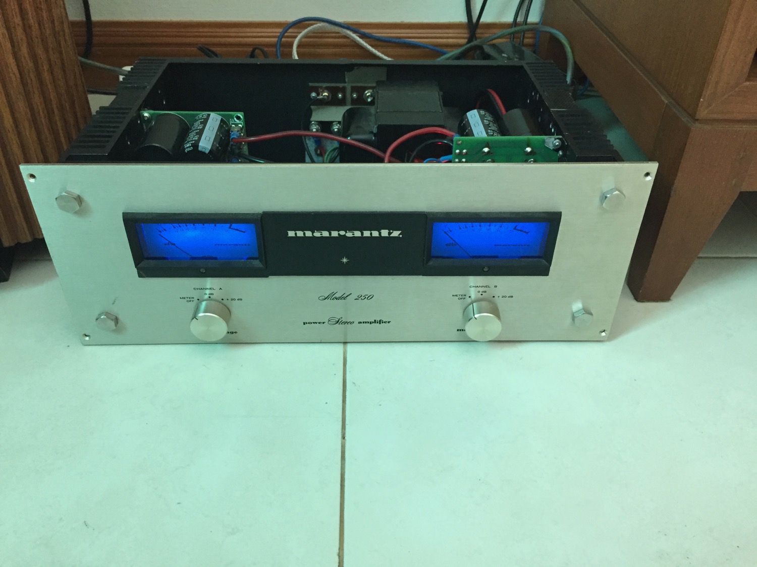

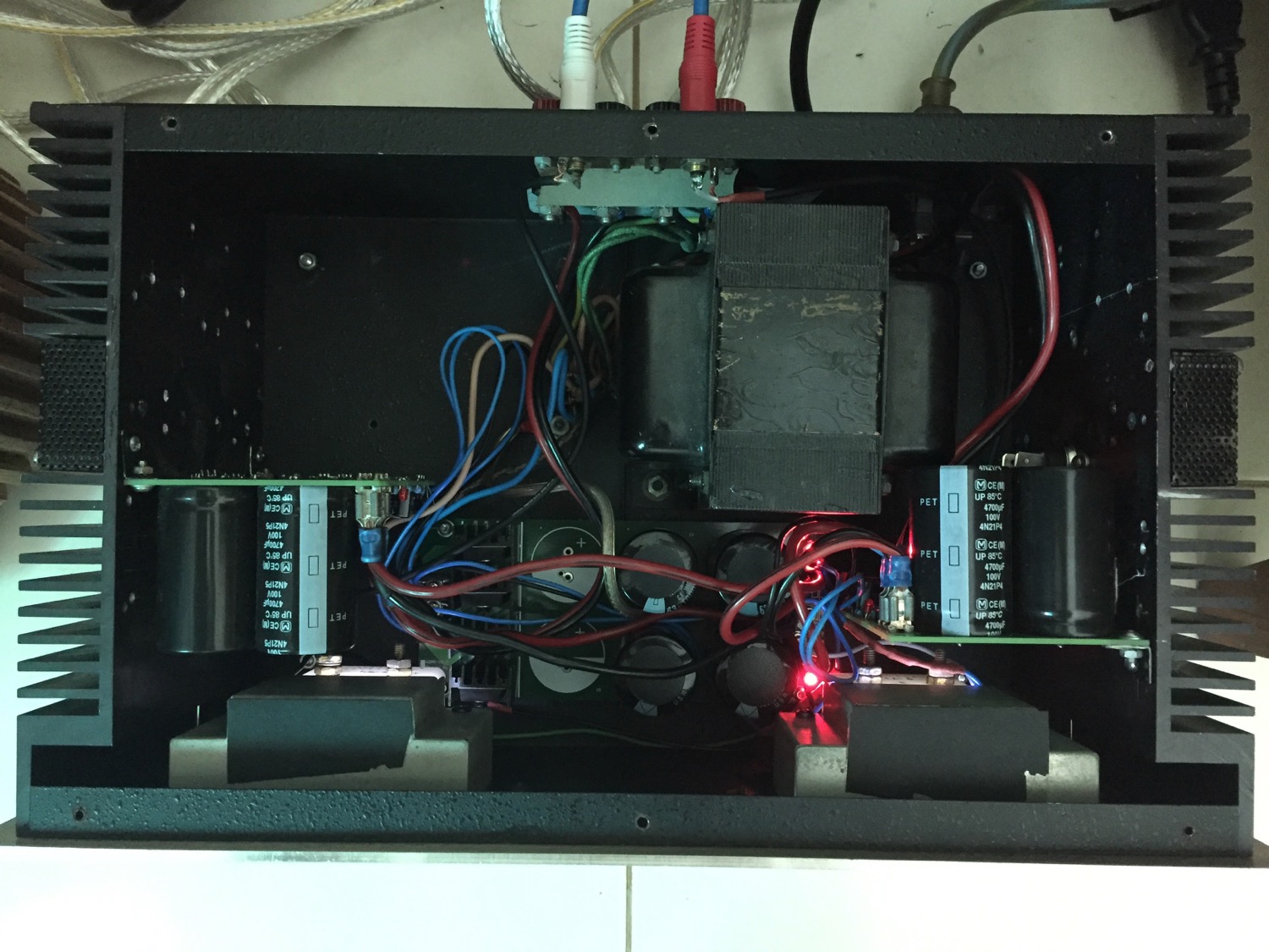

Q-Watt finished
After long time to build this amplifier is now completed.
I have two old amplifiers, one to old, an hotchpotch from a Marantz model 32 it was build in a case from Marantz model 250 (long time ago I have serviced Marantz in the Netherlands)
The second model was also a Marantz model SM-6 with a burned out voltage amp.
Initially I had planned to use the SM-6 to build in this the Q-Watt, but I changed my mind and use the 32/250 as case and use also the transformer from the model 32.
Unfortenately the transformer gives a lower voltage, with as result after rectification an 2x41V.
But in practice it appears to be sufficient, and with 8 ohm load I got appr. 20V
I have not gone higher because dissipation was quickly high.
And after listen to the amp today, I'm pretty happy, and yes the specs are real, THD checked with Keitly 2015 in accordance with Elektor.
