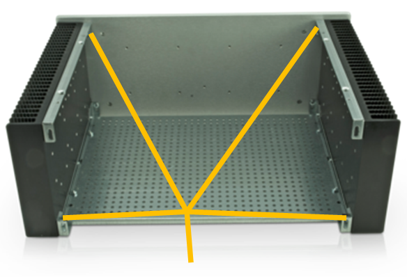

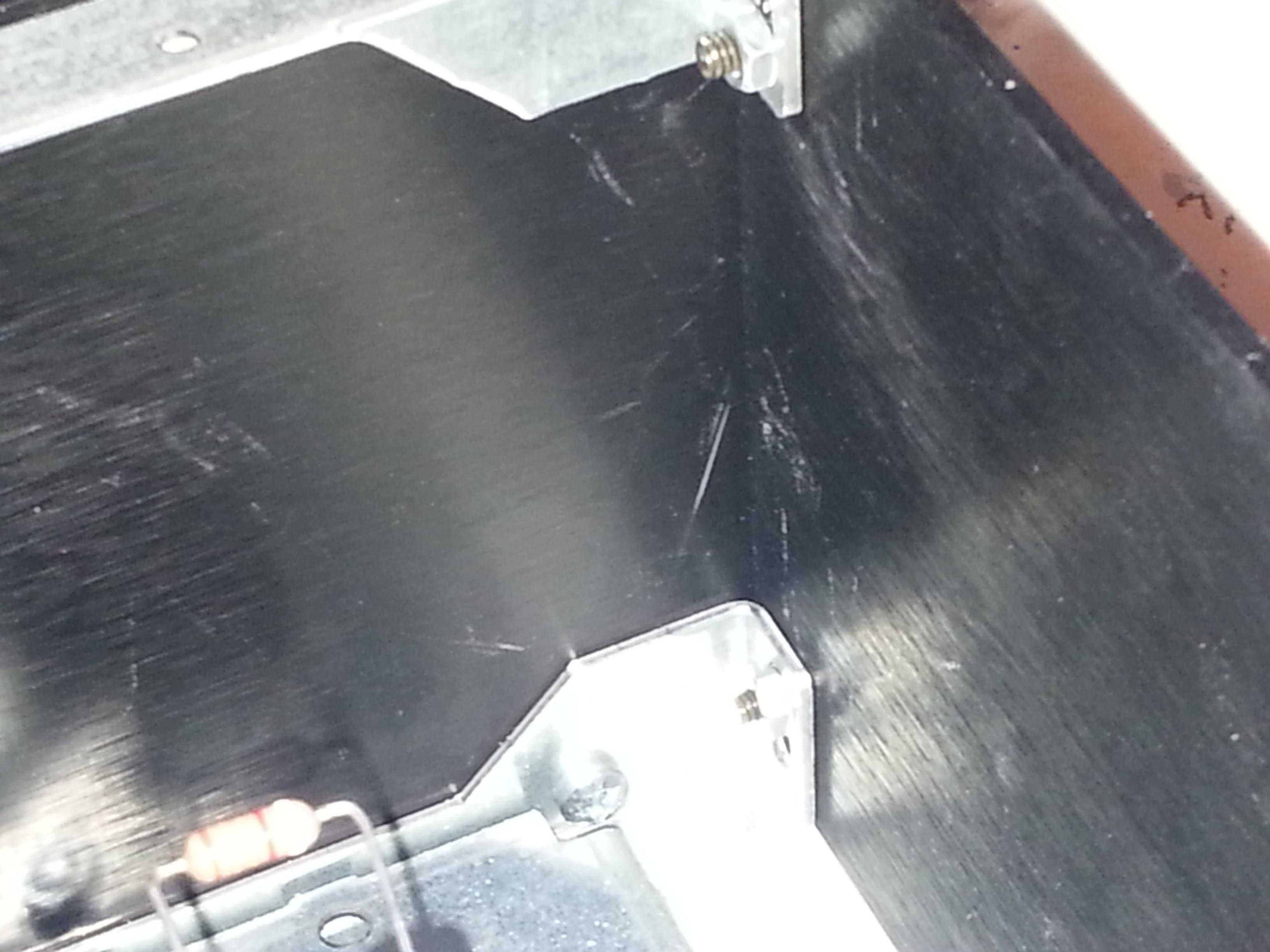

Hi All, - (esp. Calpe because you have the same case)
I have a quick question 🙂 on grounding the case walls and heatsinks... Is my existing steel bracket sufficient, joining the anodised walls (heatsink) to anodised backplate, to guarantee electrical continuity (see photo)? Should I sand off the surface coating underneath the steel bracket?
What is the best method for grounding the walls of the case? Do I need to drill more holes for direct wire connection? Doesn't seem logical since I already have holes with direct steel connection. Please help. I want to finalise my holy heatsinks.
Thanks - Popchops.

Hi popchops, I too have some small issues too, but with my SMPS and the UK standard earth and grounds.
My time availibility is my lunch break, so of course my Q-Watts has been going on for far too long.
Your sure to get numerous opinions from people in the forum, but we both have the same case.
As you've probably seen from my posts I have a mains input socket (kettle type)
From the earth pin of this socket I have an earth cable (green/yellow) and it's connected to the rear panel, soldered to an earthing washer (with solder tab) on the fixing screw of the socket.
From the same earthing washer I have connected another earth cable (green/yellow) direct to the bottom plate, again using nut/screw and an earthing washer.
So might say don't rely on fixings scews, but 'our' case is very well built, so for me the case screws (and you know how well built the case is) is ample enough. I'm not having earth cables running around everywhere giving the appearance of spaghetti junction!

In practice you'll need to connect each panel to PE by means of a wire. The screws inside the enclosure are not good enough for that. This is important for safety reasons: the electric current will always choose the easiest way back to earth. For this reason you cannot trust “the enclosure connections”. Instead run a green / yellow wire from the PE at the input to each panel in the enclosure. You can use a star topology just like you do with GND.
EDIT: found an image of your enclosure to demonstrate what I would do in terms of PE wiring:

A screw/bolt into a metal panel is good for a mechanical Earthed fixing.
Panels that are individually insulated by paint, or anodise, do rely on some other electrical connection. A screw into a tapped hole can be this connection.
I have not seen tapped holes that are anodised down the threads.
Thanks delange for your valuable views, as I have the same case as popchops I'll follow your steps with the UK standard earth connections using a green/yellow cable.
Soldering cables to these earthing washers (with solder tab) on the fixing screwscrew as indicated by delange.
