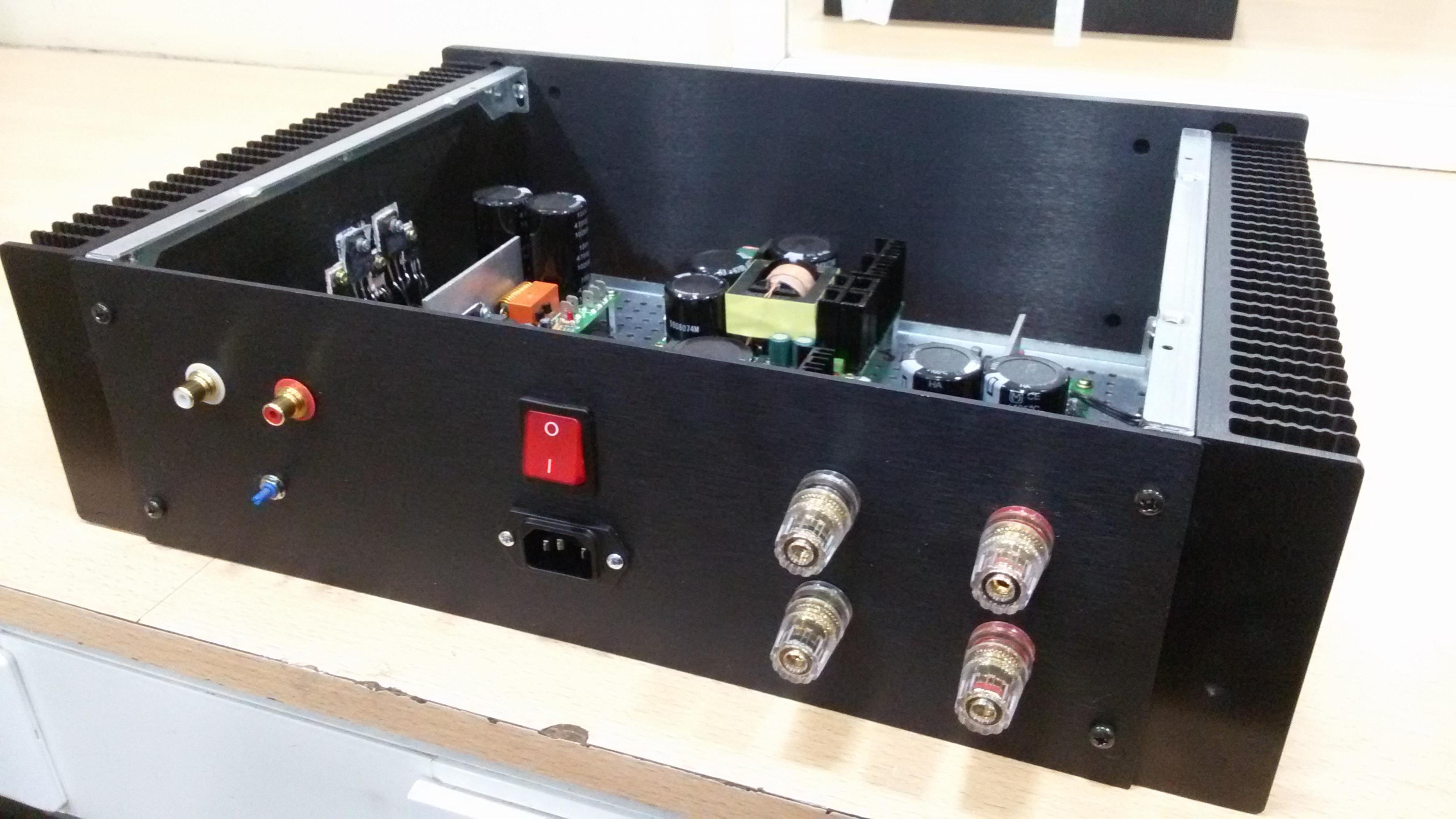

My Q-Watt as of 10/03/2017.
Slow as a snail but only being able to work on it during lunch breaks i've done quite well.
Wiring begins next week and then the setting up and testing.

Awesome Calpe! You're some way ahead of me. I ordered transformers today so I'm 4 weeks away from finalising the power supply. In that time I'll get second PCB finished and get some holes drilled.

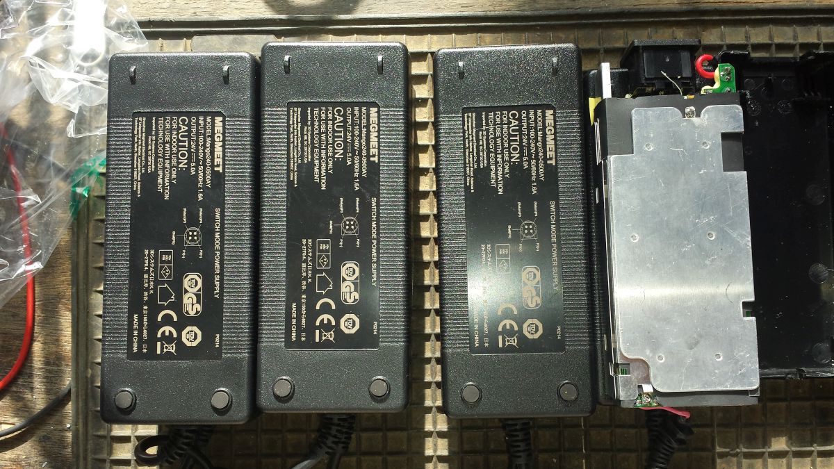

2nd picture shows the PSU: Eight cheap 24Vdc 5 A SMPS (one of them already disassembled, gnd isolated from PE and tweaked to obtain 30 Vdc), four per channel to be connected in series with the ground tap between the 2nd and the 3rd. This arrangement costs less than half of these Connex units (€ 9.95/ea).
Still have to try if it works, but I'm confident, as I successfully did something comparable with four other cheap SMPS units.

2nd pic shows my PSU, consisting of eight cheap (€ 9.95/ea) SMPS (24 Vdc 5 A). Four of them to be connected in series and tapped for ground between the 2nd and the 3rd one. The rightmost is yet disassembled, tweaked to obtain 30 Vdc and isolated from PE (which will be connected to each aluminum shielding externally). This arrangement costs me less than half of the Connex units.
Still have to try if it works, but I'm confident as I successfully did something comparable with other cheap SMPS.

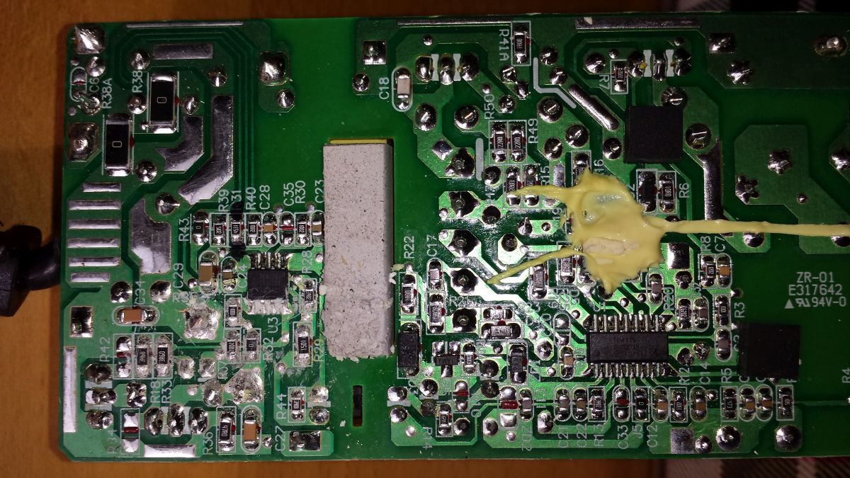

Can you elaborate on on the 'tweaks' you did on those SMPS's?
As for your configuration, you are doing this:
30
24
GND
30
24
Giving you a double 54 volts supply / 5A?
How clean are those SMPS's?
Seems like a good way to get +-54Vdc and gets a 24Vdc supply to run auxiliaries, etc.
Have a look at using RCRC after the smps to clean up the high frequency rubbish that will get past the on board filtering.
Maybe replace one or both of those R to an L+R using a fairly thin wire to increase the R part and help with damping of the inductance.
No, I'll tweak each one to give 30 Vdc, i.e. 60V per rail. Yes, I'll dare it 😀. If I'd be eager to 54V rails, I'd adjust the units to 27V each. Besides this, your assumption is correct.
First step is to open the plastic enclosure, using a hand saw. That sounds brutal, but there's really no other way. Next remove the aluminum shielding. Then trace back from the output terminals, peel off the silicone blob covering the relevant components, identify the error amplifier (U3, a TEA1761 in this case which also is a synchronous rectifier controller), it's reference voltage (2.5V) and the output voltage divider with it's tap connected to U3's pin 6. We have to look now at the divider's bottom resistor (R31, marked »4531« and marked by me by two black dots, see pic). If we want to increase the output voltage from 24 to 30V, i.e. by 25%, we have either to increase the current through the divider also by 25%. This is done by decreasing the bottom resistor, either by paralleling it by another one with four times it's value (about 18k in this case) or by replacing it by one of 4/5 it's value. Or we could increase the top resistor accordingly instead, i.e. from 12k5 to 15k3. I still have to decide which way I'll go. Most probably it is much easier to solder a second SMT resistor on top of the existing one at the bottom.

I have to stand corrected: The existing top resistor's value actually is 40k5. To achieve 30 Vdc instead of 24 V, it has to be increased to 49k5. If standard 47k were used, the output voltage were 28.5 V. Might be enough, though. Sorry for the confusion!

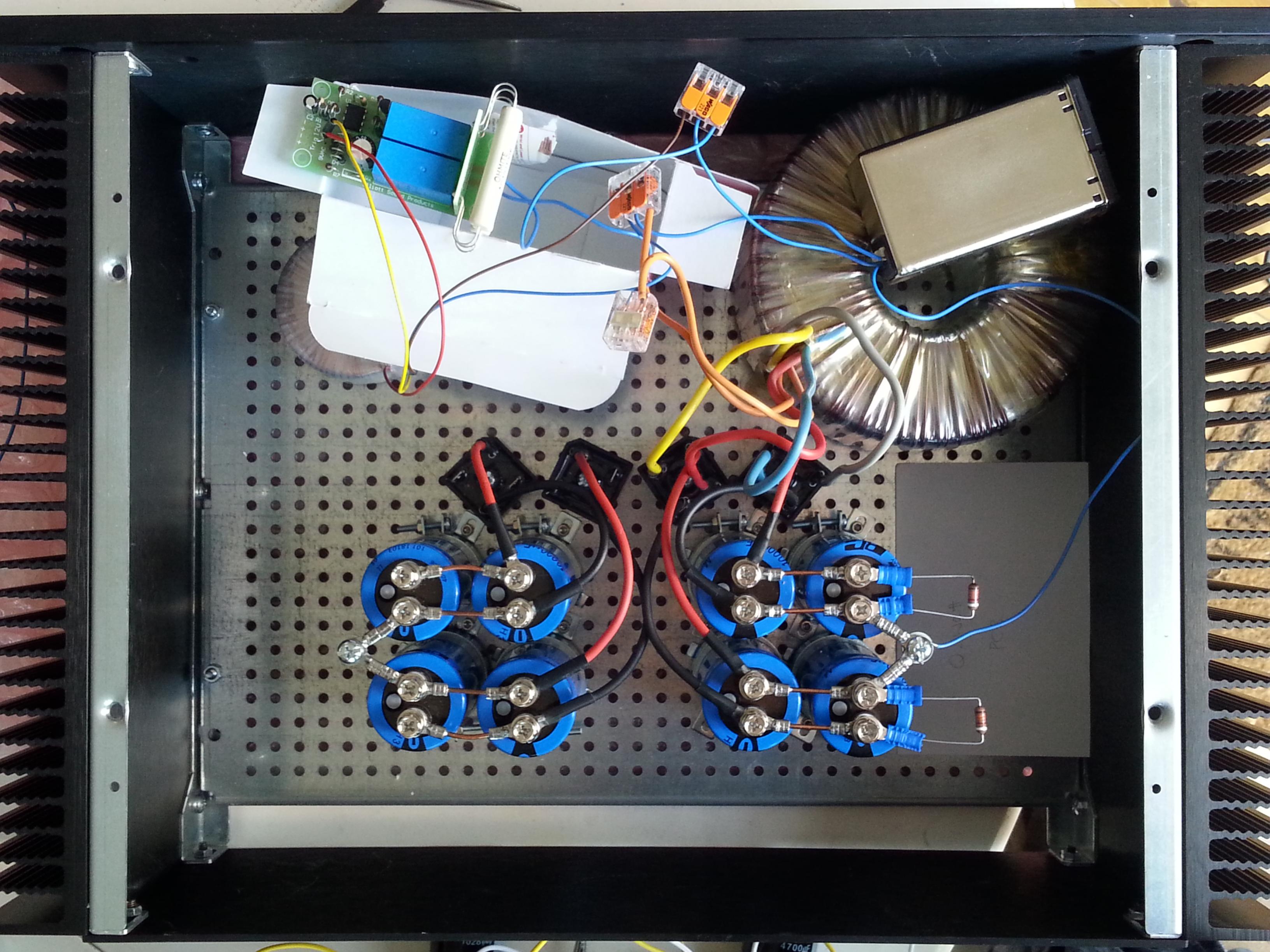

Delange, some advise when you can please.
I'm almost ready, wiring nearly complete except the mains socket, mains switch and the mains cabling to the SMPS boards.
So for when i wish to begin the 'Q-Watt on test run', as described in the Elektor article, can you please advise of any precautions?

Just make sure that P1 is fully turned to the left and that you have the power resistors fitted instead of the fuses. Of course, at this time there are no speakers connected. And short the input.
Read the instructions carefully before initial start up so that you understand the process very well.
After this, you're good to go.
EDIT: and carefully check your wiring before start up.
