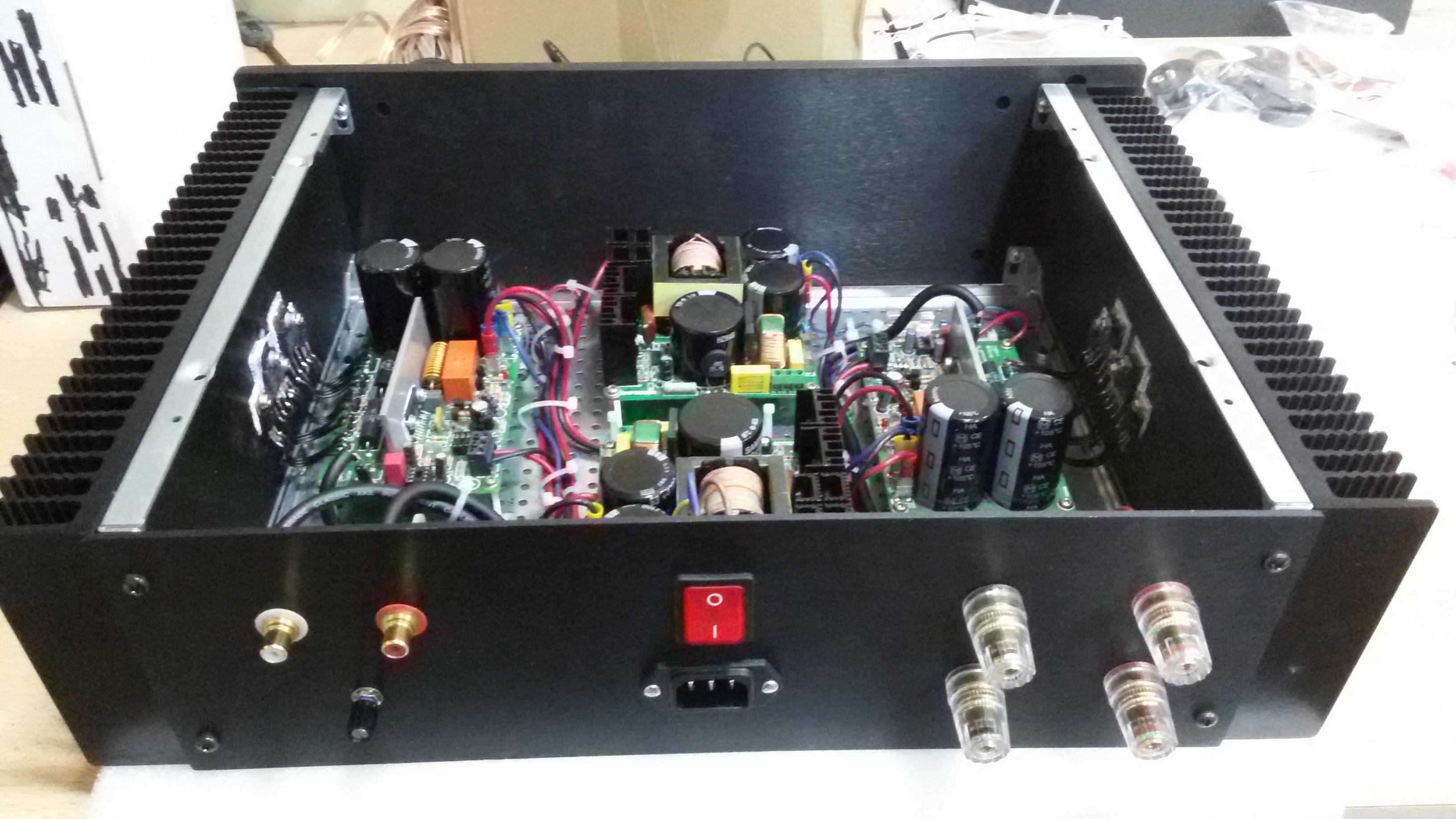

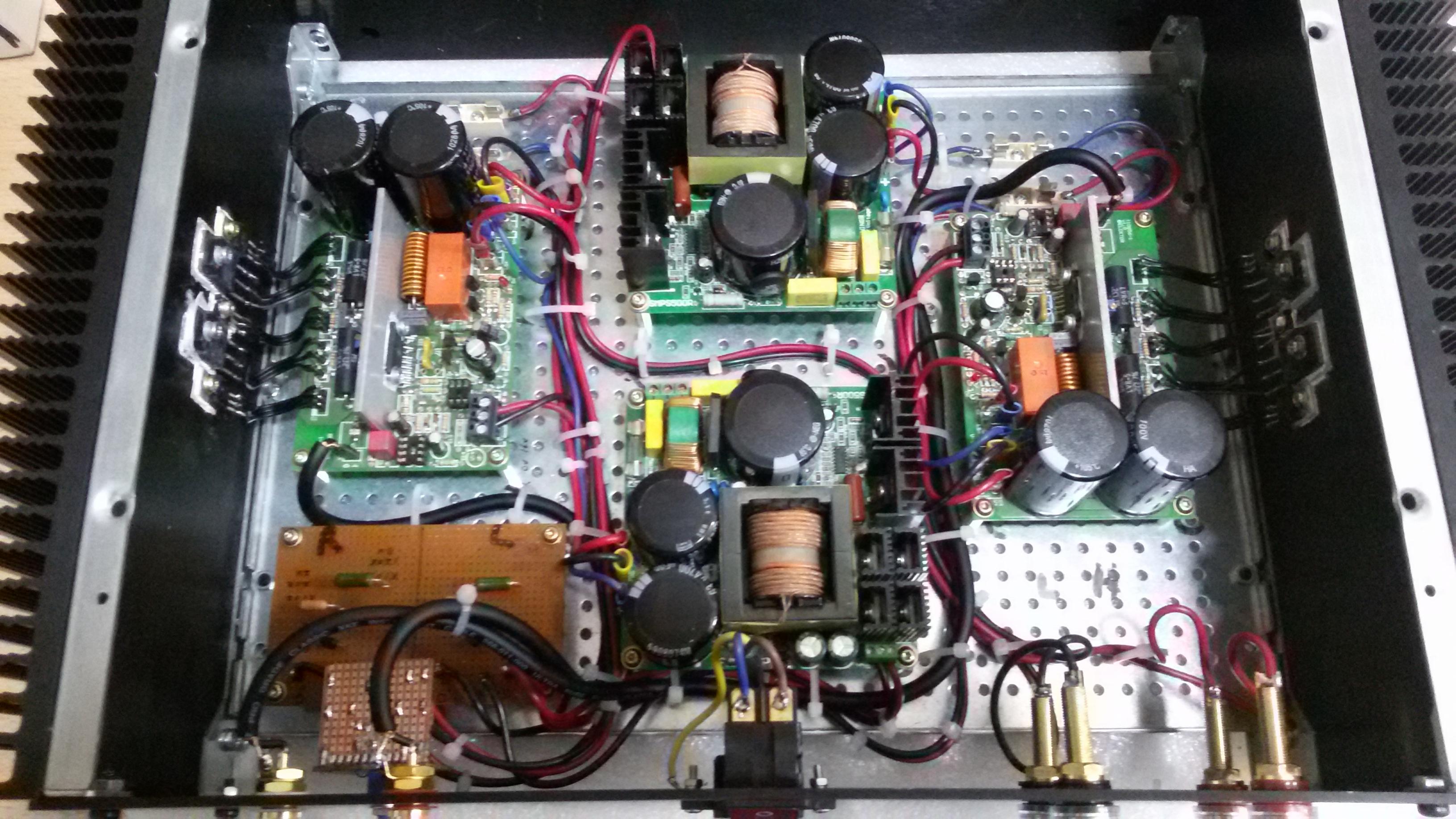

My Q-Watt as of 16th March 2017
delange, should i connect the earth cable from the rear connection (see image in post 283) direct to the SMPS's or connect the SMPS earth connection to the bottom plate close to the SMPS input connection?
Same here!
And just another point: I've been somewhat astonished that people who construct mains powered gear don't even know the acronym PE, which is a very common one (more common than most abbreviations that are customary here within this forum 😀).
Best regards!
Thanks for that. The earth connections on the amp are now actually wired as follows: -
Earth pin on Mains input socket connected to rear panel.
Rear panel connected to bottom plate.
From each SMPS mains input sockets earth, wired direct to bottom plate.
All i have left to do now is to wire from the mains switch to each SMPS mains input connection and double check wiring and transistor insulation (2nd time) on the heatsinks.
Another basic question exposing my ignorance: when setting the quiescent current, I know I need to short out the input so the amp has no stimulus. Can I leave the output disconnected? Surely it doesn't matter if the binding posts are connected if there are no speakers plugged in.
popchops, as you have the same case as i do, what ive done is to connect the earth from the mains input to the rear panel.
Then from the rear panel (same connection point) i've taken an earth coloured cable (yellow with green line) and connected it to the bottom plate.
From my two SMPS's i then connected individually from their earth connection to the bottom plate, using only one connection point.
