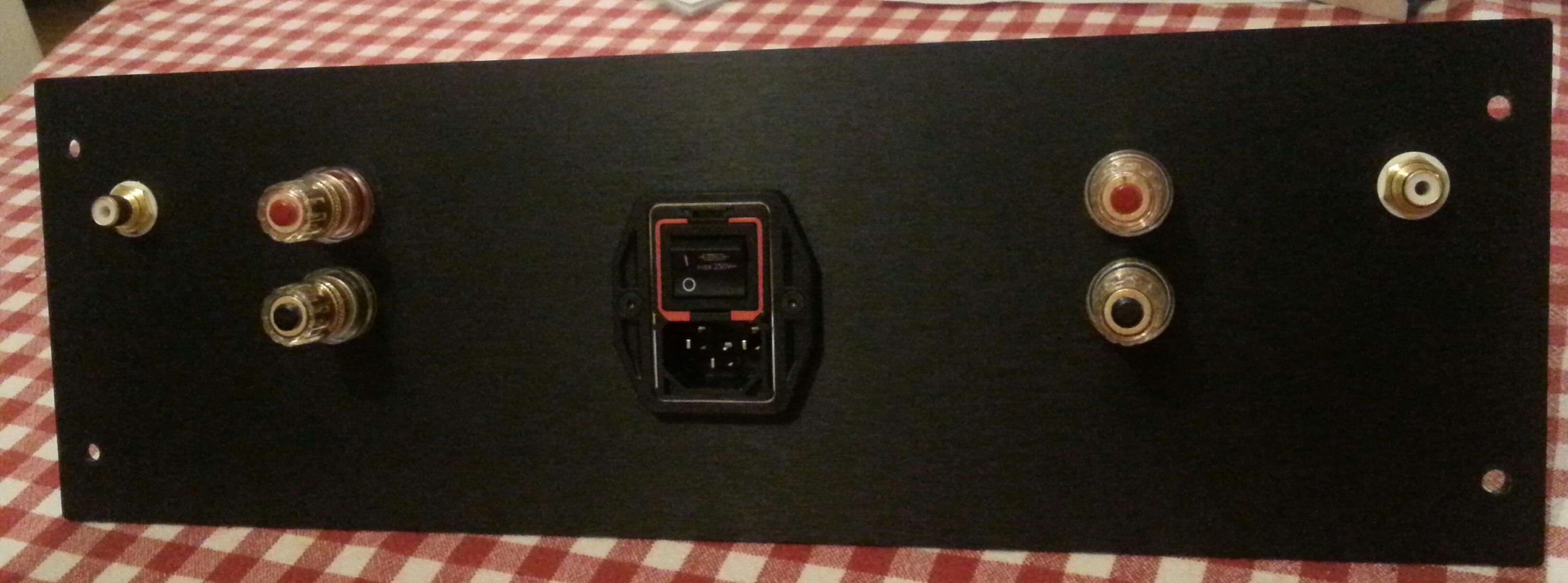

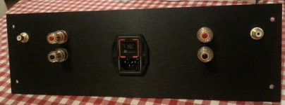

Hey folks!
Just finished the back panel drilling for my Q-Watt amp! Panel is 373mm x 120mm x 3mm.
