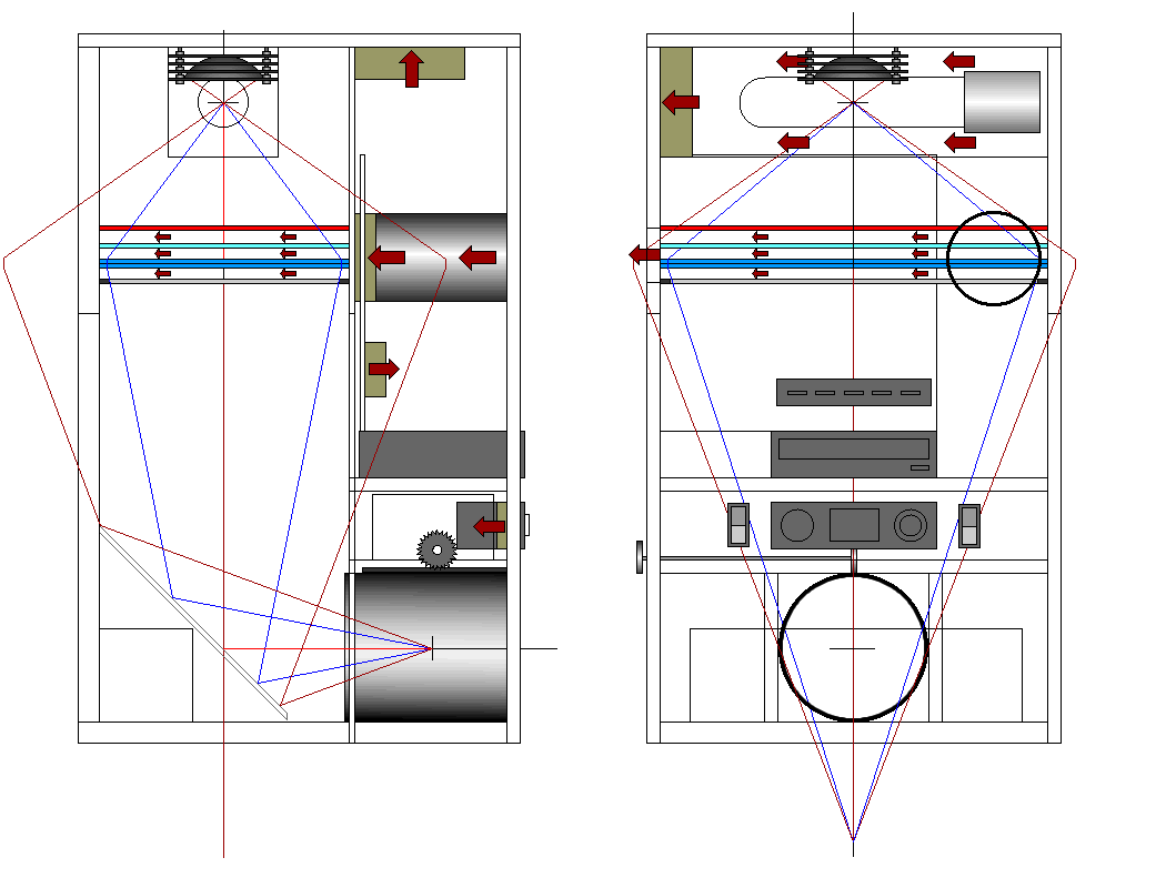

Here is the 'HDHTPC' idea i've been playing with... It will be a wall mount with a RF or Bluetooth KB & mouse. I'm attempting to price parts now to see if it'll fit into my budget :devilr:
Oh yeah, note the gear driven focus idea. I plan on lining the chamber for the projection lens with felt. It should seal out any light leaks and make it slide nicely.
It's all to scale except for the ballast at the bottom. Anyone know the size of the LL balast off hand? I hope to keep it down there to eliminate any possible RF interference.
spamh8r - My heatsink reflector idea is shown
Hezz - I'll get those measurements for you shortly

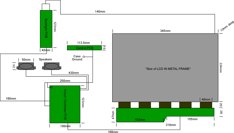

Inkog,
Have you measured how thick the LCD is without the backlight on it. I'm coming up with some LCD mounting brackets but I havn't had time to strip mine yet as I don't have a safe place to keep it until I mount it.
Also I've got to get a light. It's the only thing I need except for a small piece of IR glass.

Hezz said:
Inkog,
Hezz
No I'm sorry, I have yet to strip my LCD down that far. I had planned to keep the LCD in the metal frame for protection, and use it as a safe mounting device.
Once you strip the LCD you'll notice that the backlight snaps into place with a white plastic "square ring" into the frame. You should be able to pop this ring out and remove the backlight while leaving the LCD in this metal enclosure. My *guess* is that after the backlight is removed, you could replace this "plastic ring" and have a perfectly good protective mount.
I'll try to get some pictures of this for you if you would like. I am still using the monitor as a TV at this point, and let me say it is a very nice one. I have gotten the contrast and saturation to far beyond the level that I even expected out of this panel. I cannot wait to see a projected image!
Maybe you can ask 18wheeler as he is the only one I know that has actually stripped this monitor bare. If you can wait a bit, I'll be happy to provide you with this info. But just like you, I'm waiting as long as I can to strip it completely, as we all know the risks with this...
