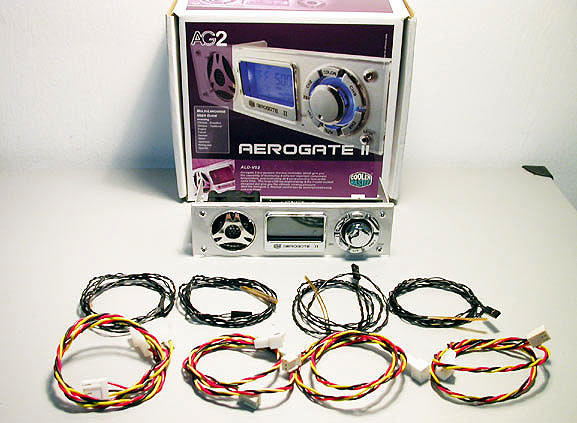

I ordered a AeroGate2 4 channel fan controller and temp monitor. Unnecessary, but cool as hell
It has a built in 50mm fan that I'll use to vent the electronics area of the PJ and cool my modified PC power supply. The built-in alarm sounds if any of the fans fail or the temps reach a certain limit.
