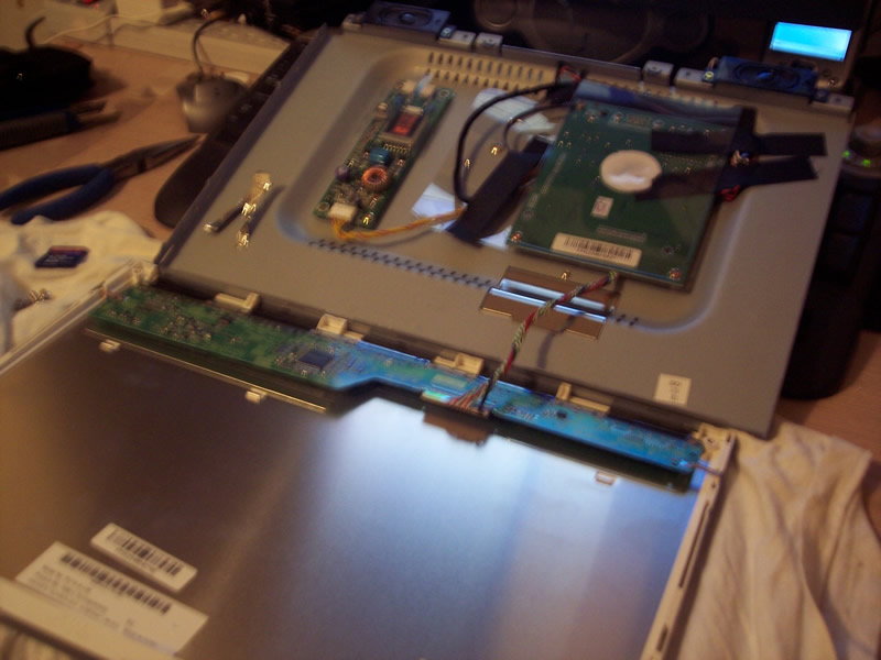

I partially striped my LCD to get measurements of the PCBs and wires lengths so I could start on the LCD bracket. I took several pics but they came out very poor so I'll just attach one.
I managed to get it back together (and still working 😉 ) so I can still use it as a TV until my optics ship. I've started the bracket and will post more pics once its complete.

Striping Proview PS576Ws illustrated.

Hezz said:Inkog,
If possible can you post the dimensions of the LCD and control cards for this LCD.
Hezz
Sure thing, but it will have to wait until I get home tomorrow afternoon.
