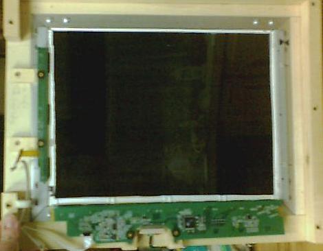

Mounting the LCD
>Once you strip the LCD you'll notice that the backlight snaps into place with a white plastic "square ring" into the frame. You should be able to pop this ring out and remove the backlight while leaving the LCD in this metal enclosure. My *guess* is that after the backlight is removed, you could replace this "plastic ring" and have a perfectly good protective mount.
That's what I did with my Proview 566s: The LCD and backlight assembly was held by a plastic injection molded part that covers the entire back surface. I took it all apart with a Philips 00 screwdriver. The plastic part can be lifted off the LCD, while the LCD remains loose in the metal frame. Then I cut the center portion of the plastic out, so it would not block the light. I put the plastic back in the frame around the LCD. Eight of the tiny screws hold the plastic into the metal frame. The metal frame has nice mounting tabs on both sides, so it is easy to fasten that to an aluminum angle frame. I surrounded that with a wooden frame so I could hold the flopped driver boards in stable positions without any strain on their flex cables.

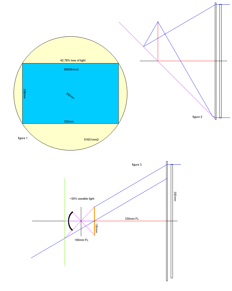

Jl2,
Q: "about reflector: would a sferical reflector be ok for a 16:10 panel? I mean would the light be uniformaly spread also at corners? I think that an elliptical one would do better."
A: Under ideal conditons, a perfect spherical reflector would produce a uniform cone of light when used properly with a point light source. As you know, we are not able to use a true point light source, and perfect reflectors matched to our bulbs are hard to come by, so us DIYers are forced to make due as best we can. With that, I think a spherical reflector setup is still our best bet. A good spherical reflector should produce a bright, evenly lit, circle of light on our LCD much like Fig1 on the attached drawing below.
I'm not totaly clear on your eliptical reflector question, so here are two answers: (1) If you're thinking an eliptical reflector would "smash or narrow" the circle into an elipse shaped pattern of light, allowing you to reduce the amount of wasted light. This is not true, and would greatly increase the unevenness of the distribution of the light. (2) Now if your thinking of using a true eliptical reflector as it was intended, much like how most flashlights work (or "torches" on your side of the pond 😉 ) ... the MH bulbs we use would produce a dark spot in the middle of the light cone due to the arc chamber being closed off to light on the ends. Do a little research here if I'm not making since. Thats how I learned.
Q: "about fresnel: did you order the 16:9 fresnel from alan already cutted to fit 17" widescreen? I think that they are ok even if larger than the proview panel, the important IMO is to place the lcd in the center.
And are they already splitted, how to split them? the rear fresnel must be adherent to the IR glass facing the light, right?"
A: I went with the uncut 15.5x15.5" fresnels because I wanted to make certain that they were large enough to work in any custom configuration I decided to use.
They come "split", no need to seperate them.
I would not place the fresnels in direct contact with your IR glass. The IR glass may become quite hot. I would use another piece of class, or your UV filter to support your fresnels.
Q: "about the proview: did u find a way to set the resolution of the lcd to 1280x768 with the black bars above and under instead of the pixels streach?"
A: Yes there is a OSD option to keep aspect ratio of smaller than native resolutions without stretching. Supports these resolutions:
