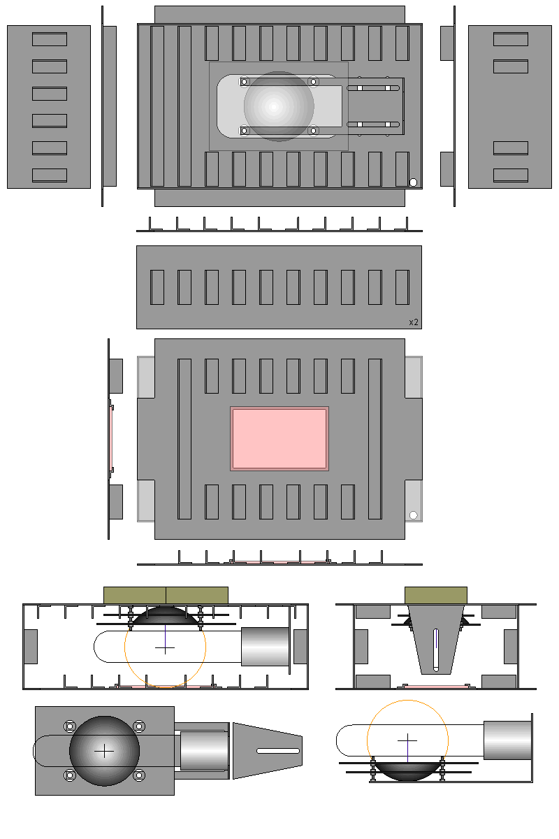

A little over-engineered probably, but it should work well. Anyway, the plans for my light engine...

Guy,
thanks for your input. Unfortunately this complicates things even more than I thought but it makes sense that the entire volume would be emitting light.
Inkog,
Looks good. I'm amazed at how good your plans are from just basic graphics software.
Hezz

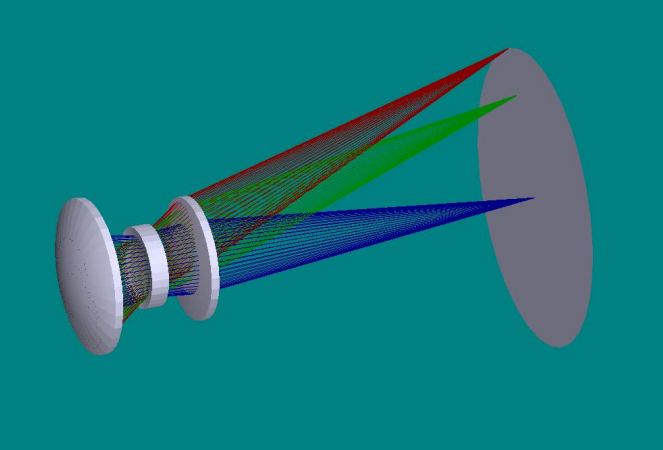

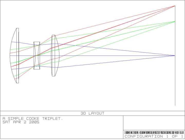

Now here is a fully computer optimized 40 degree angle FOV cooke triplet that I optimized in software. You will notice several things. Some are not so obvious and some are. First all of the lenses are different shapes and geometry. There are no two surfaces or spaces that are the same. Even the surfaces that appear nearly flat on the first and third lens are very small but absolutely necessary convex surfaces.
The smaller end must, and I repeat must be oriented towards the smaller (LCD) image for this lens to work properly. The other way will have severly reduced light output and resolution. Changing any parameter in this lens system even slightly has a drastic effect on lowering the quality of the lens.

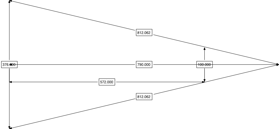

Ok,
I don't know if you can make out this diagram of mine which I did to help me decide on a fresnel FL size for my application. Also I believe I was wrong in my statement above. I think the LCD to lens distance was more like 18 inches for my 12 - 13 foot throw distance at the orientation I wanted to use.
