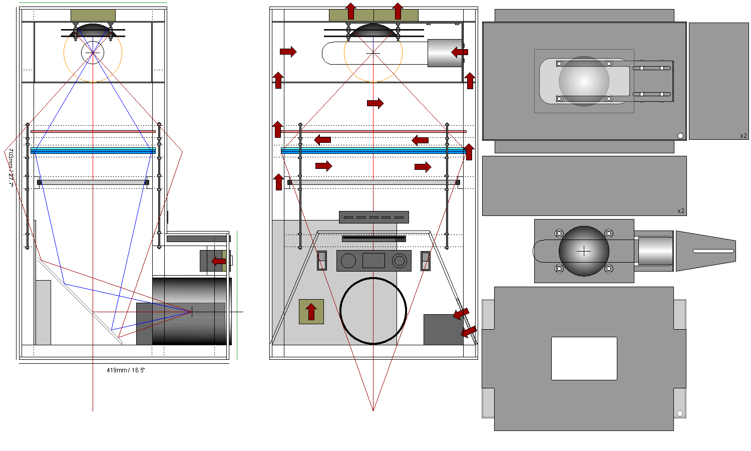

Below is my latest plans based on measurements provided by several users of simmilar optics. They tend to change often (normally for the better 😉 )
Blue is the widest angle of light that will be needed to light the entire vertical surface of the LCD. Red is the same but for the horizontal surface. I normaly trace the diagnal distance also, but it is not shown in that drawing.
I trace those lines for several reasons:
I can get a good idea if my reflector is of suffent size to evenly light the entire LCD. (Turns out that the IKEA Napkin holders should work great.)
I can measure the max angle of light as it is hitting the triplet
I can get a rough idea as to how large my fresnels will need to be, and therefore the size of my box.
I can also tell how big my FS Mirror will need to be.

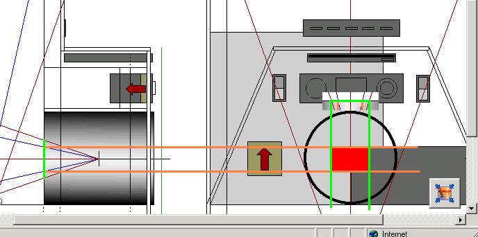

ok thats what i thought
anyway i have been working on your pic, look at this atached file at the botom;
i drow a red square inside the triplet lens (rear lens). I think you could paint the rear lens outside (non red part) with black flat and you wouldn´t notice any difference since there is no light hiting there. Is just a thought, i am discussing with guy grotke at other trhead, but i think you are not using full triplet area.
tell me what yo think about

I understand what you are getting at. Right now, all I have to go by is information from others, at least until I get my optics. It looks like you may not be able to focus the LCD if you shorten the LCD <-> Triplet distance enough to take advantage of the entire FOV. As far as I know, no one even knows the true FOV of this lens. Its all an (somewhat 😉 )educated guess at this point.
thanks for the reply;
i don´t mean to shorten the lcd triplet distance, it is what it needs to be, but you can choose a field fresnell long enought or just place the bulb at a proper place so the light cone from the lcd hits full area on the rear lens element on the triplet.
of course, taking the triplet closer to the lcd would fill the area but the image should not be focused for that throw (you would have a larger trow).
you know some OHP have a wheel so the bulb placenemt can be adjusted, i believe it is if the throw changes to much, then you need to adjust the light cones again.
thanks.
Um... isn't the light hitting the edges of the triplet(Therefore diminishing or destroying the corners of the image) what everyone's trying to AVOID? That's hard enough for most people. Don't be concerned with it not occupying the whole FOV of the lense.

If your reffering to the red rays in the right image, those rays are not folded and are not representive of where the light would be entering the lens. The left most image is correct and all light enters the triplet well within its FOV.
Inkog: A fresnel doesn't need to be used at its focal point, necessarily, as long as it's on the focal axis. Theoretically, you give up some light evenness with this(Due to the light hitting the panel at a non-perpendicular angle), but it seems that people are putting out good results this way anyway.
Given a set of two 330mm fresnels, for example, you can put a lamp closer than 330mm to the fresnel, at a point which will make the beam extend to a point 450mm ahead of the front fresnel.
Yes I'm aware of this. My current plans use 2 330mm fresnels. Arc to fresnel distance of ~191mm, fresnel to triplet distance of ~451mm. Unfortuantly, I know of no one whom has been able to get a perfectly lit and focused projection with a >15" panel using 330's and this triplet.
I would like to find a 450mm fresnel so I can use a split design, have a keystone option, and have good light distribution. This setup would be ideal for me, but I'm going to make do with what is available to me at the present time.
Who knows, once I get my optics and start experimenting, I may find this setup works perfectly for me. Like I said before... until I get my optics, it's all guess work and assumptions.

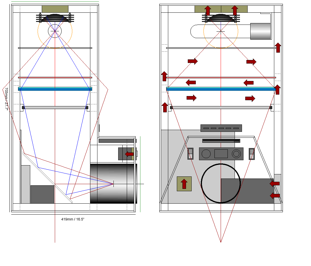

Here is an update to my plans. On the right is my light box/engine design. 100% adjustable for fine tuning. Comments welcome.

Inkog,
Your overall design looks pretty good. There are now a few things to think about in regards to the bulb and reflector.
One, a lot of light is lost out the sides and if you can get the reflector to come up around the bulb to it's midpoint you will reflect more light (in theory).
I have come up with an idea that I think will improve the light reflectors that are being used. I think it will work with both spherical and parabolic reflectors.
Since the actual light element is far from being a point source all of the reflectors that we are using are far from ideal. I have come up with some reflector geometries that I think will work better than standard shapes for non point source elements.

I already have both my bulb and reflector and by my calculations the reflector is big enough to reflect light back through the arc at at all the angles needed to light the fresnels from corner to corner. Any bigger and you would just be reflecting light and IR heat back through the bulb at angles that would not hit the fresnels anyway.
I hope that makes sense. 😉
