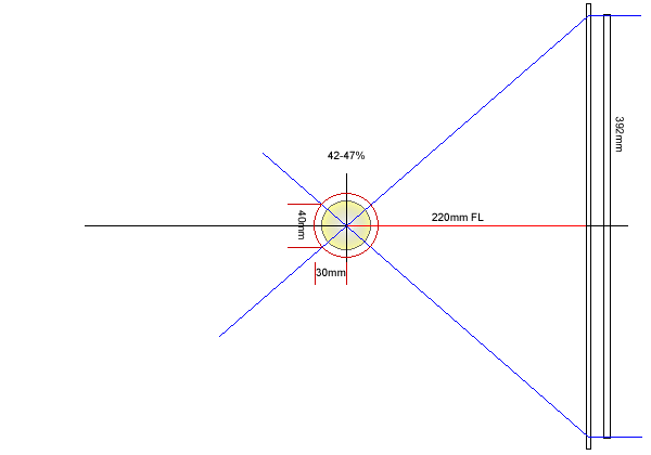

I think that spherical reflector from Surplus Shed is damn near perfect for the s400dd bulb using a 220mm fresnel with no pre-condenser. See below. I will get a couple of those to play with
Good Find bro
(By the way all, of my sketches are 1px==1mm)

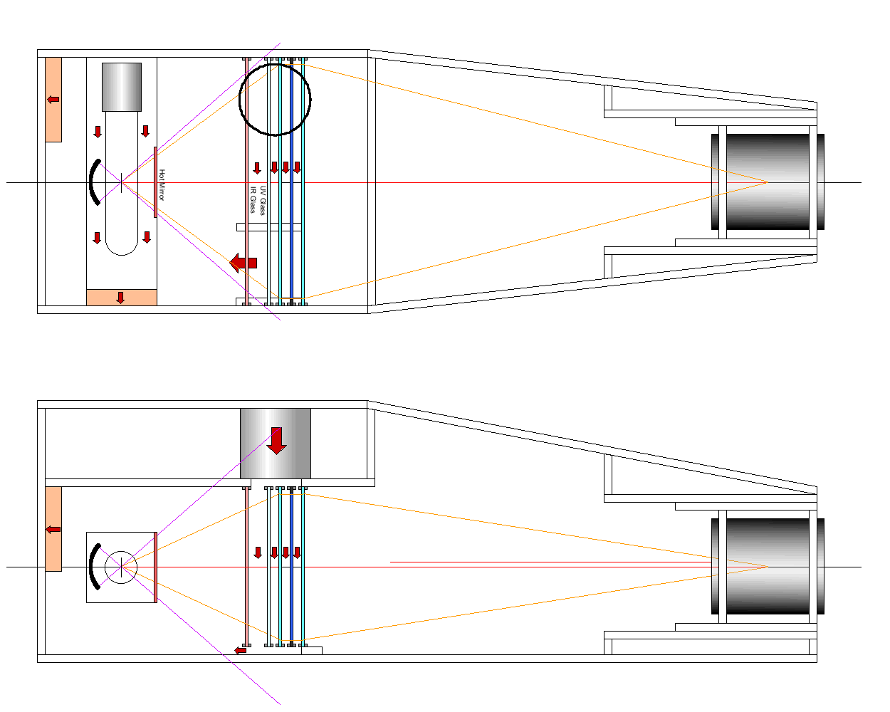

Guy, B270 can handle upto 300c no probs, aslong as you cool the condenser there isnt a breakage issue.
Standard float glass will.

I don't think a MH lamp in close proximity will melt a standard glass condensor,
It wont melt it, it will crack it, its from the expansion rate being too great on the center of the lens. They dont heat evenly either, the hottest part is right in the center (about the size of the arc).
What happends is the center gets so hot it has to expand more then the outer. The outer is cooler and therfore boom, it gives.
I used to think that they heated evenly aswell, it wasnt until i got a temp probe out (that melted btw) and tested it. I also saw the heat difference on a particular lens on the plano side as the coating in the center changed colour to the outer. The coating in the center was burnt.

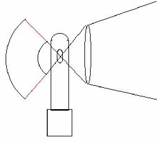

The reflector does not have to be the same diameter as the pre-condensor lens, because you can have it at a different distance from the lamp arc. It just has to have the same or slightly greater of an arc of intersection, when the lamp is placed at the center of curvature. That way, all parts of the pre-condensor lens "see" a reflection through the lamp arc.
In the drawing, I have a small reflector near the lamp and a larger reflector farther away. Their shape is the same.
BTW: Beware, reflectors are spec'ed by their focal length which is 1/2 of their radius. You will not try to use them as bad parabolic reflectors, so all you care about is their radius.

Oh! Thanks for that tid bit, that helps alot. I was worng in my thinking
Guy Grotke said:BTW: Beware, reflectors are spec'ed by their focal length which is 1/2 of their radius. You will not try to use them as bad parabolic reflectors, so all you care about is their radius.
