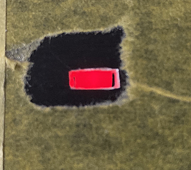

When I was in need of a little distraction, I went to the chassis and tried my mechanic skills, making a prototype of the LED-indicator:
Since I have dozens of rectangular leds, I'm using them for the front. Cutting out a hole 5 x 2 mm is a bit of a challenge though. (As one can barely see, the LED sits snugly, but the cutout got half a mm too long). I luckily made it on a spare part.
Next try: round the led, make the hole 5 x 2 mm with round ends...
edit: That yellowish stuff is the masking tape protecting the anodized aluminium.
