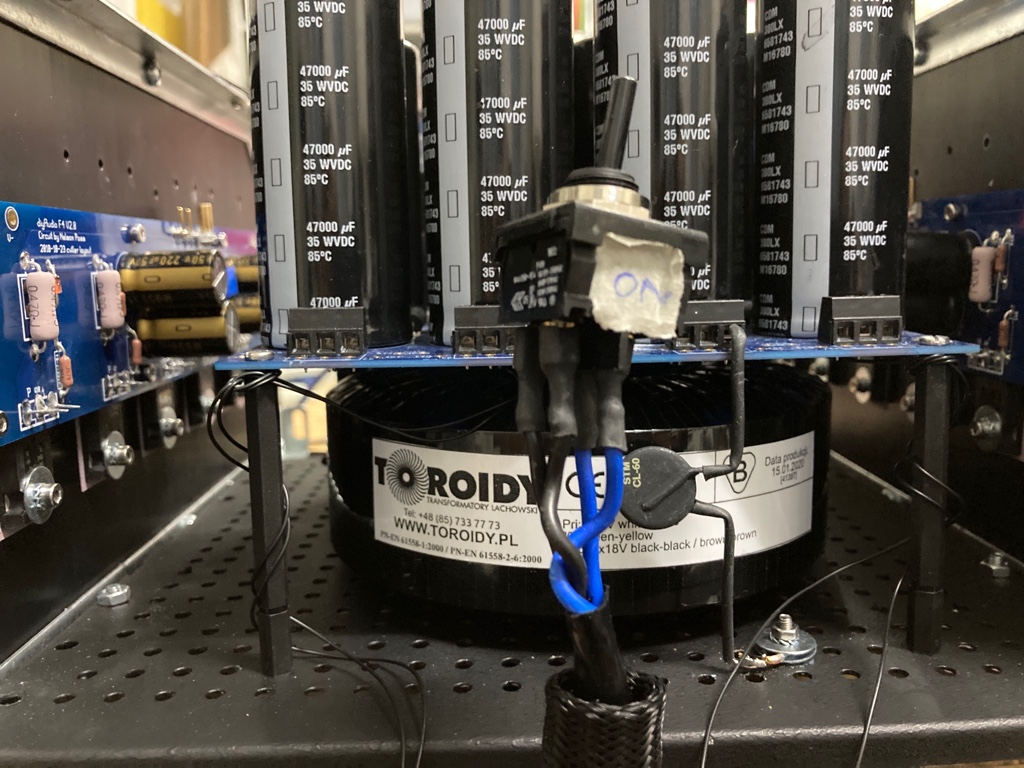

1) continuity
Almost everything‘s installed.
I just wanted to make sure there’s no continuity between hot and neutral on the IEC... and there are 40 something Ohms.
Must be the toroid‘s primary?
Will unplug it and repeat the measurement...
You have the resistance of the primary windings plus the resistance of the thermistor.
This seems about right
Are you on 240V AC?
Are you on 240V AC?
Yes, 240V

if you switch off ( with switch ) , it must be open circ
again, post pictures
we will ask for details, if needed
Dumb measurement (new battery) IEC hot (brown) to IEC neutral (blue):
All disconnected, switch open: no continuity
All disconnected, switch open: 8.3 ohm
Small xformer connected, switch open: 2 ohm
Both xformers connected, switch open: 45 ohm
1) from IEC towards switch
2) from switch towards softstart-board
3) PSU 0v to chassis
4) IEC Ground to chassis
Thermistor from toroid primary 0 not yet installed...

aha

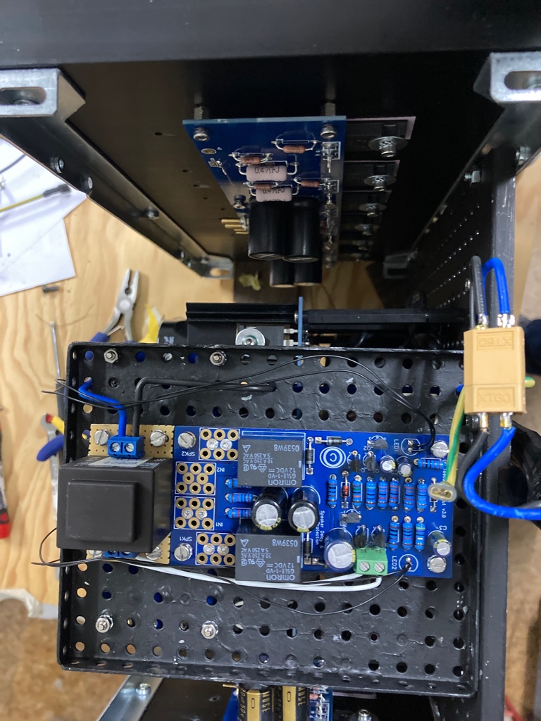

I see we still have missing info ........... you have softstart circuit there, so reading 40 or so ohms is to expect
anyway - give us larger plan pictures so we can see arrangement of everything
and - you got me veery confused here :
switch open in all cases ?!?!
post pics, plenty of them

Argh.
No of course, the switch was closed I repeat the switch was closed.
Sorry my bad.
or maybe is just bad battery in DMM
time for new one
Where did you get THAT battery?
Must make wonderful measurements [emoji1787]

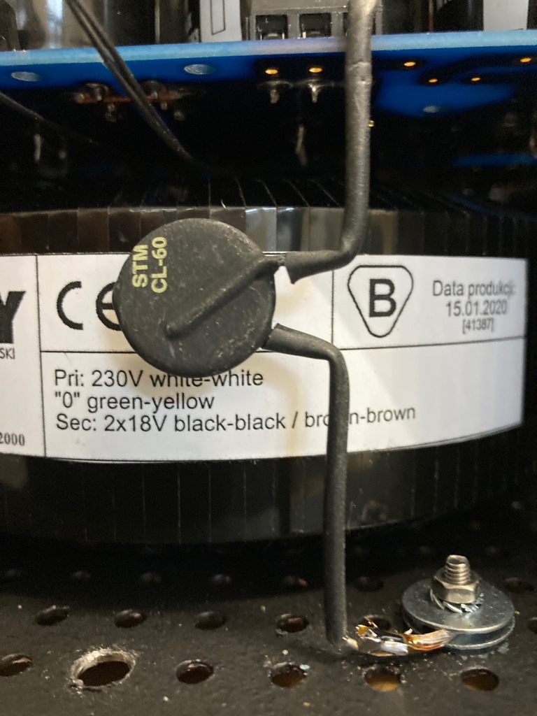

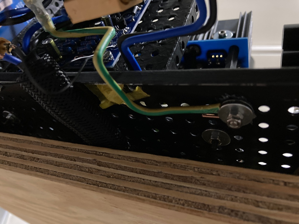

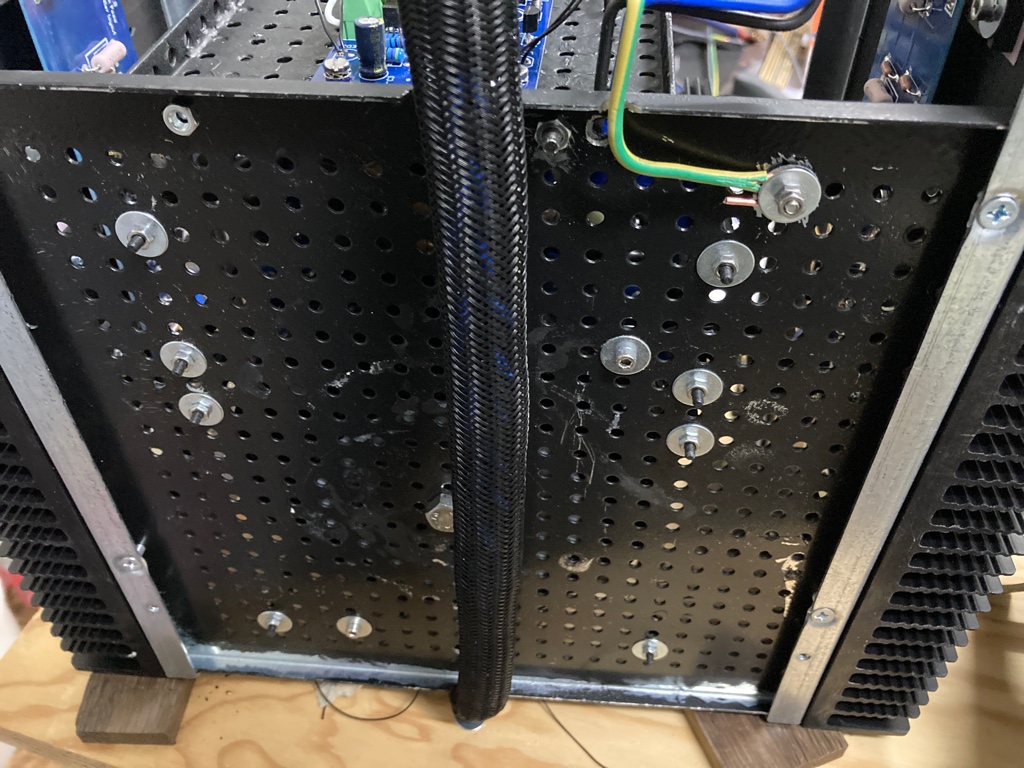

grounding the tranny...
As you could see in the last image I posted (last, above) my toroid comes with a yellow-green "0" wire...
Shield between primary and secondary?
I am not sure (haven't got the question confirmed before) wether it directly goes to chassis ground, or wether it should be lifted with a thermistor too?
Pico, your answer was the closest I got:
1 thermistor between primaries (got the softstart-board instead)
1 thermistor @ PSU 0V
no mention of CL60 @ tranny-0V =
right?
TIA
david
(and, just to have it said, I (bloody) did listen to your cap-recommendation, and it scared the **** out of me, I mean, 8 * 47000 )
right?
TIA
david

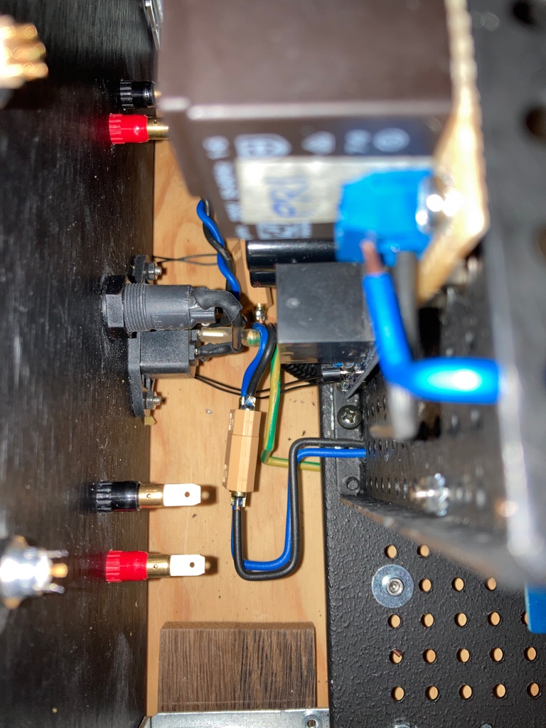

I still can't see how you did connect small aux xformer, big one and soft start circ........
few things - rouiting just one wire through hole in metal plate is no good practice - you need to do that with pair of wires , both of same circ ( lead and return)
also - be sure that you connected primary of small xformer to mains side (not secondary to mains!), taking in account that you wrote "Small xformer connected, switch open: 2 ohm"
frankly, I can't make sense of list you wrote , even when knowing that you made typo with "switch open"
Ok. I'll make corrections, check everything again and try to make a diagram. (already 2 aux-trannies blown)
