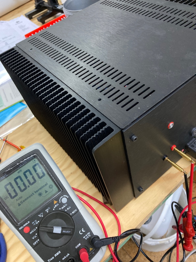

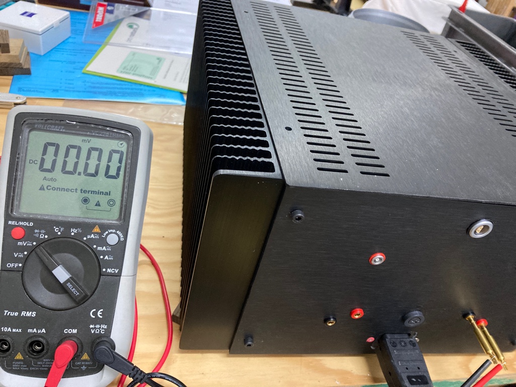

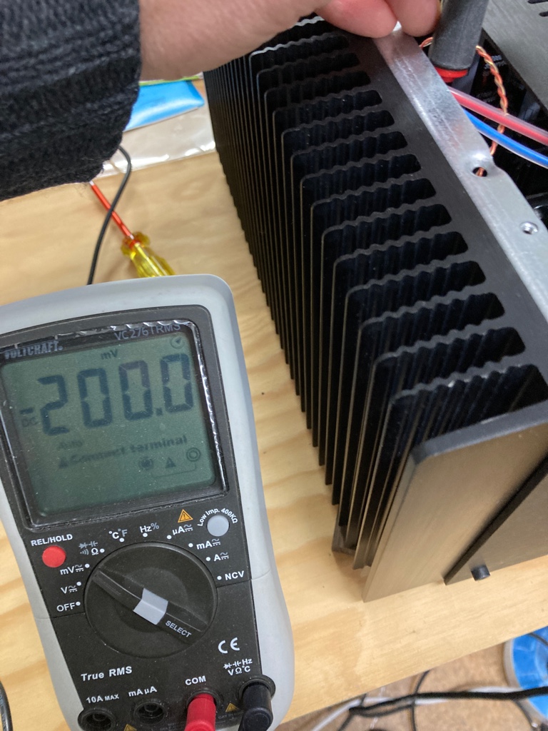

Bias & offsets for a pre-bragging. (Of course the offsets are momentary, it is jumping +- 0.2mV or so, bias is +- 0.3 mV

On mine, I set up the bias to 200mV and made sure it was stable, then adjust offset. Adjust bias to 225mV and re-adjust offset after two hours. Satisfied with the current setting and measurements, left the amp with the setting for about two weeks while being use. Re-adjust bias to 275mV, checked dc offset, then that's it. Re-install top plate, done,

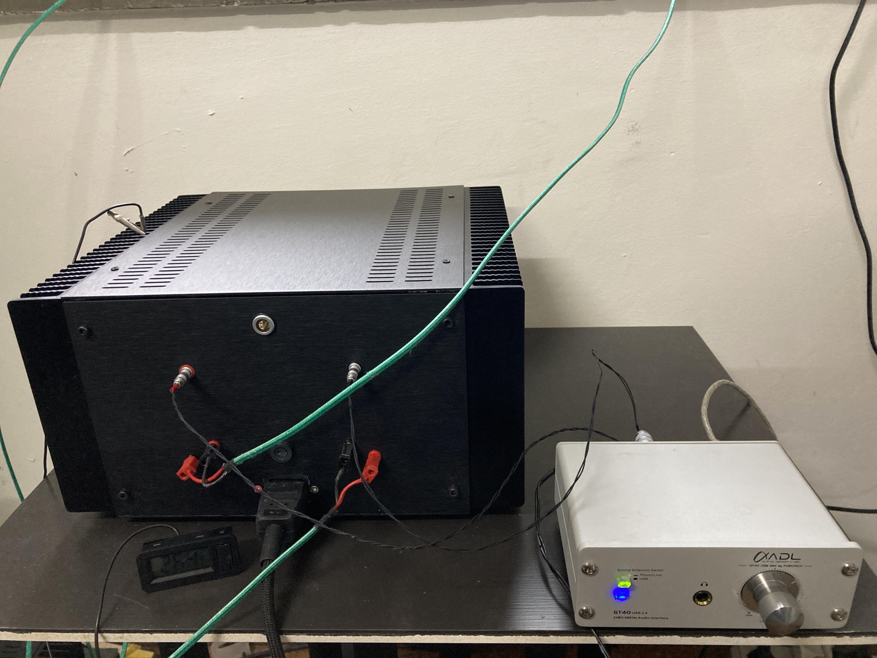

Here we go!
The almost last 5mm (make connectors) went very easily.
Plugged it in, and was a bit worried if everything would really be ok?
Nothing on power on, and then... a very strange new way of sound-impression coming out. I had a audiolab 8000C + P, a Onix 21, and a DCB1/ACA combo playing, and now its a furutech gt40 and that F4, which is warming up. I start to like it (30°C heatsink)...
Mr. Pass, 6L6, mighty ZM, Mooly, Dennis, 2Pico (bloody 😀), itsallinmyhead, and the ones I forgot, many many many thanks!

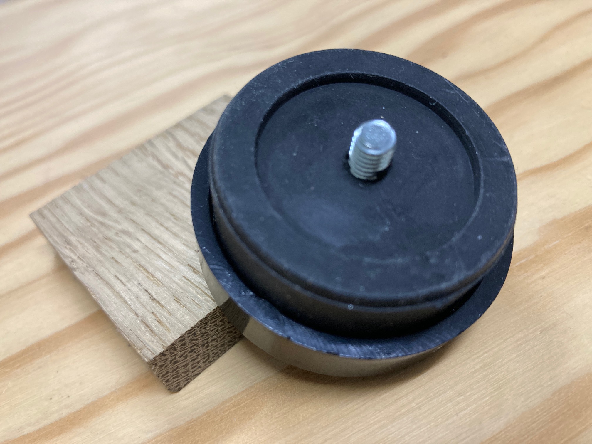

modushop‘s antivibration feet are bugging me, dont like the plastic and especially I‘m not convinced of the fact that they‘re supposed to be attached to the 2mm baseplate, it _will_ bend!

Bensing is not an issue if you out the feet close to the corners. Or like 6L6 did in his F4 guide. Haven’t tested that exact approach. But looked the part.

Looking up 6L6‘s way now. But the construction is a bit contrary to how static forces are applied. (I also don‘t quite agree with other details of the chassis construction, but won‘t complain, they‘re still really nice).
And, I believe that Jim‘s feet are different: Mine have the screws embedded in the rubber so there‘s no way to get to the steel-bracket (clamping the baseplate between foot and bracket is not an option)
