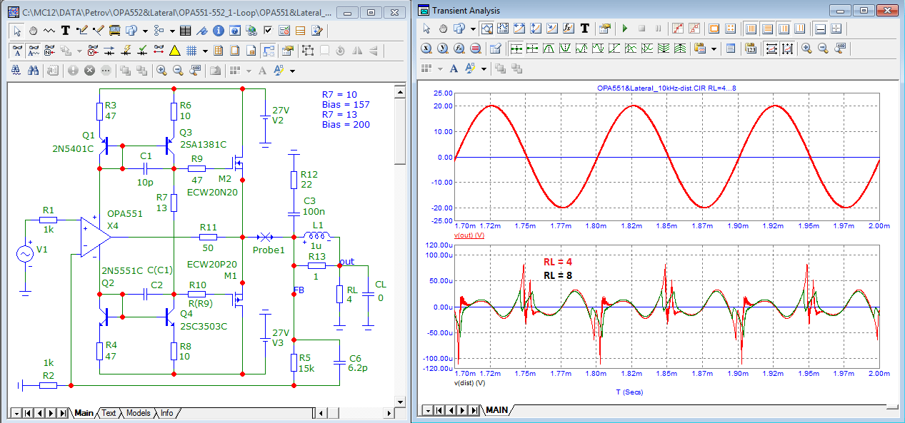

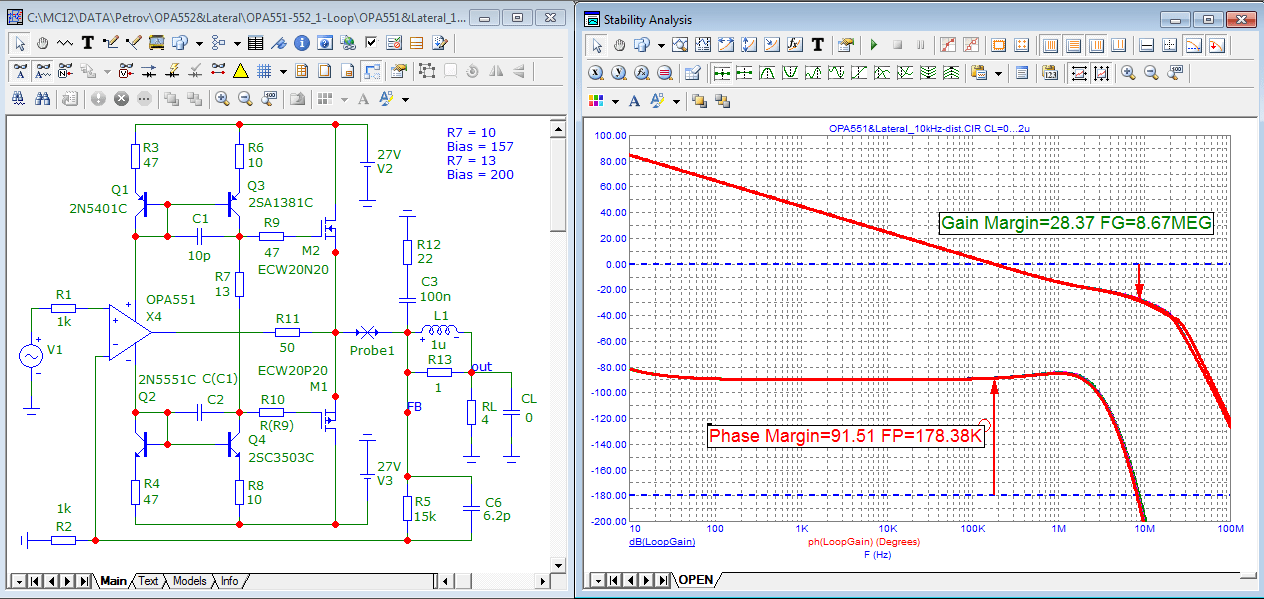

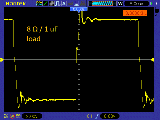

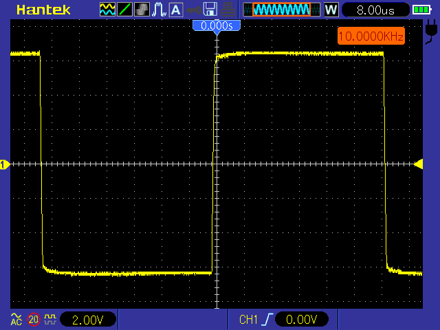

inserting two 10pF caps between the collectors of the two current mirrors, stability should be there for all loads.
That was a silver bullet. 😀
Using 10 pF at current mirrors and with no C6, C7, C11, only 33 pF C10, amplifier with OPA551 is stable. Zobel at output is mandatory, otherwise it will oscillate, never mind the load.
Most important is that it is stable with any capacitive load. So, great news, topology is valid for real conditions. Frequency response is some 700 kHz but it distorts waveform above 100 kHz. Likely, all problems can be ironed out.

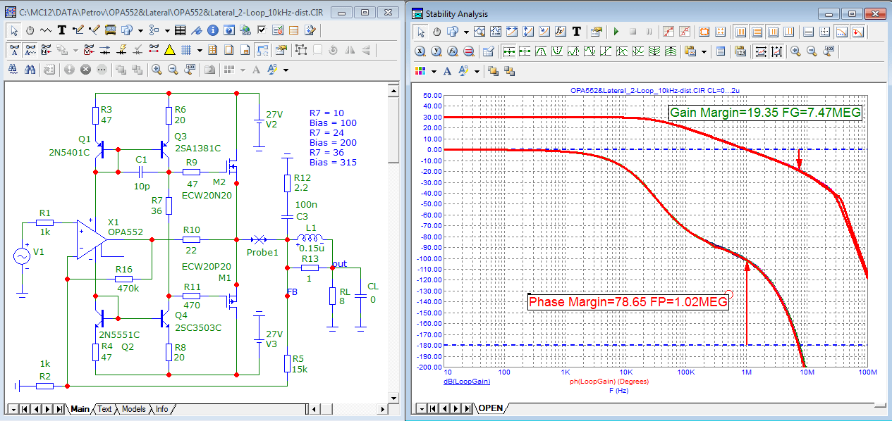

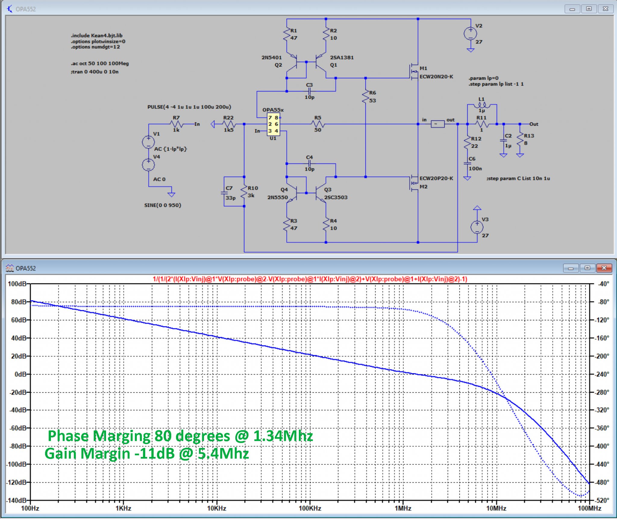

When plotting the loopgain with Tian's algorithm, overall stability is as good as it can be, but the oscillations between 15Mhz and 25Mhz are caused internally by the loop through the current mirrors and back to the opamp's output.

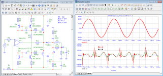

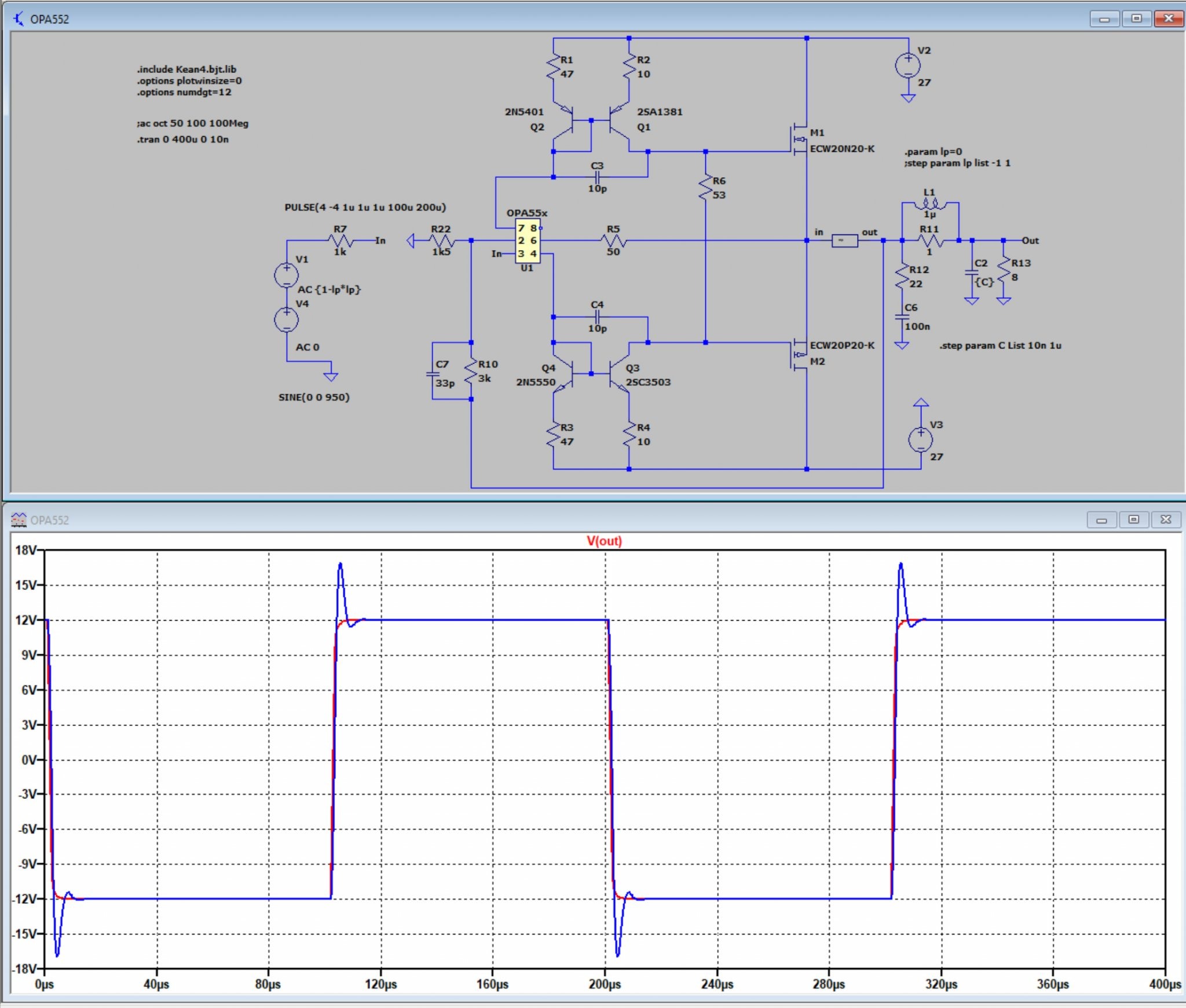

When using a 10Khz signal as you did with 1usec rise and fall time, LTSpice gives the response as below with re 10nF and 1uF // 8R.

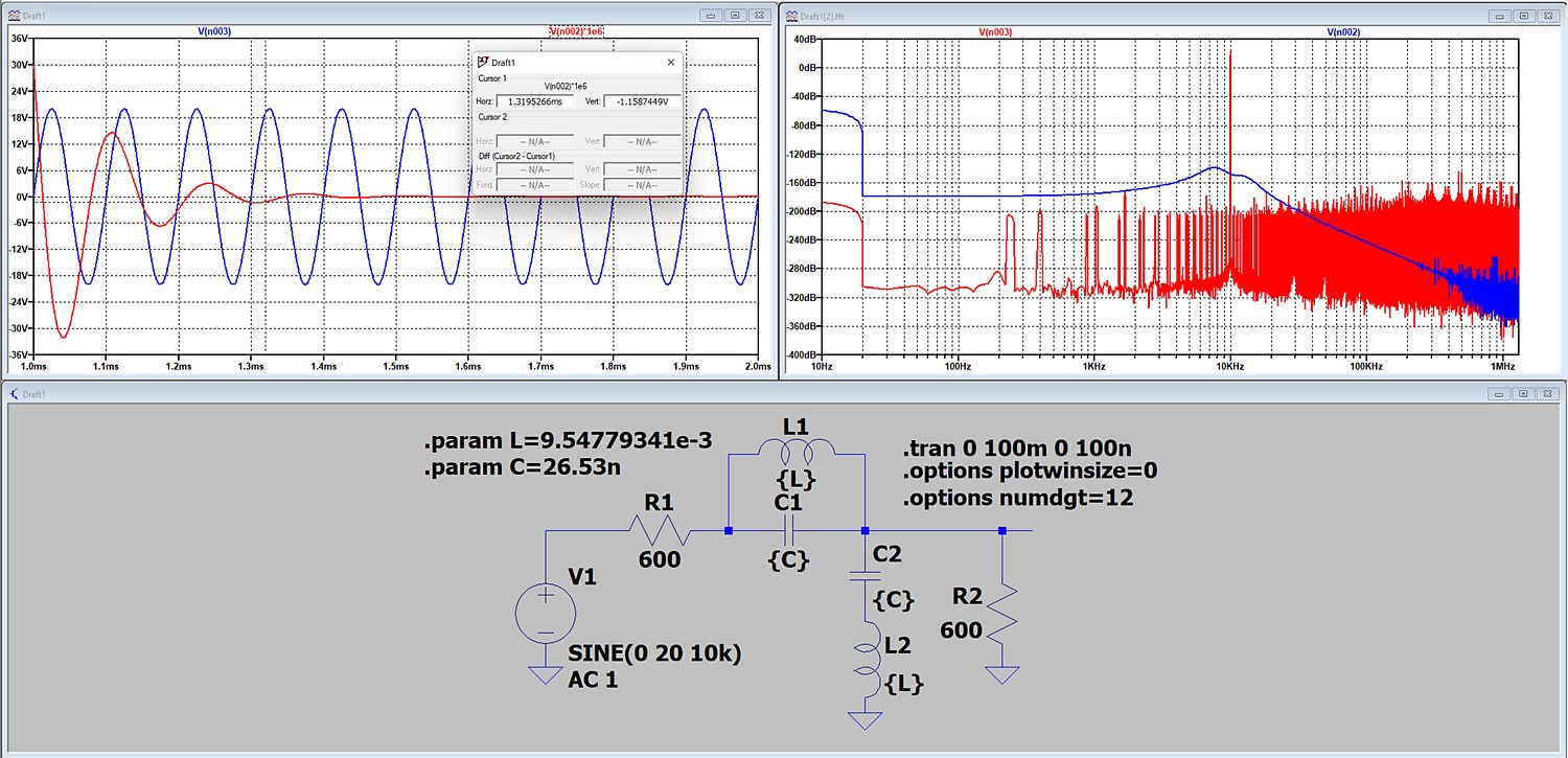

Just to show that you are chasing ghosts, I applied a 10Khz 20V peak signal to your LINEAR notch filter.
Since a linear filter doesn't produce distortion, this might be an opener for you.
The time signal in red and the output signal in blue, shown at the left plot, reveals that after 1.3msec output ringing, caused by the abrupt starting 10Khz burst, becomes below 1usec, that's it, nothing further to discover.
The spectrum shows that the output signal is completely free of harmonics as a prove that linear filters don't distort, so this discussion also closed.

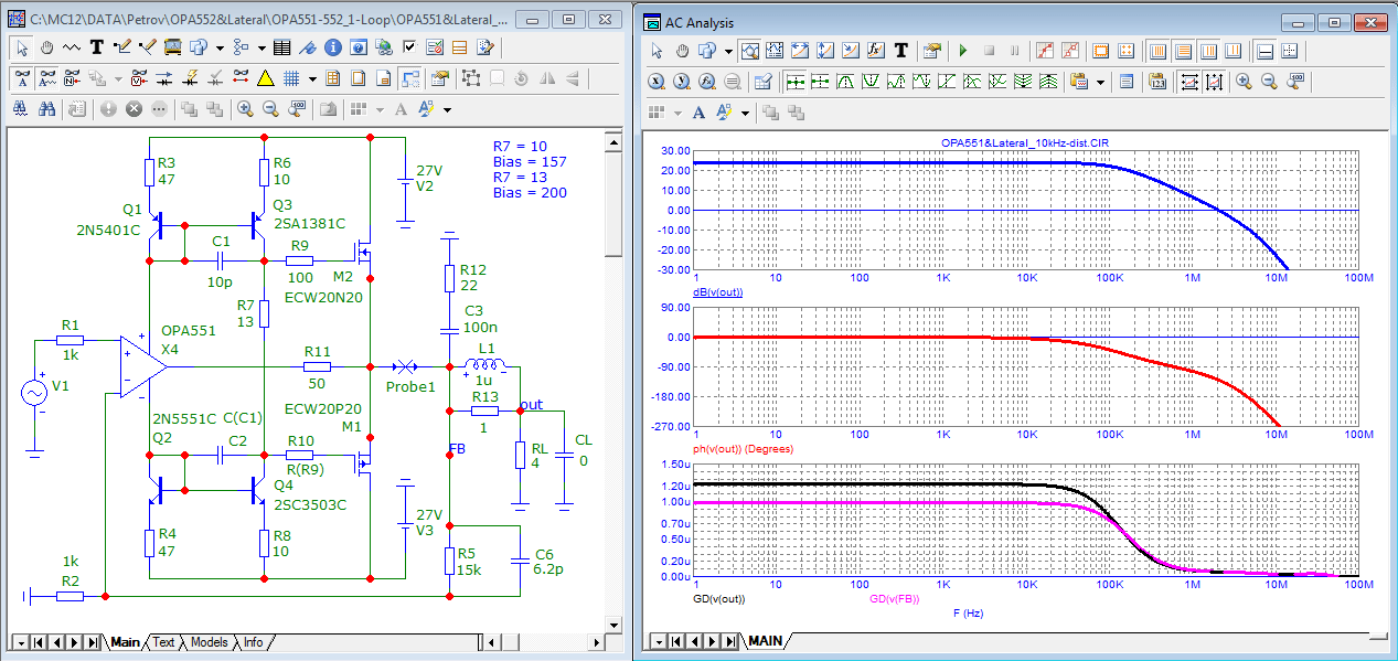

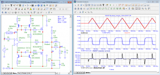

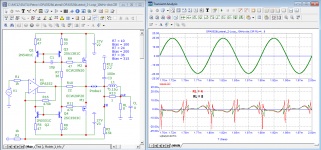

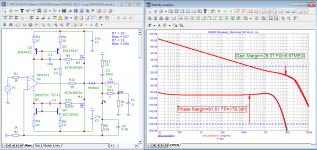

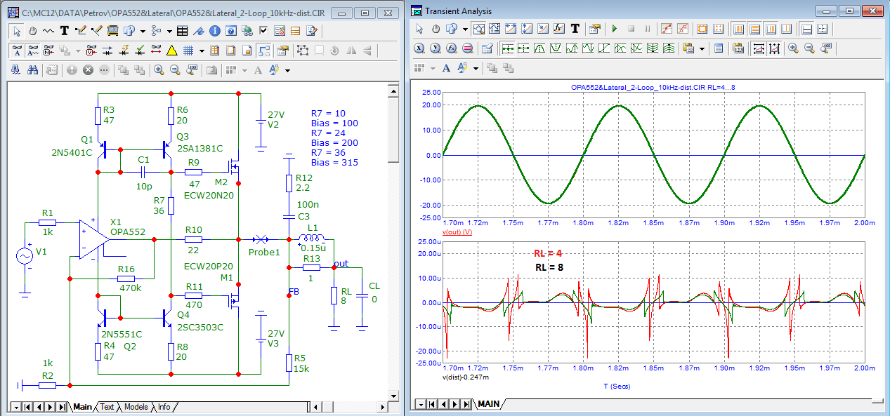

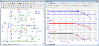

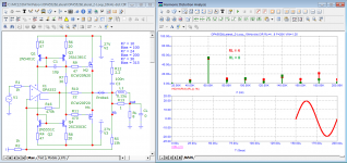

It's easier to type the model yourself and see how it works than to ask you to do something, just like and Bernhard.
For the amplifier model, the transistor models corrected by Bob Cordell are used.
The first two graphs are what I asked Bernhard to do.

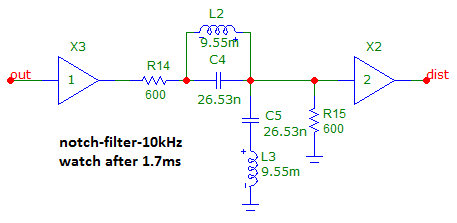

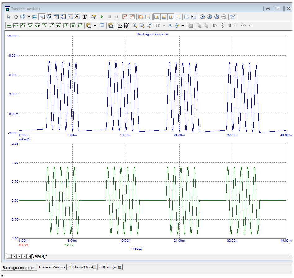

The third graph is the result of the test using a notch filter.

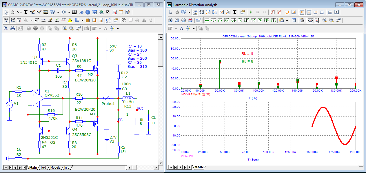

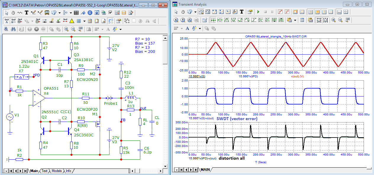

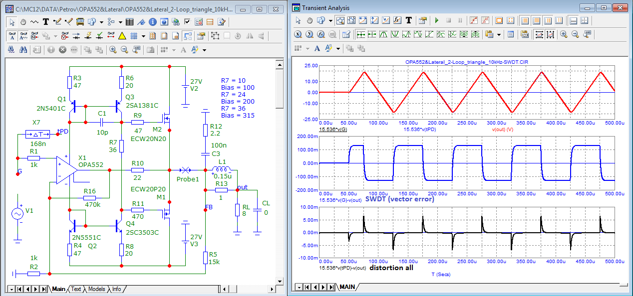

The fourth graph is the result of the test with a triangular signal.
Petr
p.s.
Parameters can be improved by using a different chip
O.K. There it is, your final confirmation that linear filters don't distort, this is a big step forward, because it eliminates the existence of "Vector" and "Speed" errors.
I suppose that with "measuring" you mean processing the incoming signal with the filter curve.
First and second image:
Opposite to what Aridace and Tombo did, you increased gain by a factor 10, making your curves incomparable with theirs, but anyhow be aware its just a new situation and what you are showing seems to be correct.
The third image:
Yes this image shows the real distortion after notching out the main frequency, very informative showing (rather harmless) H2 and (to be avoided) crossover distortion.
The fourth image:
Showing meaningless "Vector" errors and "Distortion all", the latter by subtracting a time delayed and gain multiplied input signal from the output signal.
What has been mentioned more than once, you use only one single time delay that is stable up to ca. 20Khz, but beyond 20Khz the time delay is changing, causing that you make a large time delay error for frequencies above 20kHz.
Look at your "Distortion all" curve and you will notice risetimes of at least 2,5usec, corresponding to a frequency of ca 1.5Mhz. where GD is no longer 1.2usec but a factor 10 times less, thus causing a huge error in your subtraction plot.
So, "Distortion all" just as "Speed errors" are meaningless plots having no relation to real distortion.
The only correct plot in this series showing distortion is the third image.
Hans

Hans, if you want to understand what high-speed distortions are, carefully re-read the material that I posted.
I repeat once again, the notch filter can only highlight what the amplifier added to the sinusoidal signal in steady state: harmonics, switching distortion. No wonder we look after 17 periods of the signal, so you yourself saw it is useless to watch before 13 periods. Any THD meter works the same way!
The notch filter cannot pick out what the real signal is losing. After all, the real signal is more like a pulse signal than a sinusoidal one. Negative feedback works by comparing the input signal with the delayed signal from the output of the amplifier.
The subtraction of the input and delayed sinusoidal signals from the output of the amplifier does not lead to additional distortion, since there is always a tail of the sinusoid of the previous period. There is no such tail in real signals! - this is what we see at the beginning and end of the burst, with changes in the amplitude of the signal, with changes in its frequency, at the tops of the triangular signal.
Only the compensation method of measuring distortion allows you to measure what the signal loses. Losses of a signal also are high-speed distortions (losses).
