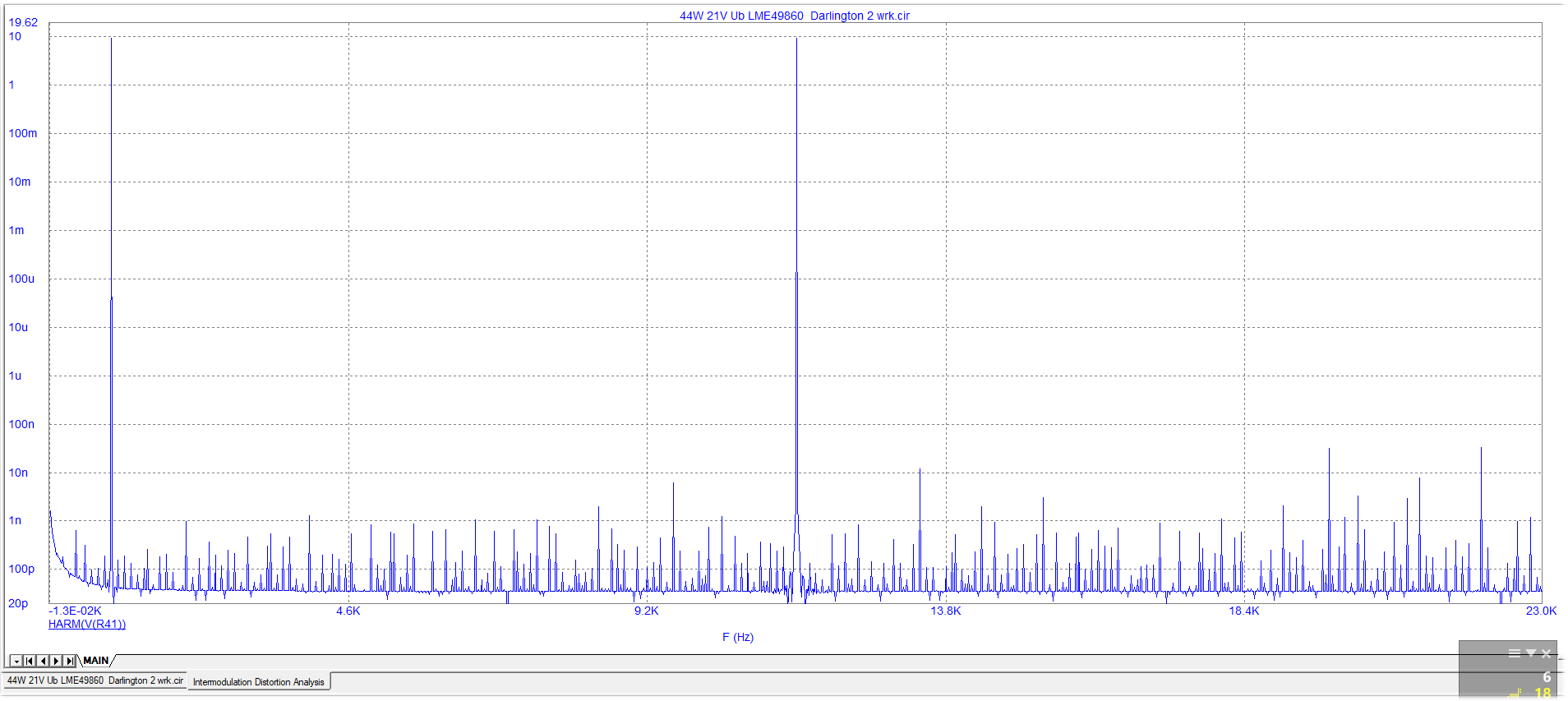

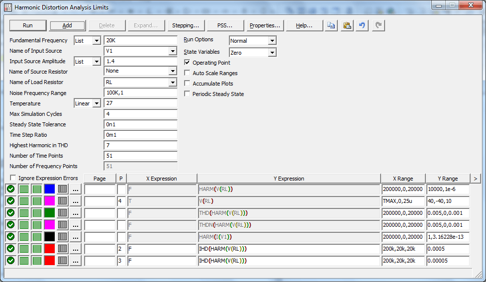

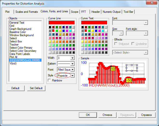

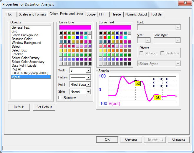

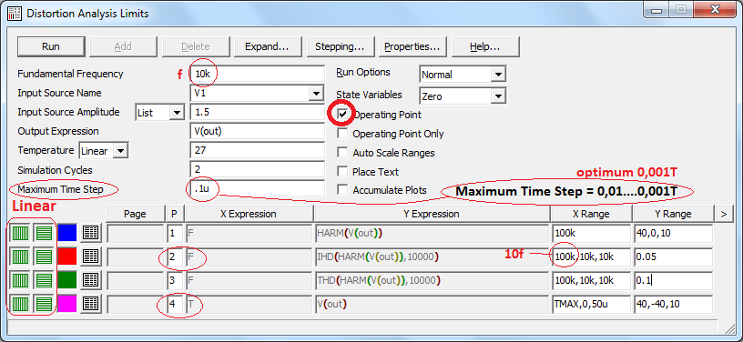

Simulators use sinusoidal signals to measure distortion. At the output of the tested amplifier models, distortions are added in the form of harmonic components that are multiples of the fundamental frequency: 2f, 3f, 4f, 5f, ....nf.
The 9th version of Micro-Cap is completely self-sufficient and largely automated, the levels of harmonic components (IHD) are displayed in% by default, as is customary to give in the specifications.
To measure the distortion spectrum, it is enough to leave lines 2 and 4.
The settings for displaying on a chart are given in the properties windows.
The total THD at a frequency of 1 kHz is of little interest to me personally, it is much more important to look at the distribution of spectral components at least up to the 10th harmonic.
To see the dependence of the spectrum on the output voltage level, it is enough to set the input voltage in the stepping mode.
To see the dependence of the spectrum on the load impedance, it is enough to set the limits of load change in the stepping mode.
To display the spectrum of harmonics in the 12th version, you have to enter an additional line for IHD.
Using a few additional lines, you can see the spectrum in a stretched form.

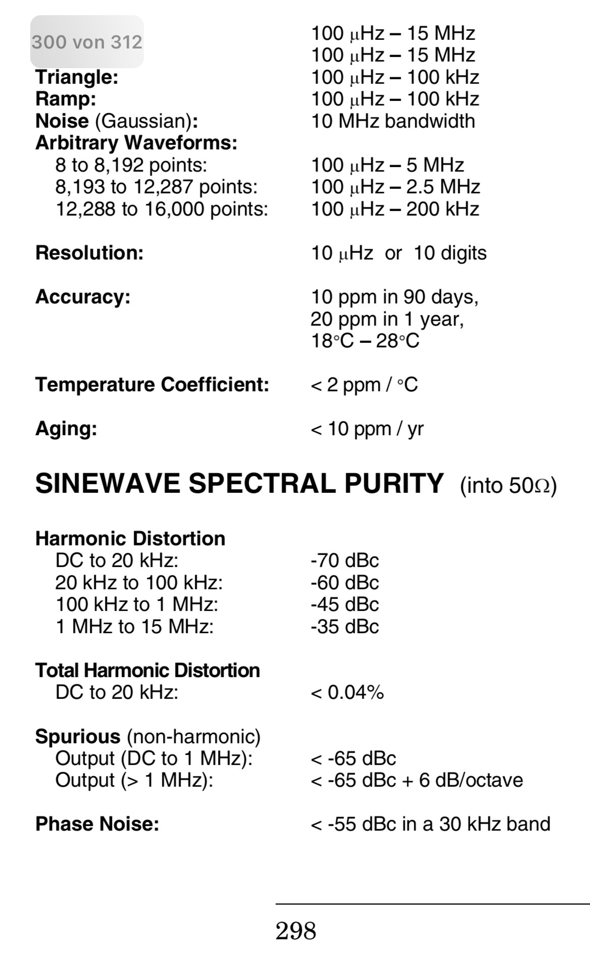

How do you generate that 10 kHz burst to test your amplifier ? Not in sim. In real world.
Let me guess... No answer. As expected.

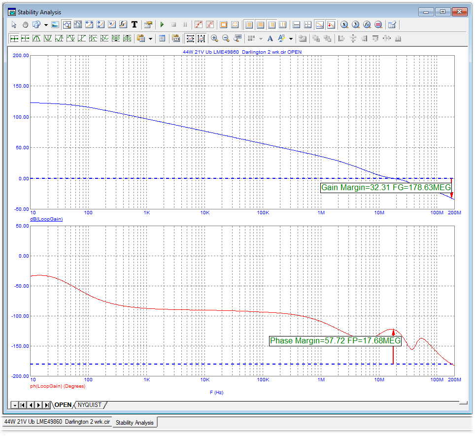

Well, now it's your turn, finally present the Bode and loop gain plots. Alnikst even told you how to do it.
Otherwise, it is not clear why you came to this thread, maybe you wanted to say something? Dialogue fails. LOL - this is not a dialogue. There are plenty of laughers like that even without you. 🙂

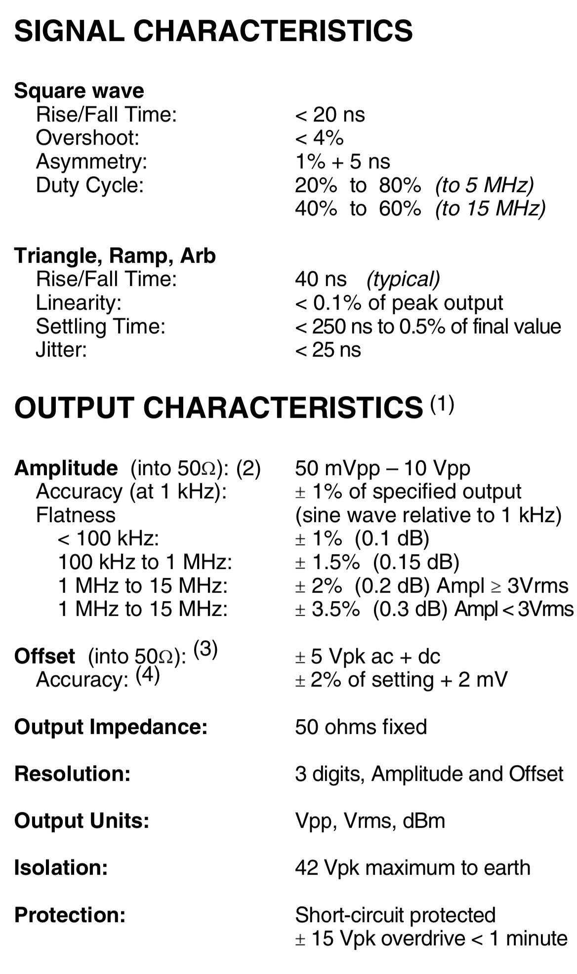

No.Bernhard, I hope you are satisfied with this answer about bursts?
Remember: First you came up with the AP that has only 96 kHz, far from your infinity.
Look at the specs of your 12 bit Agilent.
Where is the infinite bandwidth?
And where does the infinite bandwidth? instead of answering the questions that you are asked (Bode plot and loop gain plot), you once again drive diarrhea of wordsNo.

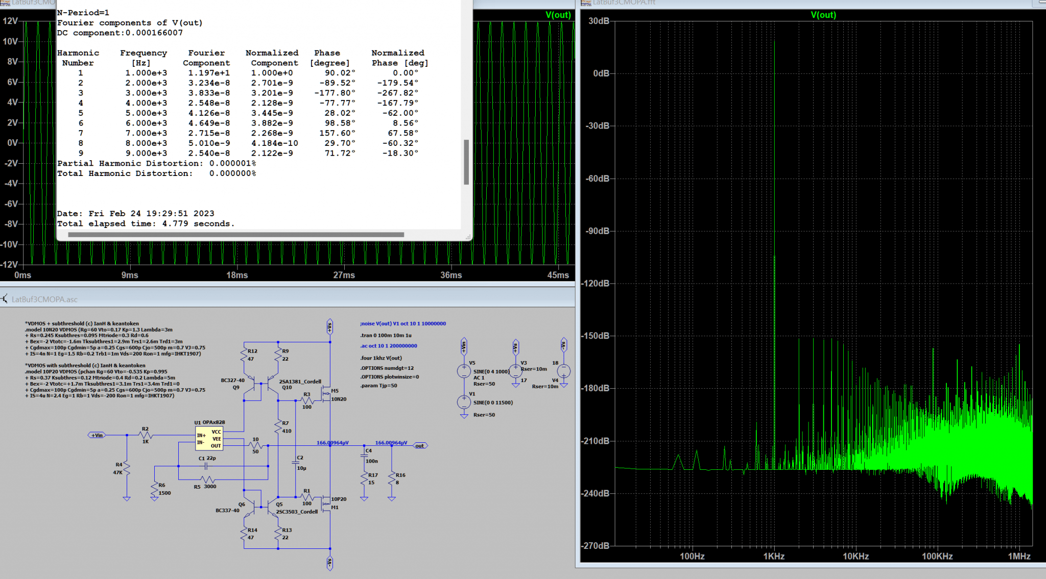

Amplifier topology from post #1147 yields great results in simulations. Even with LTSpice, if output stage operates in A class, I can get several ppb distortion just before clipping. Result is 60 dB better than using the same components in standard composite amplifier topology. In simulation, amplifier is stable without C6, C7 and C11.
As my amplifier at the bench was output stage enclosed in opamp feedback, it was not too hard to rearrange components on the breadboard.
What I was afraid of, happened. Amplifier is very unstable and oscillates even with very large C10 (330p) and C11 as specified. Though, I used noninverting configuration but that shouldn’t matter.
I don’t see a point in endless chasing of low distortion numbers with just theoretical topology, not confirmed in practice. It may work with some tweaking but that can be done only in practice.
Those same components, arranged as a classic composite amplifier, provide rock stable performance with any capacitive load, 1.7 MHz power bandwidth, 200 ns rise time and distortion in range of -110 to -130 dB (full power/1W). I would very like your topology to work stable but if not, what I have is acceptable as well. 🙂

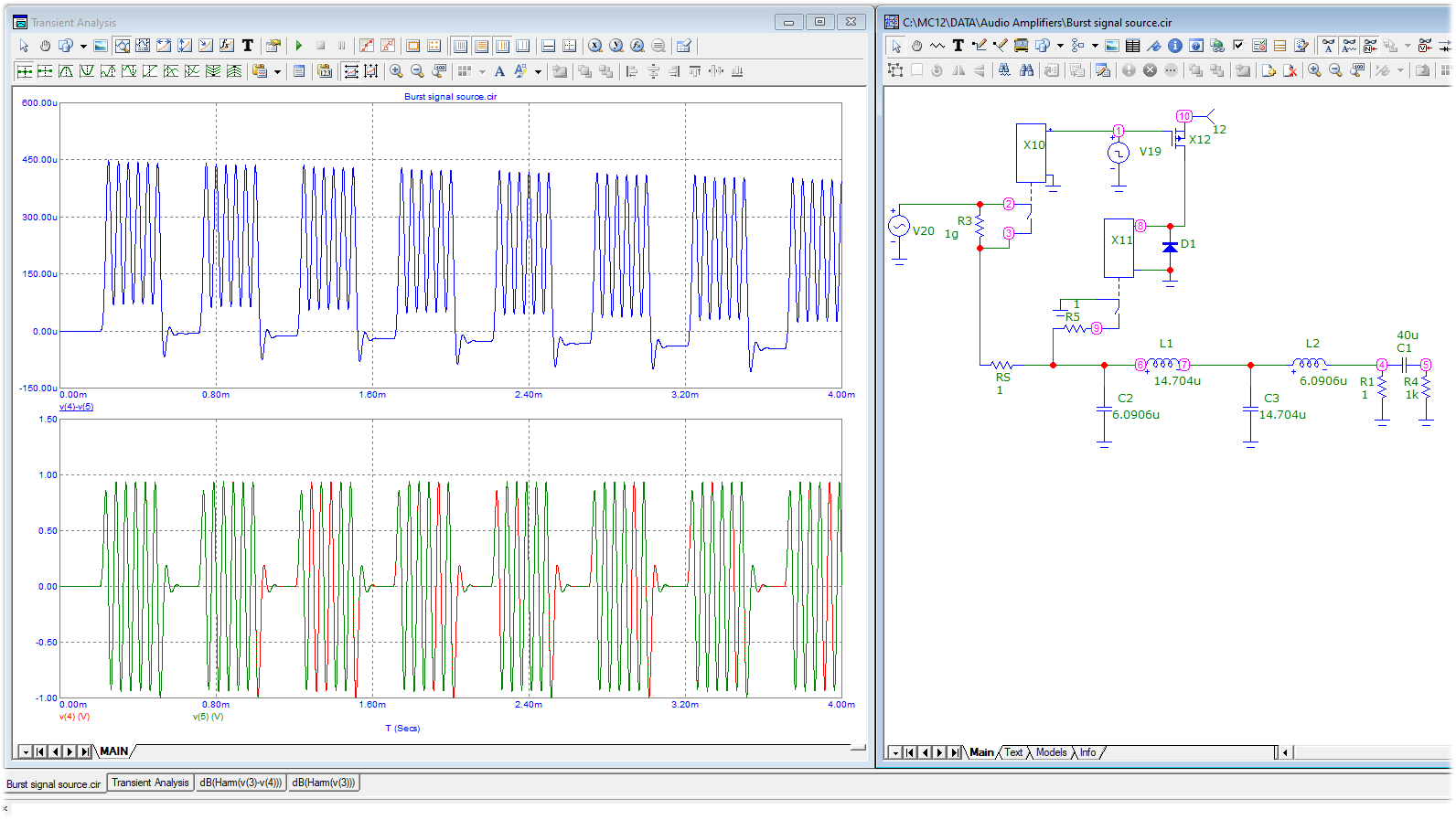

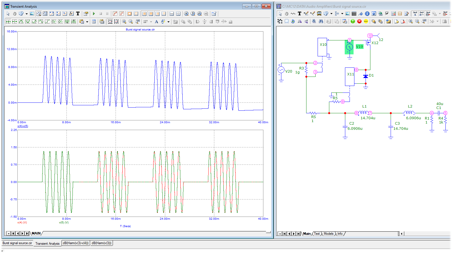

When you create signal generator in a simulator to simulate a DUT, you should also place a LP filter on the output of said generator in order to represent a situation as it would appear in reality - otherwise you will have a pulse start that is not possible in the real world and hence, a non valid simulation. You decide what the filter fo should be and of course describe why the choose value was selected.
