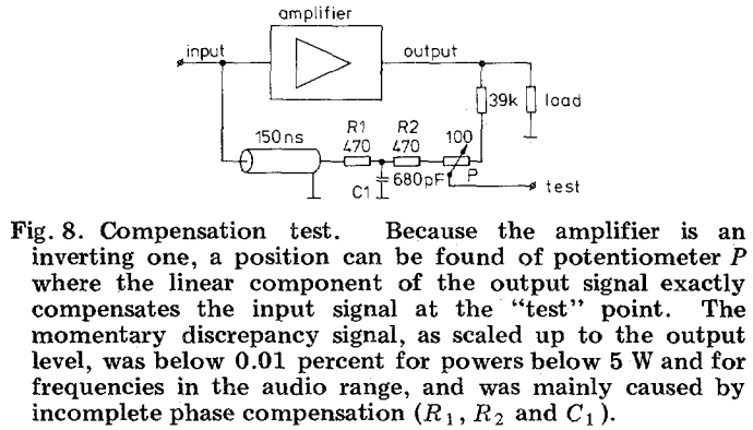

Is there a simple clear explanation and diagram showing how to measure distortion using the compensation method? Its a term I had never seen in the last 50 years of designing and measuring audio. Perhaps I understand it as a different term?

This method of measuring distortion was defended by Sapozhkov in 1956 with his doctoral dissertation.
However, for its correct application, the delay line and the comparison circuit (adder) must be ideal.
Today, anyone who understands the essence can use this method in the simulator.

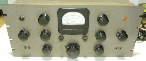

As I thought, different terminology. The basic principle was used in RCA distortion analyzers from the 1930's:
And in more recent designs like the Cordell distortion magnifier use the same principle.

Demian, this is exactly where Petr goes wrong for two reasons: 1) by comparing the output of an amp with an input signal with a BW that is by far exceeding the amp’s BW and 2) by neglecting the amp’s frequency dependent GD.Just model a bandpass filter that matches a typical amp. in fact that would be a more appropriate reference path than a simple phase shift + delay. You should also be able to easily figure out what the requirements would be for a bandlimited source to have no "speed" distortion.
When subtracting signals, the only correct way would be to feed any appropriate signal to a distortion free bandpass filter with the exact BW and GD properties as from the DUT and compare its output to the DUT’s output.

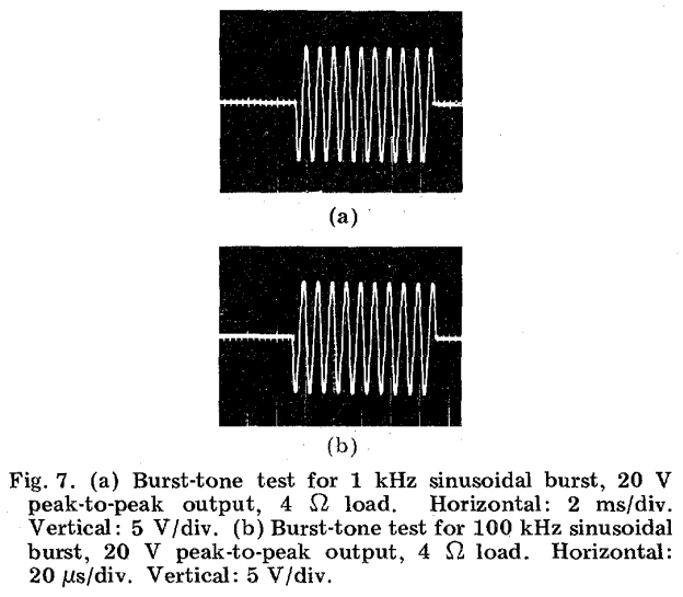

How many times did I ask the “theorists” to take a burst from one period of a signal of any frequency in the audio range, pass it through a first-order low-pass filter of 100 kHz and show a section with a “cosmic slew rate”. I usually use 10kHz for both sine burst and triangular waveform.
So far, no "theorist" (or guru) has provided the result of such measurements.
It is done very simply, a triangle is selected in a suspicious area using a tangent to the signal (hypotenuse) and two legs (horizontal and vertical) so that dV / dt can be calculated.
Let me remind you that the slew rate SR is related to the total power bandwidth of the amplifier by the formula:
SR = 2πfmVm
