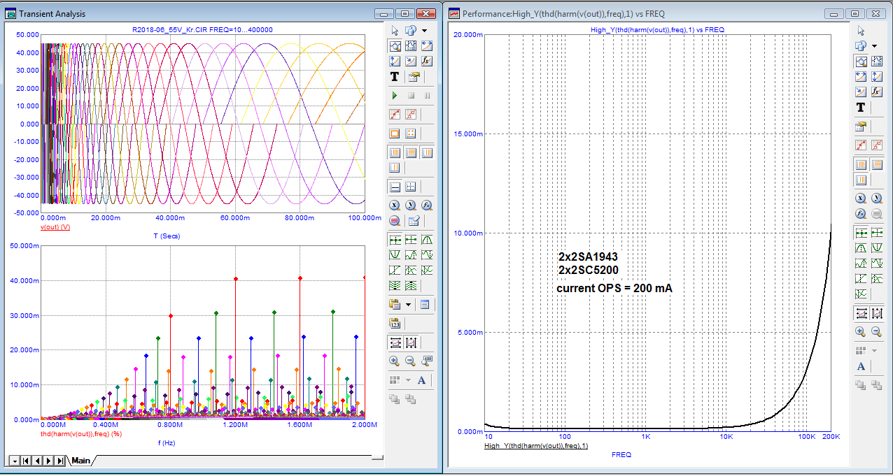

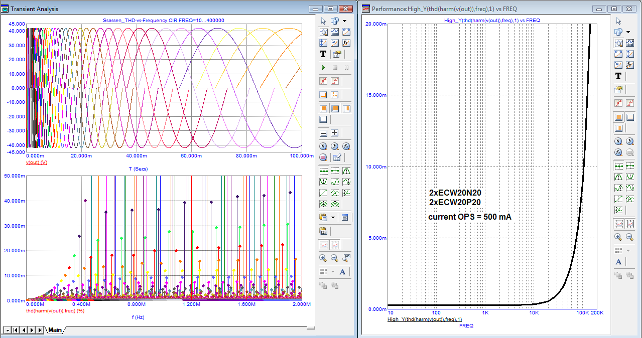

Here are three amplifiers with comparable parameters
????? ?? ??????? ????????? ?? AD844
in my amplifier (R2018-06) increased the supply voltage to + -55 V

This is not the first time I have presented the measurement results in this form and so far no one has asked questions, I thought that everyone understands

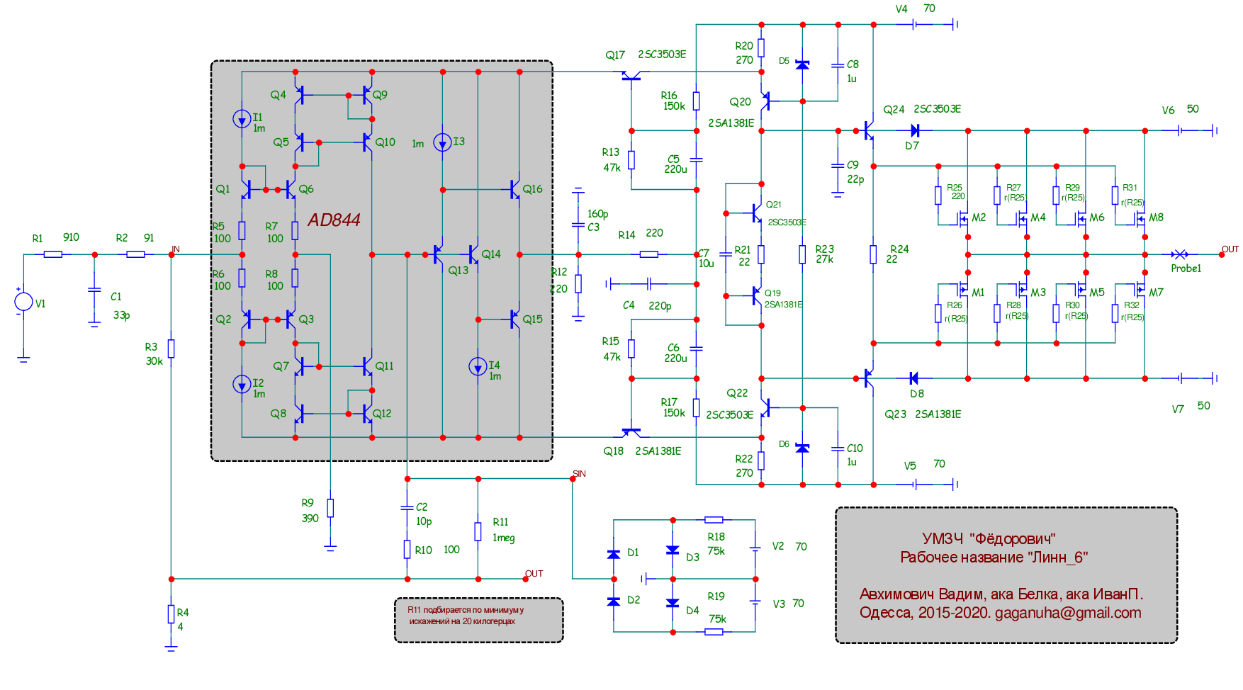

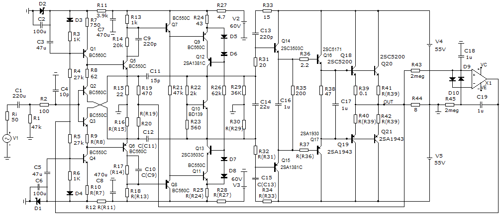

The circuit of my amplifier is published in the Russian magazine Radio 2018-06
Unlike the original, I increased the power supply to conduct tests under the same conditions

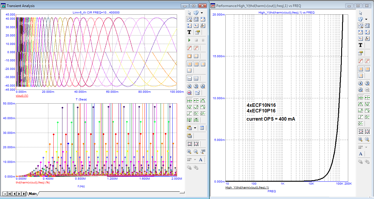

Presented graphs - dependence of THD on frequency
On the left side, the spectra of harmonics are shown when sinusoidal signals are applied to the input, starting from a frequency of 400 kHz and further with each step, the frequency decreases by 10%.
Rendering ends at a frequency of 10 Hz.
The right side shows THD in% for signals from 10 Hz to 200 kHz
the third graph is the graph of the circuit discussed here

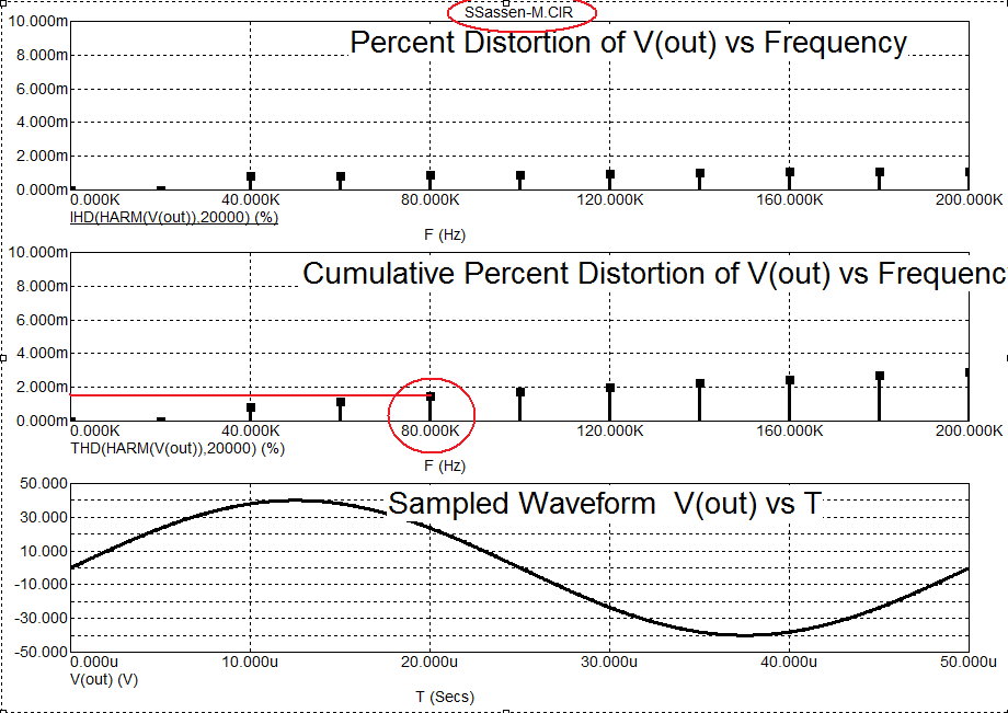

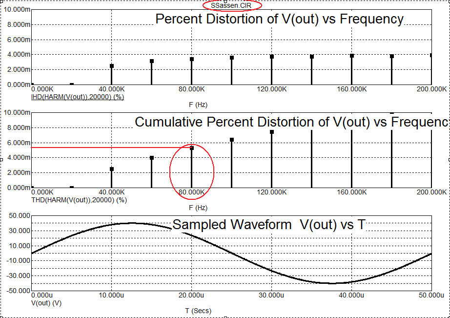

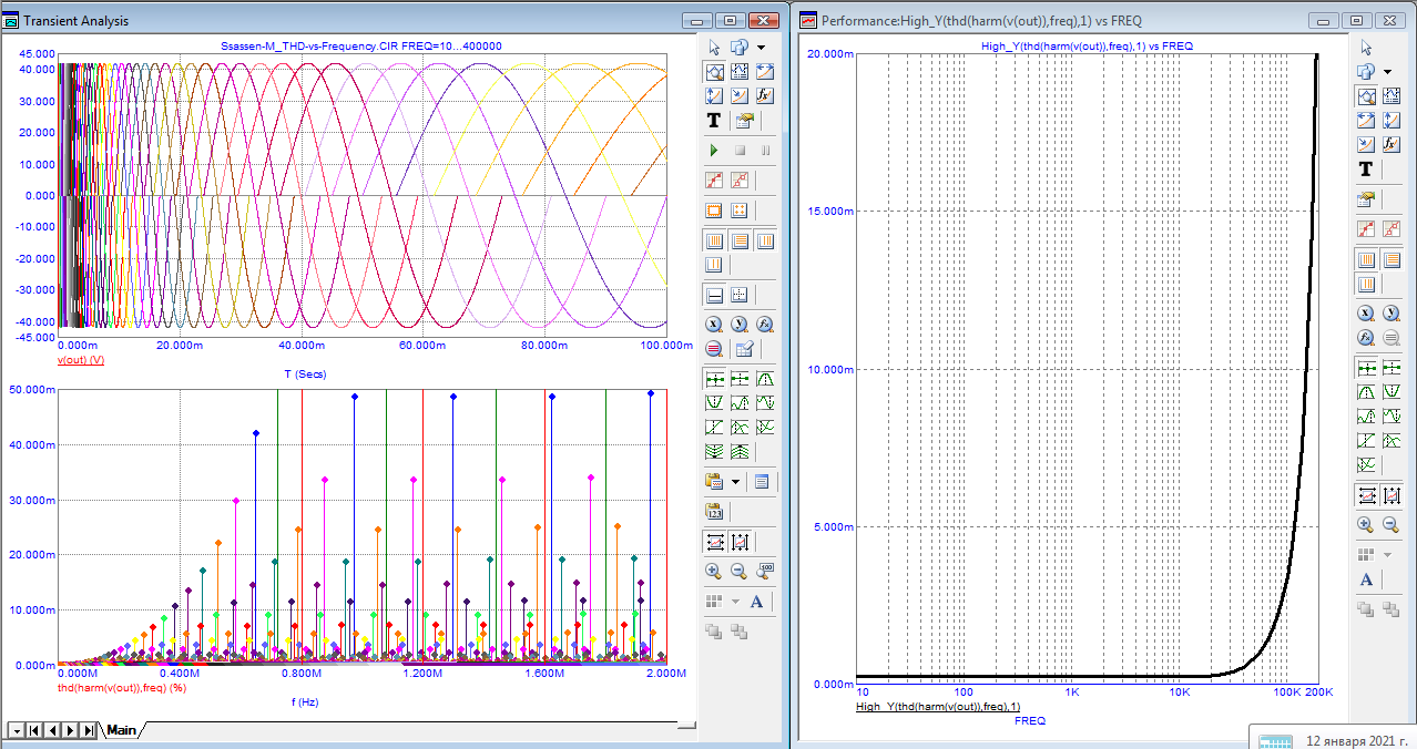

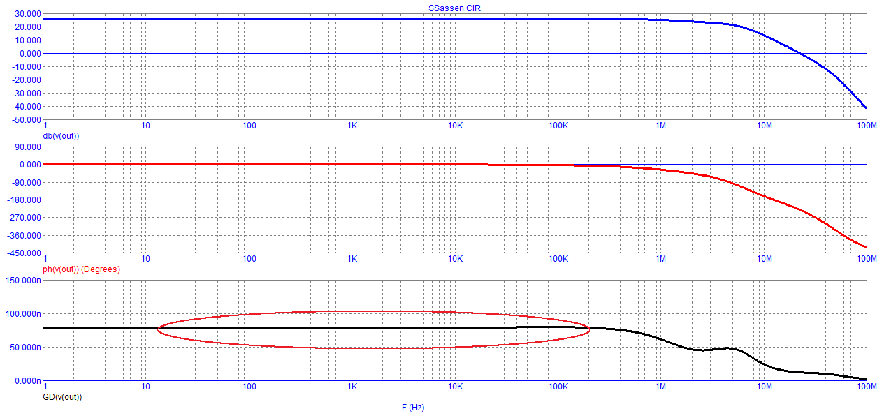

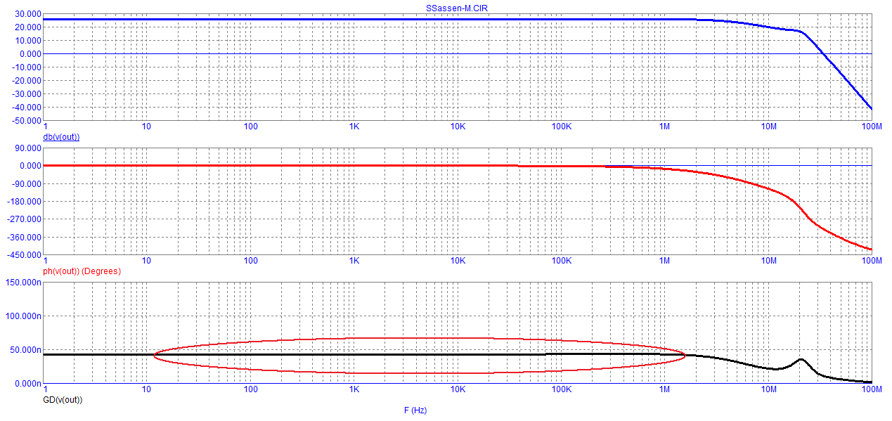

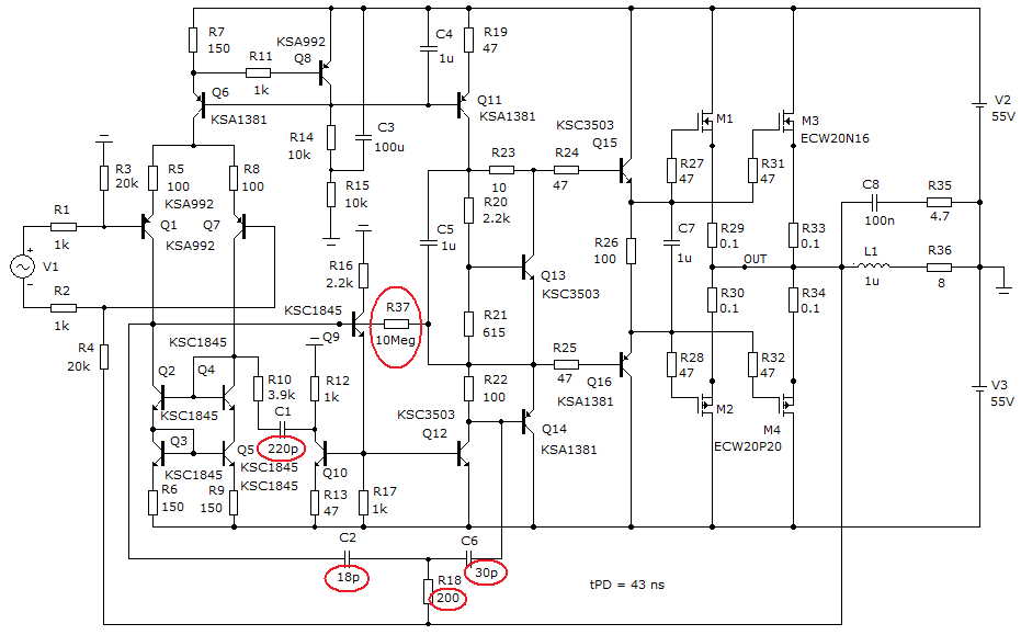

Ssassen, the parameters of your amplifier meet the requirements of the reference amplifiers:
The delay time of the signal passage does not exceed 100 ns
Group Delay constantly from fractions of Hertz to 200 kHz
Without changing the operating modes of the amplification stages, I changed the values of the correcting circuits
Time Propagation delay reduced to 43 ns (approximately 2 times)
The duration of the Group Delay was extended by an order of magnitude
see pictures

Petr-2009,
Could you please explain first of all the benefit of reducing propagation from 100ns to 43ns up to 200Khz, that’s 0.3 degrees at 20Khz.
I don’t get it.
Hans
Compare the results of two tests with each other
If you don't see the difference, then I won't help you.
I'm not going to overpersuade or convince those who believe that the time Propagation Delay does not affect anything, just walk by your own way.
By the way, in Graham amplifiers, the time Propagation Delay is about 30 ns; therefore, the introduced distortions do not depend on the measurement period.
In another branch, I showed by the example of a composite in which tPD = 1.5 μs and distortion in the steady-state mode 0.000000005%, and in the first period 0.8%
At the same time, in the Graham amplifier, due to the low signal transmission delay, distortions are equally small at any period.

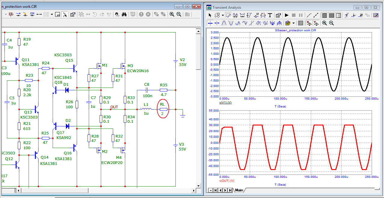

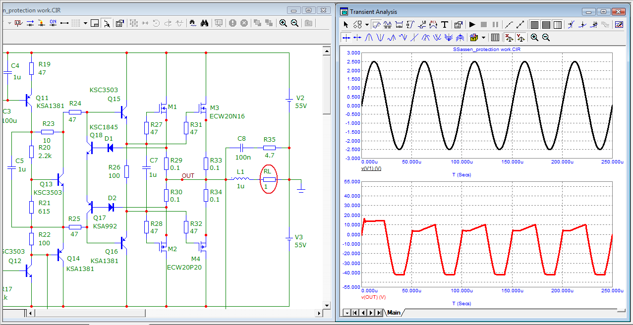

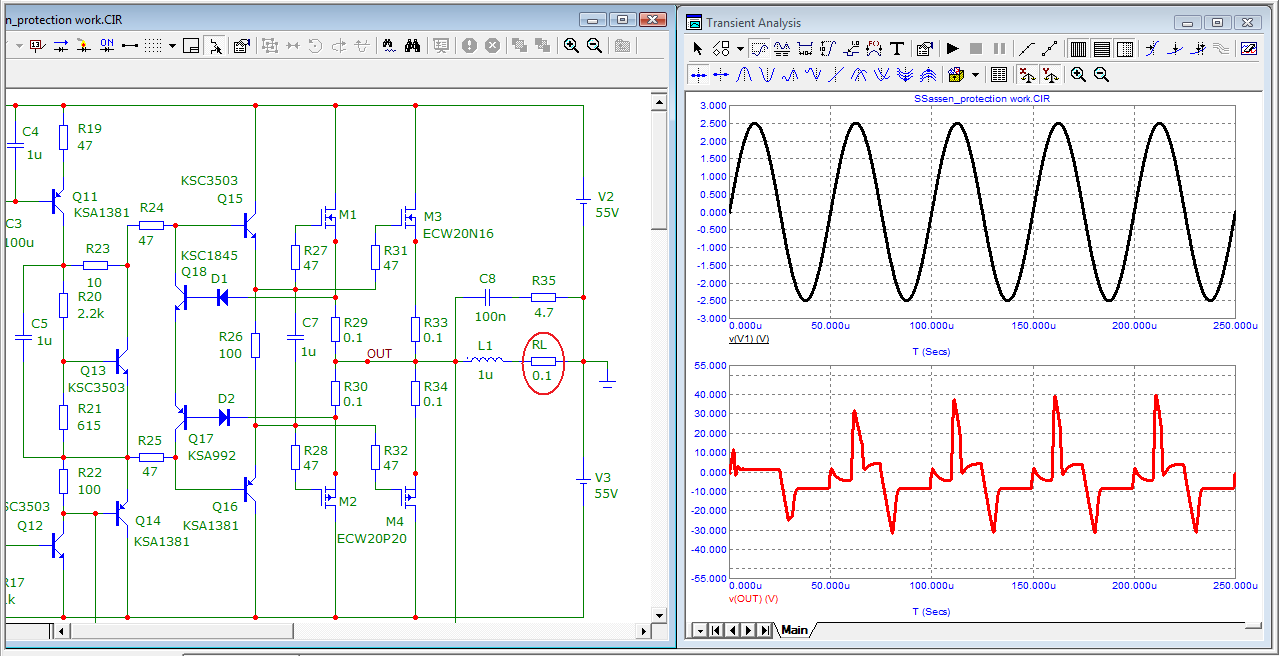

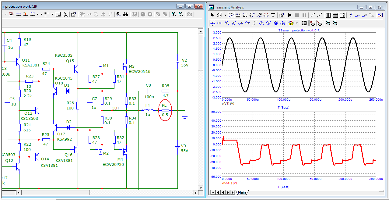

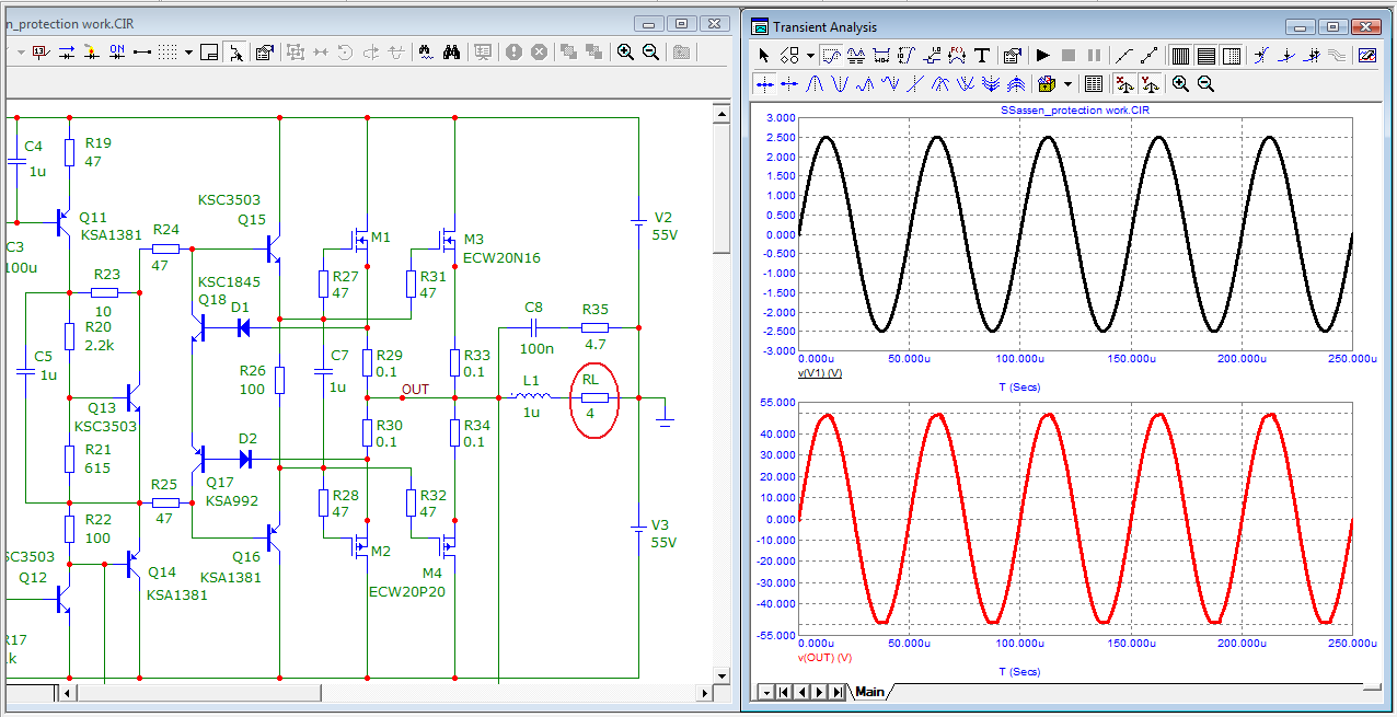

check the effectiveness of the protection
according to the graphs, it is easy to calculate at what currents the limitation occurs
in the event of a short circuit in the load, the protection circuit will perform its function

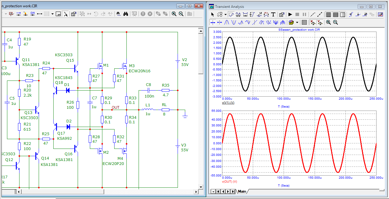

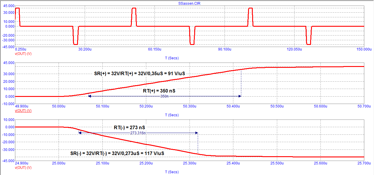

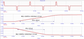

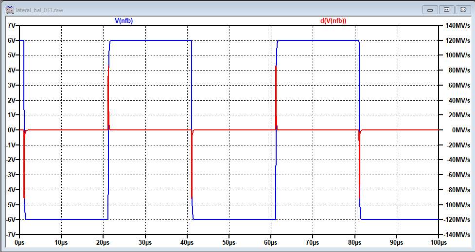

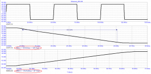

single-ended voltage amplifier, hence the slew rate of the output voltage is asymmetric
And as for Graham's "nonsense", so it is confirmed in practice
Since nobody reacts, I could not resist to do so.
Yes, what you say is nonsense for several reasons:
1) We are looking at an audio amp.
At 20Khz@100Watt in 8R, which is insane, slew rate is 5V/usec.
So taking a safety margin of a factor 2 brings us to a minimum requirement of 10V/usec.
2) Feeding the amp with a 0.1usec rise/fall square wave, up to an output signal of +/-6Volt, this amp is producing a perfect symmetrical slew rate of an almost perfect 90V/usec, see image below.
Hans
