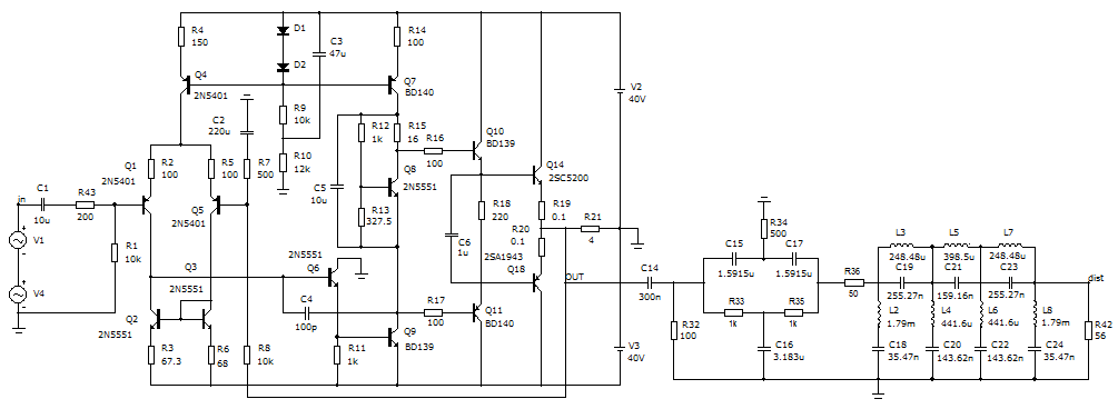

here is a simplified version of the amplifier
The GEM amplifier
The GEM amplifier

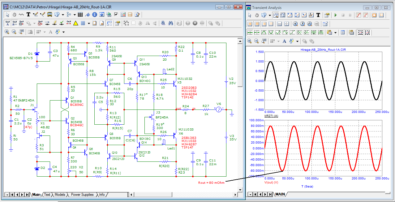

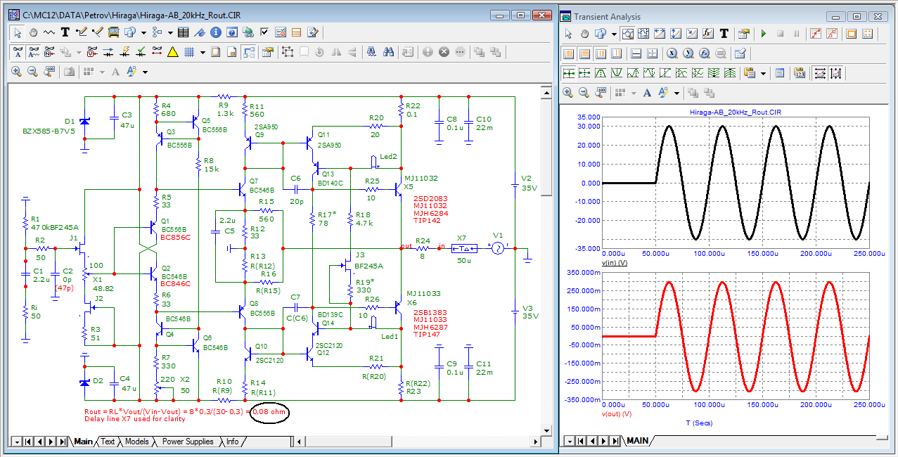

Measuring the output impedance of an amplifier
In practice, three methods are used:
1. The simplest and most commonly used method is as follows.
Measure the voltage at the output at no load Vno_load (no load Rl) and at the load Vl. Then the output impedance is calculated using the formula: Rout = Rl*(Vno_load - Vl) / Vl
2. The second method is convenient for use in simulators.
Short the amplifier input to ground. The output of the amplifier is supplied with alternating current of the frequency at which we want to measure the output impedance. If you apply a current of 1 Ampere, then the output voltage will be equal to the output impedance in ohms. A 1000 V voltage source and a 1 kΩ resistor can be used as a 1 A current generator. Delay line X7 used for clarity
3.The third method is often used in both hardware and simulators. As in the second method, the amplifier input is shorted to ground. At the output of the amplifier, between the load (Rl = 8 ohm) and ground, a voltage source is switched on with an amplitude of approximately ¾ of the supply voltage and the voltage at the output of the amplifier is measured. When measuring real amplifiers, use the second channel of the stereo amplifier. The output impedance is calculated using the formula: Rout = Rl * Vout / (Vin-Vout)
Of the three methods, in my opinion the most useful and informative is the third method. Observation of the voltage at the output of the amplifier together with the generator signal is done using a two-channel oscilloscope.

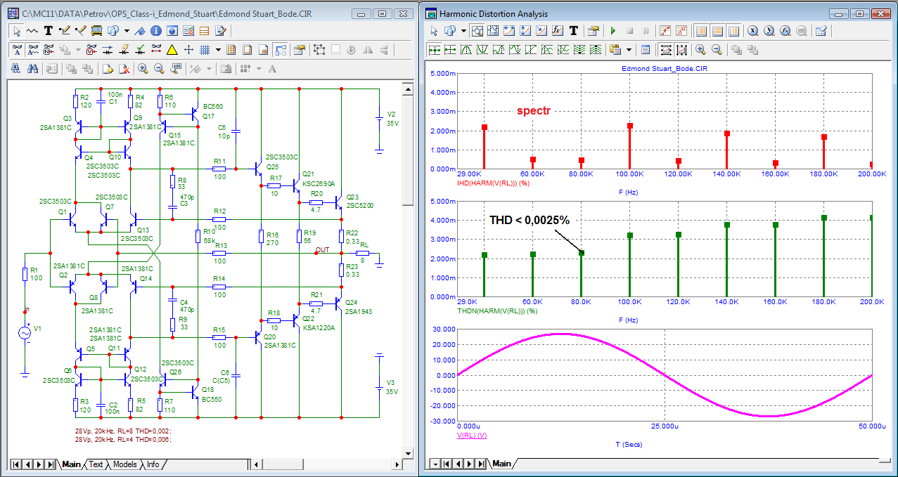

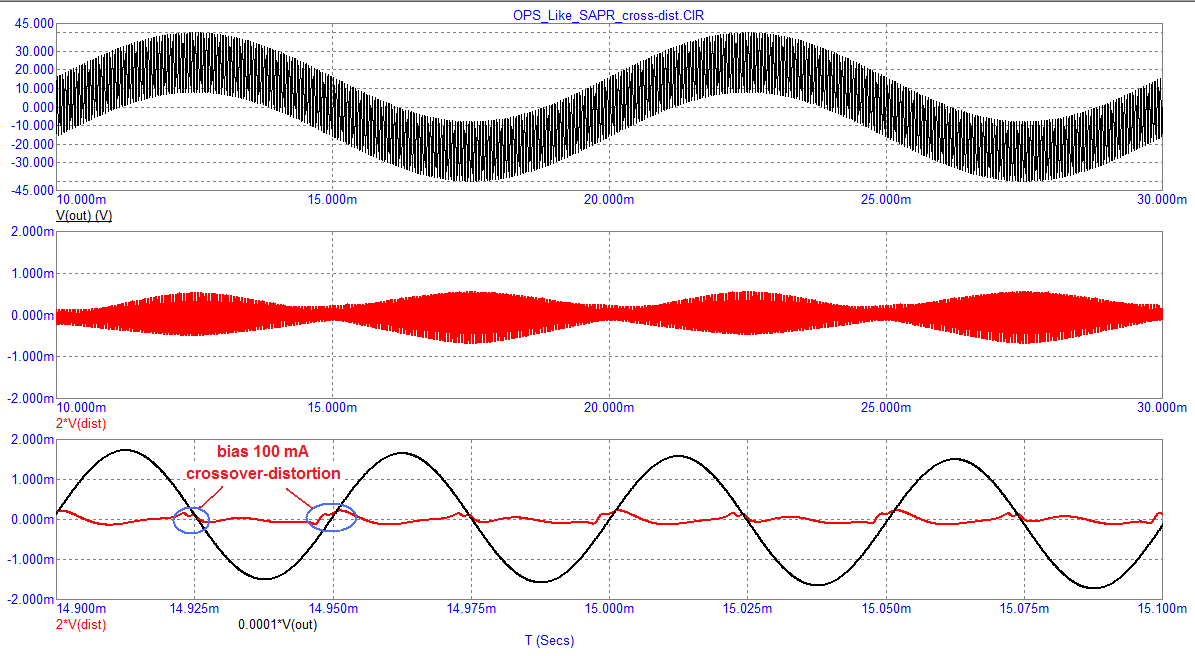

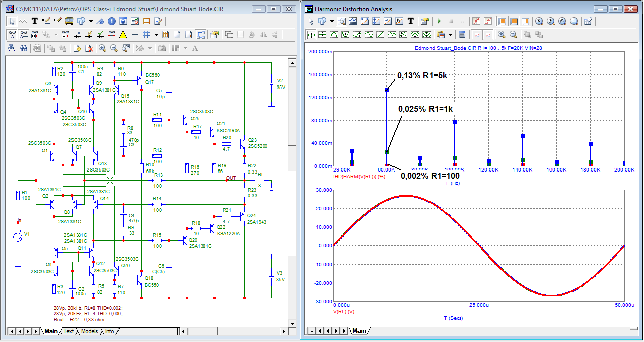

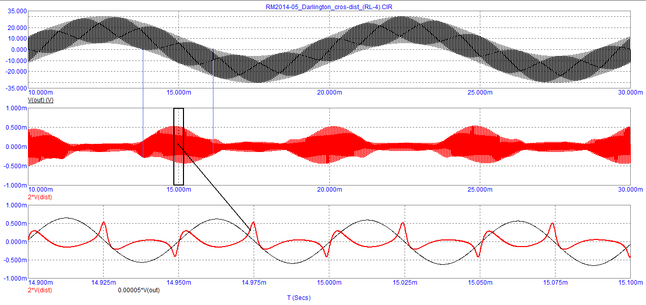

Let's check the parameters of one of these solutions
Class i and siblings
Patent US4595883
https://www.edn.com/the-class-i-low-distortion-audio-output-stage-part-3/

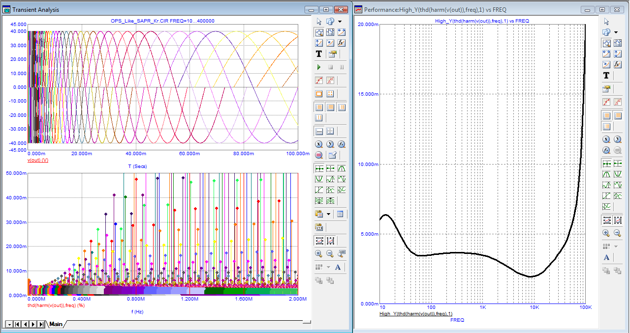

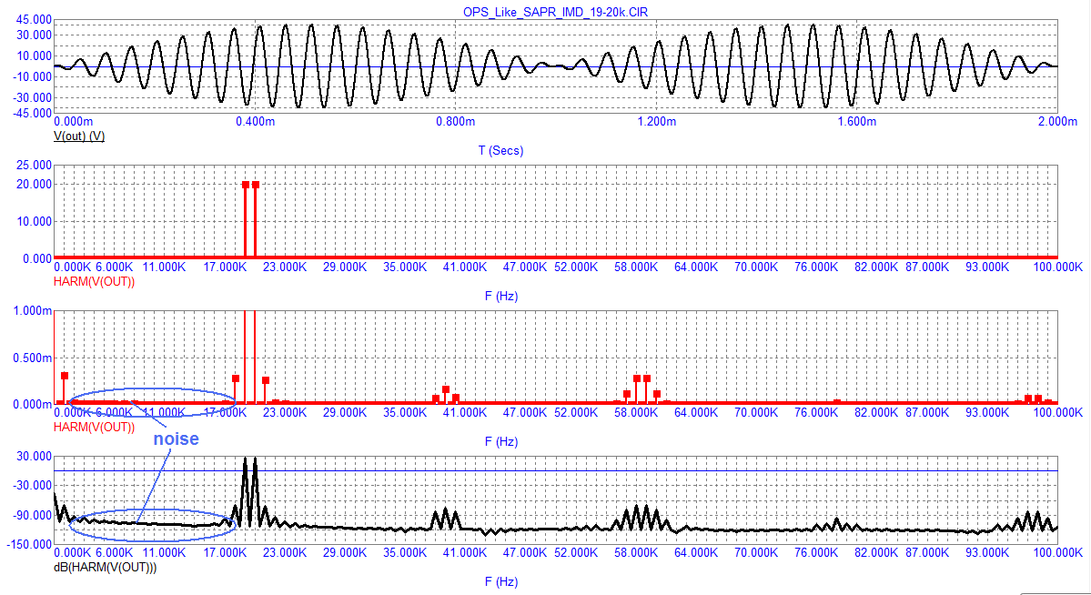

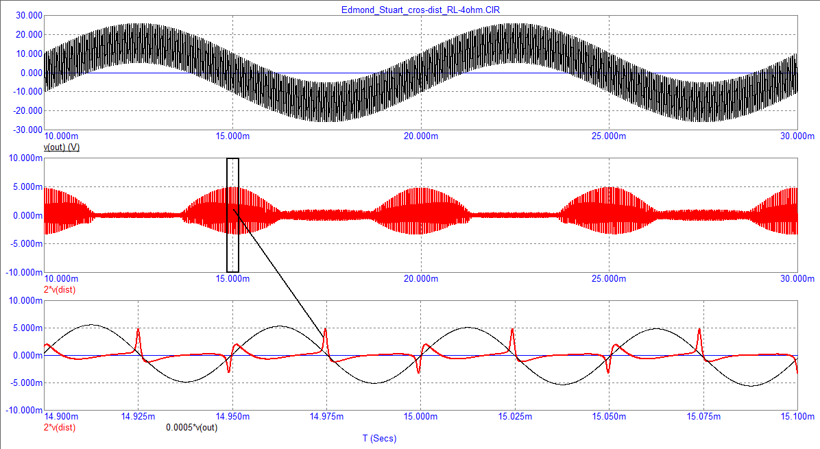

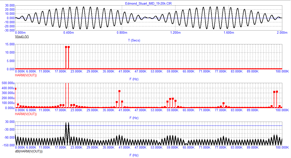

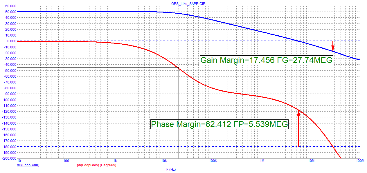

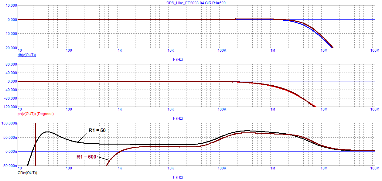

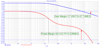

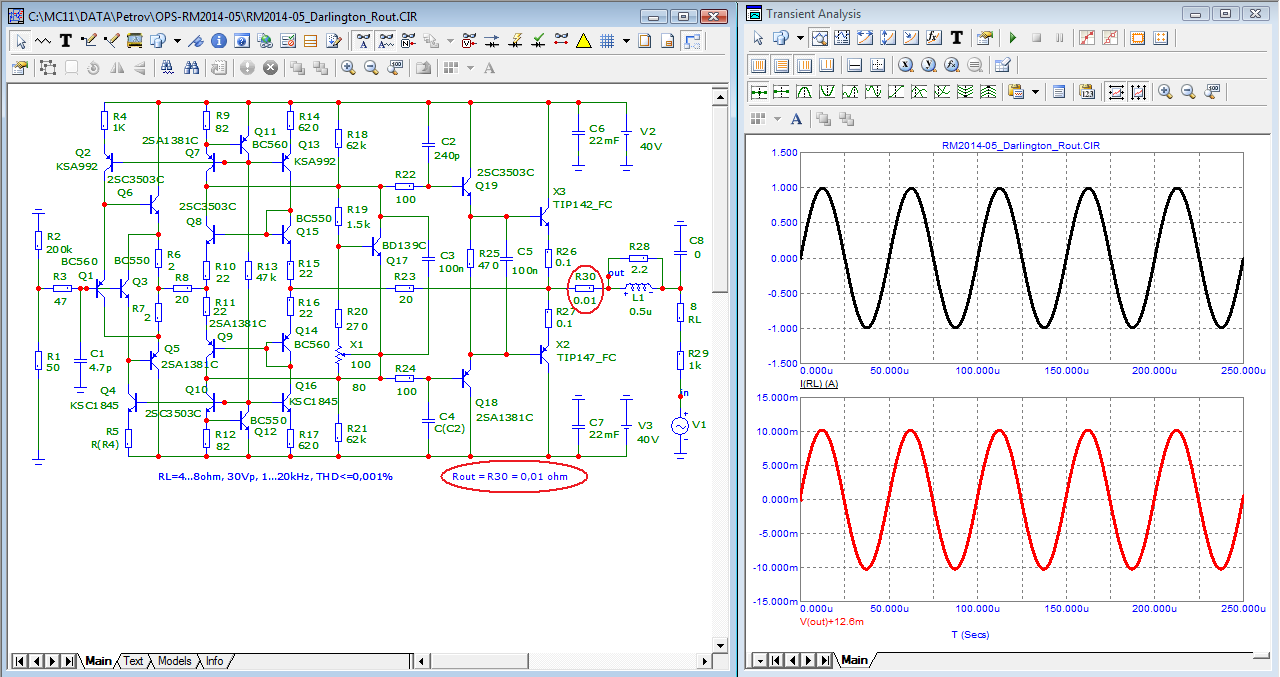

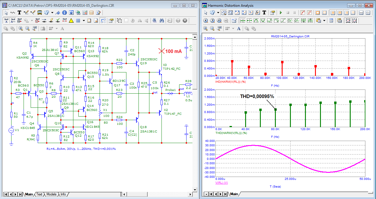

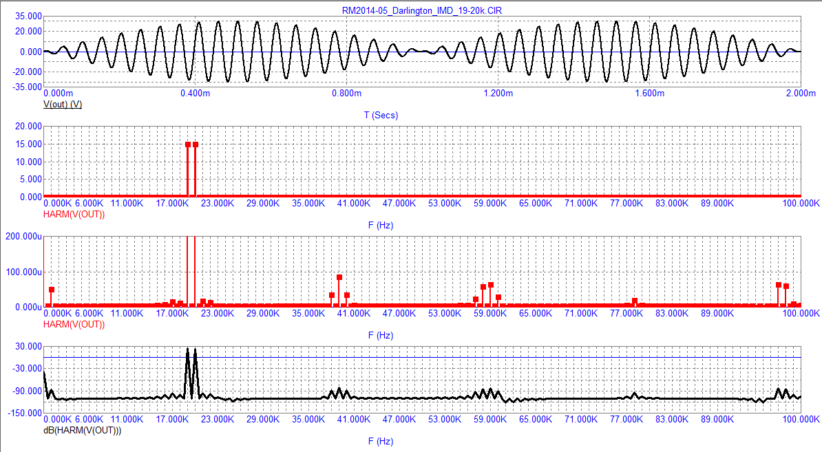

Let's make an output stage according to the idea:
New Lineup IDEA - Power Follower/Output stage

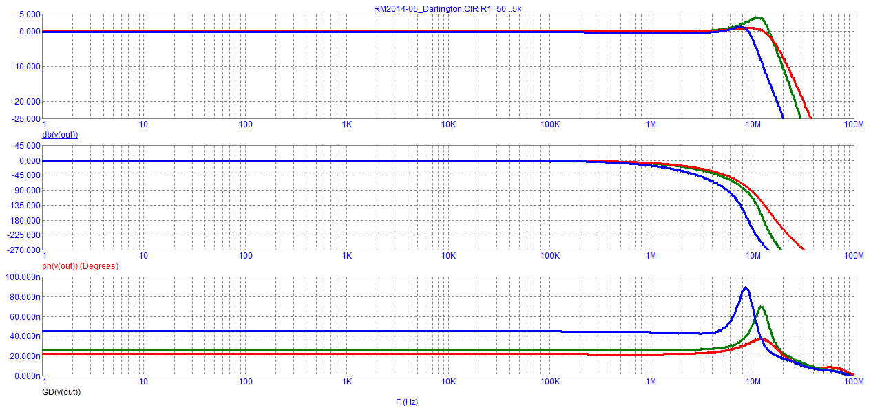

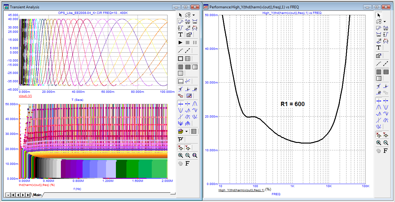

You deserve the price for producing images in a way that most if not all of us don’t understand.
Why not describing each picture like everybody else does by telling which line is showing what and why and then coming to some sort of conclusion.
Hans
Hans
I agree with Hans. The charts you are sharing aren't done in a conventional way... at least not the convention that users of this forum are accustomed too. As a result, it's not always clear what you are trying to convey... especially when descriptions accompanying the charts are brief or nonexistence.
Also keep in mind, users of this forum have varied backgrounds. Many of us are not engineers and many are novices. This should be a place where people can learn and not feel like they'll be dissuaded from asking questions.
I hope there is no need to explain what a distortion spectrum is in the form of a Fourier expansion The same goes for intermodulation distortion. Under each chart there are captions explaining what they display.You deserve the price for producing images in a way that most if not all of us don’t understand.
Hans
As for the conclusions, then you can compare the parameters of the two amplifiers with each other
If I understood correctly, many people do not understand the results of tests on measuring switching distortions. I have repeatedly given the filter circuit with which the measurements were made, I am citing it again. I think you can use such a filter in any simulator. The only thing you need to know: start outputting measurement results after the end of the transient processes in the filter, not earlier than 10 ms. See also the description of the application of the virtual device for measuring switching distortion. As an example, we measured the output stage of the DartZeel-108 amplifier.
O.K. thank you for responding.

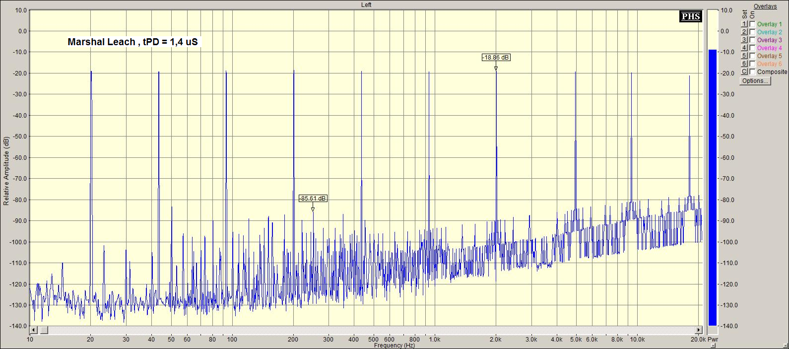

I have read your PDF and understand you are dividing the areas of investigating in three parts, the positive halve, the zero crossing area and in the negative halve.
The idea to see the different behaviour in these three areas is quite nice and brings me to a number of questions.
1) In the PDF you presented, the distortion envelope for the Dartzeel looks as if modulated by 20Khz.
Why is this 20Khz envelope not filtered by your notch filter ?
It would be interesting to have some form of explanation why.
Using an FFT could reveal more detail.
2)In the zero crossing area you blame the distortion to switching distortion alone.
But what about IMD and THD ?
Again an FFT (for the three different areas) could give some answers.
3) It's nice to see what happens when using 100Hz + 20Khz, but it has hardly any impact on Audio reproduction since it's all above 20Khz and completely supersonic.
So why not somewhere in the low Khz range, where our auditory system is most sensitive ?

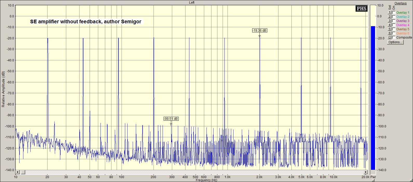

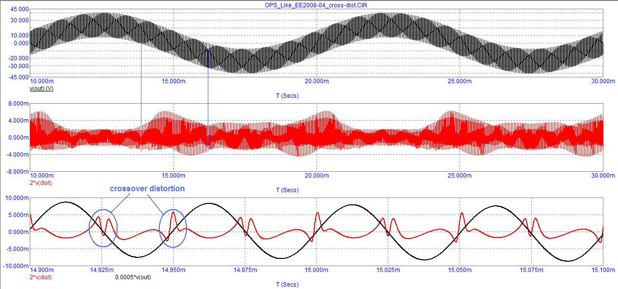

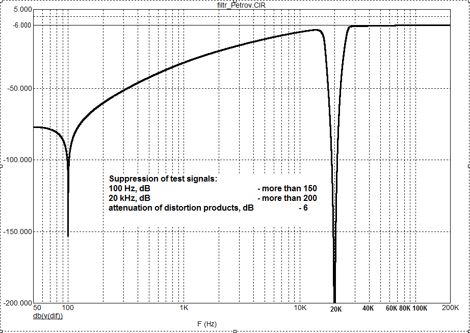

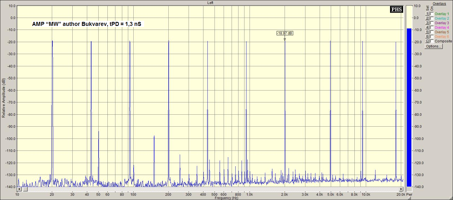

Hans, the use of the FFT shows the spectrum of distortion products, but does not provide a visual representation of the causes of these distortions.
The more you use such a filter in your tests, the more you will become convinced of its usefulness. For example, test the output stage using a single frequency of 20 kHz. You can see how the amplifier works asymmetrically at zero crossing.
Here are two tests of the same amplifier with the same signal.
In the FFT spectrum, we see the frequency of harmonics, but the reason for their occurrence is not clear.
The filter test complements the FFT test perfectly.
When designing an amplifier, I do not limit myself to checking the Bode diagram, loop gain and THD, but do many other tests.

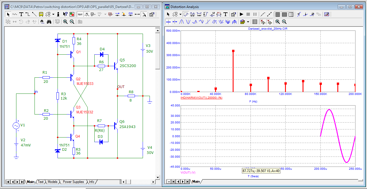

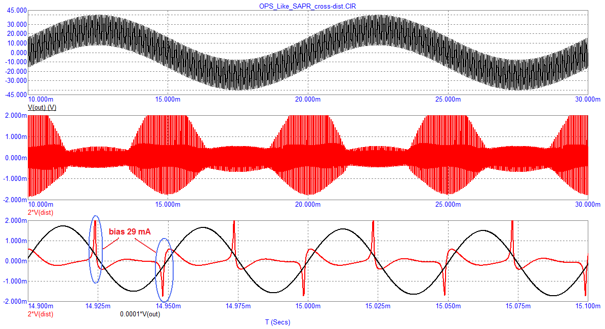

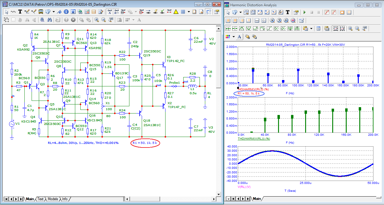

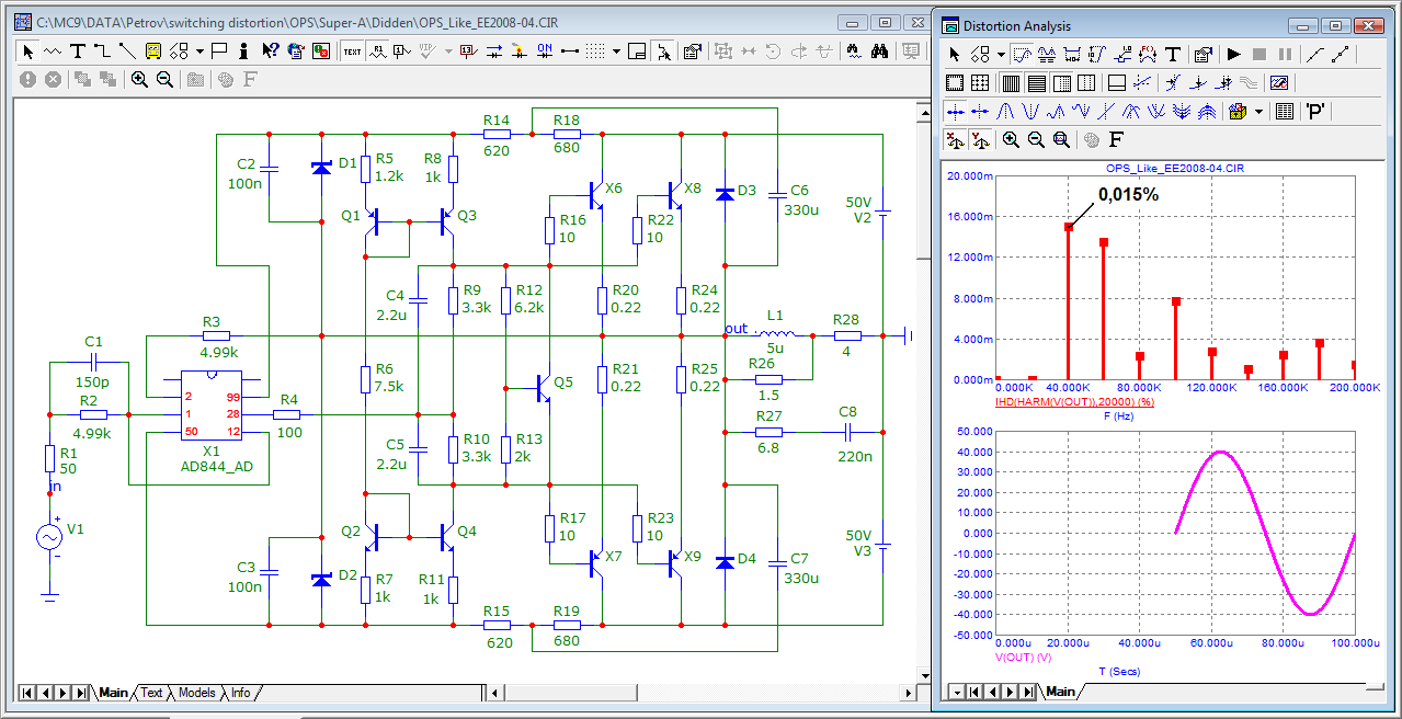

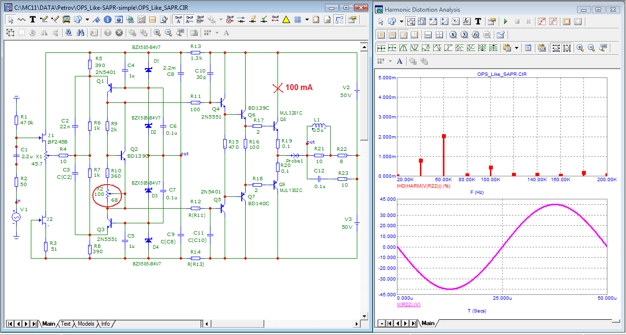

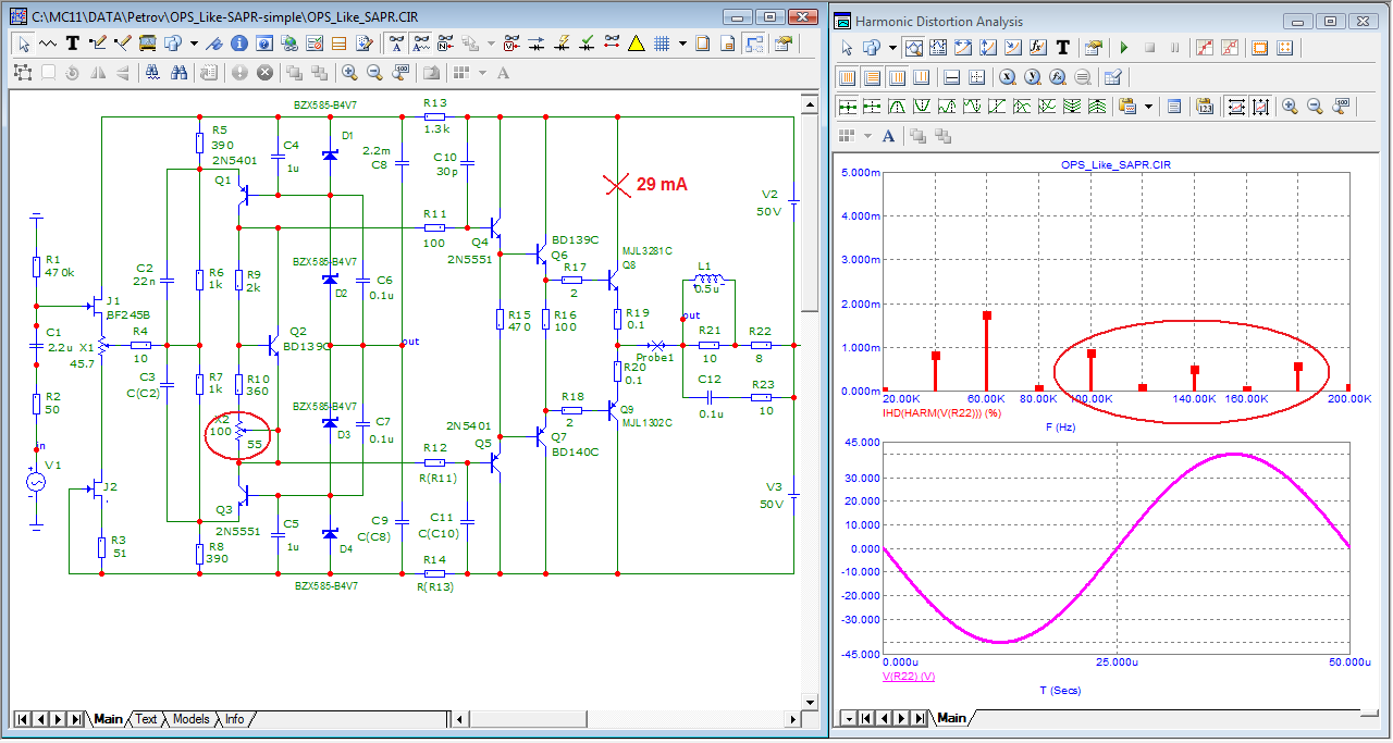

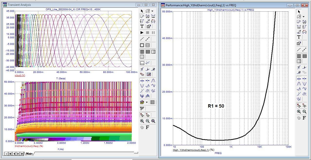

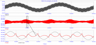

Let's continue our study of amplifiers using a filter. Here is another example of an output stage positioned as an OPS with distortion compensation. Let's see how it copes with switching distortion, as well as the spectrum of signal distortions with a frequency of 20 kHz.
as you can see, the output stage does not handle switching distortion very well

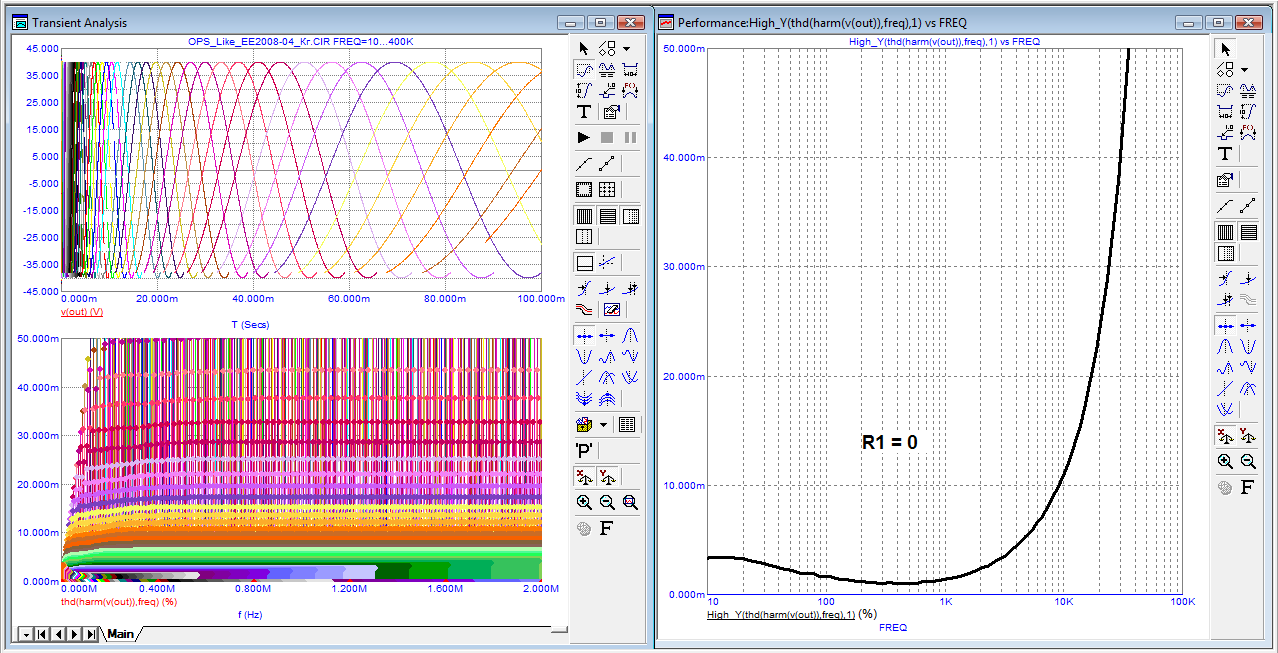

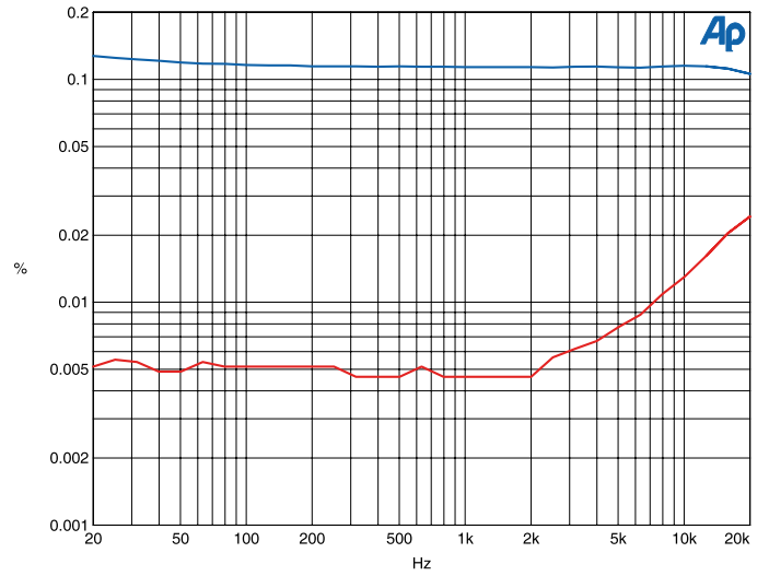

If you look at the dependence of distortion on frequency, you can see a rapid increase in distortion starting at a frequency of 2 kHz. With a signal source resistance equal to 50 Ohm to a frequency of 20 kHz, distortion reaches the level of 0.025%. The situation is even worse when the resistance of the signal source is equal to 600 ohms. Distortion grows on both sides of the 2 kHz frequency.
Petr,
First of all I admire your positive drive to find new ways in measuring amplifiers.
And although I have taken the trouble of reading carefully what you have written, I have a problem in validating things because you are using new terminology and regard several things as common knowledge.
A number of things:
1) Why are the two Dartzeel distortion diagrams so different, in your PDF and your recent posting and why had the first one a 20Khz envelope despite the 20Khz filter ?
2)Why is the fact that HF signals after the amp + filter are attenuated a prove that microdynamics in the audio band are lost.
3) Why are you focussing so much on speed distortion outside the audio band and what exactly is speed distortion
4) What is your definition of transient distortion, because feeding a burst to a filter causes a change of shape, which is not the same as distortion.
5) What exactly is noise bias .
It is no my intention to talk things into the ground, but sorry, I see no correlation between quality of audio reproduction and your papers, but you may be on to something that's important.
Hans

I do not understand what are you talking about. Show these two different diagrams, then we will discuss.1) Why are the two Dartzeel distortion diagrams so different, in your PDF and your recent posting and why had the first one a 20Khz envelope despite the 20Khz filter ?
I showed that low-level HF signals were distorted at the amplifier output compared to the input signal, and with a 2-fold attenuation. What else needs to be proven?2)Why is the fact that HF signals after the amp + filter are attenuated a prove that microdynamics in the audio band are lost.

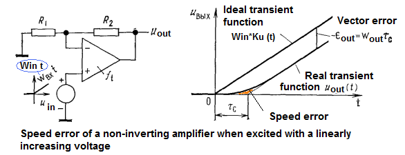

Jiri Dostal drew attention to high-speed distortions back in 1981. This type of distortion occurs whenever the signal deviates from the sinusoid and manifests itself to one degree or another. The music signal is not a sine wave, therefore this type of distortion is the most harmful for amplifiers designed to amplify music signals.3) Why are you focussing so much on speed distortion outside the audio band and what exactly is speed distortion
Transient distortions are associated with the behavior of the group delay. The smaller the group delay and the more linear and longer the linear section with a smooth falloff at the end, the less transient distortions.4) What is your definition of transient distortion, because feeding a burst to a filter causes a change of shape, which is not the same as distortion.
Noise offset is precisely what occurs due to velocity distortion. The lower the signal propagation delay, the lower the noise floor in the audio range. You can verify this by reading the comparison test of the two amplifiers. Although at 20 kHz the loop gain in the Hafler amplifier is 2 dB higher than in the Hiraga amplifier, it nevertheless has a higher noise floor.5) What exactly is noise bias
