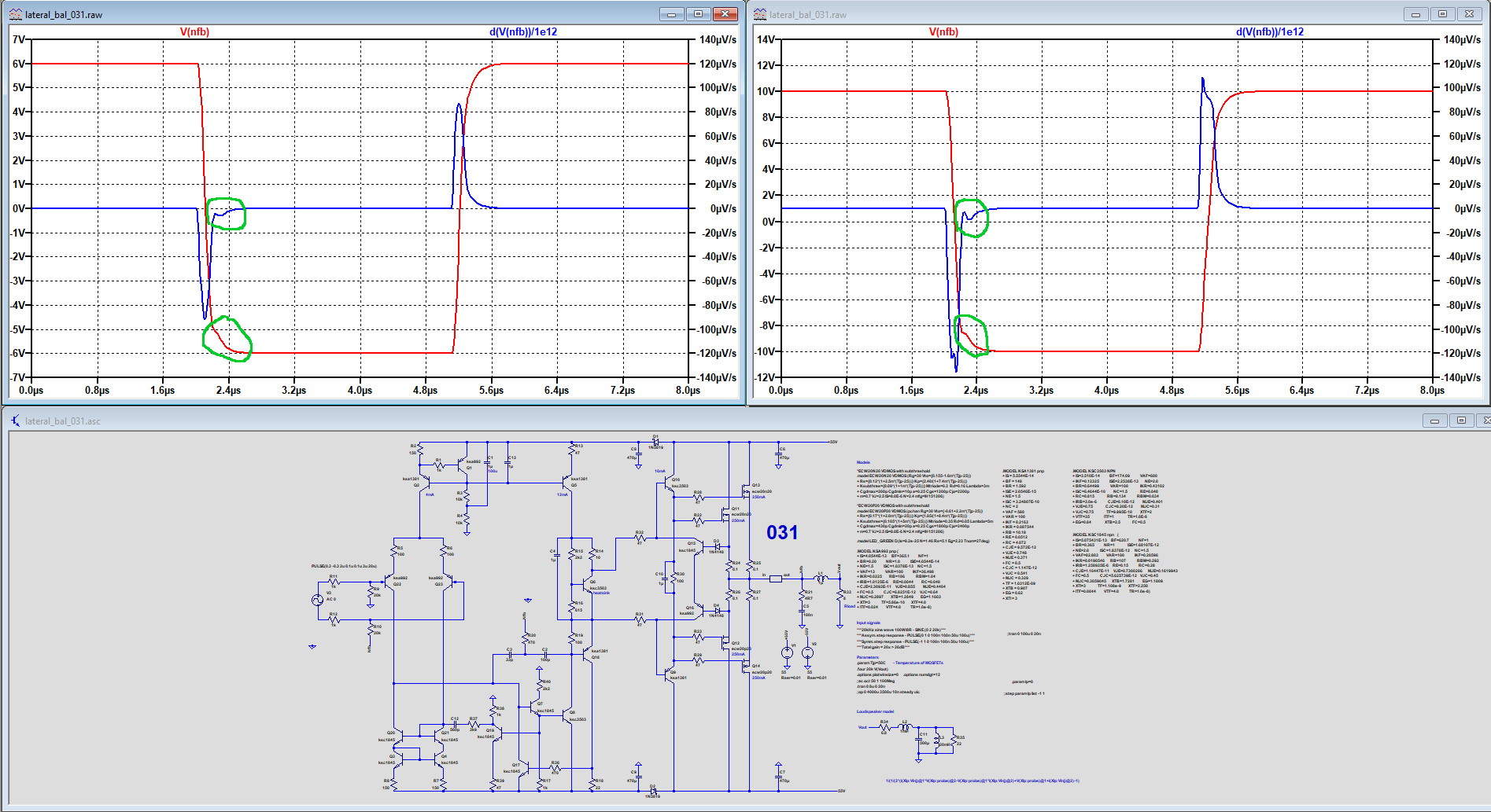

Obviously Petr has no idea what I did.
I took the derivative of the slope d(Vout)/dt, which is the most accurate way to derermine the slew rate.
Up to +/- 6Volt the slew rate was symmetrical using a square wave with a very fast slope.
Beyond this level, which will never happen in real life, the amplifier became non linear so that’s where I stopped.
So SSassen 90Volt/usec in both directions is a good achievement for your amp, way beyond what will ever be needed and especially because the square wave output signal is nicely critically damped with a very fast settling time.

Quick comment: there is an extra required step to identify slewing issue: in simulation or measurements, determine the 10%-90% time for both the leasing and trailing edges of the amplifier step response, for various amplitudes of the input signal (in simulation you could go to the amplifier clipping, in practice don't try it, the output RC cell (and potential other components, may blow). If:
- 10%-90% time does not depend on the output amplitude, then what you are measuring is the amplifier rise time, directly related to the closed loop bandwidth.
- 10%-90% time does depend on the output amplitude, then you reached the large signal slewing limit, and you can calculate the slew rate.
Note1: the slewing waveform is usually NOT nicely damped, but the transition from the slope to the plateaus is abrupt.
Note2: if you cannot identify a slewing limitation as above, this means you are safe; the rise/fall time (that is, the amplifier bandwidth) are high (low) enough to mask any slewing effects, so slewing distortions will never occur. So limiting the amplifier bandwidth to a reasonable value (say, 100KHz) by (for example) using an input low pass filter) is a good protection against slewing distortions (assuming they may ever occur, which is always questionable for the low slewing audio signals).

Ah! So Q8 does 117V/µs and Q5 does 91V/µs. That's a 22% difference.
If 10V/µs is needed, there is a marging of approx 10 times for both sides. That can produce distortion at 200kHz indeed. A sharp analysis.
Now the rest.
It is simple to correct for that, I'm just wondering how best to simulate slewrate limitations so small differences are quickly found and can be corrected.

Simply use the method in LTSpice as was used here
Musings on amp design... a thread split.
Offer a square wave with 0.1usec rise/fall time, display the output signal V(out) and its derivative d(V(out).
By increasing the input voltage you will easily find the point where the slew rate stops.
And as a matter of fact, I don’t see a reason why slew rate should be symmetrical as long as the slowest of the two is fast enough like your 90V/usec.

Sander,
I hope this is your name, is it?
My feeling is that you still might have not enough confidence in finding the slew-rate, the way I mentioned.
That's why I have taken a smaller time range with a higher square wave frequency, enabling to show you in more detail the slew rate.
The image at the left is made with a +/-0.3V input signal, showing a symmetrical +/-90V/usec slew-rate.
When increasing the input signal to +/-0.5V, you see that the upgoing ramp still has still ca 90V/usec while going down is with a slew rate of ca 120V/usec.
Very simple to perform, isn't it.
However what is quite visible is the asymmetric behaviour that's encircled in green.
I would worry more about that part than the asymmetric slew-rate
Hans
