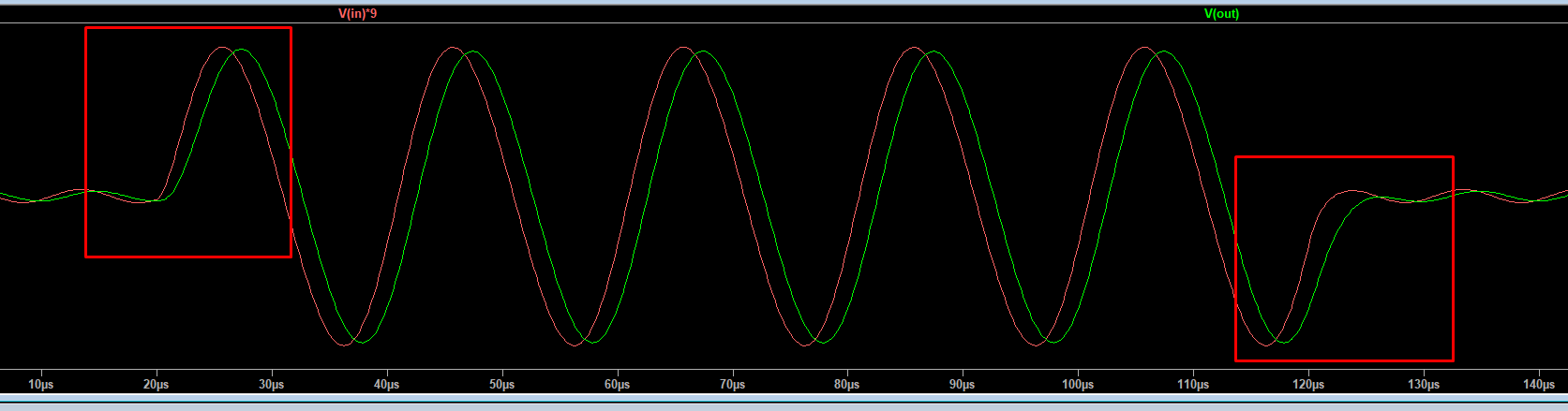

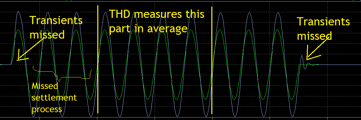

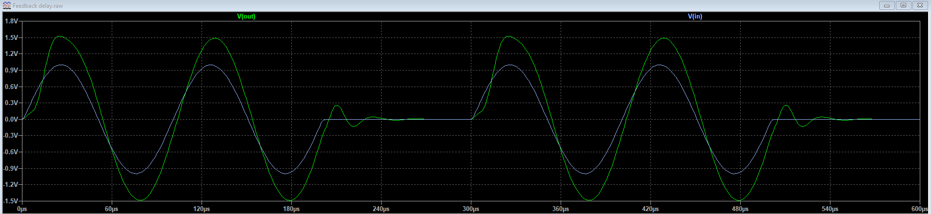

I'd say transient distortion is a one that's not continuous/periodic and
is only present right at the beginning (or at the end) of the change.
Attachments: I know these are extreme cases but besides that they represent that there
is some "special" error at every "new" signal change which cease after a few periods.
About the name: I guess even if it can be categorized to something more fundamental one
we can use it to emphasize its importance. Like we have different word for sparking and lightning.

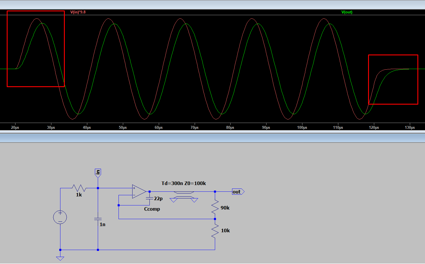

Could you please post the schematic of the amplifier discussed and put a mark on the points that you "measure"?
Here you are. Comments:
  • the test signal is 50kHz sine wave (I know starting and stopping too fast...)
  • input RC = 1k + 1n
  • amp delay = 300ns
  • in the middle: THD = "0" and the steady sine already has just a phase shift
  • I know it's a "stress test" but it's good to visualize the effect
But if you have a better test signal (which is not a continous sine wave) I'm open.
  • delay.asc
    delay.asc
I mixed two signals here just not to start from zero and stick to this thing.
The main thing is that if the signal is changing there is not just a delay.
The "simple delay" is only there after a settling time.
So what a real music signal is rather like?
It has almost continuous transients (I dont mean step signals under that) or continuous regular sine waves?
  • amp delay = 300ns
Sorry dude, but this is complete nonsense.
Not again. This is getting redundant, like hitting your head on the wall. Your artificial signal has little to do with reality,and so the conclusions from it. Why dont you use a real music signal? Maybe yould learn what that looks like.
