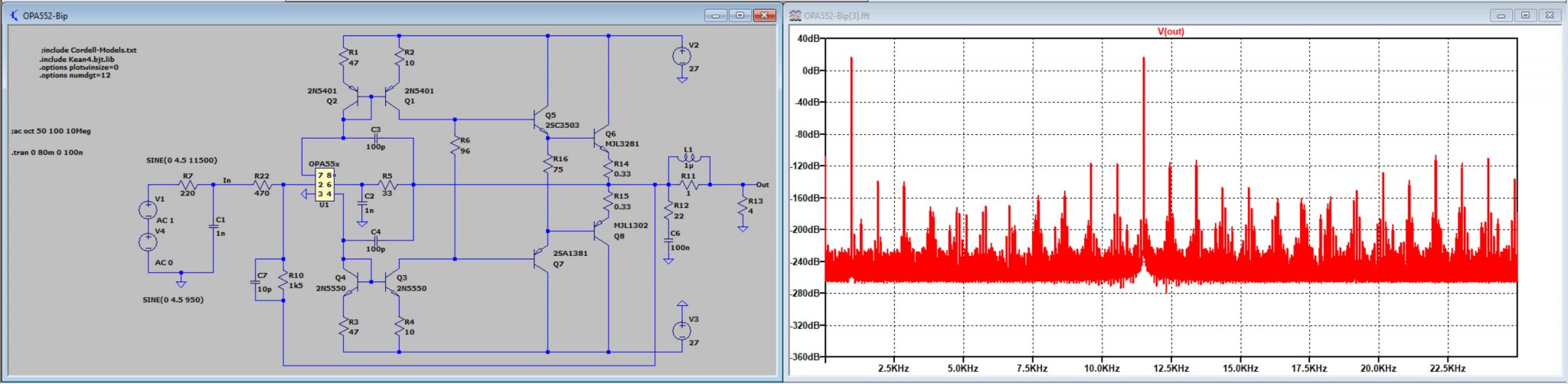

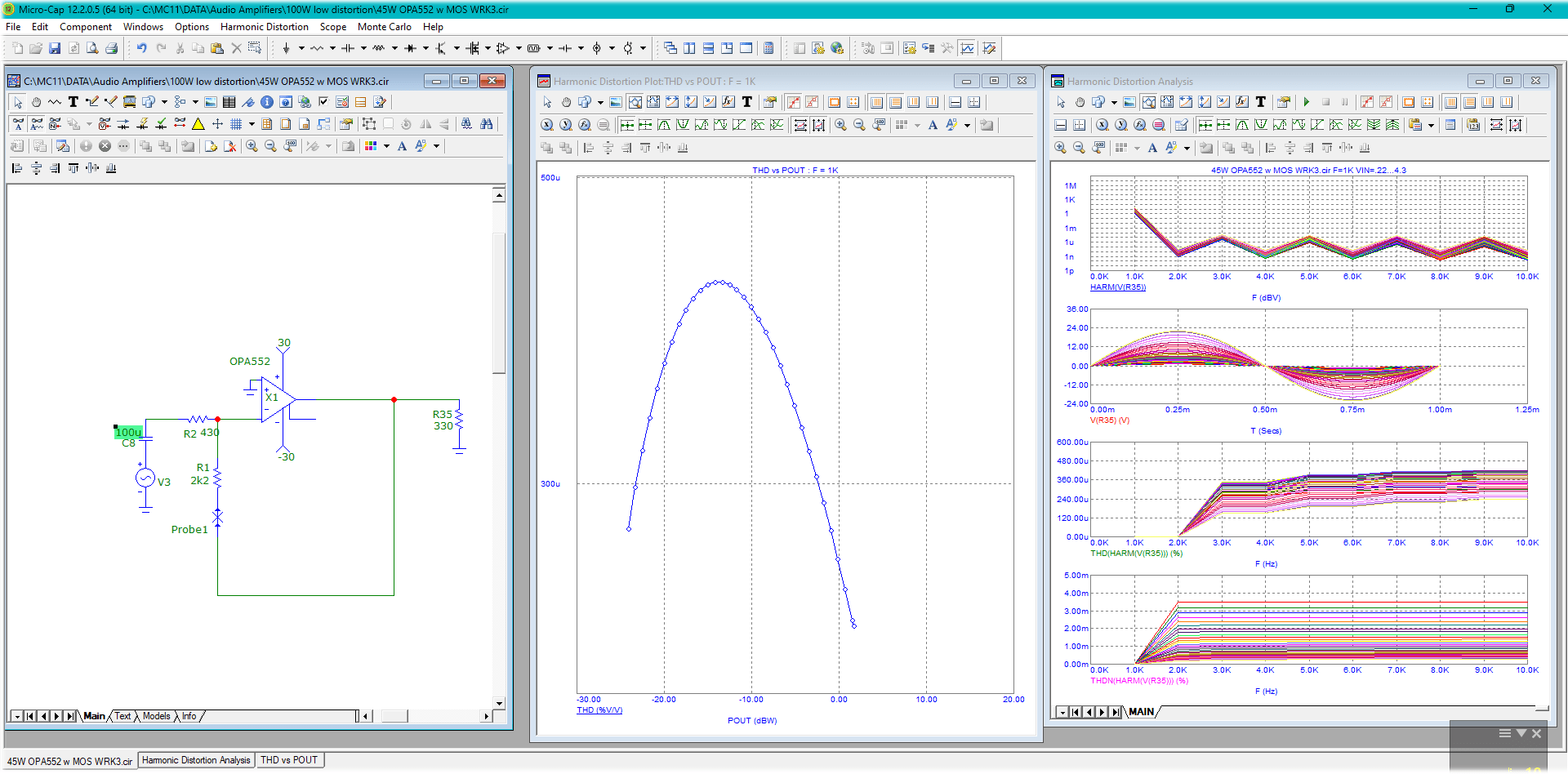

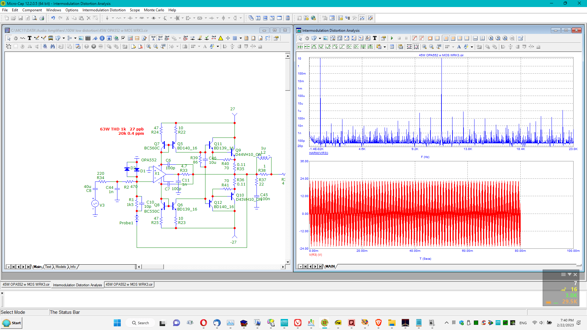

In uC, IMD with IRF series is ~ 20 dB higher than with ECW series (input & bias set properly).
It would be nice to have a universal tracer, producing the models via actual measurement of "device in possession".
Anyhow, the topology with the OPA552 looks viable.

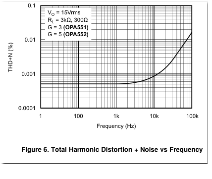

Comparing THD (sim) with spec of OPA552 doesn't show the sim is too optimistic.
With three MosFet models used, resp the IRFP series from Bob Cordell, The ECW series from uCap and finally the ECW series from Heglun&Keantoken I got the following spectra, all with the same input and all with 250mA Bias.
The uCap seems too optimistic and the other two are showing practically the same distortion peaks.
The ECW's are quite a bit noisier, but at a total insignificant level.
Hans

If uC models for the ECW series are too optimistic, that must be the case for other laterals too (2SK1058 etc.) as the difference in circuit behavior mainly considers R(on) / Id(max). What looks like noise in the lower two pics could be high order IMD products instead. In that case, the difference between adjacent peaks is 50 Hz. If so, the model from Bob Cordell is too optimistic. It would be interesting to use darlingtons instead of mosfets.

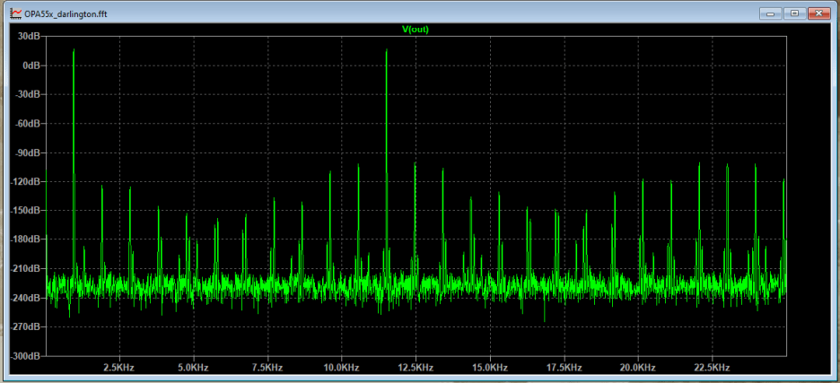

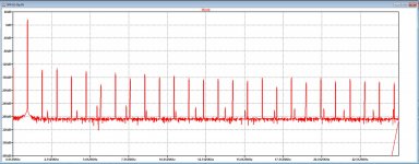

It would need measurements to be sure. Hence, presuming the topology is valid, I exchanged the mosfets with darlingtons (much cheaper too), setting quiescent current to proper value. THD 1k & 20k. It would be interesting to see if that's too good to be true as well.
That bad behavior shows well even with uC, using types like the MJH6284 / 7 in sims of power stages, at 20 KHz. Those darlingtons are only good in a sim of "worst case possible". The STD03 is better in that respect, and so is the MN2488 (Ft 55MHz) and its complementary part, MP1620 (Ft 50 MHz).
With a proper set of BJT's, result is comparable to the IRFP Mosfets version.

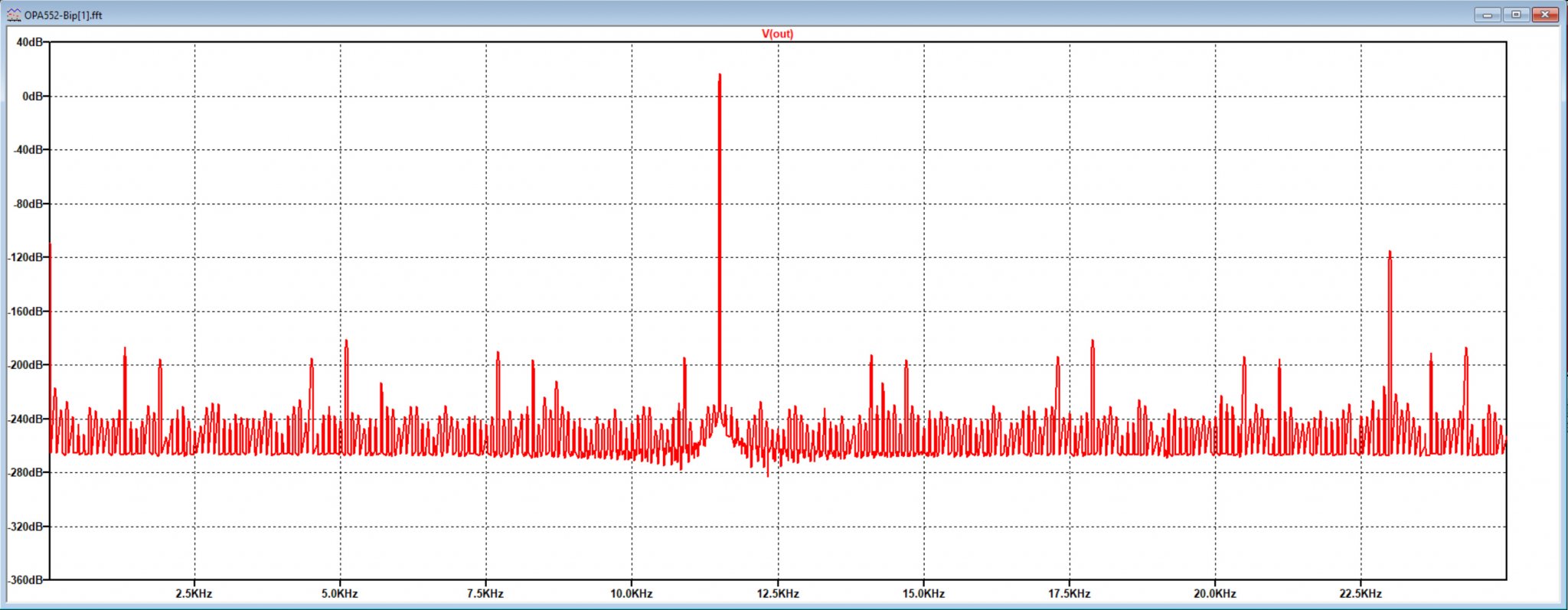

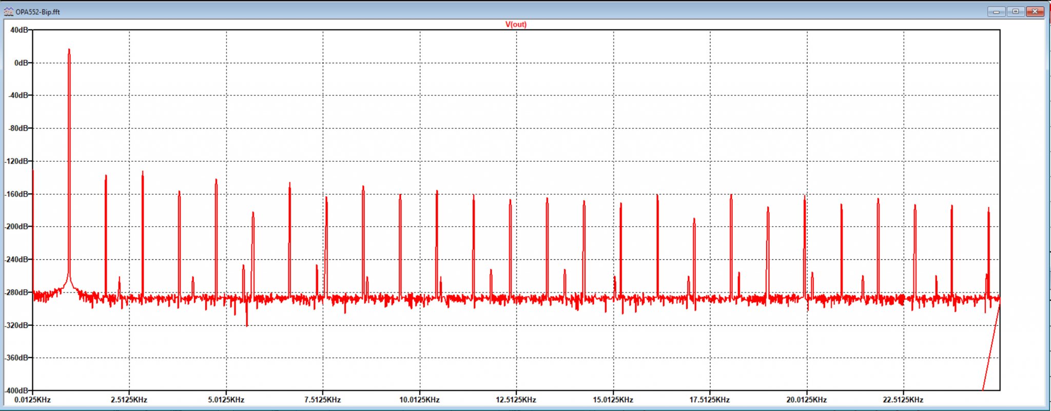

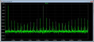

I also made a run for just 950Hz and 11.5Khz, to find the reason for the "Grass".
To my surprise THD for 950Hz with TI's model is much larger without any decay as for 11.5Khz, and when doing the IMD test, all these harmonics are again creating IMD products.
It's wise not to jump to conclusions, because many models aren't that perfect below -120dB, so in real life things may be rather different.
Hans

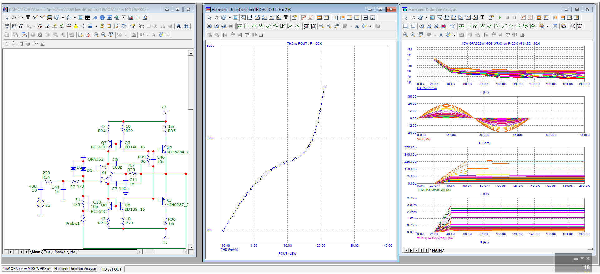

Thanks for checking that: in uC with mosfets they were required to prevent parasitic VHF oscillation in transient analysis: stability was OK without them. What I did check with the darlington config was temperature stability, and that looked OK.
