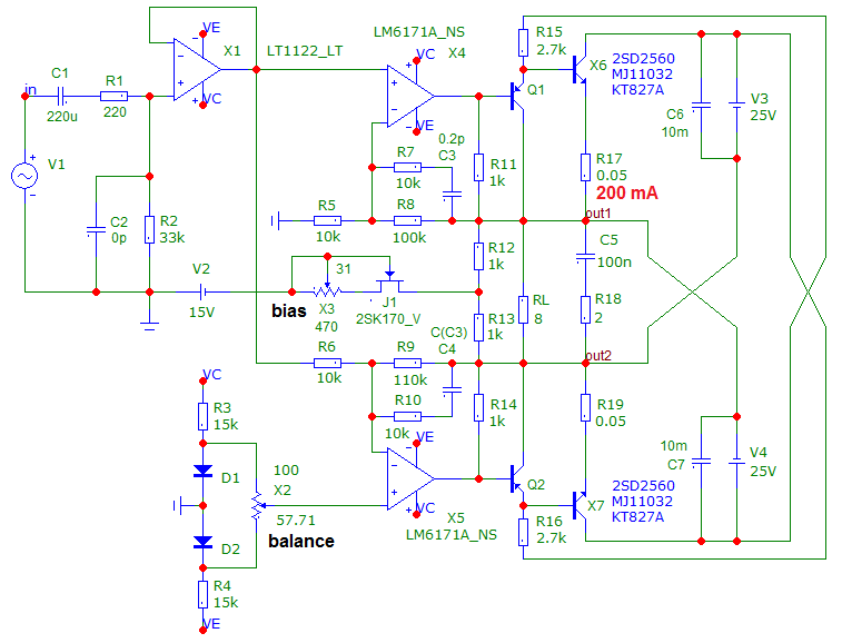

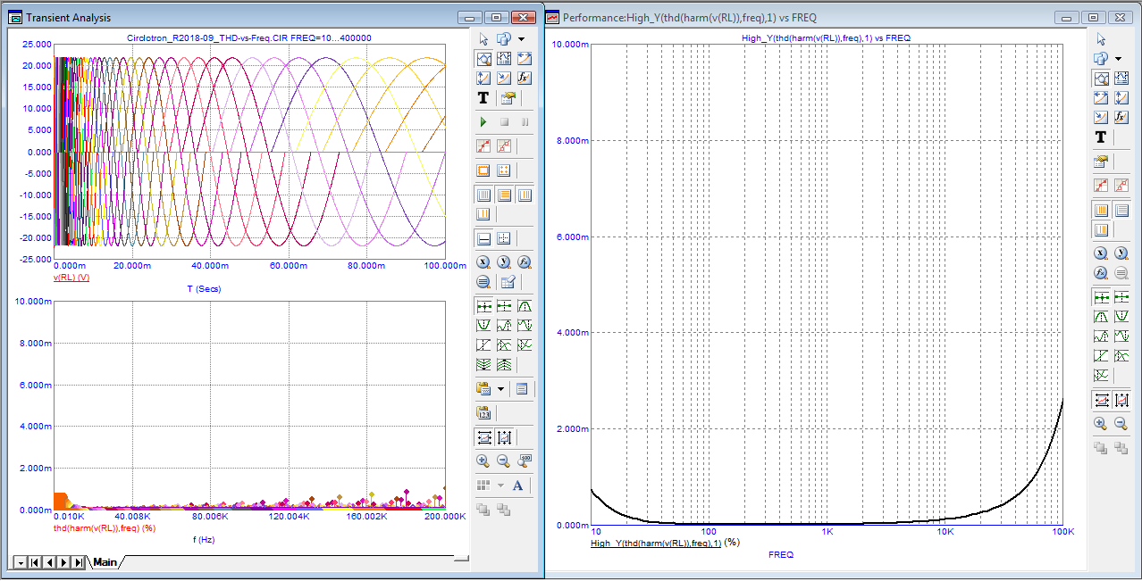

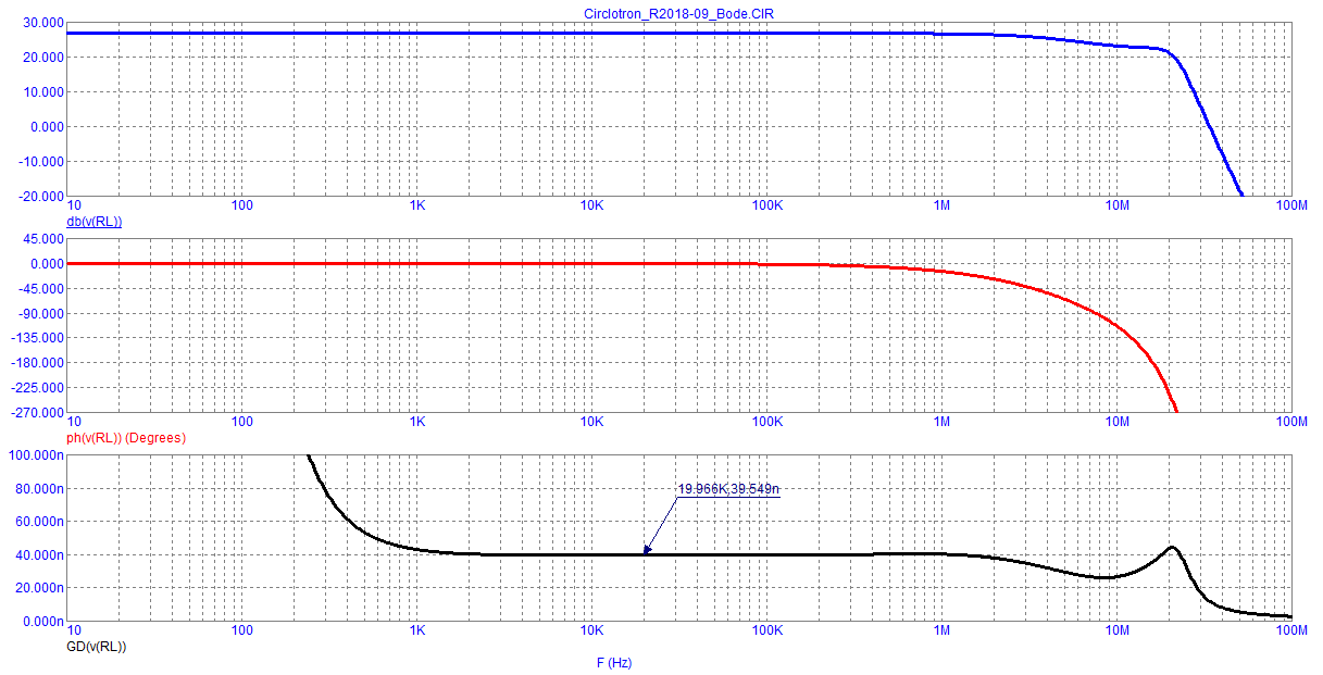

As Graham Maynard pointed out, the sound quality depends on the first period distortion (FCD). According to Jiri Dostala's classification, the main contribution to FCD is made by speed distortions. In turn, Cyrill Hammer noted in an interview that amplifiers with GNFB should have a tPD of only a few ns, if you are not able to fulfill this condition, then make amplifiers without GNFB. Moreover, for the latter option, he did not stipulate what the Group Delay should be.
Let's try to figure it out with a specific example.

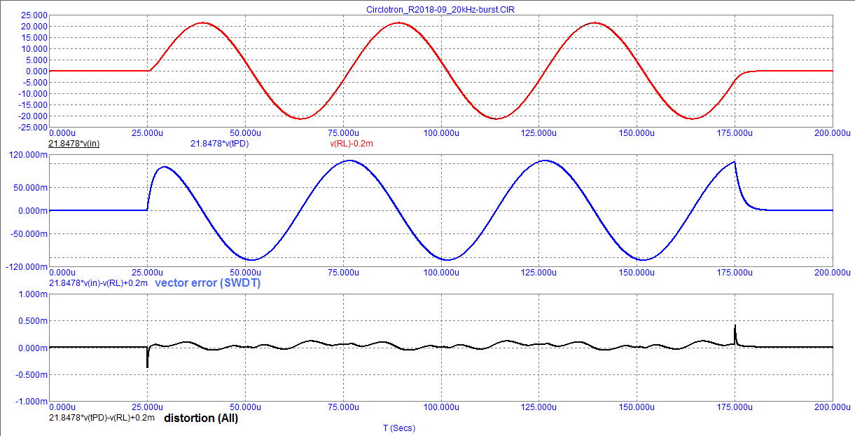

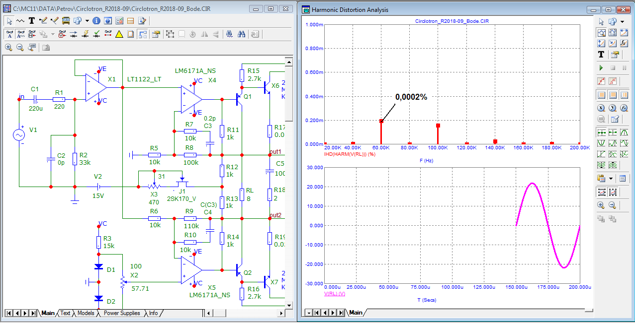

GainWire-NGNFB-classB-PowerAmp

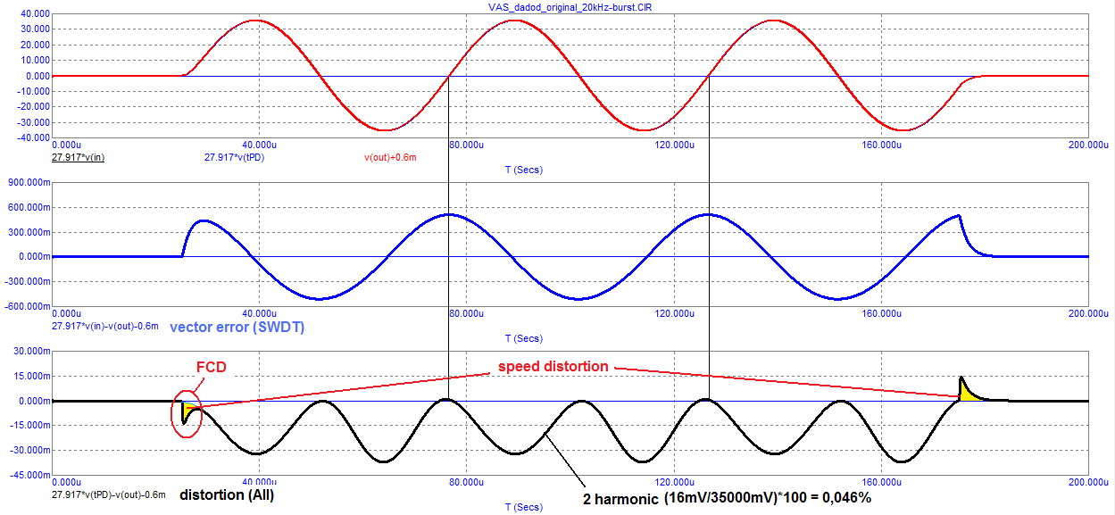

It can be seen from the Bode diagram that tPD = 114 ns. Group Delay is constant almost up to 200 kHz, then there is a smooth decline !!!
The spectrum of harmonics of a signal with a frequency of 20 kHz is short, only one 2nd harmonic at a level of 0.046%. It is known that with a short spectrum the level of the 2nd harmonic can be several percent without negatively affecting the sound quality (as an example: most tube amplifiers). Let's measure the vector errors using the Hafler test. With an output voltage of 35 V, vector errors are 0.5 V, i.e. 70 times lower (~-37 dB) (middle graph).
We will measure all types of distortions, for this we subtract from the input voltage delayed for a time tPD and adjusted to the output voltage level (lower graph). Here we see the 2nd harmonic at a level of 0.046% and velocity distortions of negligible magnitude. As shown by the test performed, the speed distortions, even at tPD = 114 ns, are much lower than the nonlinear distortions. The same value is confirmed by the calculations of Jiri Dostal.
As practice shows, this value is also true for amplifiers with GNFB, provided that the Group Delay has a constant value up to at least 200 ... 300 kHz and then a smooth decline occurs (without overshoot as in the Hafler XL-280 amplifier).

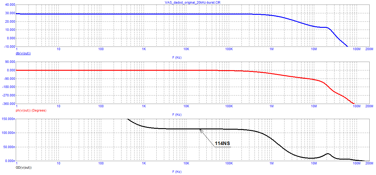

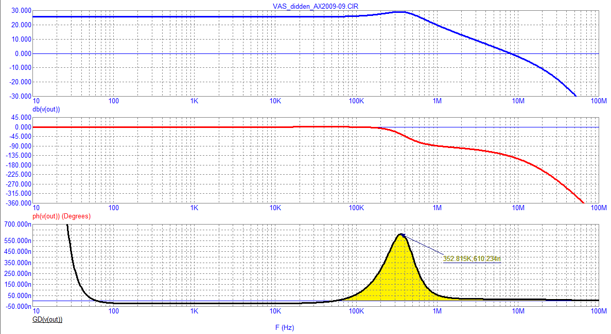

Here's another Banksy ...
It can be seen from the Bode diagram that Group Delay has a negative value in almost the entire sound band, and immediately after the sound band it begins to grow and reaches 610 ns by the frequency of 350 kHz.
In the steady state, the lead of the output signal with respect to the input is 20 ns.
The vector error (SWDT) is less than 100 mV, taking into account the severe distortion of the waveform.
In order to measure all types of introduced distortion, it is necessary to delay the output signal by 20 ns. The measurement result is shown in the lower graph.
The graph shows that the amplitude of speed distortion reaches 0.35 V, the peak level exceeds 1%.

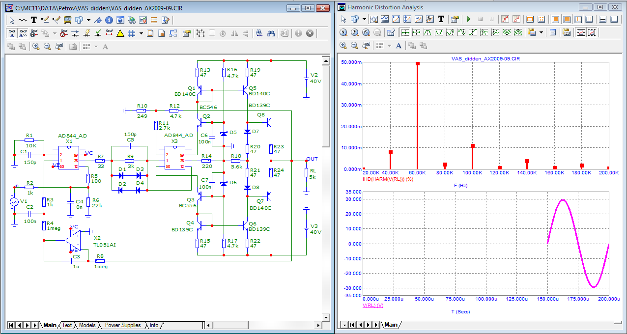

This is another example as an addition to the Hafler XL-280 amplifier tests.

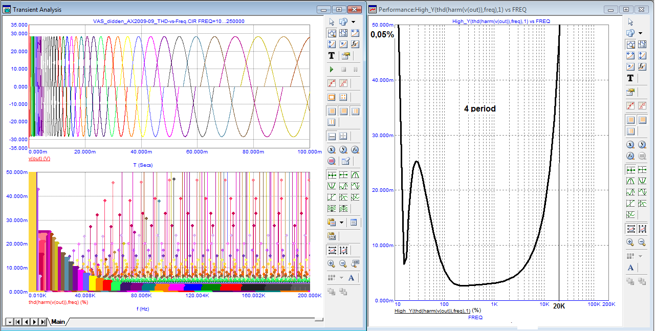

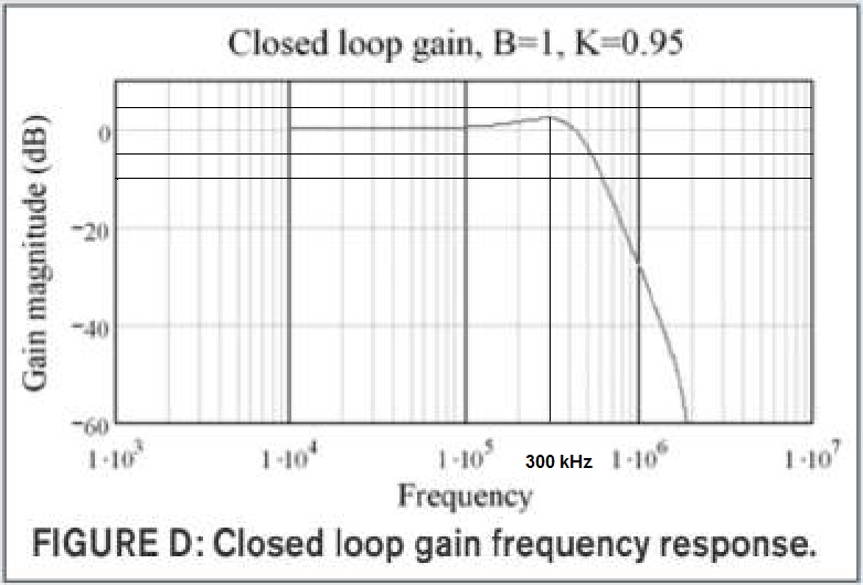

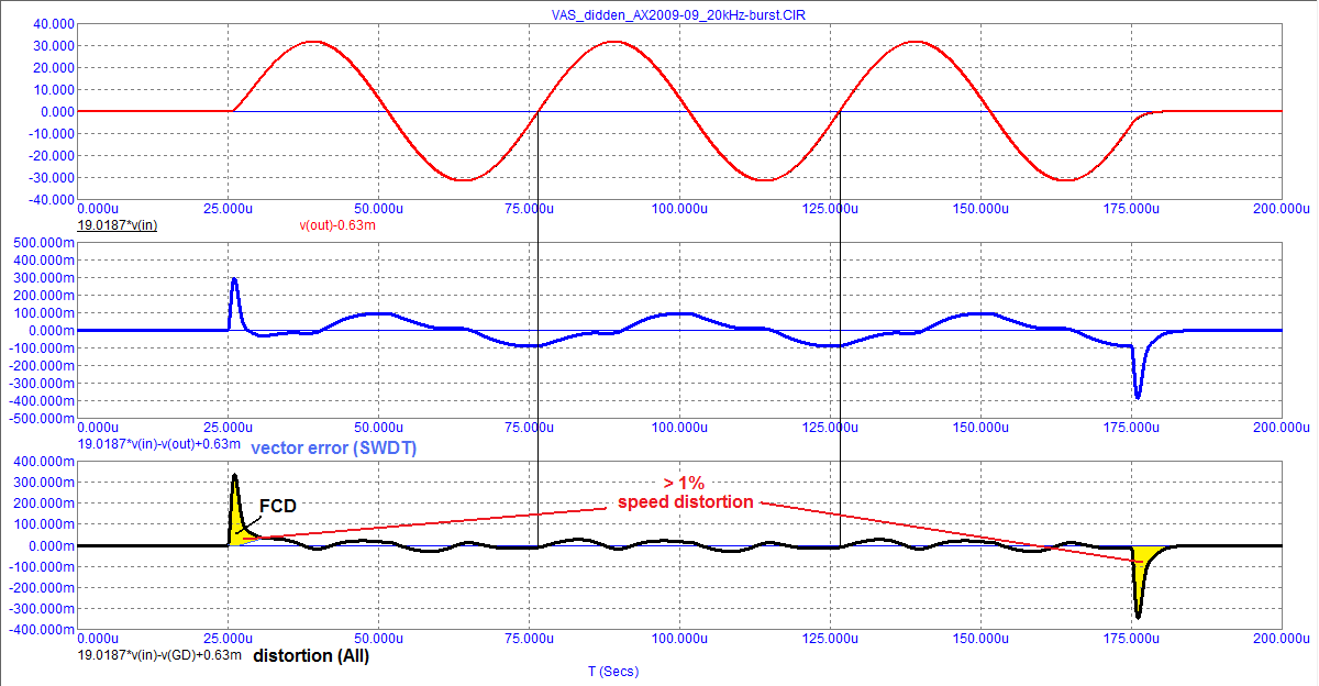

Despite the beautifully presented theory, the parameters of this solution are far from perfect.
The passband drops abruptly above 300 kHz.
Beginning with a frequency of 2 kHz, distortion increases sharply.
when measured in the 2nd period, everything is much worse

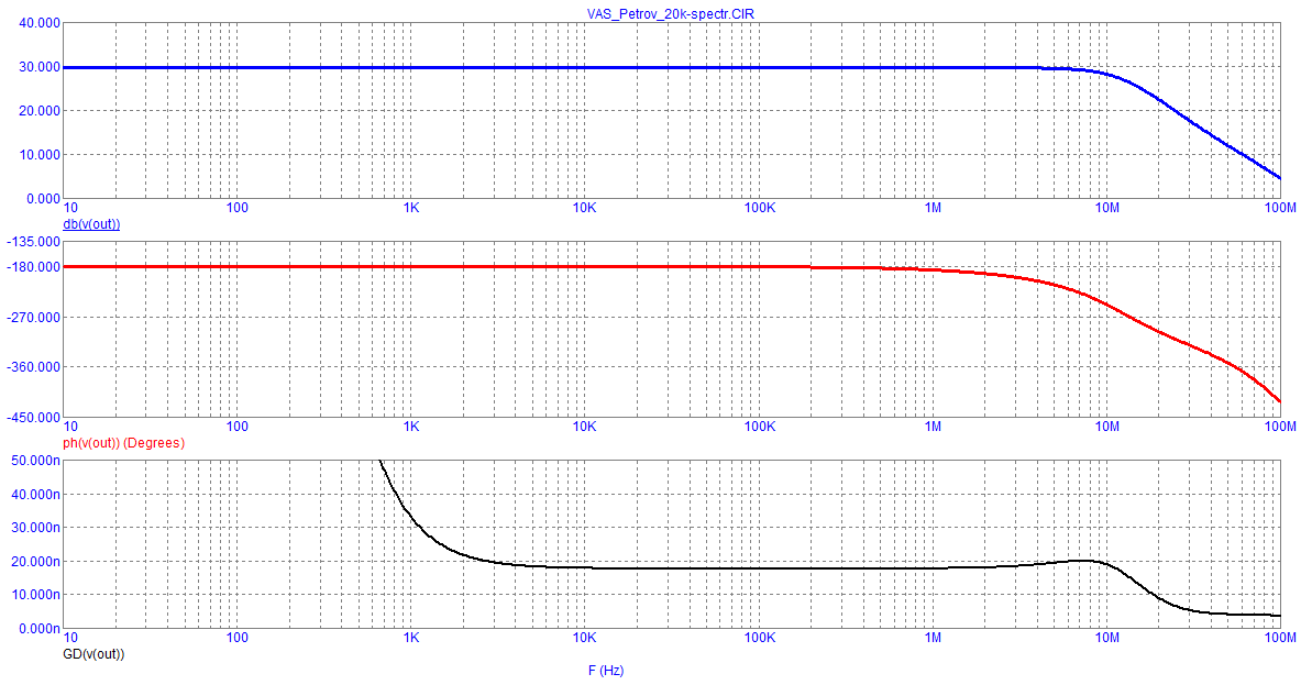

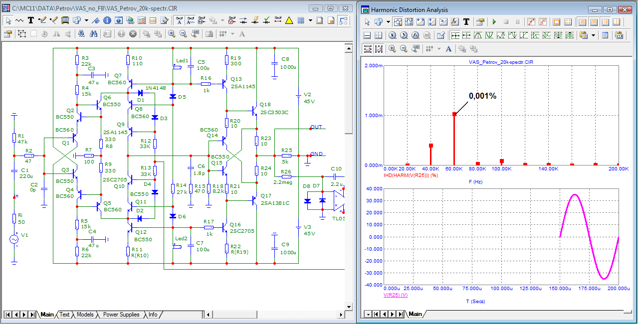

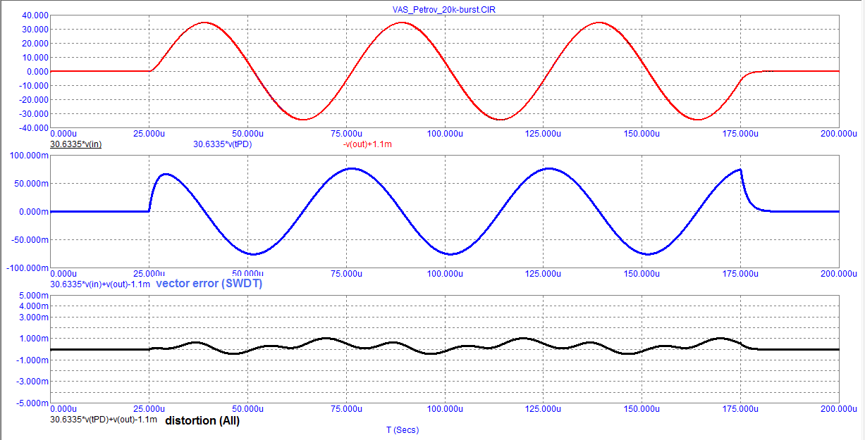

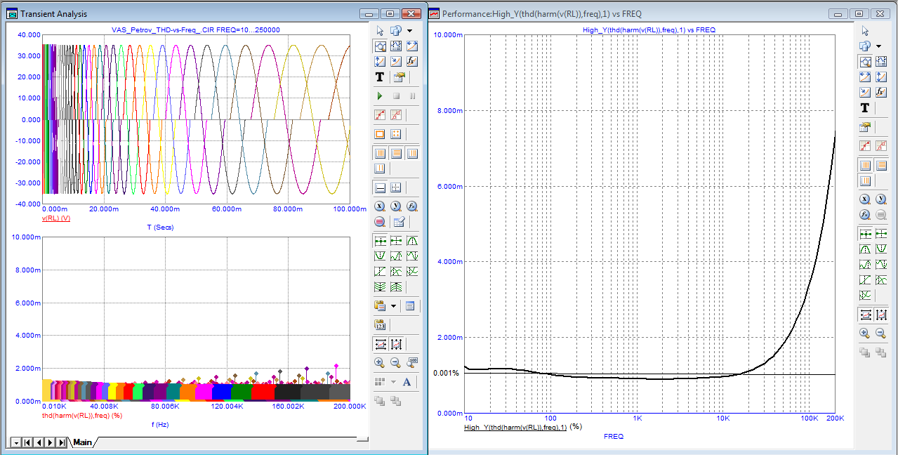

Here is a variant of a voltage amplifier without GNFB, compare with the parameters of your amplifier for a similar purpose.
As you can see, there is no speed distortion in this amplifier as such!

Jan, unlike you, I am not engaged in blah, blah, blah and insults of opponents and their constant humiliation (which you allowed yourself with both Graham Maynard and me), I give specific arguments in the form of tests of specific schemes.
Using specific examples, I have shown that the accuracy of amplification depends on the group delay time and is very important - on its behavior behind the audio band (see the test of the Hafler XL-280 amplifier and voltage amplifier from AudioXpress 2008 08-09).
On tests with the help of burst, I showed the physical meaning of the distortions of the first period (FCD), and also showed what the essence of speed distortions is.
In amplifiers without GNFB, there is practically no speed distortion (I gave a few examples).
Amplifiers with GNFB must have a Group Delay of no more than 100 ... 120 ns, provided that it is constant in a band of at least 200 ... 300 kHz and then has a smooth falloff.
That's actually all that needs to be learned.
