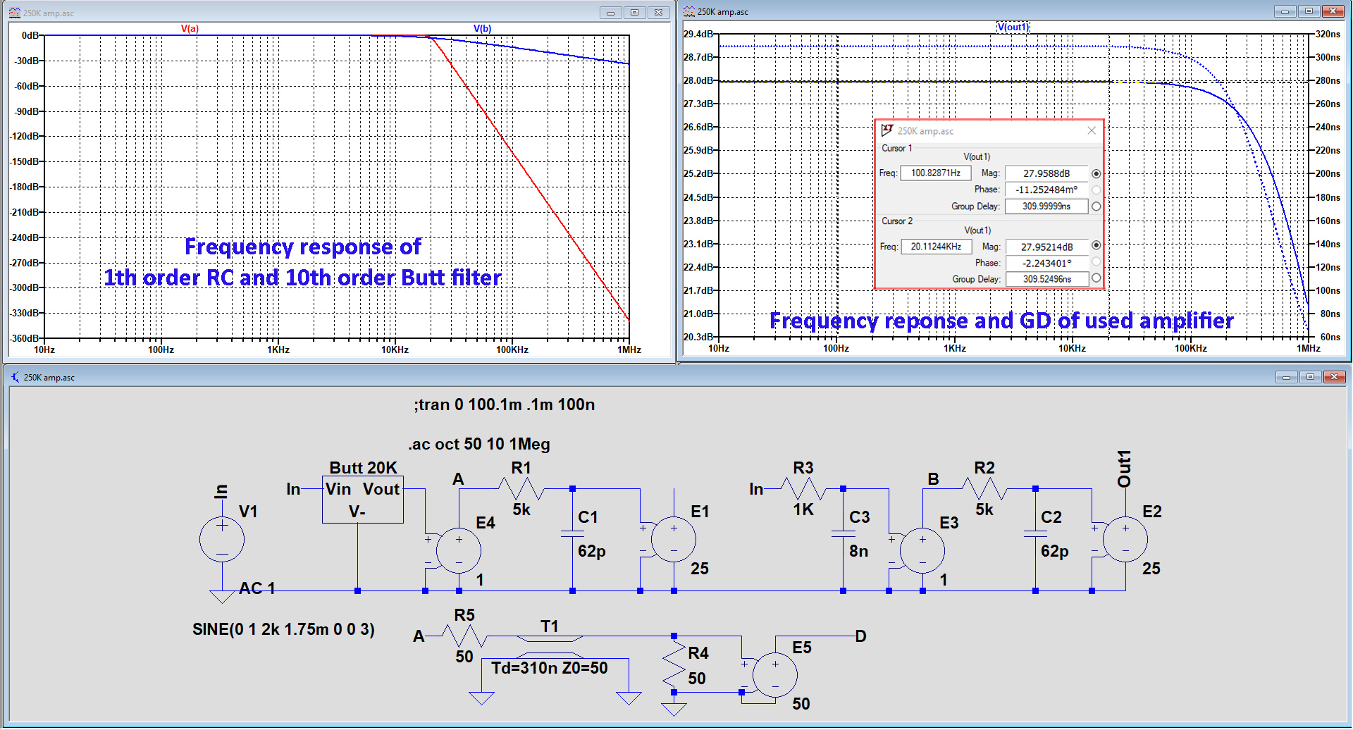

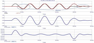

Just to show what non information you are trying to present to us, I took an 500Khz BW "amplifier" with a gain of 25.
Obviously you didn't dare to take the challenge, that's why I did it.
This distortion free Amp has a perfect flat 310nsec GD as can be seen in the first image.

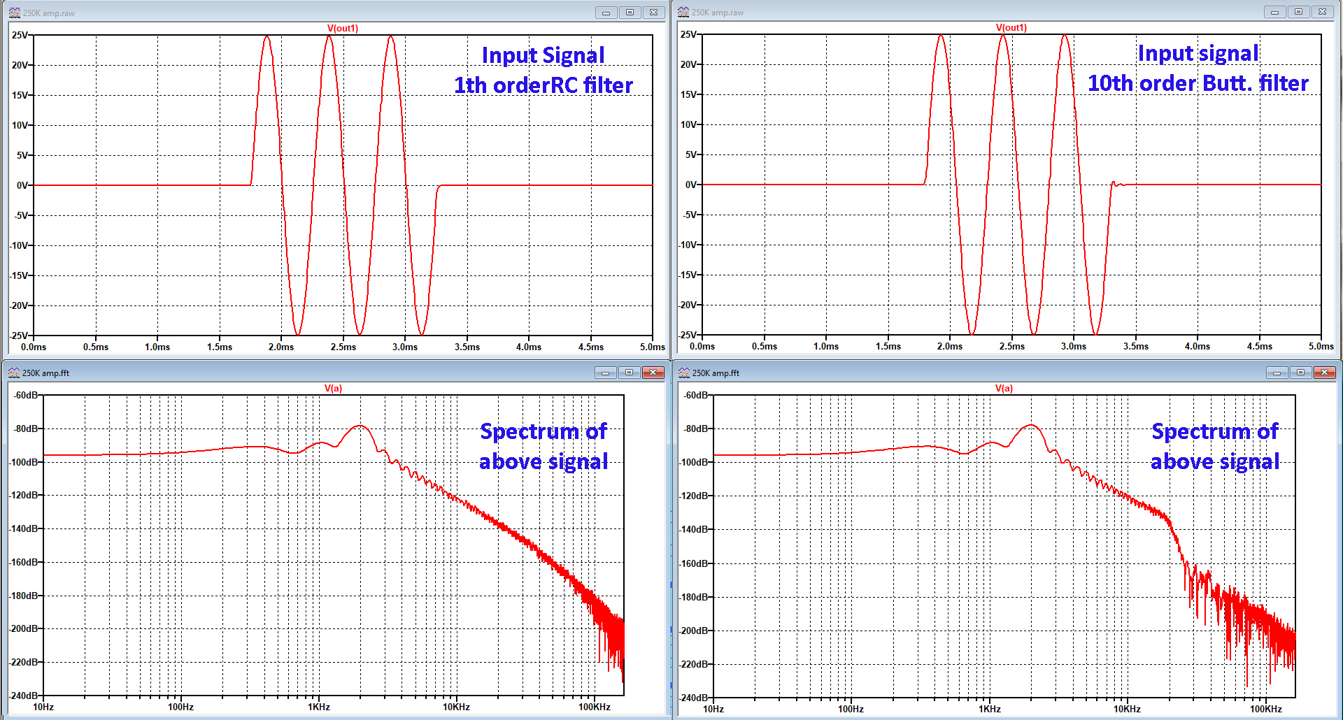

Input signal with three 2Khz sine waves was filtered resp. with a first order RC filter and with a 10th order Butterworth filter, both having their -3dB point at 20kHz.

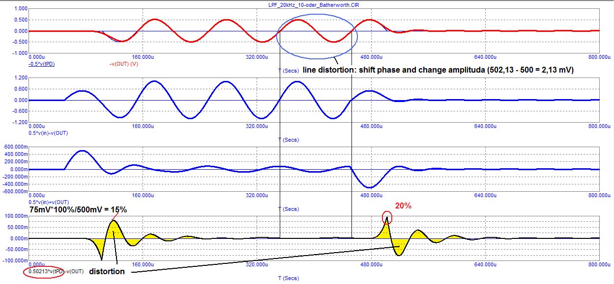

See second image with filtered input signal and its spectrum.
RC filtered left and 10th order Butt. filter at the right.

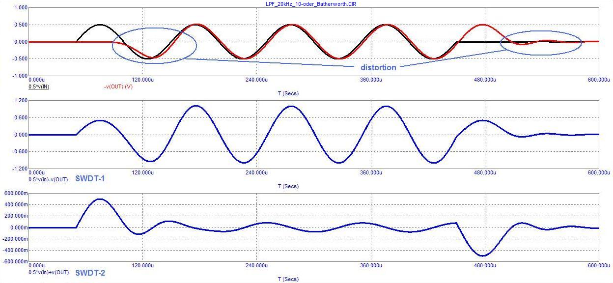

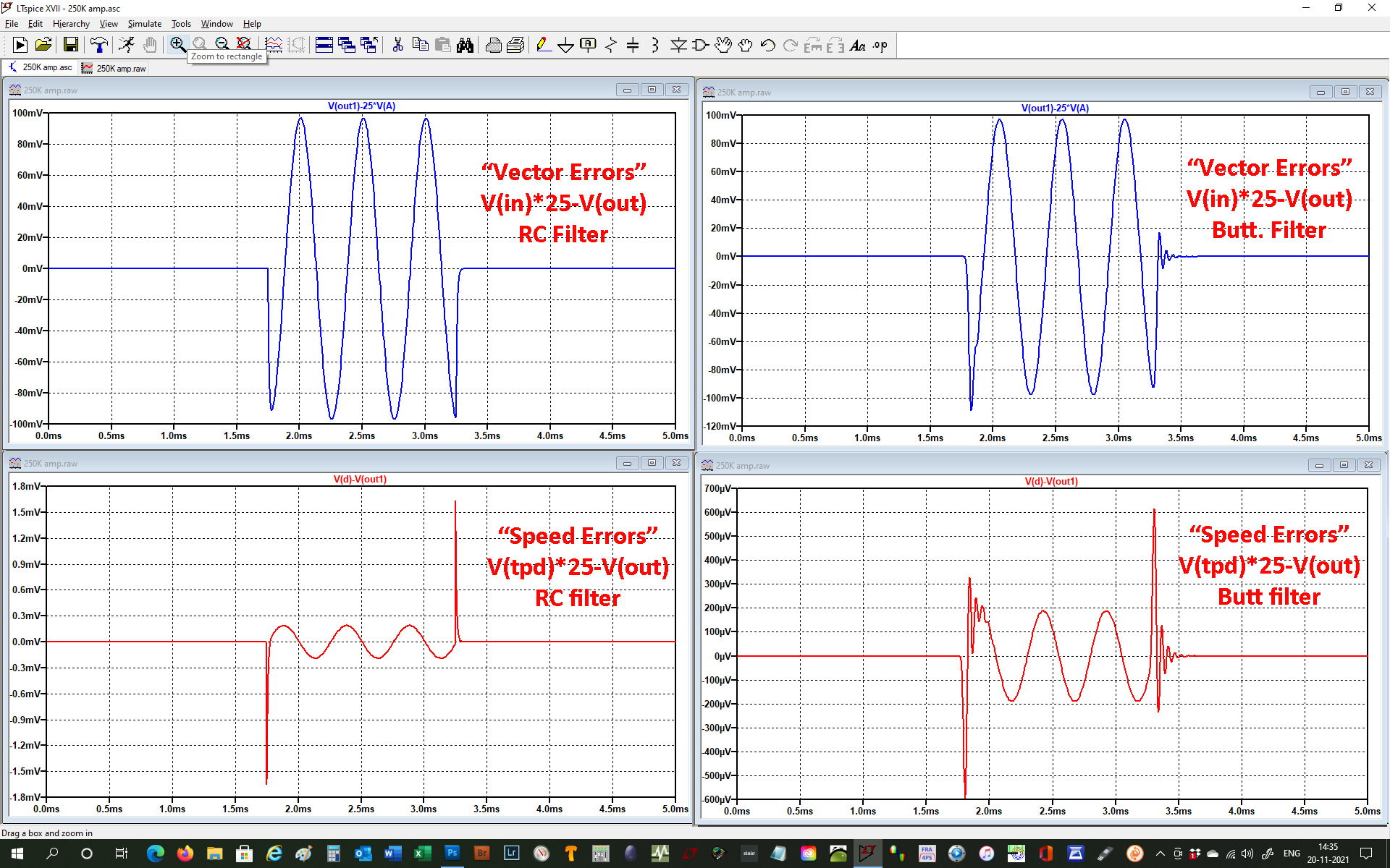

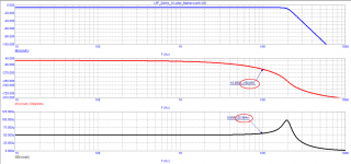

Third image shows the so called Vector errors and Speed errors.
Both errors are largely dependant on the used filters, and since none of both is a brick wall filter, some of the higher frequencies with a different GD are slipping through the filter, leading to so called "Speed Errors" that have no meaning at all, just as the Vector Errors are supposed to show something that is depending on the used input filter, but also meaning nothing at all.
So this all proves that a perfect amp with no distortion can be disqualified by silly test patterns generated by not adequately filtered input signals.

This is a real amp's model, but it shows the importance of the used filter for filtering the input signal.
So when you want to prove something, you should also show the FFT of the used 3 wave input signal.
When it's spectrum doesn't stop abruptly at the point where the GD stops being flat, you are cheating yourself.
And when I need your help, I will certainly ask you, but don't expect this to happen, first do your own homework in a decent way.
So I'm waiting for you to show us an FFT of your input signal.
If you are unable to brick wall filter the used input signal, I will be happy to provide you with one, then we'll talk further.

Hans, I don’t need to show the linear distortion introduced by filters. If you paid attention, I test all amplifiers without an input RC filter in order to see the distortions introduced by the amplifier itself, but I process the signals with a first-order low-pass filter with a cutoff frequency of 100 kHz (as in the DIM-100 tests).
In the third graph, you demonstrate distortion, but you did not even realize that there should be no signal in the middle of the burst (there should be full compensation!), Since your amplifier is perfect. Now send a signal with a frequency of 10 kHz to the same circuits and show what will happen on the 3rd graph.

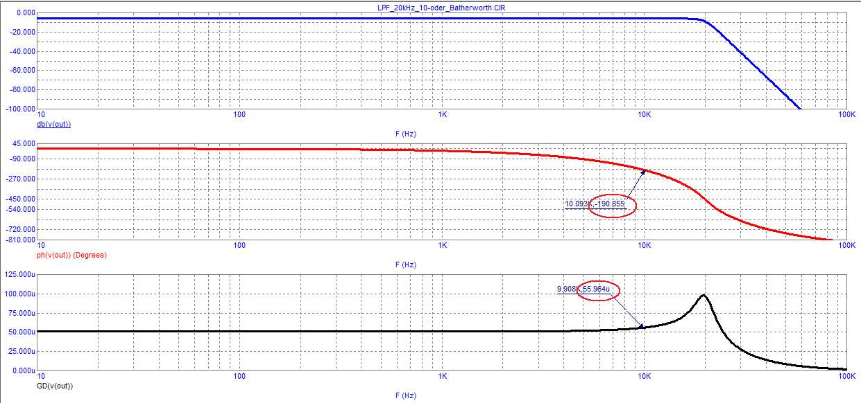

Hans, why in your circuit an ideal amplifier with Ku = 25 if you are measuring filter distortion. What are you trying to prove to me with this?
Here is the Bode diagram of your filter. It can be seen that the output signal at a frequency of 10 kHz is rotated by more than 180 degrees, (approximately in antiphase as seen in the next figure), the signal is delayed by more than 50 μs.
You can imagine what will happen to the signal closer to the frequency of 20 kHz.

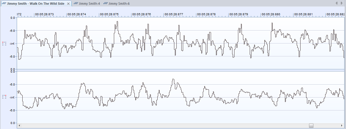

If you think that the square wave signal you showed is what comes out of a DAC, you are a lost cause.
Why would I tell you another DAC and you show me again this non-existing square wave? You're just wasting my time.

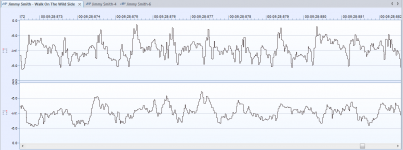

Jan, I didn't think you were that far from digital recording. Here is a snippet of the signal recorded in the CD standard (44.1 kHz, 16 bit) from the audio editor. In this form, it enters the DAK - a converter that converts current into voltage. The converter contains a filter that brings the signal to sound with additional phase and amplitude distortions.
Jan, you can count the steps - there are exactly 44 in 1 millisecond

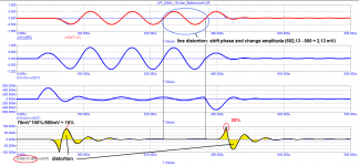

Hans, if you wanted to show me the distortion introduced by a 10th order Butterworth low pass filter with a cutoff frequency of 20 kHz, then at a frequency of 10 kHz they are equal to 15 to 20%.
As you can see, linear distortions are not earlier than after 2 and a half periods.

Excuses, excuses and endless excuses as expected instead of trying to learn something from a simple model.
I'm sorry to say, but this time you have clearly shown a total lack of basic understanding with astonishing little idea what you are doing.
The type of filters that I used are not playing any role at all apart from the only and single condition that after filtering the input signal should have no frequencies above the point where the GD stops being flat.
If so, there will be no "speed errors" that were still clearly visible in #838.
So looking at the phase and GD of a 10th order Butt. filter is completely senseless.
Using your first order filter, as I already suspected, does not fulfil the above condition at all and leaves the door wide open for higher frequencies having other GD's leading to the "speed errors" that you permanently show.
When increasing the BW of the amp but leaving the input signal the same, you will more and more fulfil the condition that there are no frequencies in the input signal above the flat area of the GD.

Hans, to what frequency does the Butterworth 10th order LPF have a flat GD?
The next question is: what filter do you think should be used to test amplifiers in the entire audio band?
I have shown what real distortion a 20 kHz filter introduces into a 10 kHz signal. And do you seriously think that now any amplifier is capable of amplifying such a signal without additional distortion?
