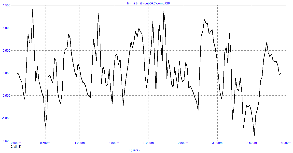

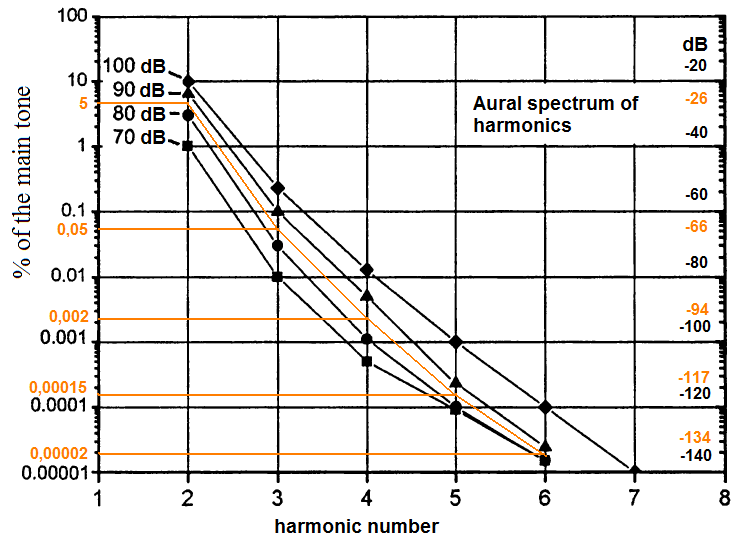

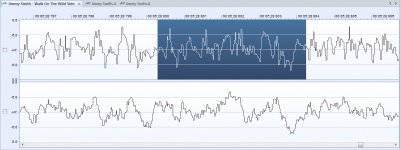

Hans, Here is a sample of the digital recording from the CD.
I took from it a small area in mono, highlighted in dark.

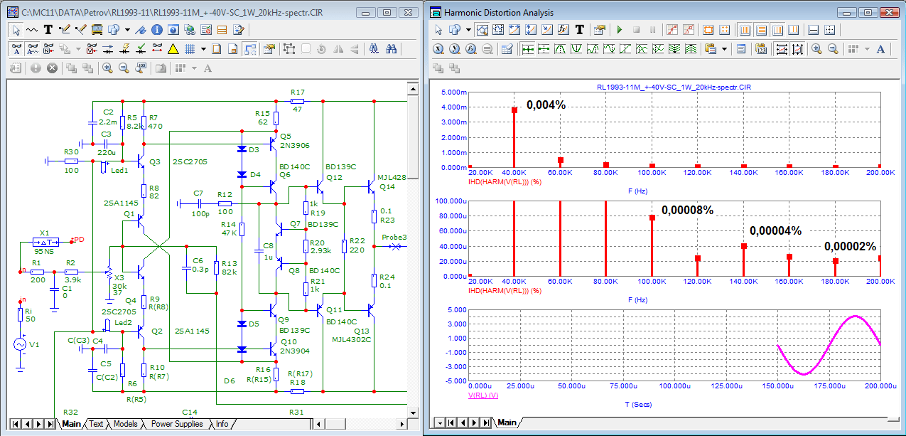

The third figure shows the same fragment of the recording from the DAC output of the onboard computer. In a computer, the signal in this form goes to the line-out and to the amplifier for phones. Question:
can i feed this signal directly to the amp model for testing?

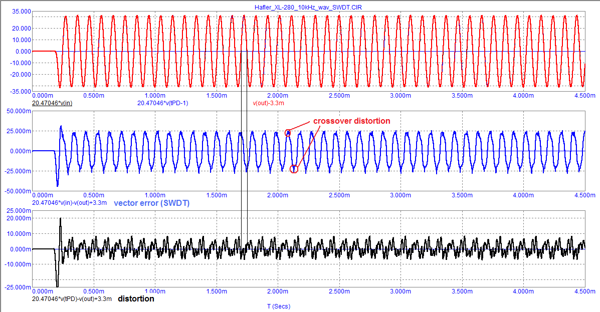

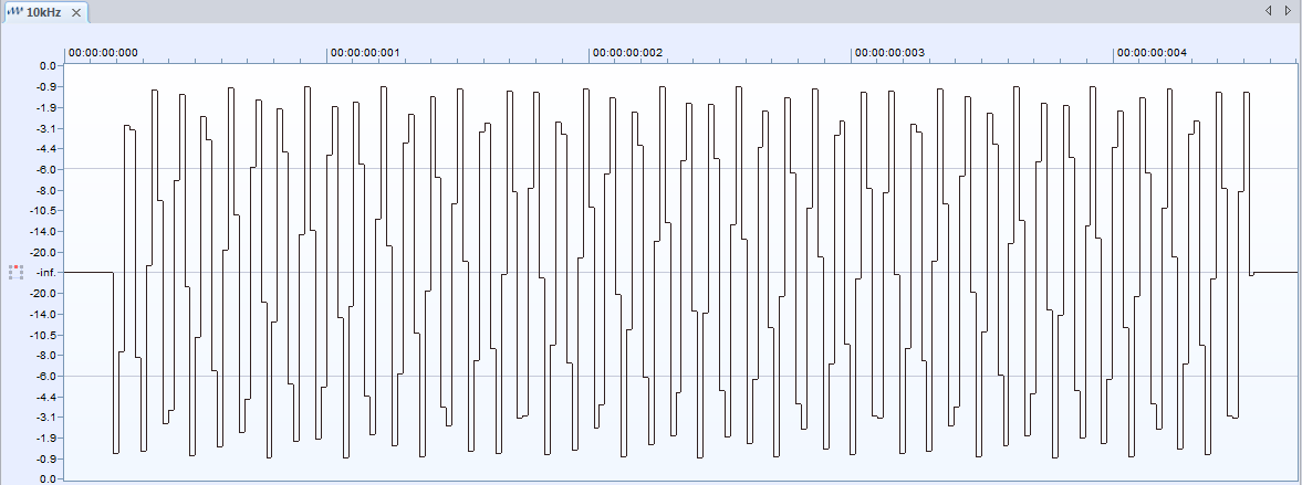

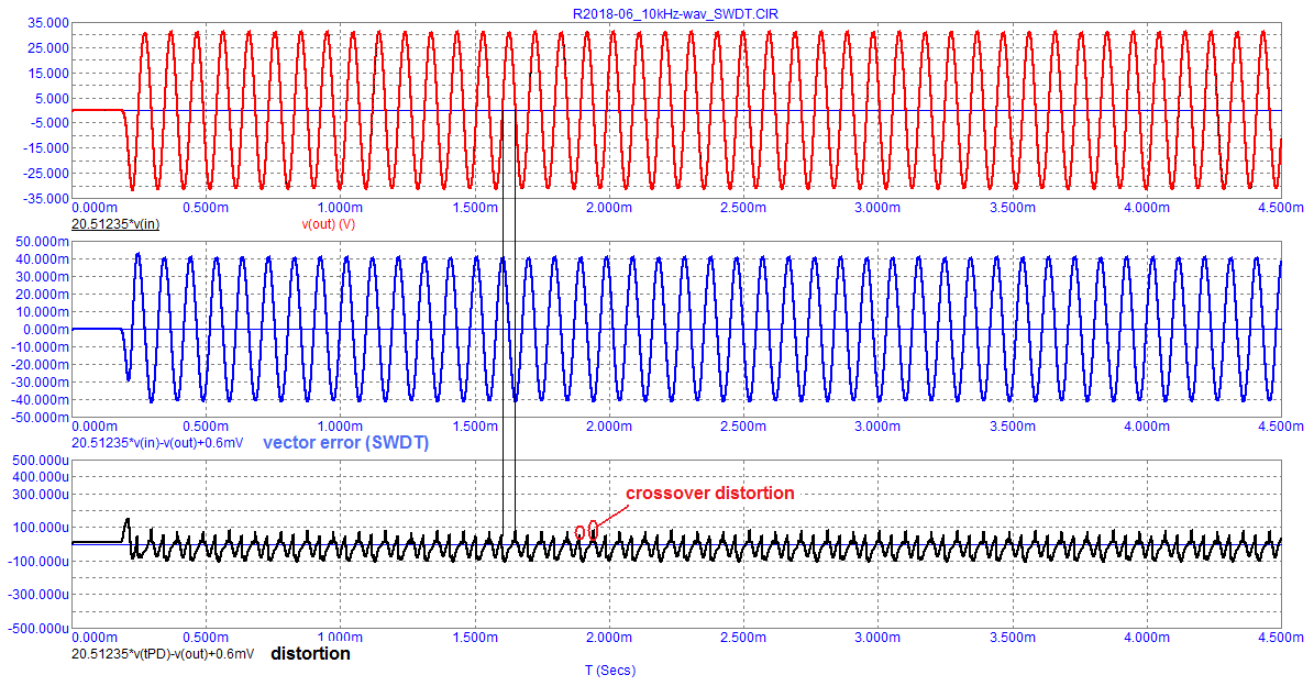

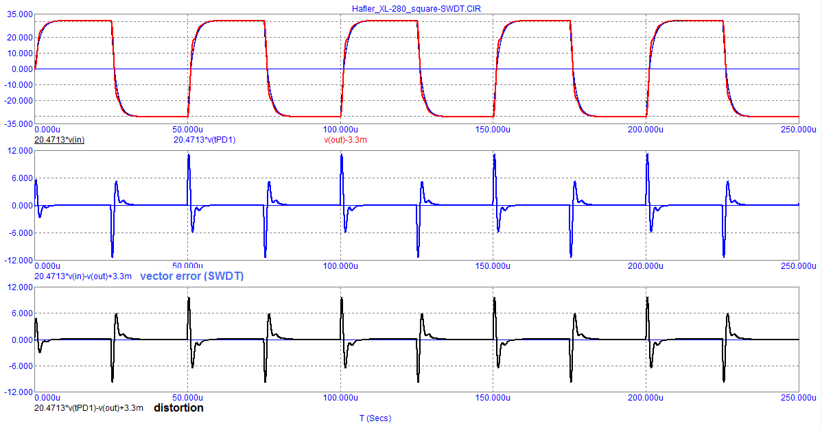

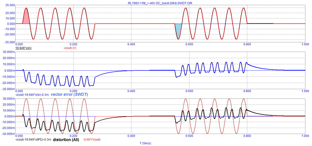

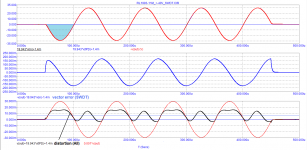

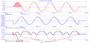

Figure 01 shows a 10 kHz signal digitally taken from an audio editor.
Figures 02 and 03 show the test results of the two amplifiers.
According to Hafler, the vector error at the highest frequencies of the audio range should be no more than -60 dB (less than 1 / 1000Vout). With an output voltage of 30V (peak), it should be less than 30mV. As you can see, Hafler's requirement is being fulfilled.
The second amplifier has about 1.5 times the signal propagation delay, so the vector error is higher.
The lower graphs of the tests show the distortions. I hope it is clear how they are measured from the designations on the graphs.

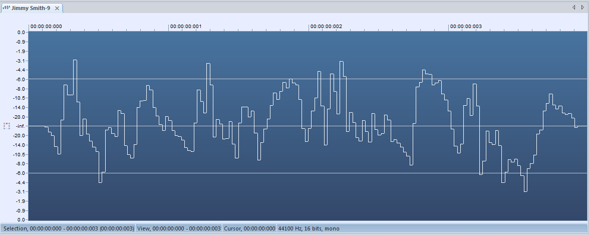

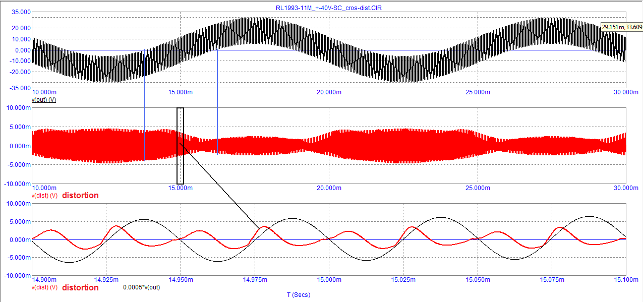

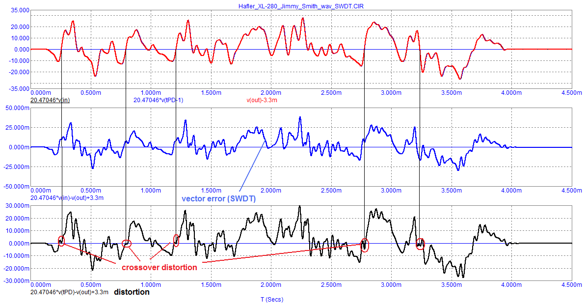

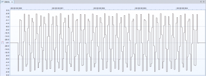

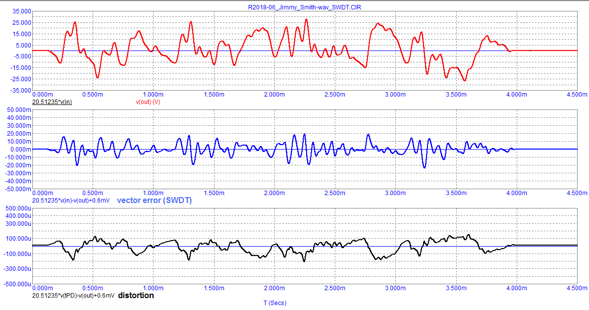

In the next test, we used a fragment of the digitized audio signal in Fig. 04.
In the settings of the models, I did not change anything, only replaced the 10 kHz signal with an audio signal - Figures 05 and 06.
Signal replacement practically did not affect the amplitude of vector errors.
But the distortion in the XL-280 amplifier increased by at least 4 times (12 dB), while in the second amplifier the distortion amplitude practically did not change.
Why such a result I hope is clear from the arguments and explanations given earlier.
There is a problem with the third figure. It appears undersampled and or improperly interpolated (looks like straight line interpolation which is not accurate for filling in between sample points). Was it taken with a scope? If so, what were the scope settings? Where was the probe attached?
If we had a good scope shot of the analog output of the PC, then most likely it will look proper to run into a power amp.

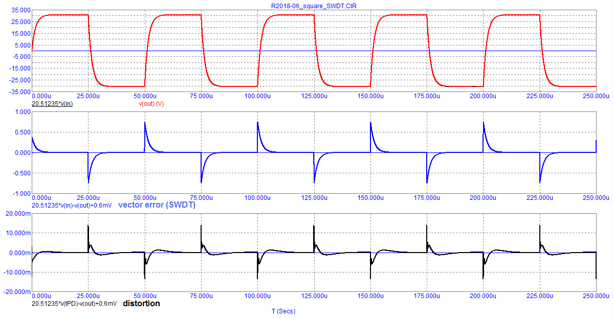

Let's carry out an additional test on a square-wave signal passed through a 100 kHz low-pass filter. The test results are presented in Figures 07 and 08.

Square wave tests can be appropriate for use in stability evaluation. They are not appropriate test signals to simulate normal bandlimited audio signals.
why, the rectangular signal is used in the DIM-30 and DIM-100 tests
Those tests use a low pass filtered square wave, not an unfiltered one with excessively fast rise-time.
the numbers 30 and 100 represent the cutoff frequency in kHz of the first-order low-pass filter. I also use 100 kHz low-pass filter processing.

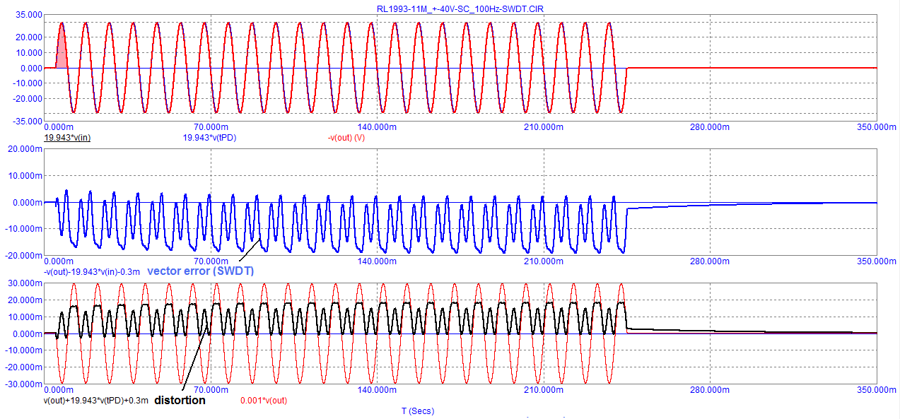

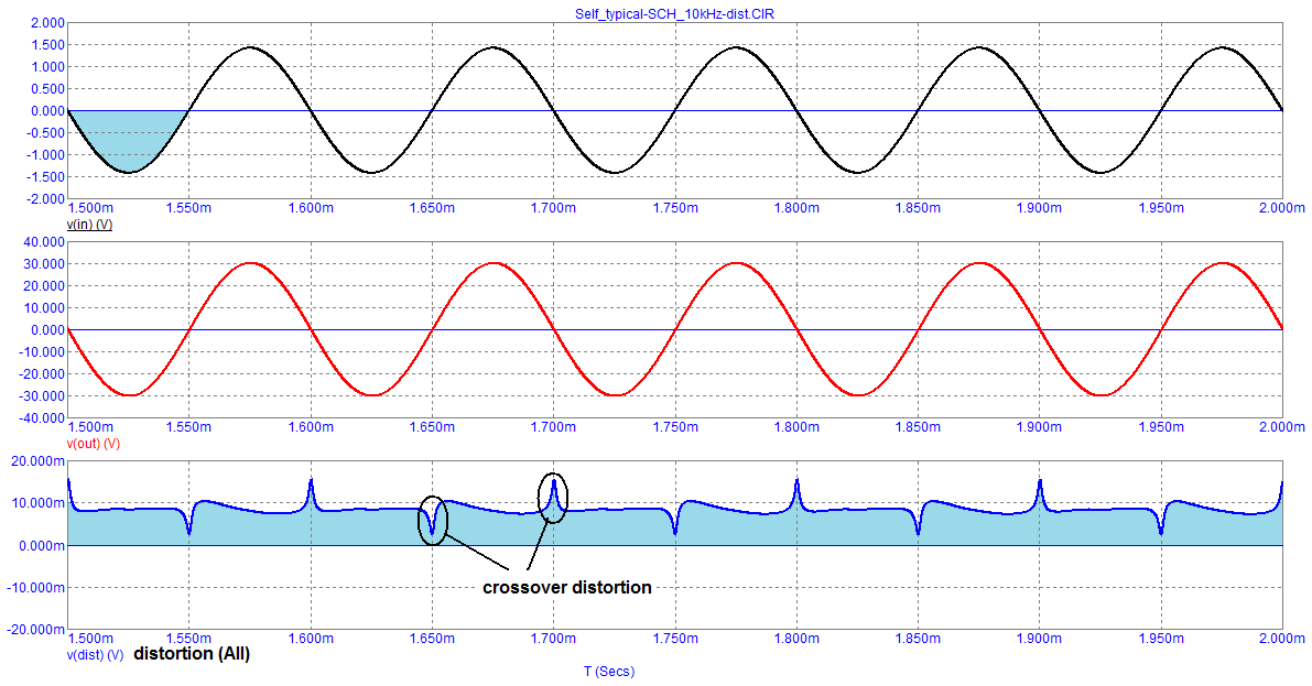

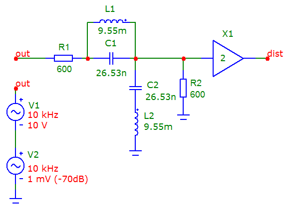

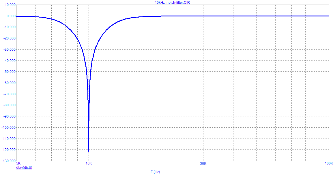

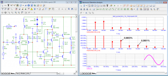

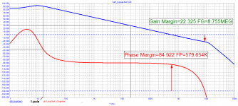

Amplifier distortion outside of standard tests

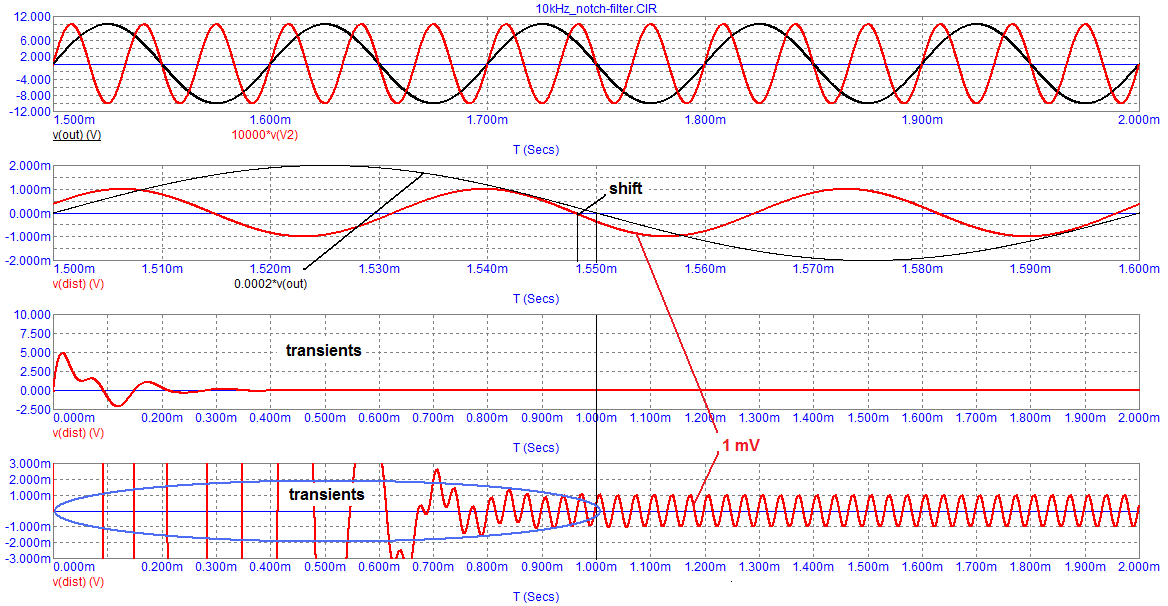

We use a simple 4th-order Bessel notch filter as a measuring device.
From the Bode diagram, it can be seen that it submits the fundamental frequency of 10 kHz to about 120 dB, the 2nd harmonic and higher pass without attenuation.
Let's apply two signals to the input of such a filter: 10 kHz with an amplitude of 10 V (peak) and 30 kHz with 1 mV (peak) - 80 dB.
At the output of the filter, we see only a 30 kHz signal with a level of 1 mV.
But the transient processes in the filter itself last about 10 periods of the main signal and the measurement result can be seen no earlier than after 1 ms.
Let's see what can be measured with such a simple virtual instrument that we cannot measure with standard instruments.

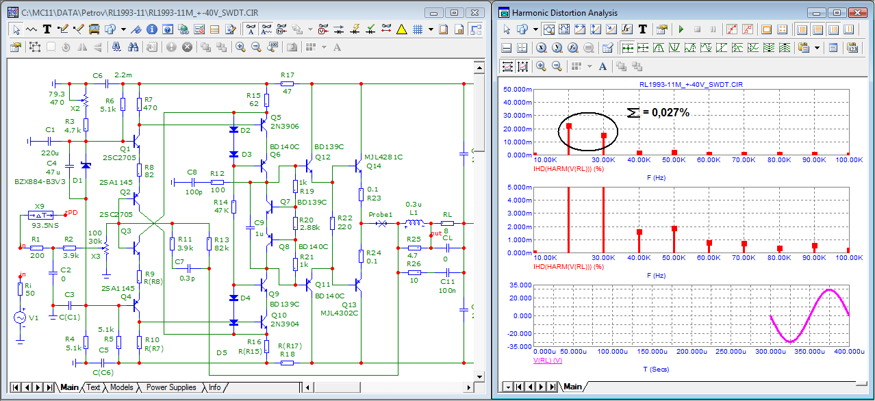

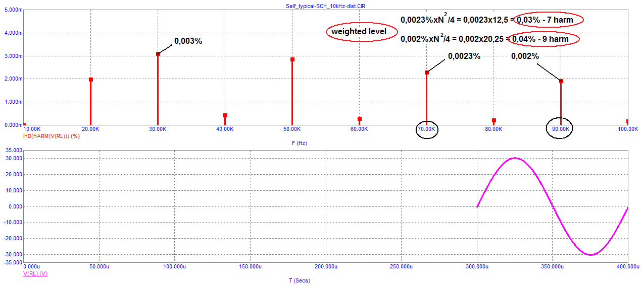

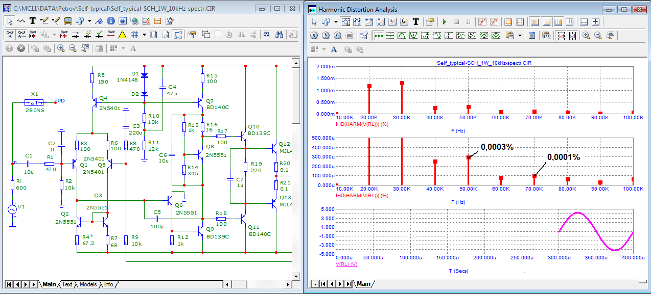

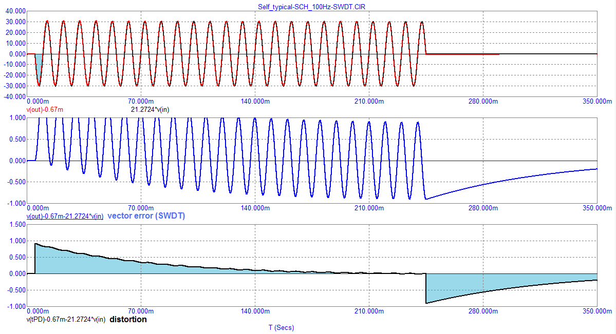

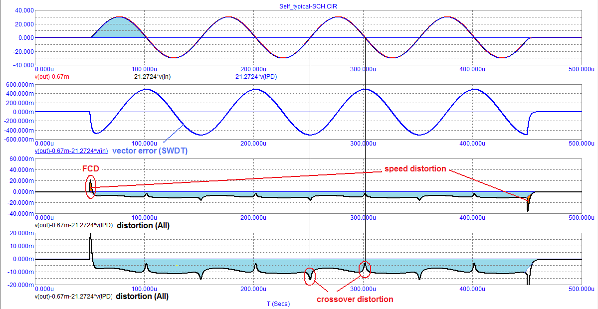

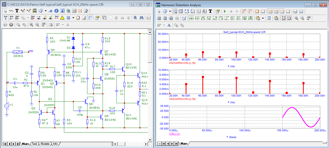

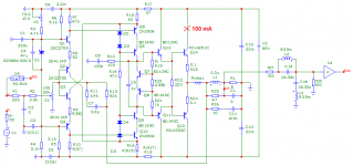

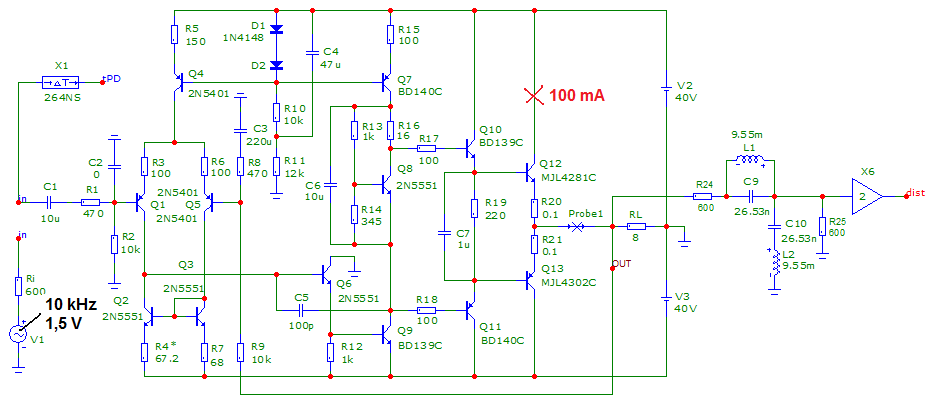

To do this, let's take a typical Douglas Self scheme.

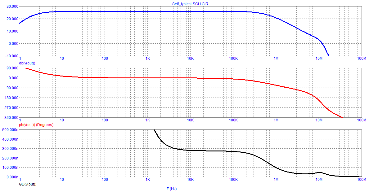

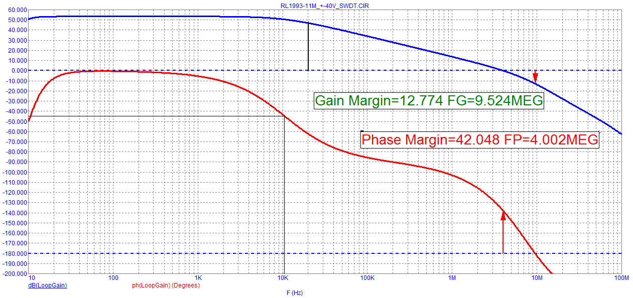

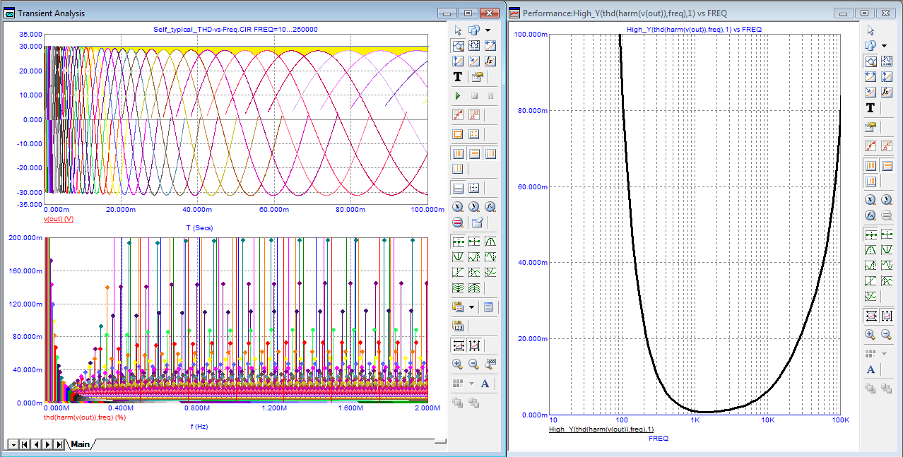

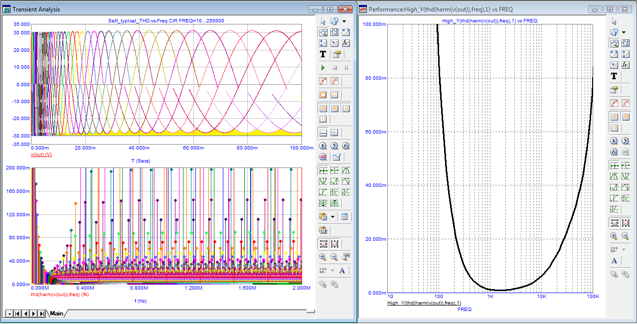

First, let's run standard tests:

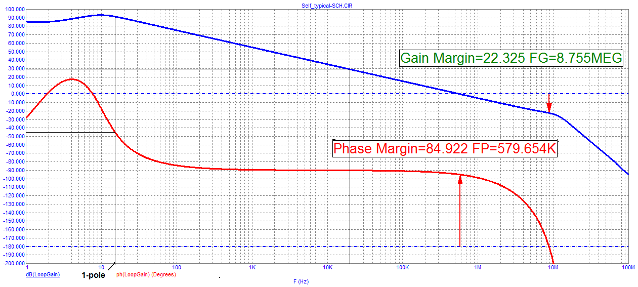

Bode diagram,
loop gain,
spectrum of a signal with a frequency of 10 kHz.
The output voltage contains a wide range of harmonics.
The weighted level of the 7th harmonic is 0.03%.
The amplitude of the switching distortion reaches 10 mV, which is 0.03%.
The same level and constant component in the output signal - depends on the polarity of the first period. When measuring distortions by the compensation method, we see the same distortions as at the output of the notch filter. Only in this case there is no need to skip 10 signal periods. On the burst, in addition to distortions in the steady-state mode, we see velocity distortions with an amplitude of up to 30 mV (0.3%) and more, and the same constant component depending on the polarity of the first period.

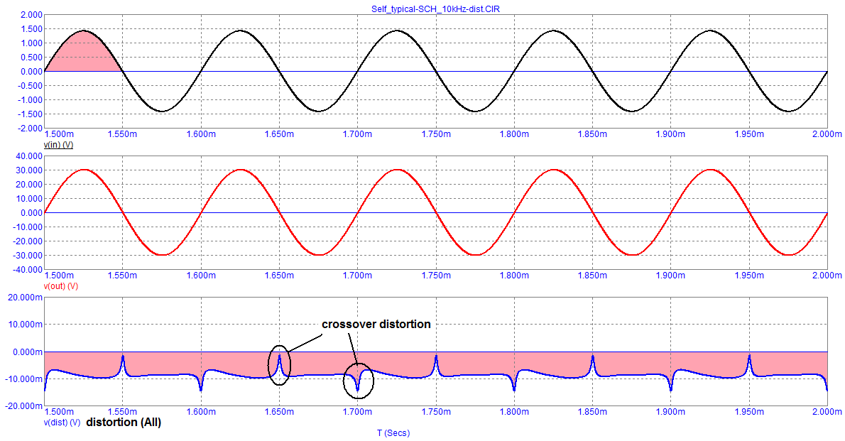

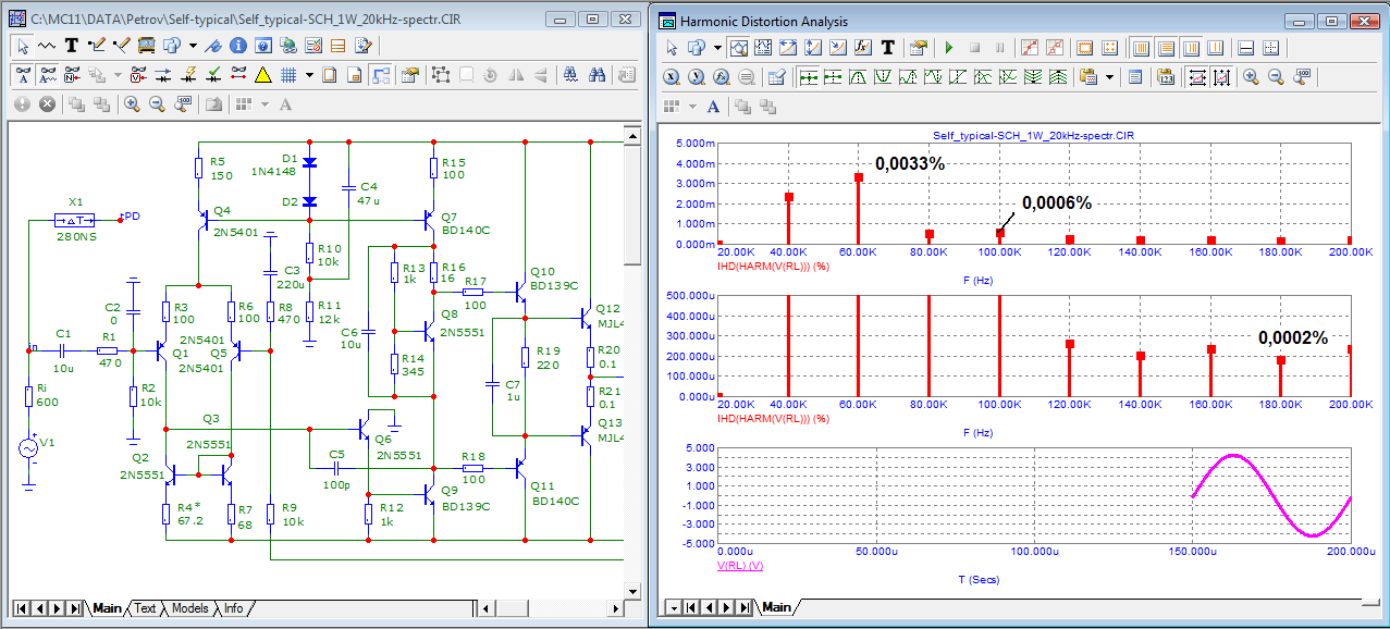

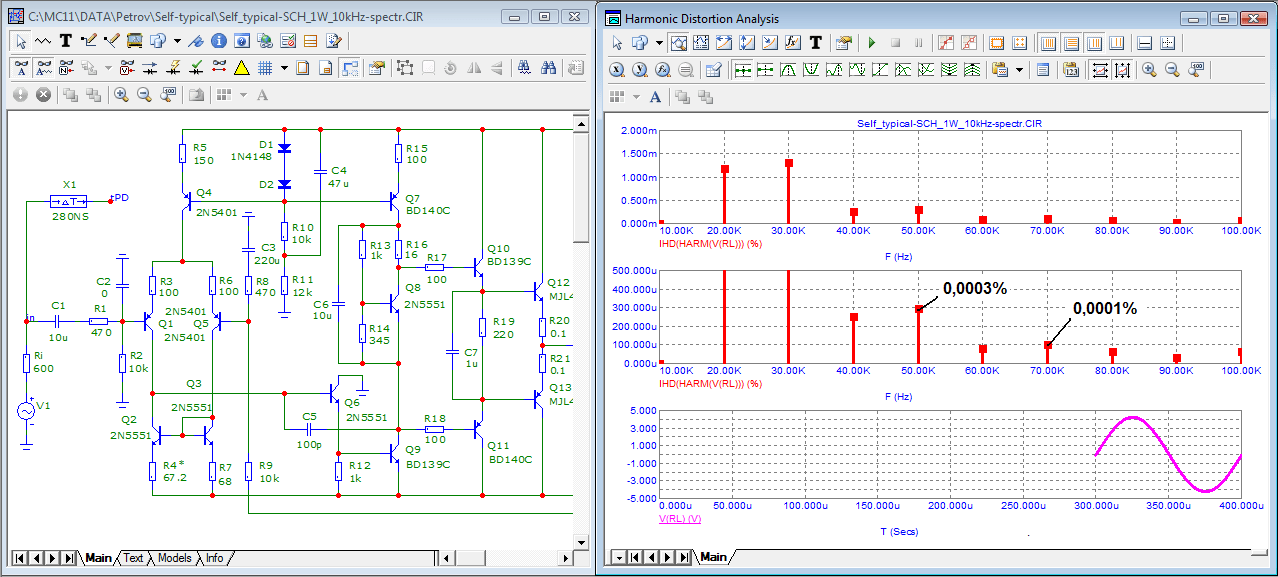

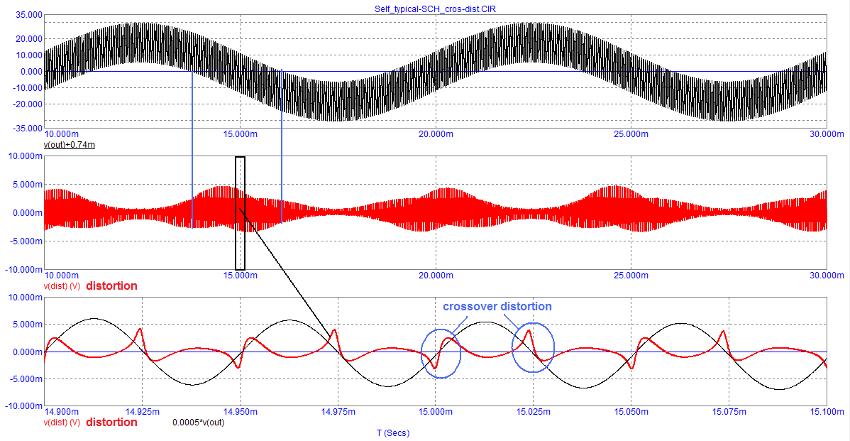

Bode diagram,
loop gain,

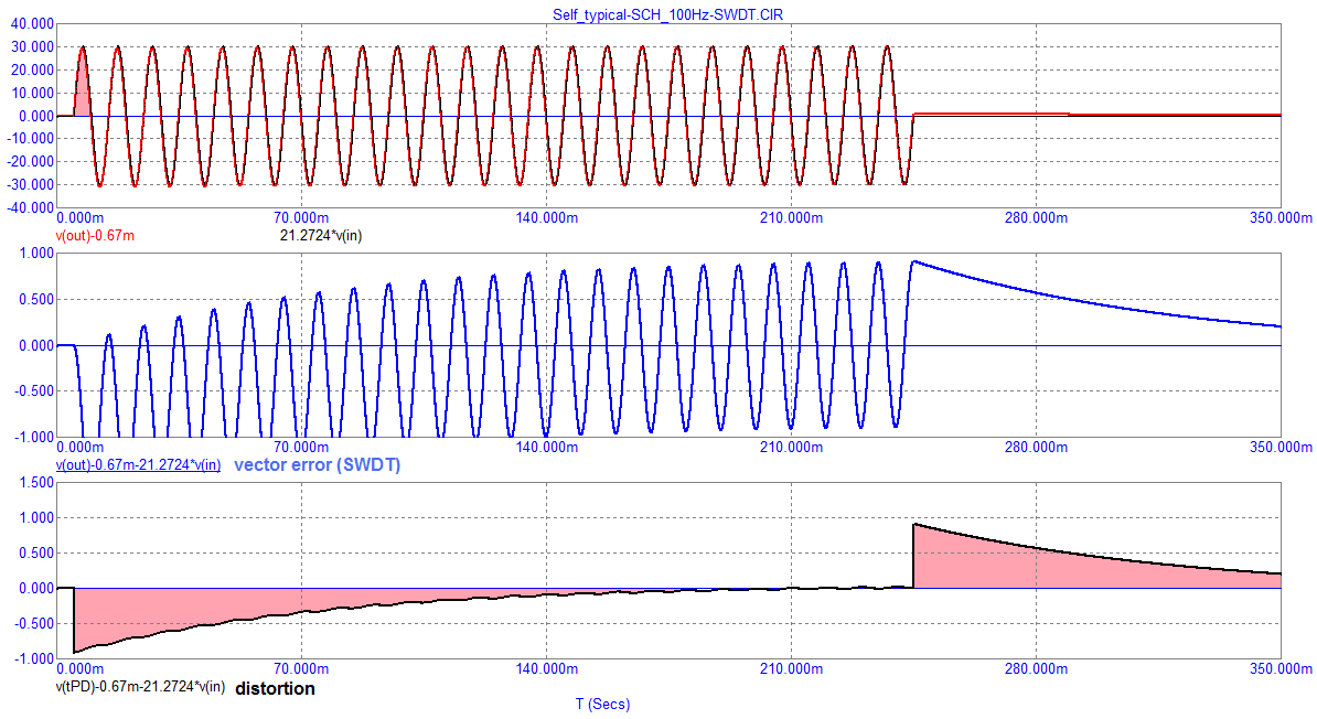

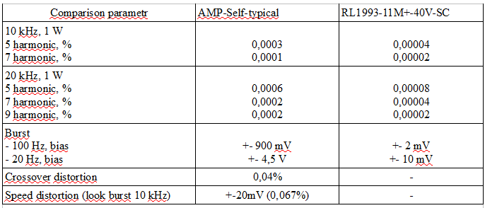

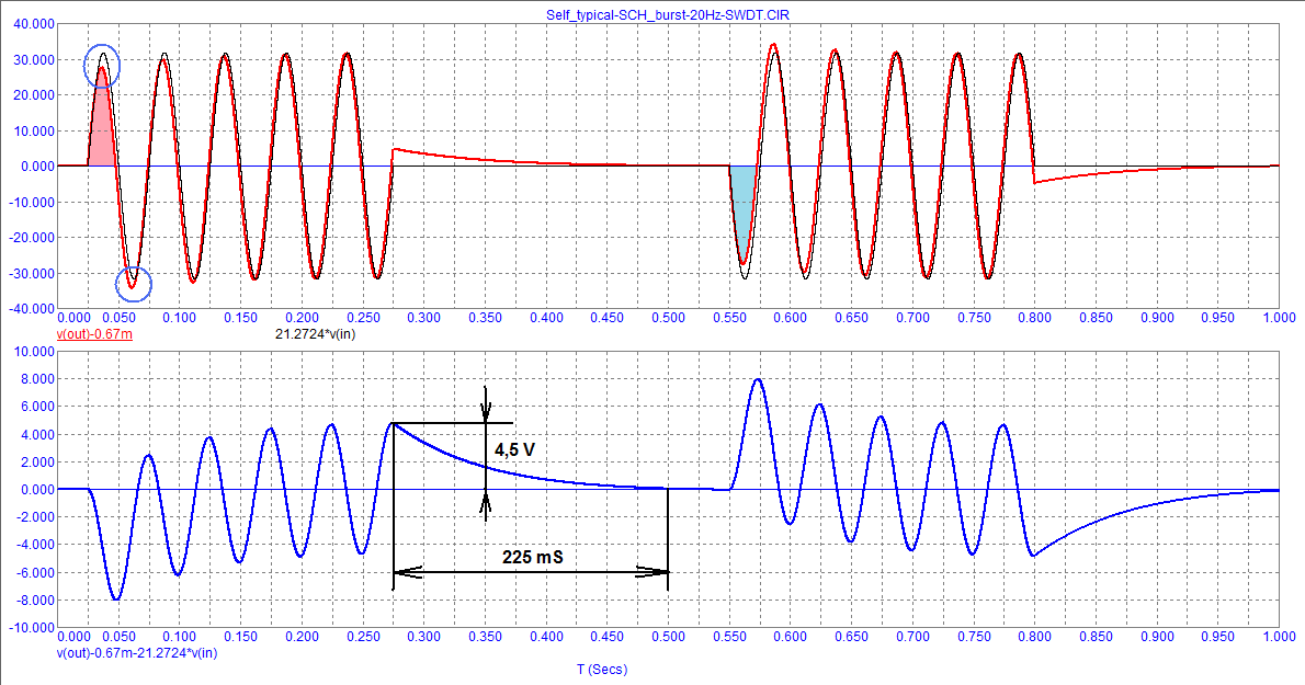

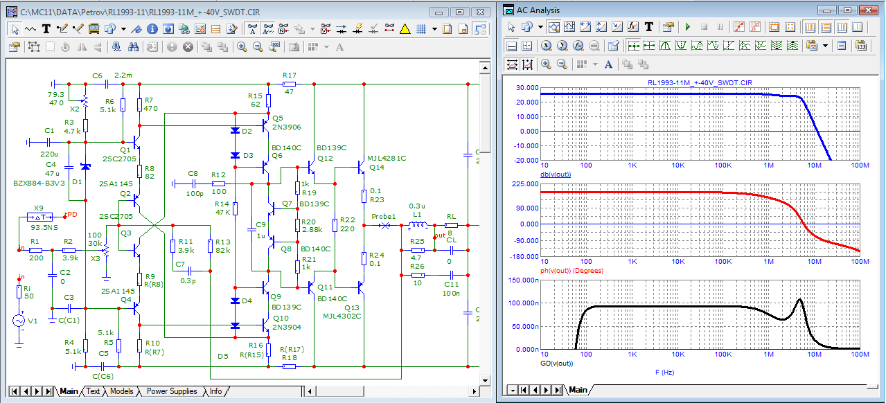

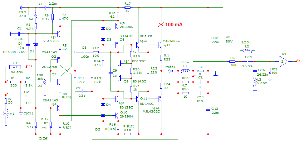

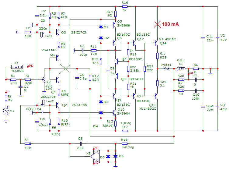

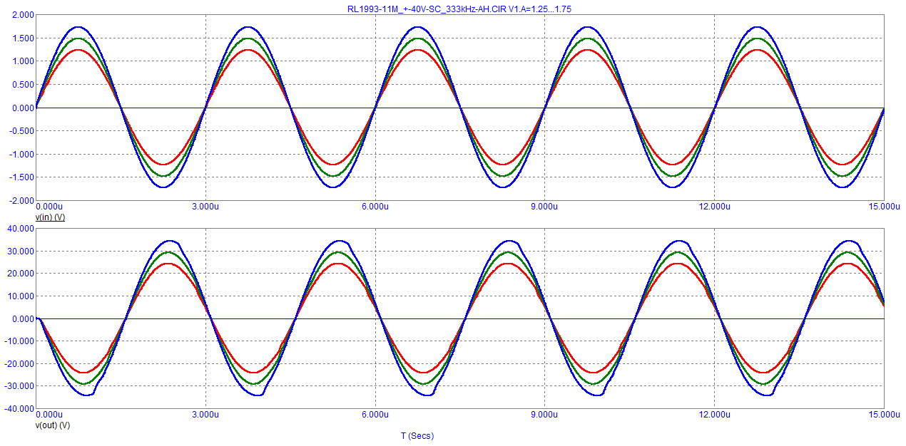

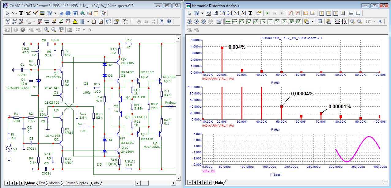

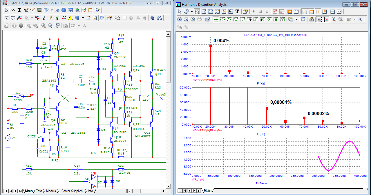

Distortions undetectable by standard measurement methods

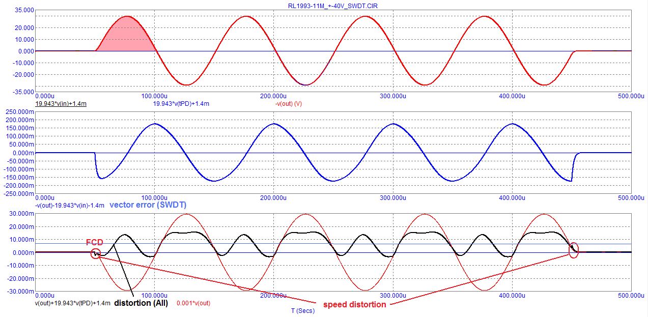

In Russia, amplifiers with an artificial midpoint in the power supply formed by a capacitive divider were once popular. The main popularizer was I. Akulinichev.
Over 30 years ago I also developed a similar amplifier, see diagram. The output stage is the same Darlington double as in the typical Douglas Self circuit, the quiescent current of the output transistors is also set to 100 mA.
As can be seen from the Bode diagram, even with a choke at the output, the signal propagation delay time does not exceed 100 ns (tPD = 93.5 NS).
Group Delay is almost constant up to 500 kHz, At 5 MHz, there is a slight increase in Group Delay, which practically does not affect the parameters of the amplifier. Distortion of a 10 kHz signal is measured by three methods:

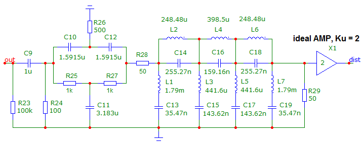

using the FFT analysis of the built-in program;
using a notch filter;
compensation method.
Distortion at the output has a small bias of about 7 mV, which does not depend on the polarity of the first period of the signal. Due to the increased frequency of the first pole and the relatively small signal propagation delay, the distortion of the output signal is free from crossover and velocity distortion.
It is generally accepted that special attention should be paid to the distortion of the first Watt.
At the end there are tests of two amplifiers at 1 W.

Distortions that are not detected by standard tests.
Let's make a SWDT of two amplifiers at 100 Hz.
As the test shows, the output signal with a frequency of 100 Hz of a typical Douglas Self amplifier in the steady state has a signal advance of 48 μs.
The time to reach the steady state (linear mode, the mode where there are no additional spectral components) takes at least 250 ms (25 periods).
In this case, at the beginning of a burst of 100 Hz, an output signal shift of up to 900 mV occurs! The sign of the offset depends on the polarity of the first half cycle. These distortions give a sharp increase in distortion in the low-frequency region in the test of the dependence of THD on frequency (Fig. 12, 13).
My amp with an artificial midpoint at 100 Hz also has an offset of up to 280 mV. Therefore, we had to abandon the artificial midpoint, and maintain zero at the output using a servo control system.
After revision (see diagram), the signal shift does not occur. Distortion at low frequencies is the same as at 10 kHz.
The situation is even worse in a number of amplifiers at the lowest frequency of the audio range. The Douglas Self Amplifier on a 20 Hz burst has a signal offset of more than 4.5 V !, a zero return time of more than 250 ms.
The servo-controlled RL1993-11M amplifier introduces an offset of only 10 mV. The time to return to zero is less than 150 ms.
Note. "Gold ears" claim that the offset of the 50 mV signal is already well audible and has a negative effect on the sound.
Additionally, tests for the presence of crossover distortions have been carried out. I want to draw your attention to the fact that both amplifiers have the same output stages, with the same quiescent current. At the same time, in one amplifier we see clearly pronounced crossover distortions, and in the second there are practically none.
Crossover distortion test carried out with a modified filter
