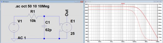

It seems you have learned something, to show your speed errors, you should limit the BW of your signals with just a few cycles to the BW where the GD is flat.Amplifiers with GNFB must have a Group Delay of no more than 100 ... 120 ns, provided that it is constant in a band of at least 200 ... 300 kHz and then has a smooth falloff.
That's actually all that needs to be learned.
For the 250Khz BW amp shown here having a flat GD of 620nsec, this signal should be limited to 20Khz max.
The 100nsec that you mention is 5 to 6 times faster, only possible with a 1.5Mhz BW amp, completely insane and over the top.
I propose as an exercise to use this simple amplifier and show all your pictures with vector error, speed error etc. etc.
Then we can analyse, because a linear filter process has no distortion.
And please don't start with an another subject, just do this for a change.
