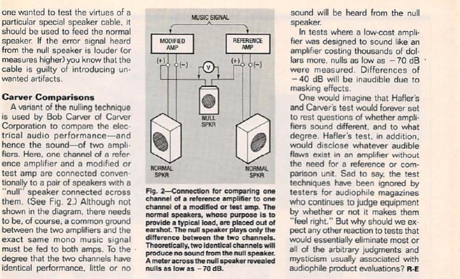

A short description of Hafler’s and Carver’s tests.
From Radio Electronics, November 1992.

And here is my first reaction:
When something comes out of the null speaker, what does it tell other than that both amps do not reproduce the same output for whatever reason.
But how to interpret this, that's a tough question to answer and does it really reveal what it is envisaged to reveal, namely difference in perceived sound quality ?
If you hear a difference in the loudspeaker, it means that the difference voltage after subtraction falls into the audio band. But besides the audible part, there may still be something above the audio range. This means that there may be an option when we see the difference with an oscilloscope, but do not hear with our ears. And then a logical question arises - does what is left out of the band have an impact on the sound? I think if it does not affect the stability parameters and does not overload the input stage with a differential signal, then it is not so important.

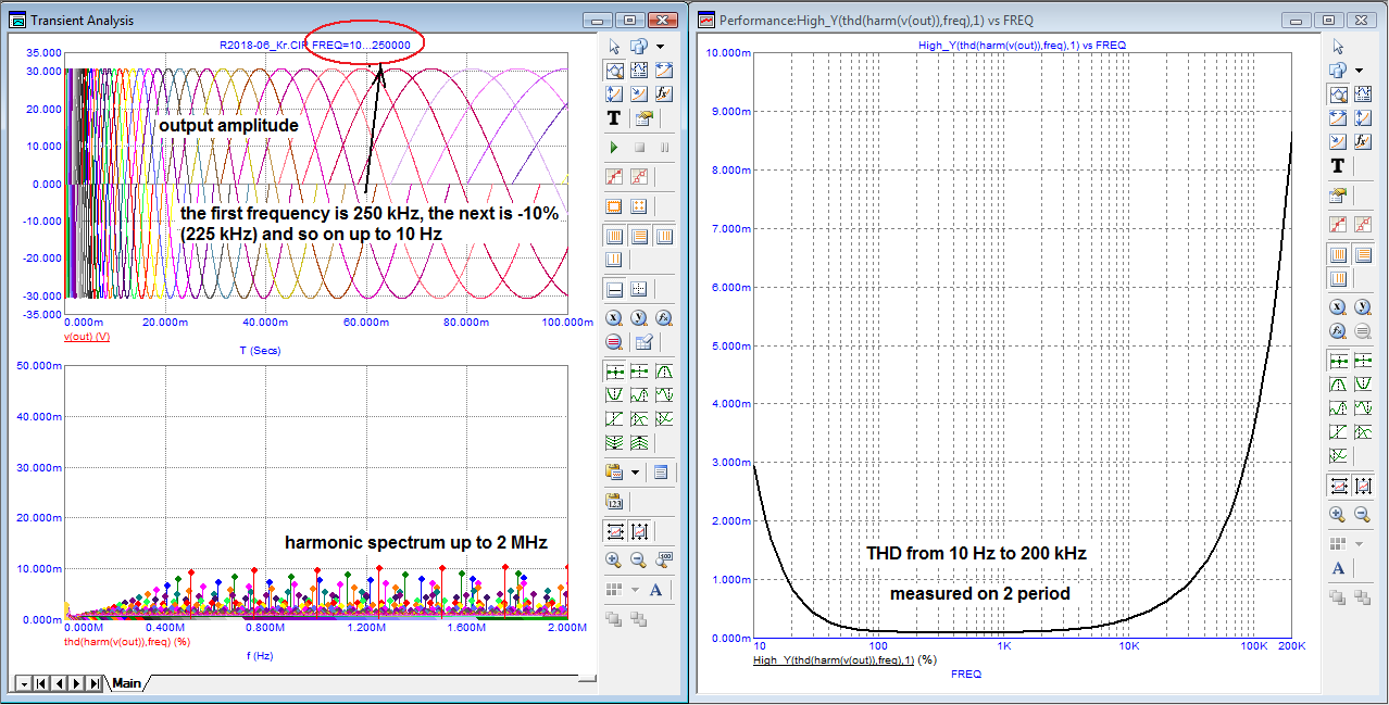

Is there anyone here who understand the microcap graphics? help explain to those who do not understand, please!
It is not a matter of understanding the graphics. That is your basic error. People do not question things because they don't understand the graphics. They would like to know what they represent and what they prove.
It is what they represent. You always fail to provide the context and so after two years you still don't get anywhere, because of your basic error and apparently your ego does not allow you to think it through.
I can throw up any graphic I want and play Banksy.
What is needed to convince people is a narrative (google that) to go with the graphic.
An imaginary example: 'This graphic shows level versus frequency of the output of amplifier xyz. Because of the R33 and C44 forming a phase lead in the forward path, the tPD will have a rising part starting at 0.234MHz. The effect on the feedback transient shows in the graph at vwy. If this is not compensated, it will be audible as blablabla."
Now we know what the graph is, what it means, and the effect of what is shown on the reproduced sound. Now we can discuss.

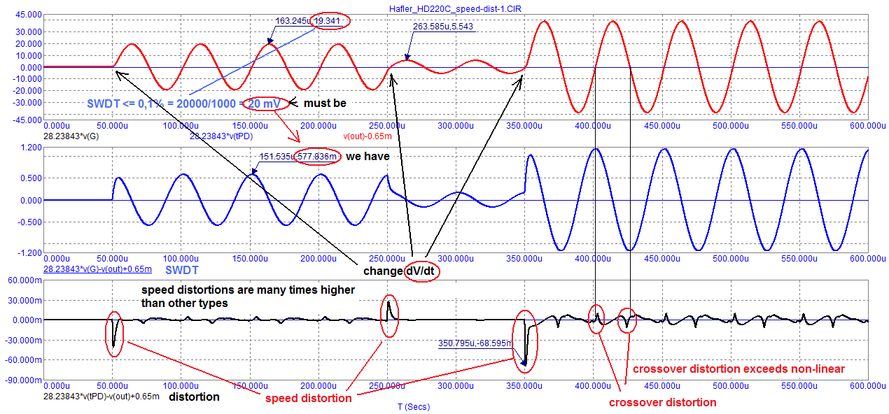

I didn't think my Banksy had to be chewed so thoroughly. Okay, back to this Hafler test. According to Hafler's calculations, this section of the SWDT sinusoid should be only 20 mV, but we have 580 mV! - 29 times more (-30 dB instead of -60 dB) - depends on tPD. Hope this is clear.
Move on. We measure all kinds of introduced distortion by subtracting the output voltage from the voltage of the ideal amplifier (which we are aiming for). For this, the voltage of the ideal amplifier is shifted by the time tPD at the test frequency. The result is shown in the lower graph. The graph shows that in the steady state we have only nonlinear and crossover distortions up to 10 mV (this is 0.025% of 40 V). At the same time, we see that speed distortions can be many times higher.
fagos asks: can crossover distortion be heard? The answer is simple: if they weren't audible, they wouldn't be driving class A amplifiers. Although not all class AB amplifiers are subject to these distortions, I have shown examples. Speed distortions occur at any deviation of the signal from the sinusoid (change in frequency, change in amplitude). But in a musical signal this is a continuous process! And if crossover distortion is heard, why shouldn't speed distortion be heard? Which are several times larger and more often than crossover. I hope these comments are enough for this test.
