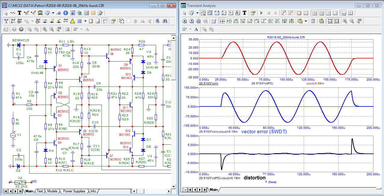

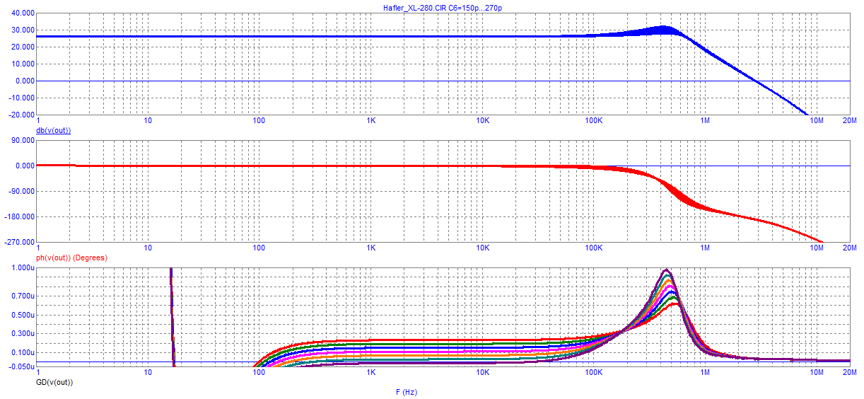

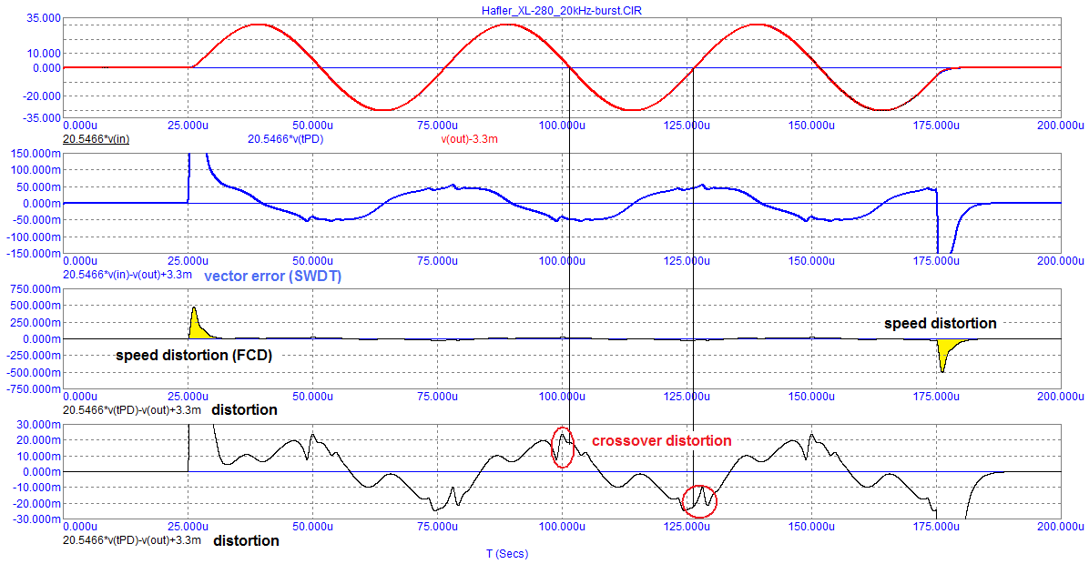

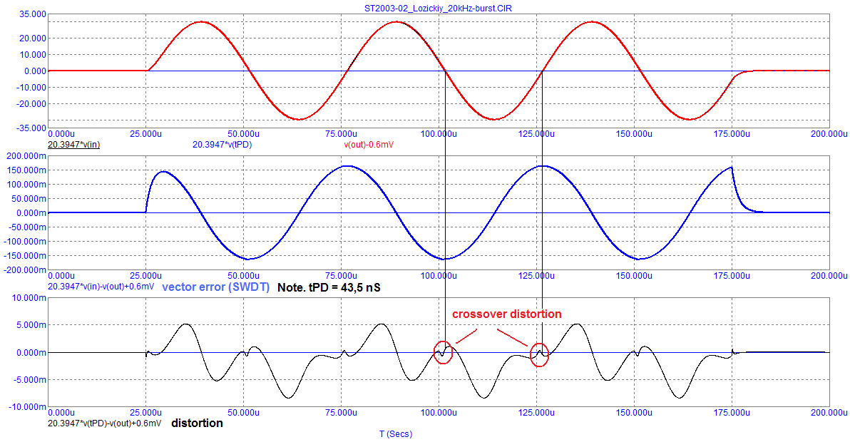

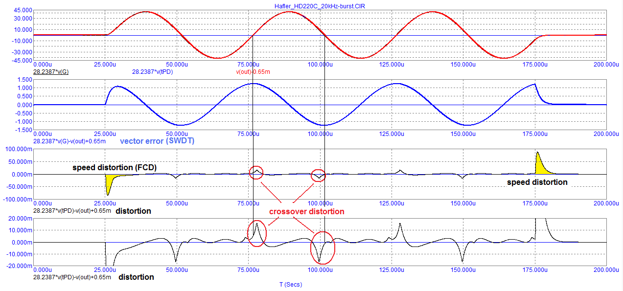

Compare the 3 characteristics of Group Delay and the dependence of speed distortion on its magnitude and behavior outside the audio band.
And although the signal transmission delay in the Hafler amplifier can be adjusted over a wide range (from zero to hundreds of nanoseconds), nevertheless, at a frequency of 450 kHz, the Group Delay rises to l μs. It is this rise that is responsible for speed distortion.
As practice shows, in the absence of boost and Group Delay <= 100 nS, speed distortions are commensurate with other types of distortions and do not significantly affect the color of the sound.

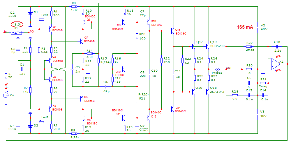

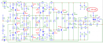

In order to increase the output power, I increased the supply voltage from + -27 V to + -40 V and added paired transistors. The rest of the changes are almost insignificant. Here is a schematic diagram of the model that was tested.

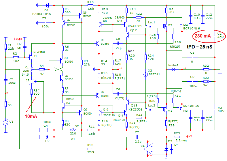

The scheme is higher in your opinion worthy to present you and your views at the moment? Are you ready to make it and carry out real measurements to confirm your ideas, how does SSASSEN offer?

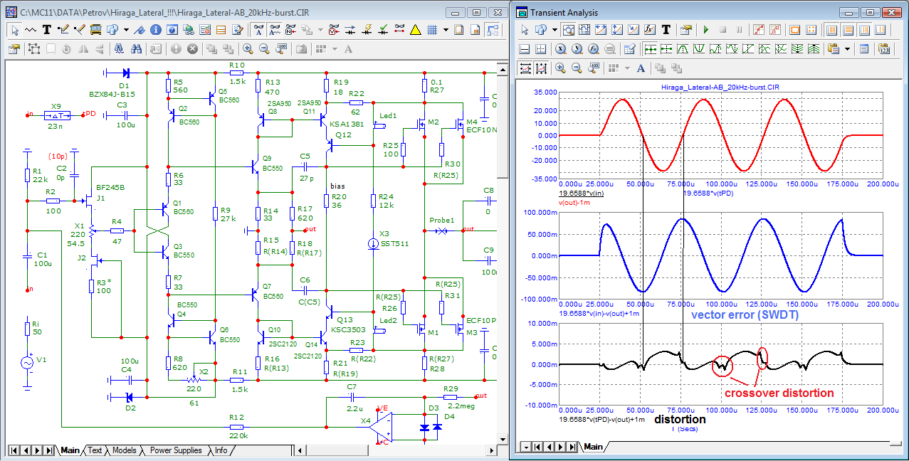

or this amplifier circuit
fagos, read carefully what ssassen wrote and do not compose for him
Lozitsky's amplifier was repeated by thousands of radio amateurs and confirmed its parameters. The circuits proposed by me are also with a current feedback and have similar parameters.

for this you need to understand the essence of the Hafler and Carver method and how to apply it correctly
on a number of examples, I showed that measurements on sinusoidal signals (in steady state) are equivalent to measuring THD. The tests should use a 10 kHz triangular signal, a square wave, 1/3 octave noise, or 10 ... 20 kHz bursts. I've shown enough examples to understand the difference.

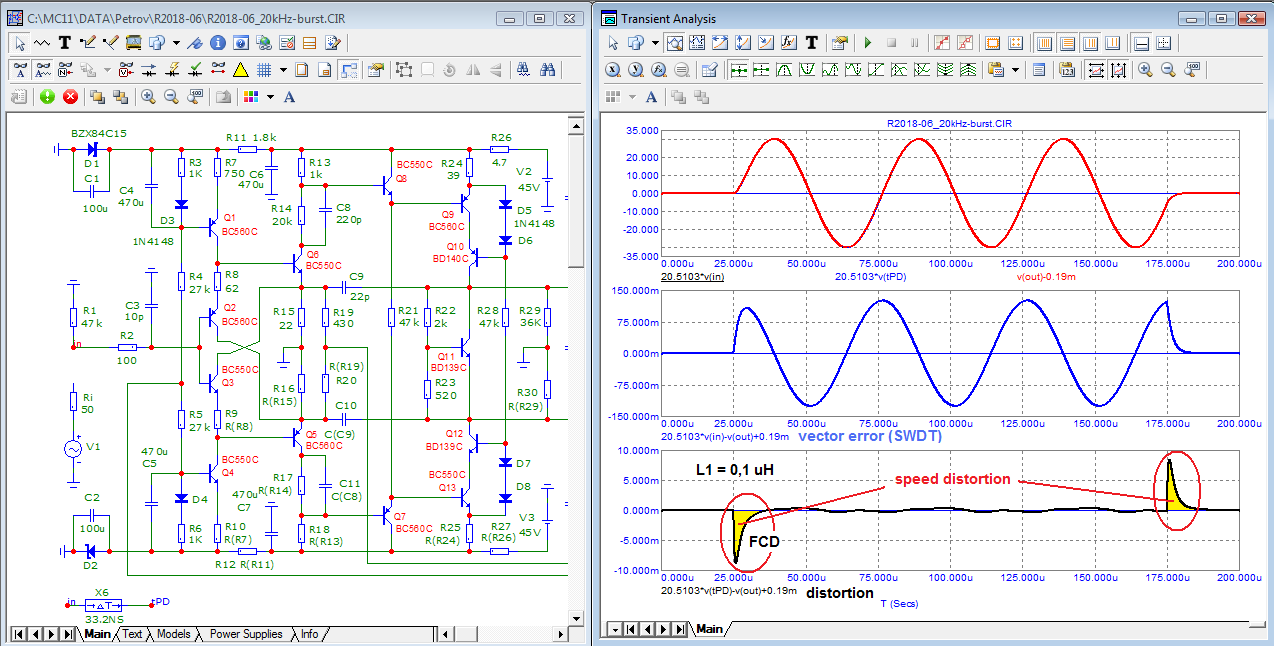

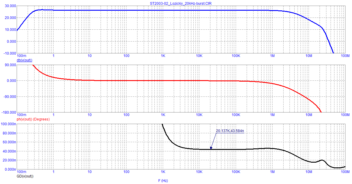

John Curl and Graham Maynard have repeatedly talked about the detrimental effect of an amplifier's choke on the output on sound quality. But apart from ridicule, it caused nothing.

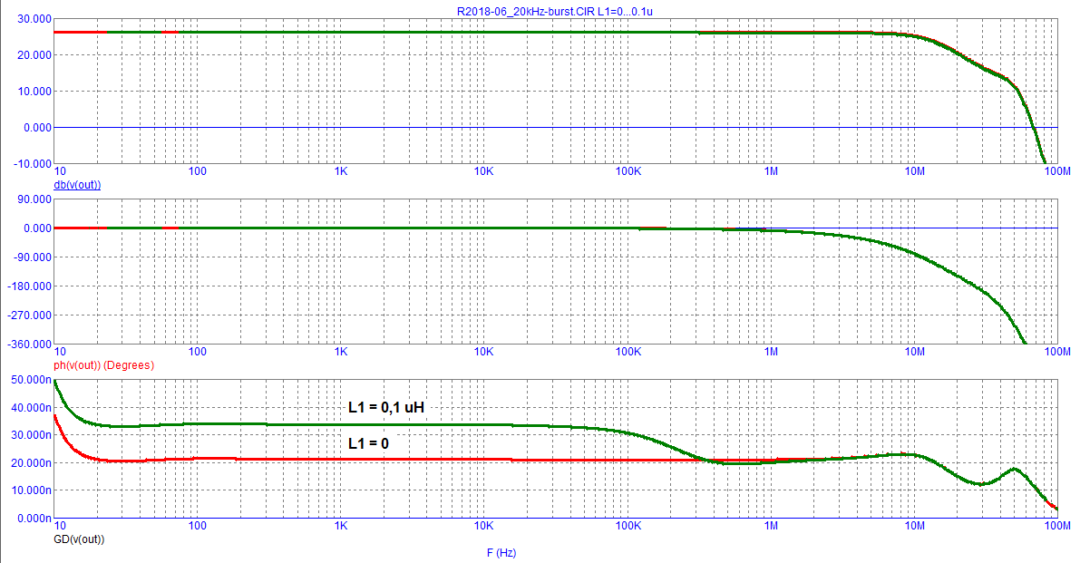

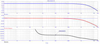

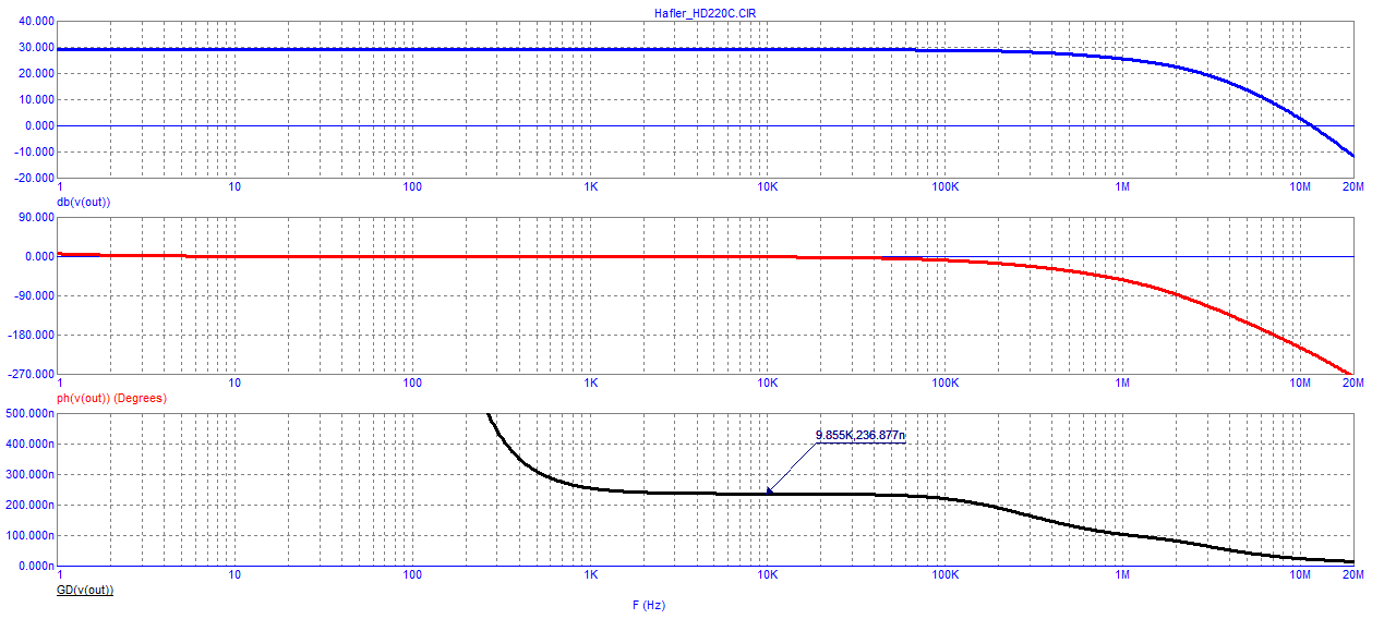

Note the choke and non-choke Bode diagram. Some authors (in particular, fagos) argue that they do not need the Group Delay graph, they say that the frequency response and phase response are enough. But on the frequency response and phase response, there are no obvious changes with the addition of a choke.
Let's consider this influence on two tests.

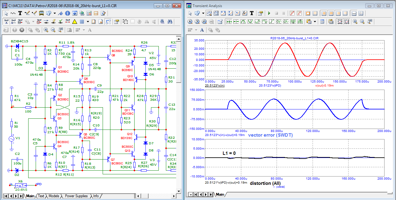

A choke of even a negligible value (0.1 μH) shunted with a 0.22 Ohm resistor has a significant effect on both the Group Delay value, its behavior beyond the audio range, and speed distortion. And what about chokes with inductance of 10 ... 15 μH, which are not uncommon in amplifiers. Without a choke, speed distortion is negligible - lower than other types of distortion.
