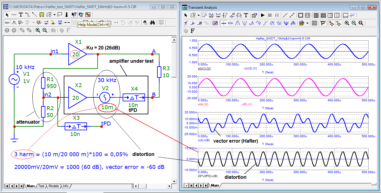

I think the topic here is if the vector error is different at a zero crossing or not, i.e. does it vary with the level in a stationary signal? At start from zero...?
Stationary signals do not have a start or an end.
If you look at the definition of the vector error as defined by Jiri Dostal, it does basically depend on almost anything in the transfer function. It varies with amplitude errors (including harmonic distortion) as well as with phase shifts and any combination of the two.
That is why a vector error could be used to compare two different circuits as to their 'accuracy', but it doesn't tell you anything about the type or relative proportion of the elements of the accuracy error, it's a sort of lumped quantity. So for audio it's pretty much useless.

for those who did not understand how the Hafler test works
here is a picture with additional comments
The 4th graph is the result of the distortion test, which is difficult to do in a real amplifier due to the lack of the ability to make delays with high accuracy.
When you adjust the phase, you can turn off the higher harmonics of a slow amplifier and then indulge your pride: "what a good amplifier I made"
