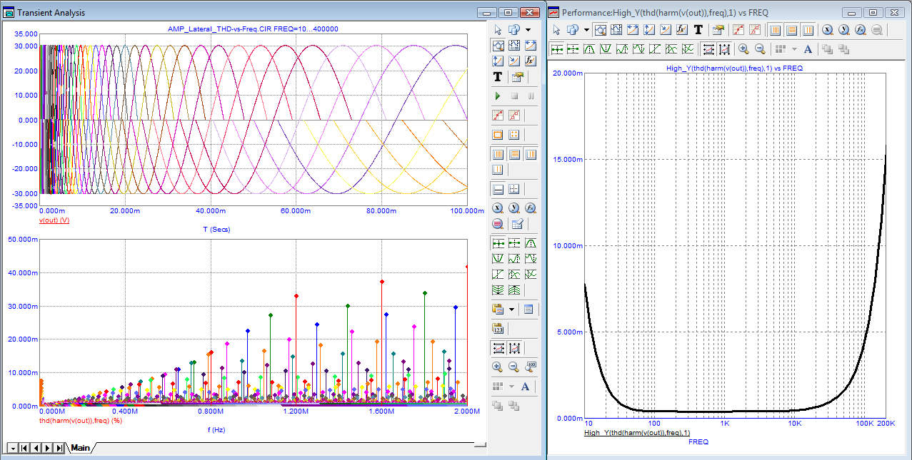

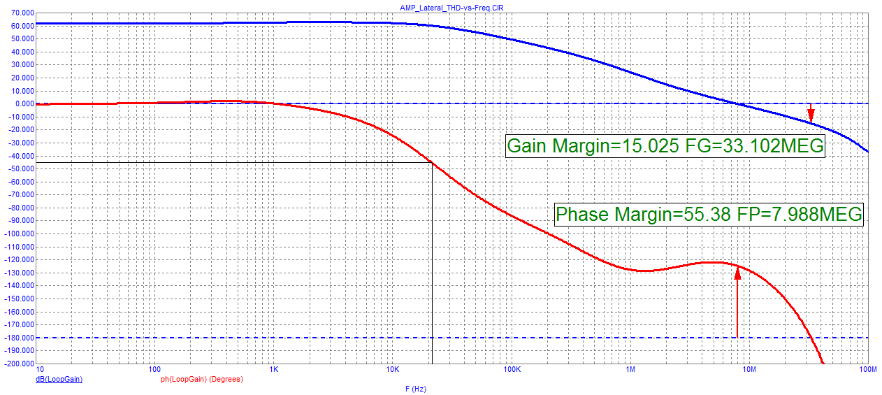

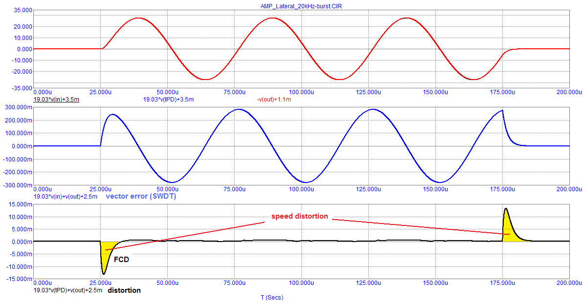

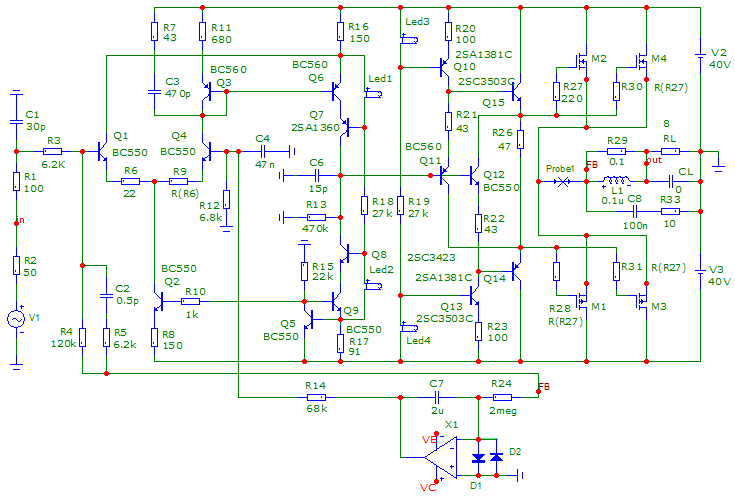

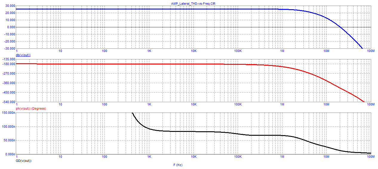

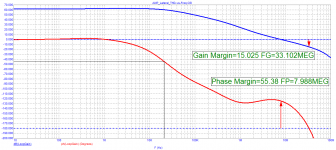

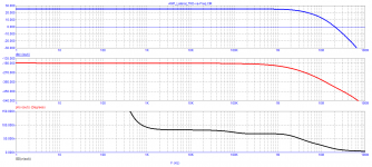

For Ssassen, here's another variation on a simple amplifier circuit. Everything has already been invented long before us, all that remains is to configure it correctly.

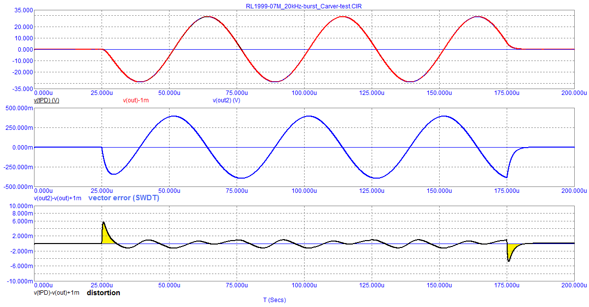

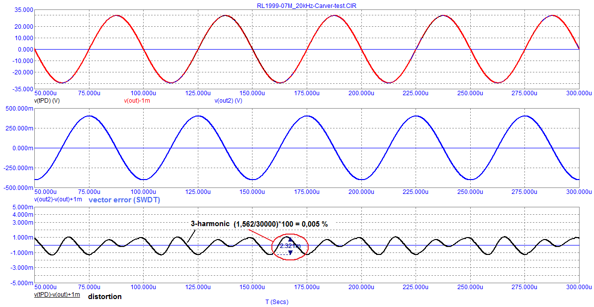

Carver's test is a similar test, only without scaling. The signal is fed simultaneously to two amplifiers, one of which is reference (reference), and the second is tested. After carefully balancing the output signals using the input attenuators, the difference between the signals is monitored. Since amplifiers introduce different distortions and have different signal propagation delays, we will also see a vector difference that can significantly exceed the difference in distortion. Both Hafler and Carver independently concluded that with vector error amplitudes of less than -60 dB (1000 times attenuation), the difference in sound between amplifiers is difficult to capture.

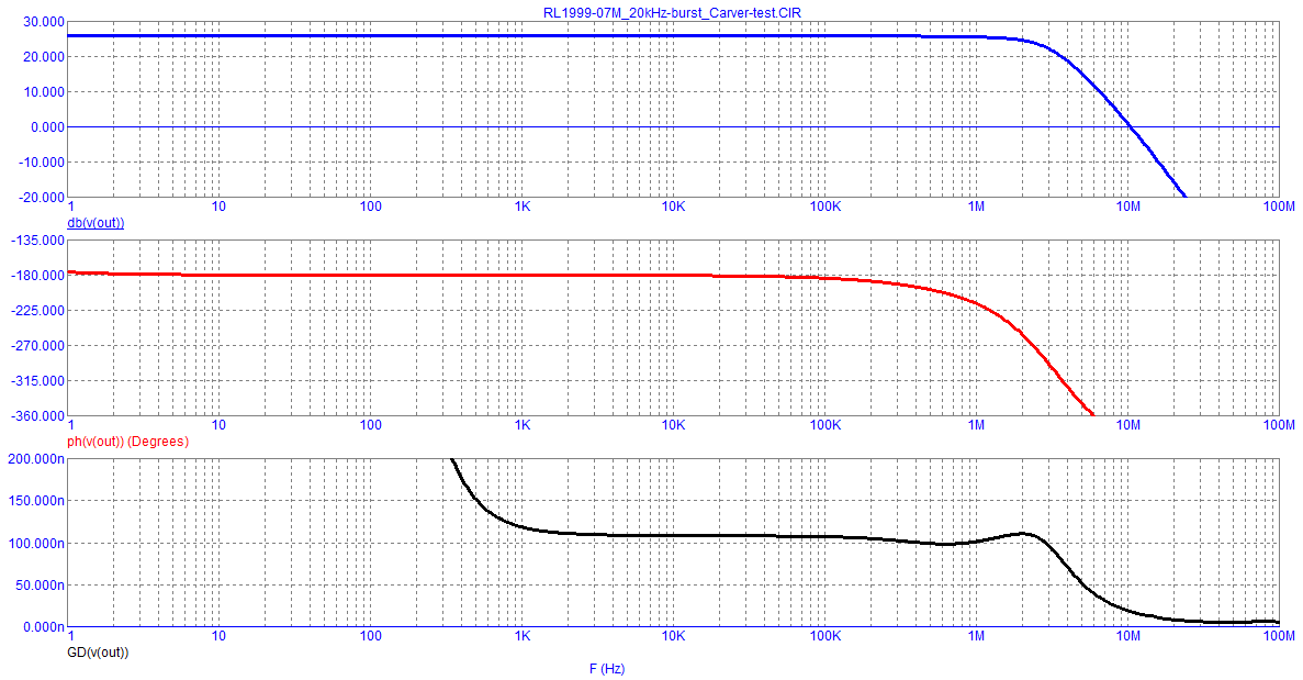

When simulating in a simulator, you can not only measure the vector error, but also measure all types of distortion introduced by the amplifier under test. To do this, use an ideal delay line equal to the Group Delay of the amplifier under test at the test frequency. In tests, I have shown this many times.
The last examples are given using a burst of three sinusoids with a frequency of 20 kHz which is passed through a low-pass filter with a cutoff frequency of 100 kHz (as in the DIM-100). Vector errors depend on Group Delay (tPD). The rate distortions at the moments of a sharp change in dV / dt also depend on tPD. We observe them at the beginning of the first period and at the end of the last.
As you can see, I give specific examples of tests for different amplifiers. These arguments support the theory of vector errors (see the book by Jiri Dostal).
No these arguments don’t support anything and only prove that subtracting one signal from an other signal gives the difference between both signals.
To call this Vector error, Speed error or Fantasy error is all the same when you can’t prove that this has any relevance to perceived audio by the listener, no matter what your references are trying to tell, mostly out of commercial interest.
Hans

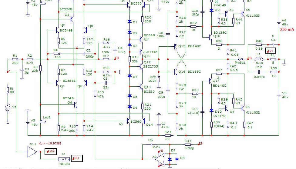

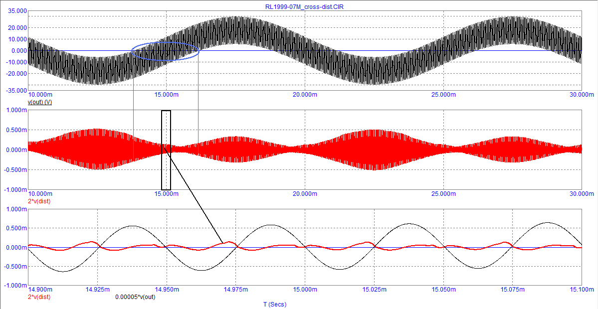

Hafler's Tect is a comparison with a straight wire with gain, i.e. an ideal amplifier with a gain equal to that of the amplifier under test.
Here are the results of testing the model.
Speed distortions are measured using burst at the highest frequency of the audio range.
At medium frequencies, they are negligible.
Switching distortion is also negligible

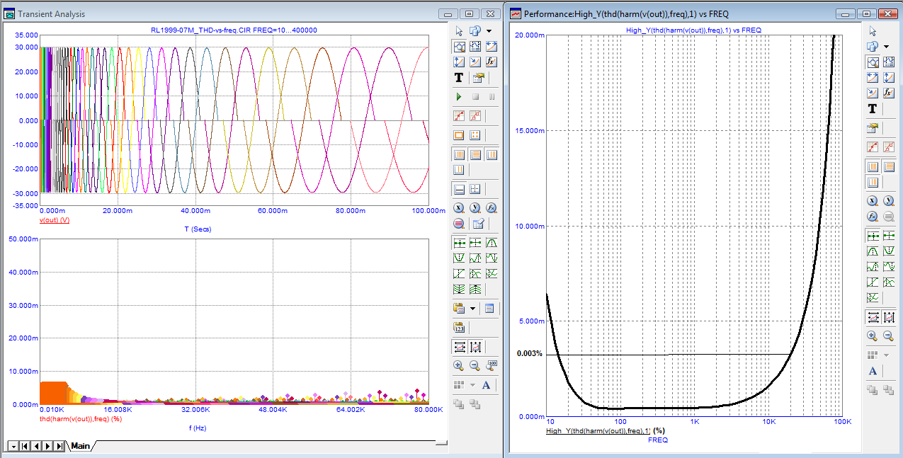

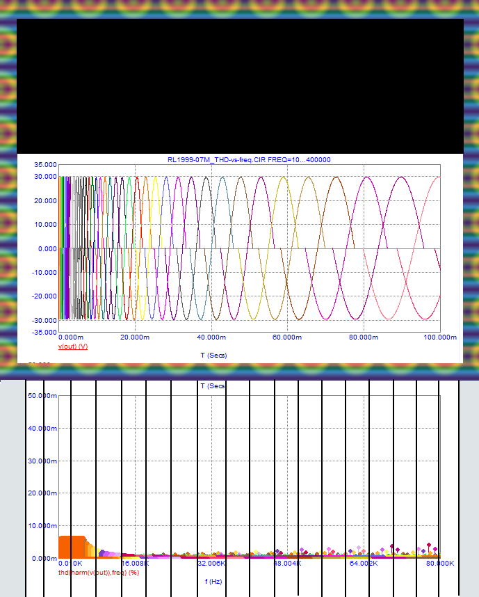

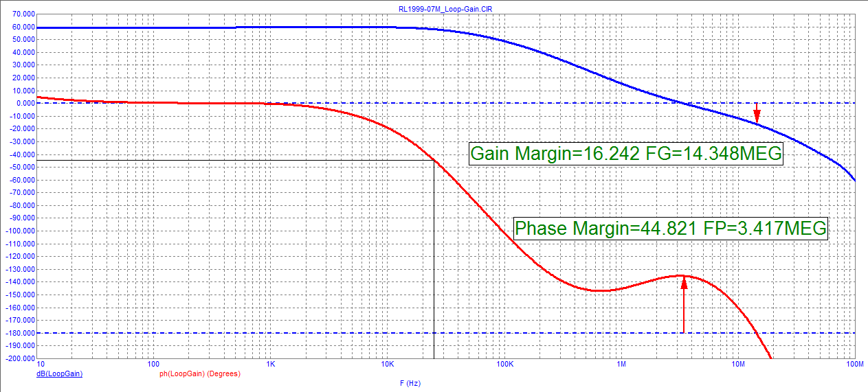

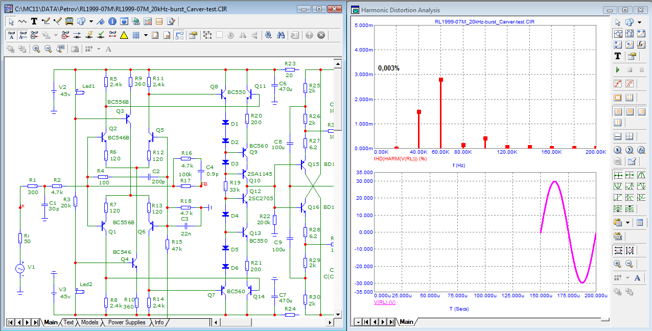

@petr_2009,
I was about to start up the simulator and spend a few hours drafting your design, but there's several now? Can you please settle on one? Also, and as Jan suggests, explain what point you're trying to make with the generated plots, without the proper context they're pretty much meaningless.

As usual, pictures are thrown up with no explanation of what they are, and what they are supposed to prove, but I like the pretty colors.
I probably can find an art gallery interested in exhibiting them 😎
Jan
Jan,
You are so right, I almost missed it, real pieces of art, the new Banksy.
I used the beautiful internal colors to make a nice painting list and used the Banksy shredder to make it worth a fortune.
Hans
Jan, for a start, imagine that I am a beginner and do not know what is the meaning of the Hafler test and try to explain to me so that I understand the essence. Then explain to me what the Bob Carver Test is.
Is there anyone here who understand the microcap graphics? help explain to those who do not understand, please!
@petr_2009,
No amount of discussion is going to convince anyone, so please let me know what schematic I need to simulate and what I'm looking for, so I can compare directly to another design. Please let me know the stimulus input, the desired result and what I'm looking for that sets the design you recommend apart from others. We'll get to whether that is an issue or not after we have something to compare, and discuss I might add, if anything.
