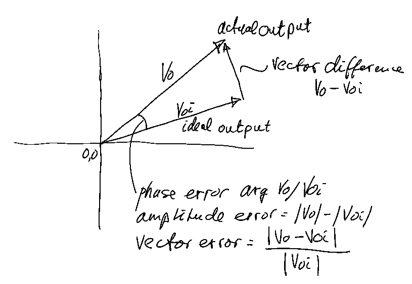

Finally got to the place where I have my copy of Jiri Dostals'book on opamps. I thought I had the original edition but memory teased me, I have the EDN re-issue.
On page 156 he starts the discussion on Vector, Amplitude and Phase errors.
In reverse order:
1 - the phase error is the phase shift between input and output. This error can be presented as a difference in angle between the input magnitude vector and the output magnitude vector, with both vectors starting at the origin;
2 - the amplitude error is the difference between the length (magnitude) of the two vectors described in (1) above;
3 - the vector difference is the length of a vector connecting the endpoints of the two vectors mentioned in (1).
The vector error then is the absolute value of the amplitude error divided by the absolute value of the ideal output vector.
In Dostals' view, the vector error is the decisive measure of the accuracy of the operational circuit, the deviation from an ideal circuit, and that seems sensible.
The rough circuit attached shows the definitions used by Dostal.
Don't forget that this book is about opamps, operational circuits and their deviations from an ideal circuit. In that context vector error could be a useful metric.
I have no clear idea what it would mean in the audio context, whether it would be useful there. Comments invited.

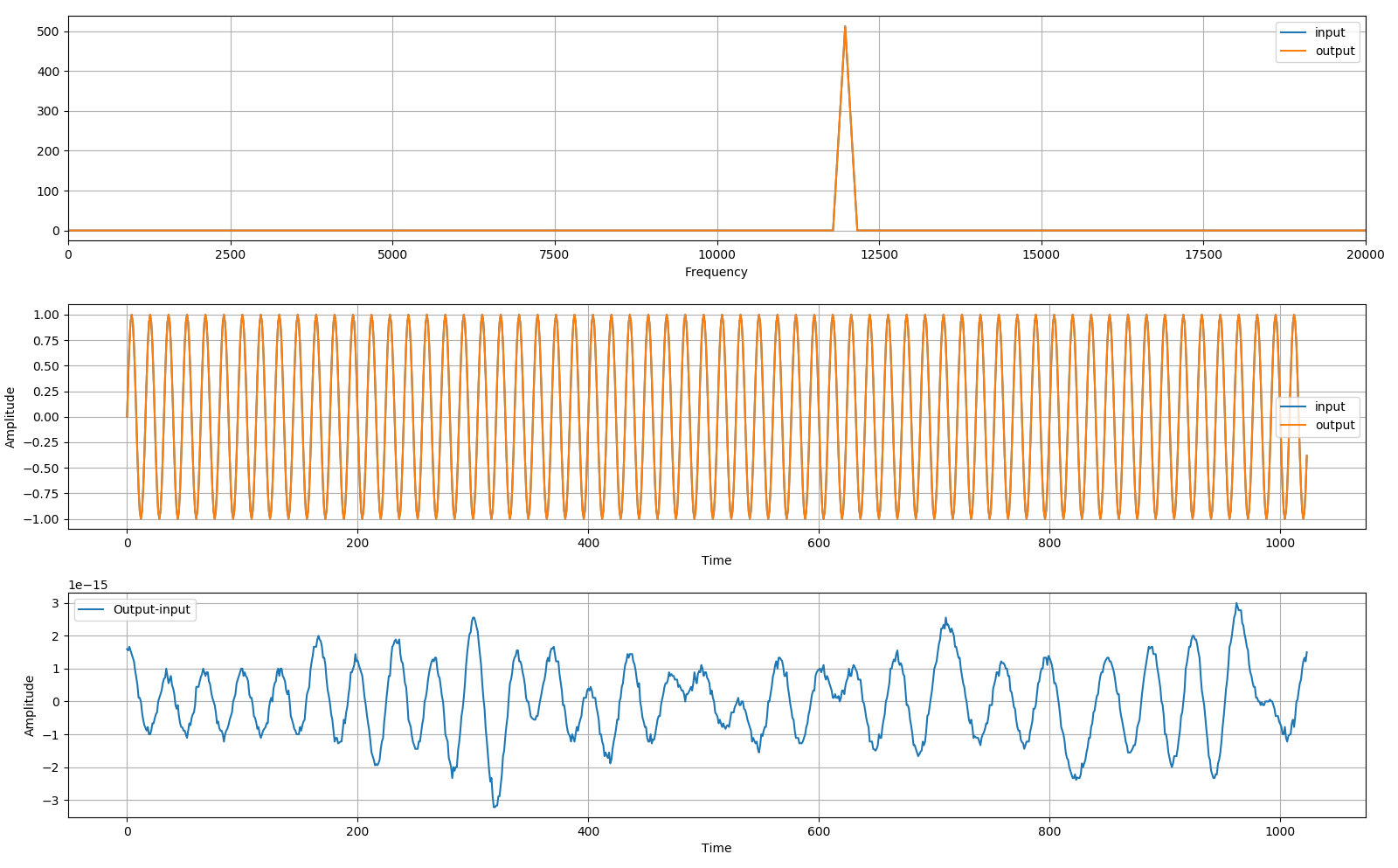

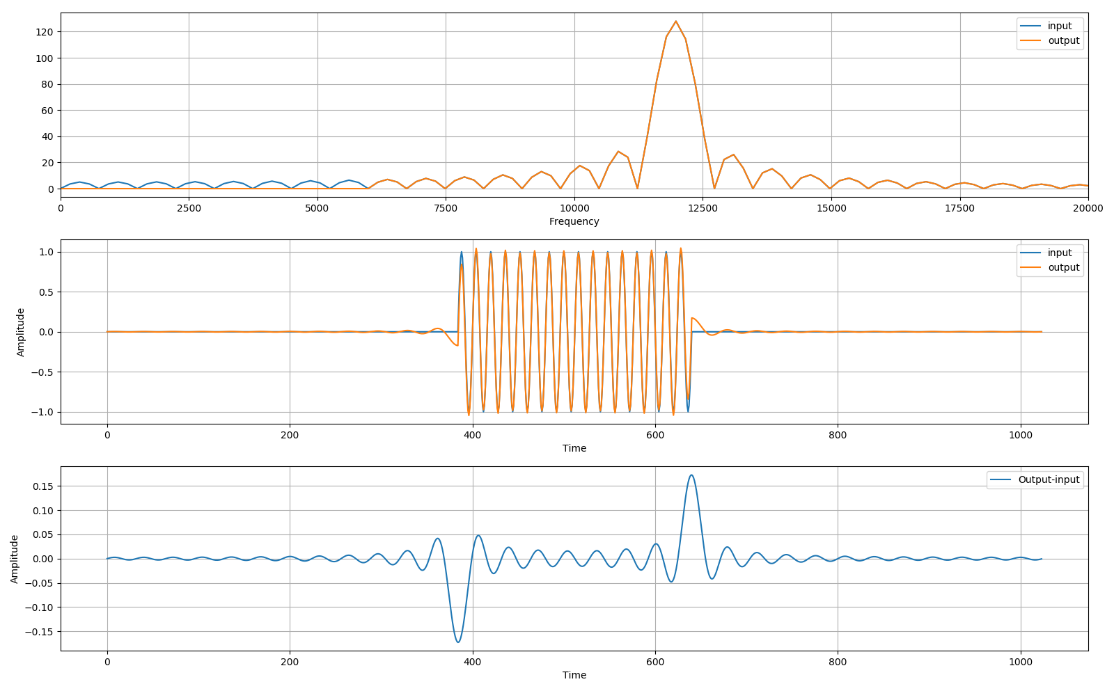

Ironically, vector error only makes sense when signals can be represented by complex numbers or phase/amplitude vectors, which means single frequency steady state, and definitely not first cycle.
Here's a 12kHz gated sine (middle plot, blue). Its spectrum (top, blue) is all over the place, it contains all frequencies both above and below 12kHz. This signal cannot be represented as vector. Removing low frequencies in the spectrum with a linear phase brickwall filter (top plot, orange) gives a signal with a different shape (middle plot, orange). Bottom plot is the difference.
If the sine signal is not gated, but instead static:
Then the brickwall filter does not change it at all, because its 12kHz frequency is above the 6k brickwall cutoff. Therefore the output is identical to the input, and the error is just floating point rounding errors around 10^-15.
This filter has no vector error, the 12kHz signal goes straight through without phase shift or attenuation. But by removing frequencies below 6kHz, it does change the shape of the gated sine, which petr would call "first cycle distortion" (why not) ; that process has nothing to do with vector error obviously.

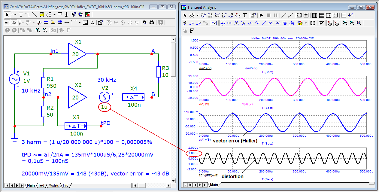

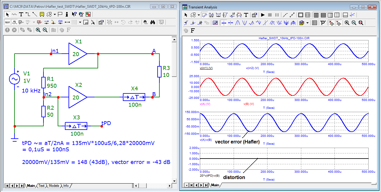

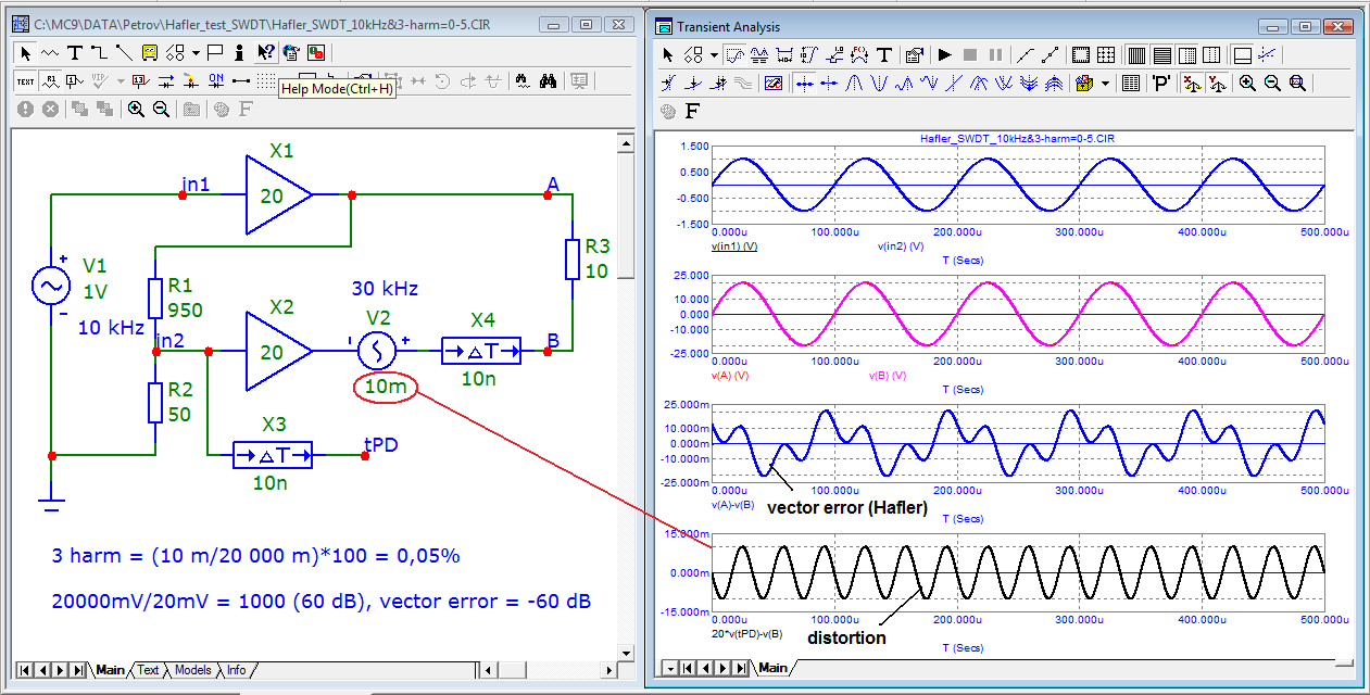

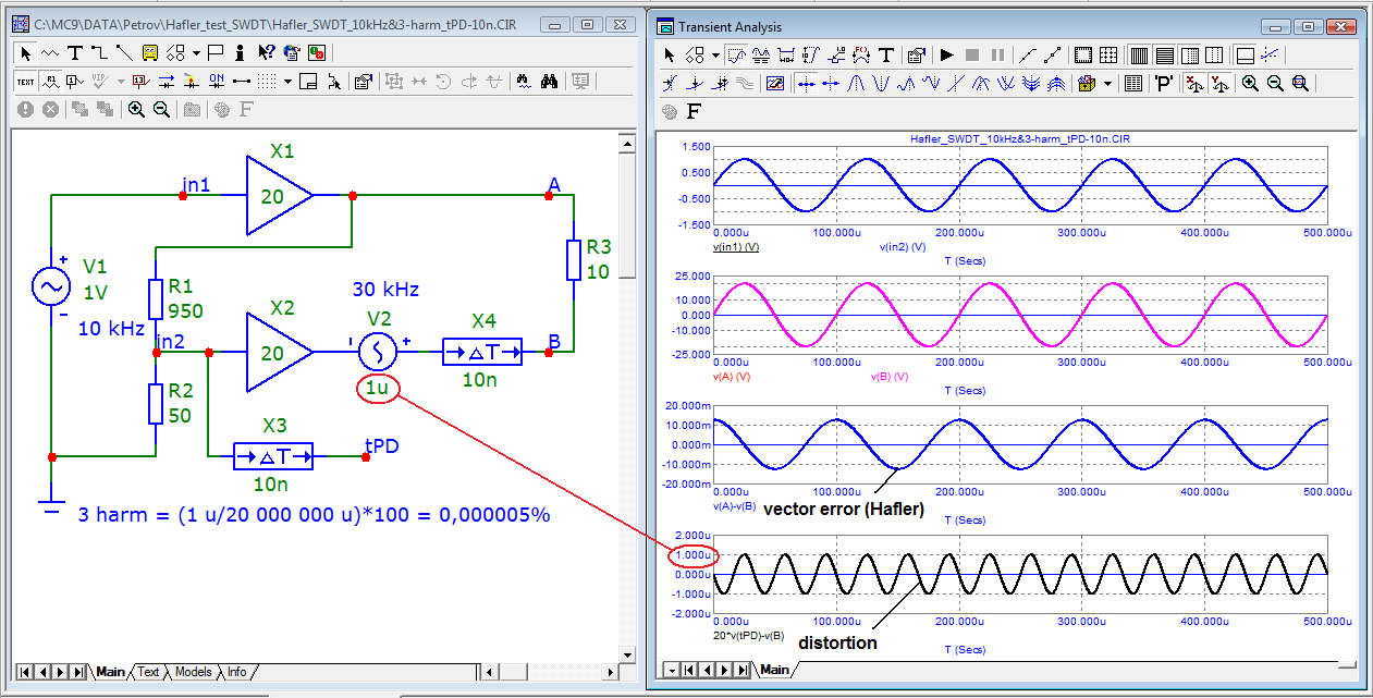

The Hafler test appeared after all the known methods (five main methods) of testing, listed by Rakovsky in his 1956 book, were investigated.
Unfortunately, until today this method has not found widespread use, with the exception of the author himself and Bob Carver.
Let's consider the work of the Hafler test using ideal components as an example.
