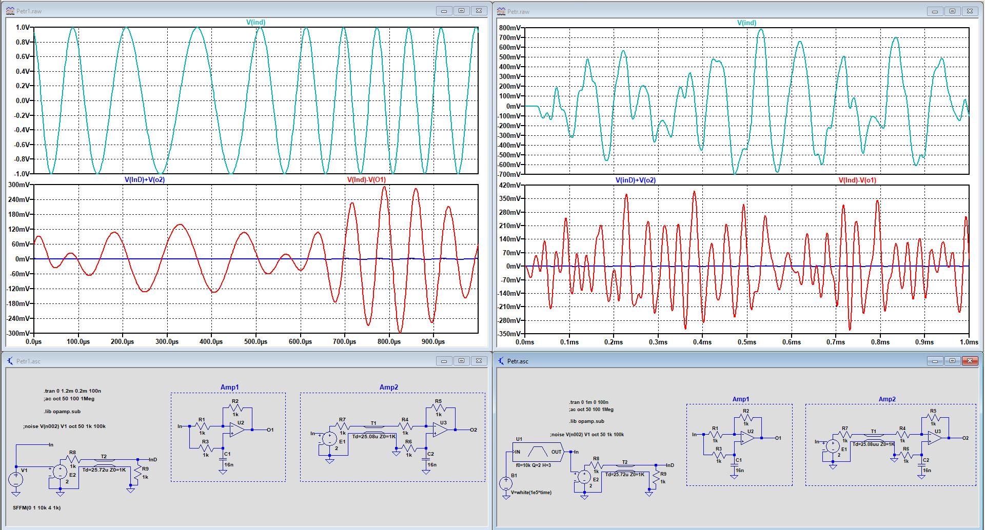

I agree, for that reason I have produced a new simulation to make things more clear.

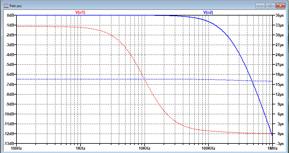

In the first Image below, two distortion free amps are shown with their resp. 100% identical Gain vs frequency.
And as can also be seen, both have exactly the same GD at 10Khz, however one amp has a constant GD versus frequency up to 100Khz where the other one hasn't.
I have offered both amps a modulated 10Khz signal and also band limited noise around 10Khz, see the second image below.
Input V(InD) signals are visible in the upper part in teal.
As a next step I have subtracted these time corrected input signals V(InD) from the two output signals V(O1) and V(O2).
The difference signal with Amp2, the one having a constant GD is zero, while Amp1 shows a large signal difference for both input signals.
This is to show that in case of an Amp with varying GD, subtracting a single value tPD delayed output signal from the input signal or vice versa, produces a difference signal that has nothing to do with distortion and that "speed distortion" is just a non existing type of distortion.
Hopes this makes my point clear in a final attempt trying to convince Petr.

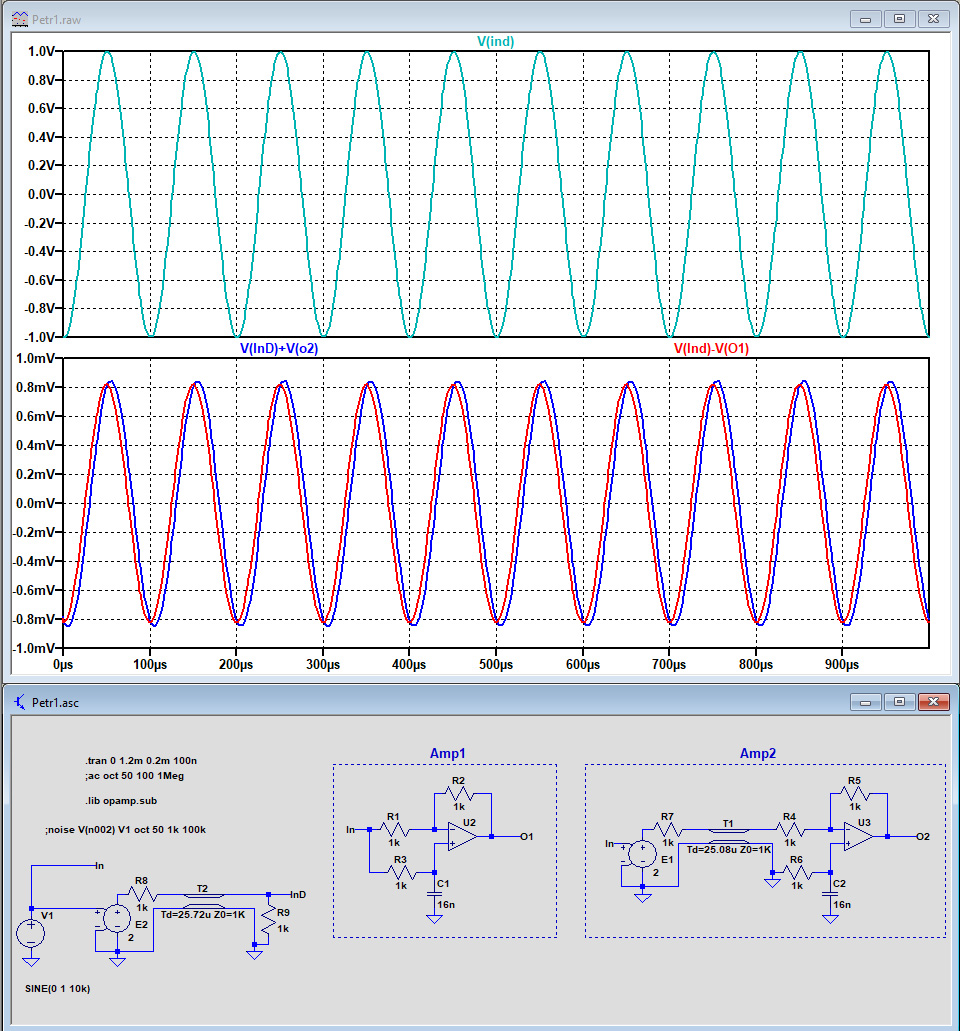

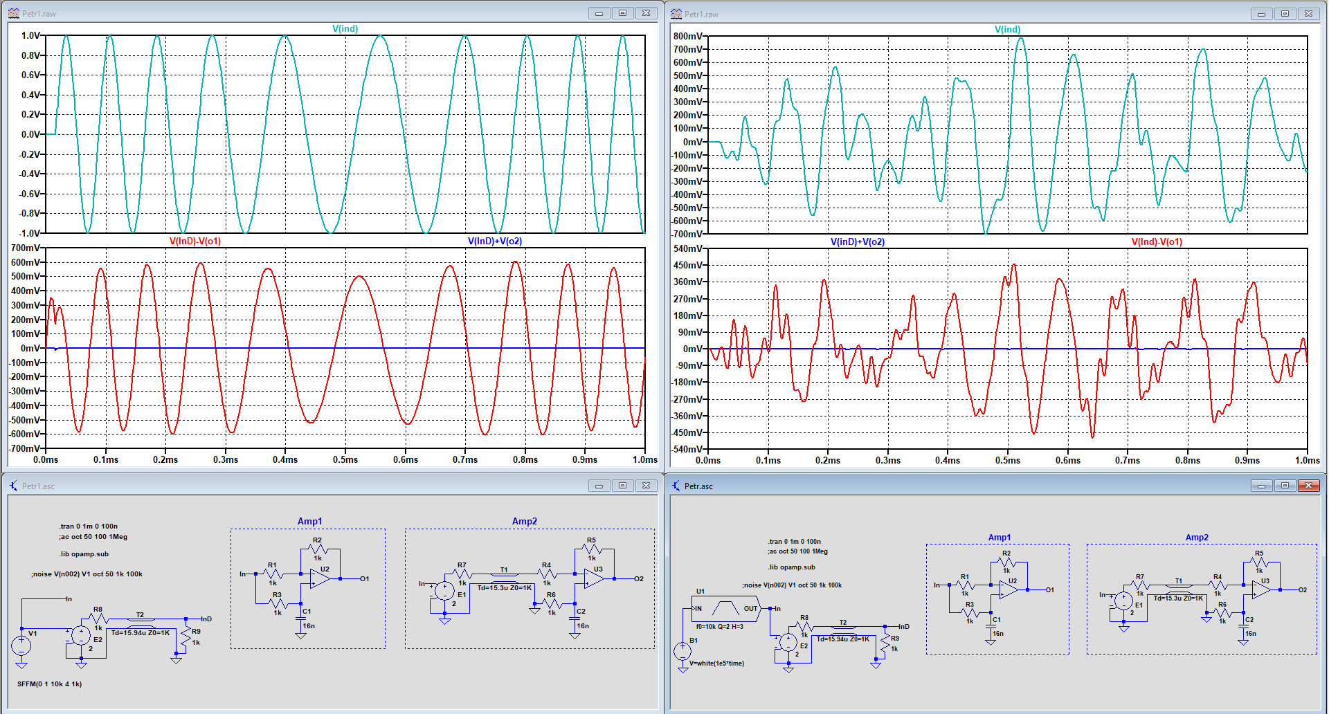

Fagos, Amp1 starts as a non inverting amp, while amp2 inverts right from the beginning.
However, I saw that I made an error in the used delay times.
See the first image below where both amps were offered a 10Khz signal in teal and then subtracted from, resp. added to the delayed input signal in red and blue.
Result for both is -60dB down, proving that the correct delays have been used.
With the correct delay times I ran the sim again with the modulated signal and the band limited noise, see second image.
Result is still that amp2 minus input is still zero, while amp1 is still showing a substantial difference signal.
Sorry for the previous inaccurate delay, but the outcome and the conclusions are no different as from before.
Hans
Hans
Hans, thank you, I did not pay attention to the difference in the connection of resistors on non-inverting inputs. Now everything fell into place.Fagos, Amp1 starts as a non inverting amp, while amp2 inverts right from the beginning.

Hans, I am trying to wrap my head around this. What is the basic cause of the difference voltage in the case of changing group delay? It that the phase shift between input and output signal changes not-constant with frequency?
Jan
Hi Jan,
That’s exactly what it is.
At 10Khz in&out have the same GD, say X and will be nulled after subtraction.
At a frequency lower or higher than 10Khz, say Z the amp will have a different GD say Y so when subtracting in &out, you will get sin(2pi*Z*t)-sin(2pi*Z*t+Phase(X-Y)) which will result in a new sine whose amplitude depends on the phase difference caused by X-Y for that frequency Z.
Hans
