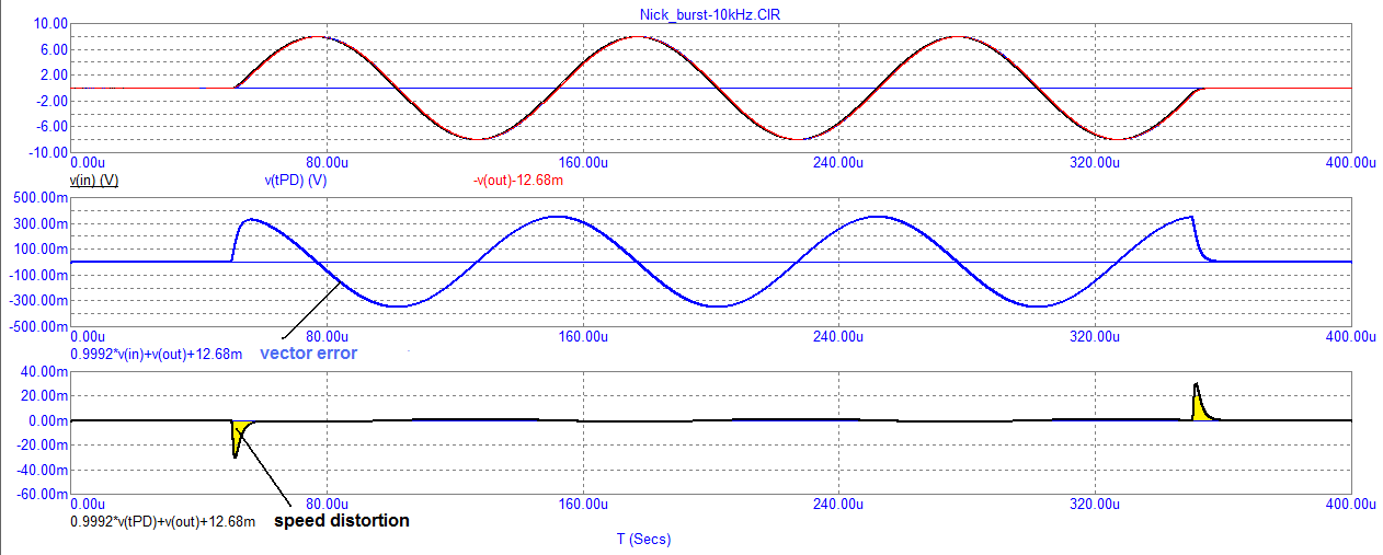

Speed (velocity) distortion occurs at any deviation of the signal from the sinusoid of a given frequency. In this case, the burst is passed through a 100 kHz low-pass filter.
Hans, to begin with, measure the second error of your amplifier at a frequency of 10 kHz, otherwise some authors with 30 years of experience strained with this

nonlinear distortion...any deviation of the signal from the sinusoid of a given frequency
linear "distortion", 5 times over audioband.. Speaker box or your ears are also "LP filter"..the burst is passed through a 100 kHz low-pass filter.
Why is it interesting? You are superbat or dolphin? But in simulation it is no problem even to 100MHzshow the Gdelay graph of your amplifier from 5 kHz to 5 MHz.
Delay and LP filtering ( way over audioband) are not distortions

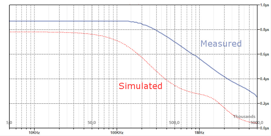

A task:
measure and show the Gdelay graph of your amplifier from 5 kHz to 5 MHz.

I used the soundcard to acquire LRCK at the SPDIF transmitter and LRCK at the SPDIF receiver. Phase shift between these two gives the delay (and its variations known as "jitter") introduced by the SPDIF chain. Then I used a divider to do the same with sender MCLK vs receiver recovered MCLK. It was around 25MHz, so that's 5x more than the 5MHz you asked
1ps is 0.000017° phase shift on a 48kHz signal, which is measurable with a soundcard if noise is low enough.

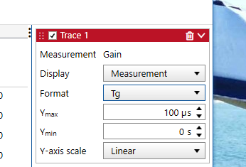

For the group delay of an amp I would use the network analyzer, but that's not an interesting measurement: open loop phase shift is much more interesting for stability.
The Bode100 in my soundcard-based lab would measure group delay directly, but I have never bothered to measure it in amplifiers. With electronics-based group delays several orders of magnitude below that of the acoustical part of the reproduction chain, who would bother?

Petr,Speed (velocity) distortion occurs at any deviation of the signal from the sinusoid of a given frequency. In this case, the burst is passed through a 100 kHz low-pass filter.

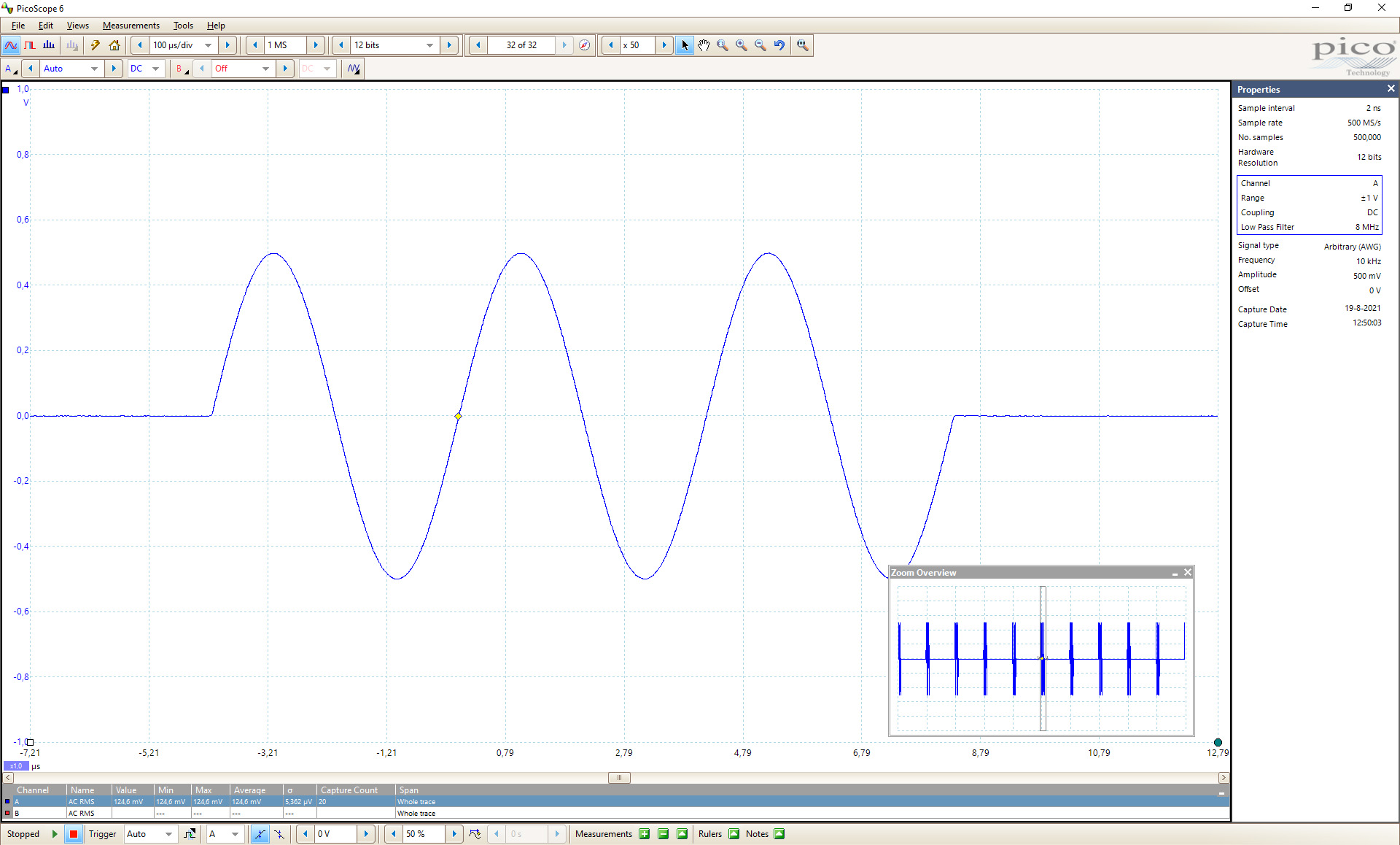

I need a more precise definition of what to do that really makes sense.
It is easy to generate a three cycle sine wave at 10Khz with 1000 point per cycle and offering this to an amp, see image below.
And also subtracting input from output after gain correction is easy to perform, although rather questionable other than to show that there is a difference between the two.
But then comes the third step which is subtracting the input signal from the (gain + delay) corrected output signal.
And here comes my question:
Do you use a fixed value for this time delay, then it makes no sense at all because GD depends on frequency.
Especially at the start and end of the 3 cycle sinewave, there is a wild spread of frequencies, so you will have to restrict the input signal to a frequency band where the Amp's GD is constant.
Not doing that will give an outcome that can't be used for any prove of distortion.

No problem at all with the VNA software using the same Picoscope.
Everything up to 100Mhz will be a hit of a button, but what's the point, why are you asking ?

Apparently it is worth repeating again - you have function breaks in the places you are talking about. And at the same time, a signal with a wide spectrum is received at the input of the amplifier, which is not limited by anything, since you do not put additional filters in the simulator.orjan, I repeat again: velocity distortions occur mainly at the very beginning of the first period, as well as with changes in frequency and amplitude, even with an ideally constant GDT. This is why there is a big difference between tests using noise-like signals (pink noise) and multi-tone tests.
of course, we are talking about the first period of the sinusoidal signal.

A simple task for those who want to demonstrate the omnipotence of their laboratory based on a sound card. It turns out that some can measure the delay of signals even up to a picosecond.
A task:
measure and show the Gdelay graph of your amplifier from 6Khz to 5 Mhz.
Just out of curiosity I did both a Sim and a real measurement of my Amplifier's GD from 5 Khz to 5 Mhz.
It's obvious that those two curves are not the same, so simulations are helpful but not always perfect.
GD is apparently constant up to just ca. 150Khz.
So subtracting a (gain+10Khz delay) corrected output from a sudden starting and stopping input signal, that's going way beyond 150Khz, will produce the sort of non-sense pictures with so called "Speed Errors".
Not shown here, but after offering a 100Khz limited input signal composed of just three 10Khz cycles and then subtracting it from time and gain corrected output, resulted as expected in a flat line !
Hans
