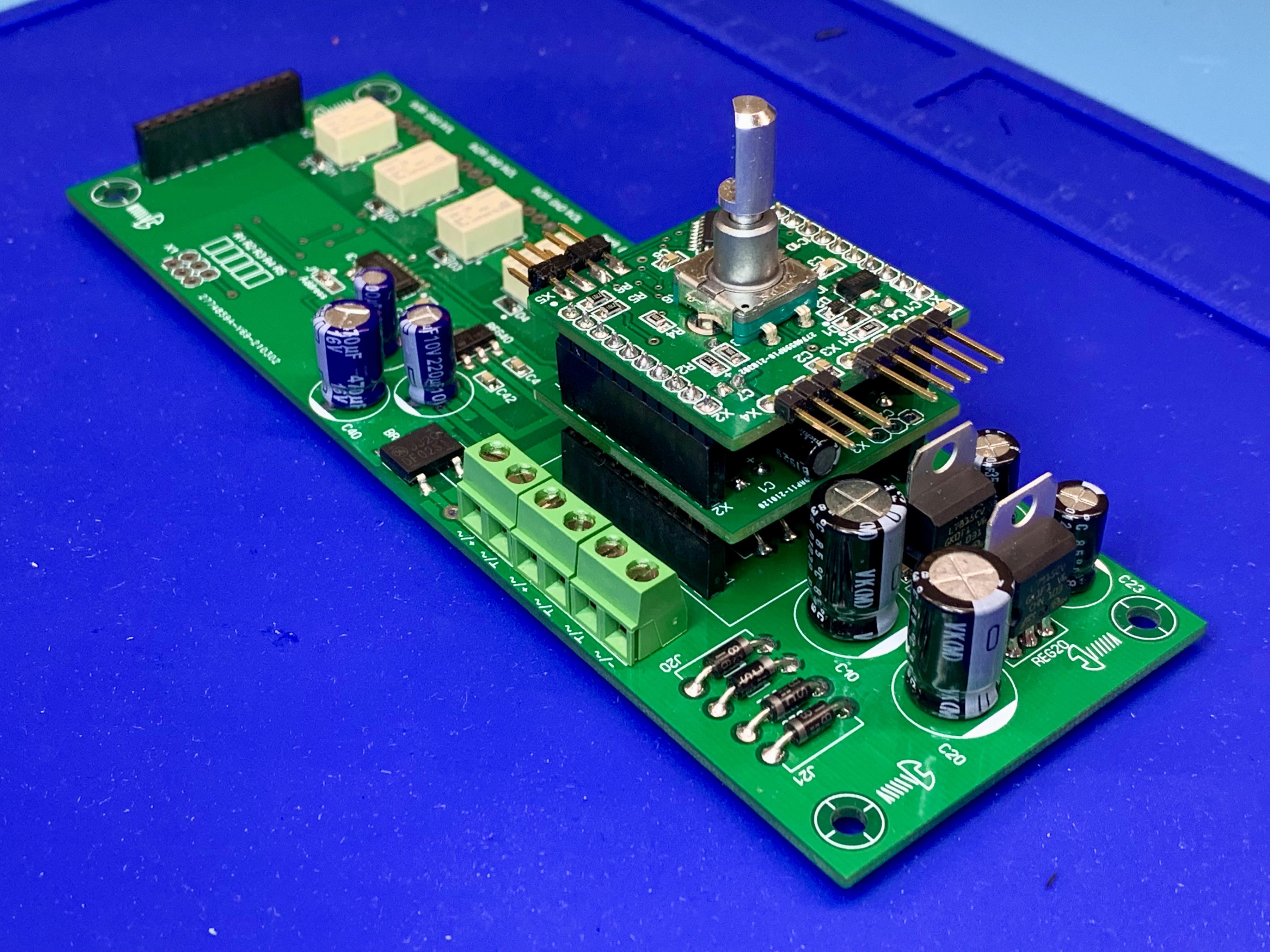

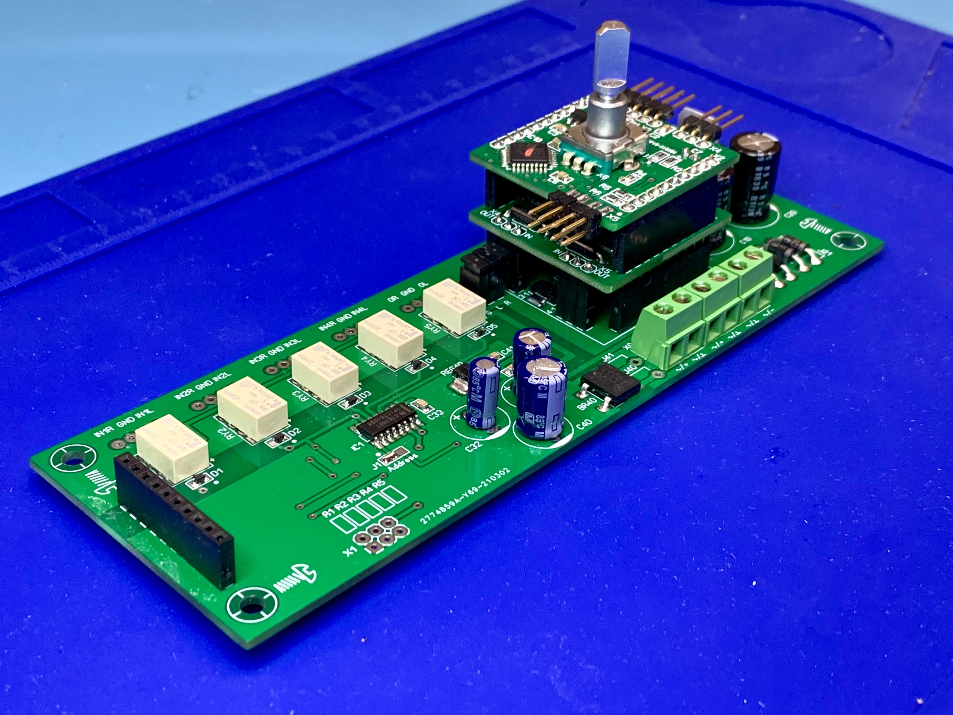

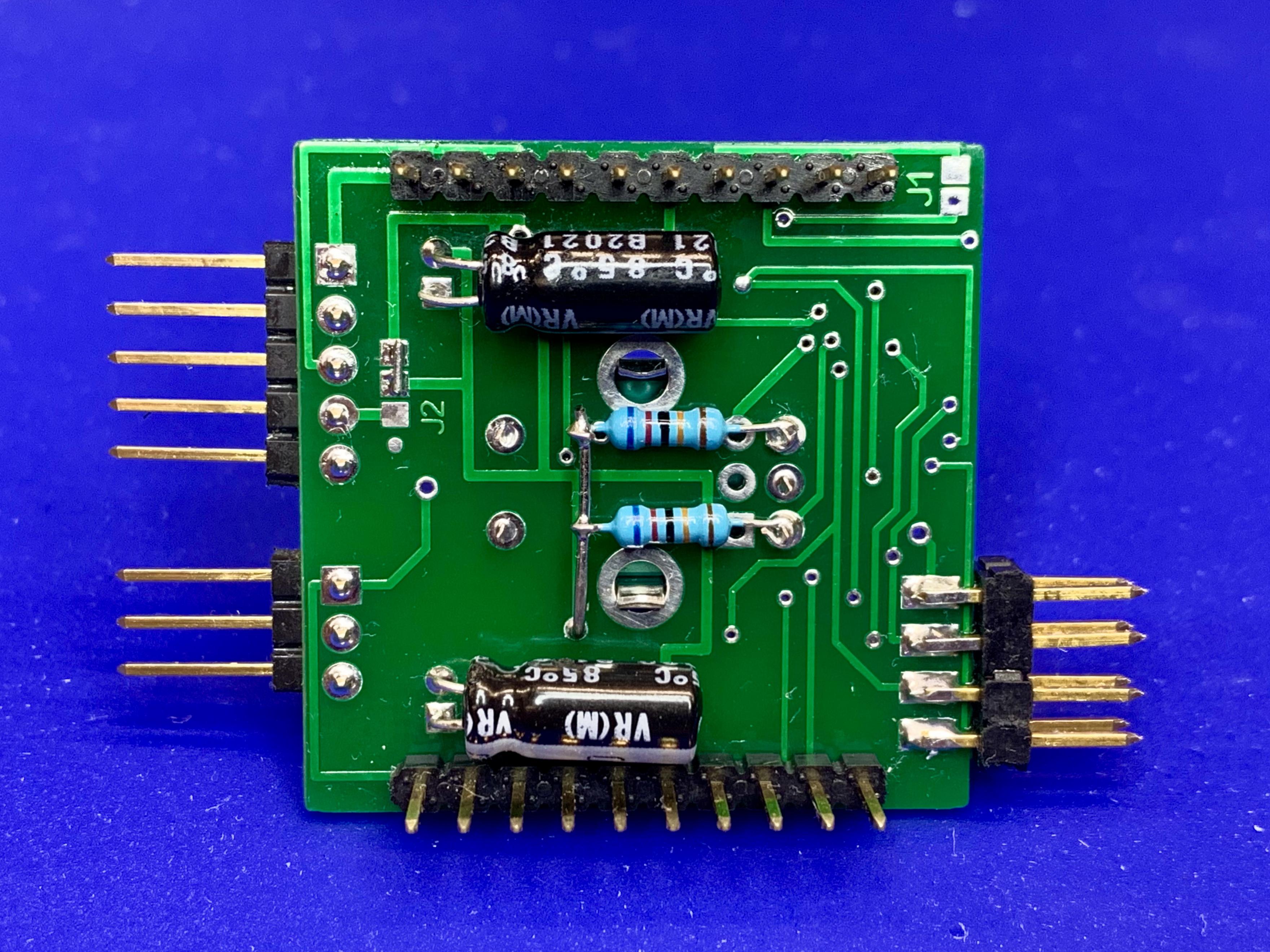

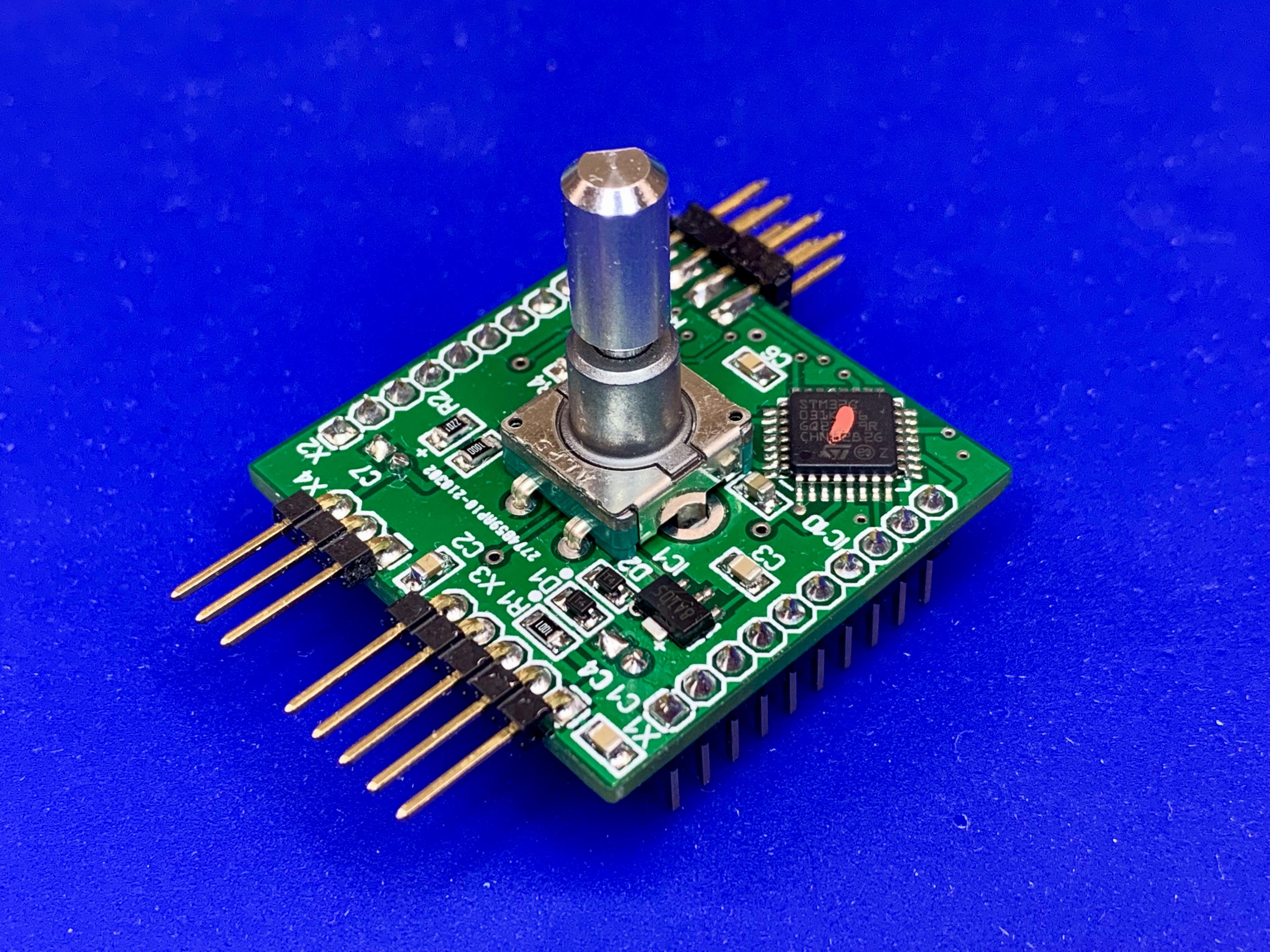

Got the remainder of the headers installed on the uController board along with the proper encoder. Added the pull-up resistors on the back. The steamship is ready to test! Just need to add some temporary input/output pigtails and some LEDs so I can see what it's doing.
This is the single-ended set. Balanced set upcoming, but same additions.

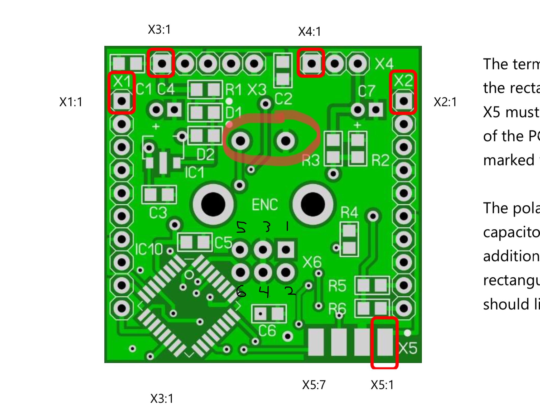

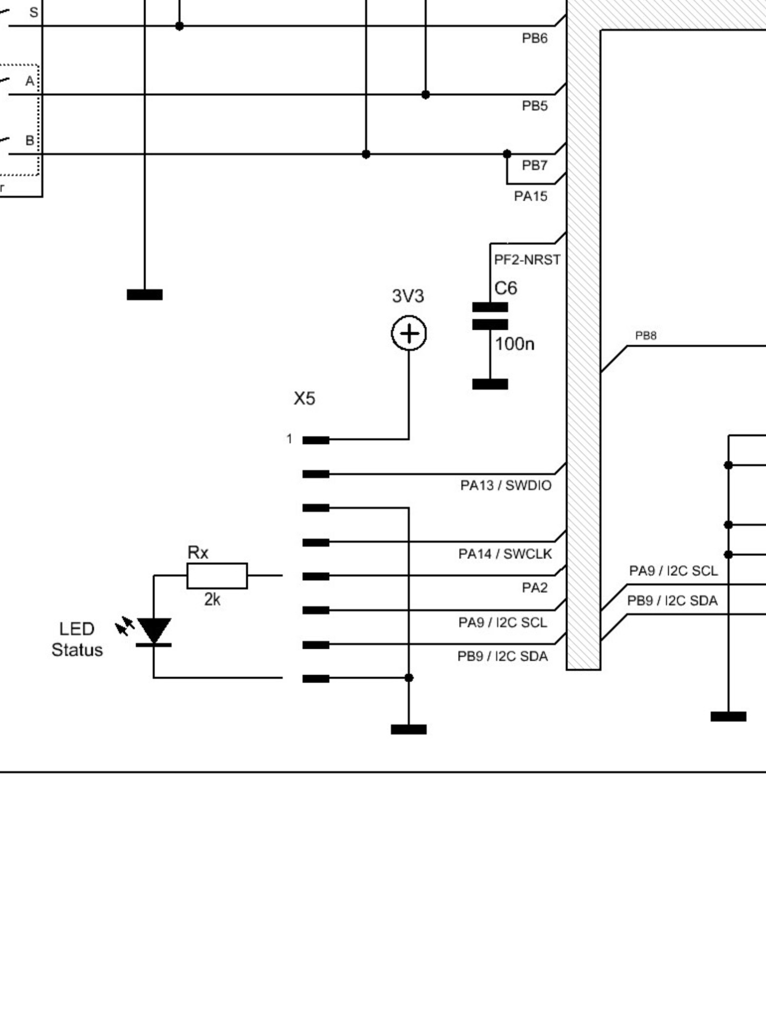

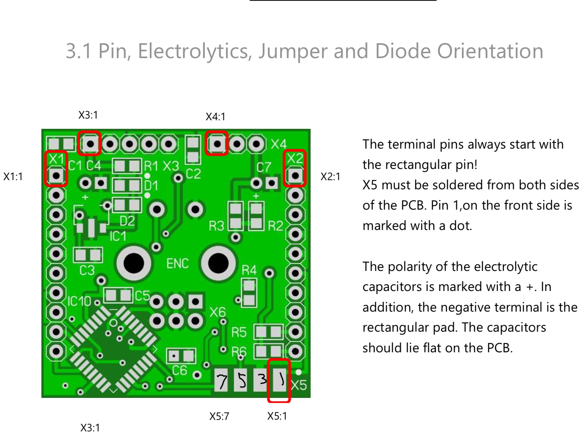

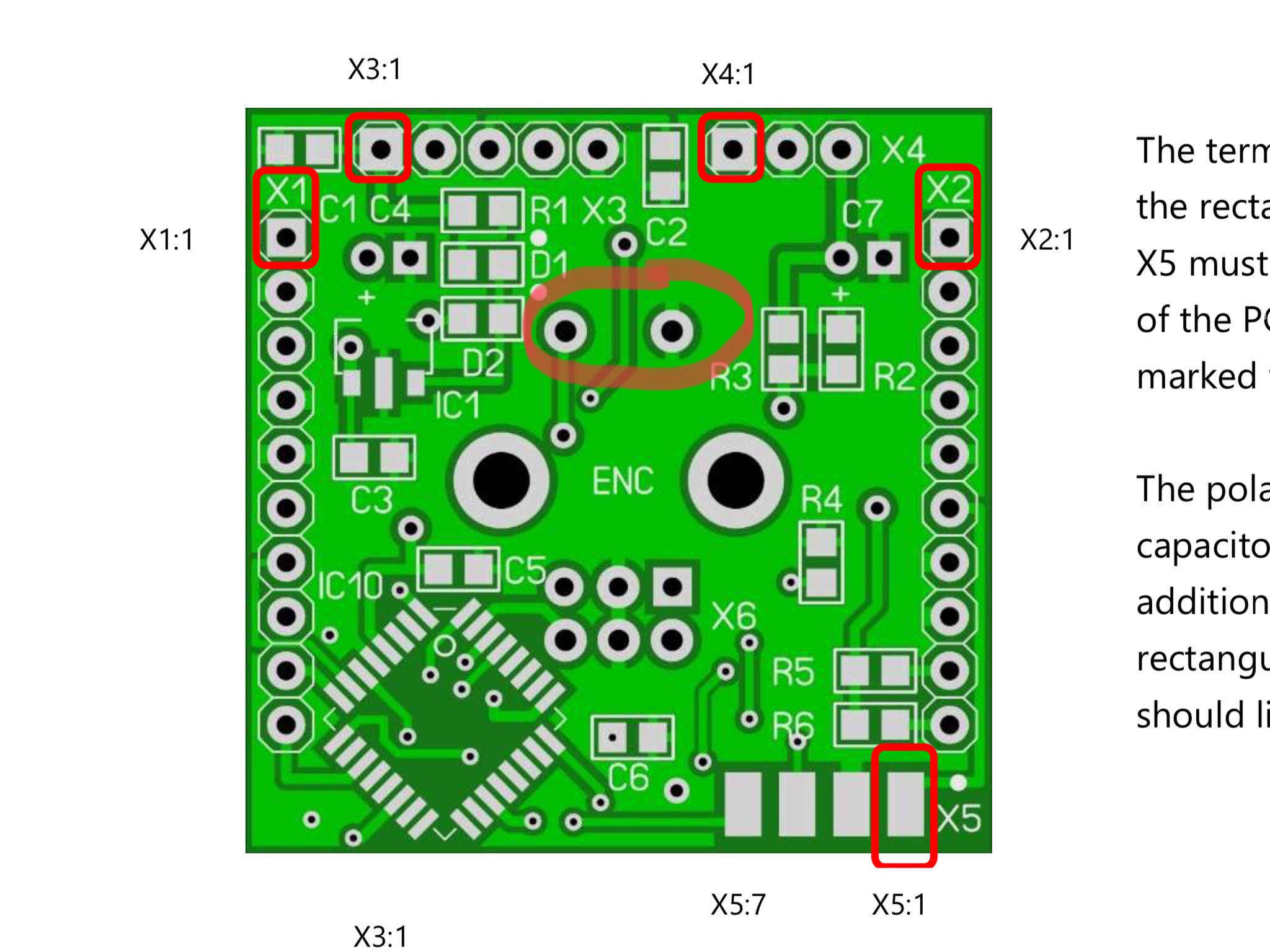

Please advise which pins on X5 to connect to, the schem is a bit unclear, anode to PA2 with resistor, is that X5.5?
I can't see where installing the LED is mentioned, not even in the BOM, only in the setup instructions. Still not sure why I needed the remote, it reads as being optional.
Yes, between pin 5 of x5 and ground. Pin 3 is grounded so you can use that. If I understand correctly, you have pin 1 3 5 7 on the same side. I haven’t built mine yet but I’m pretty sure that is correct.

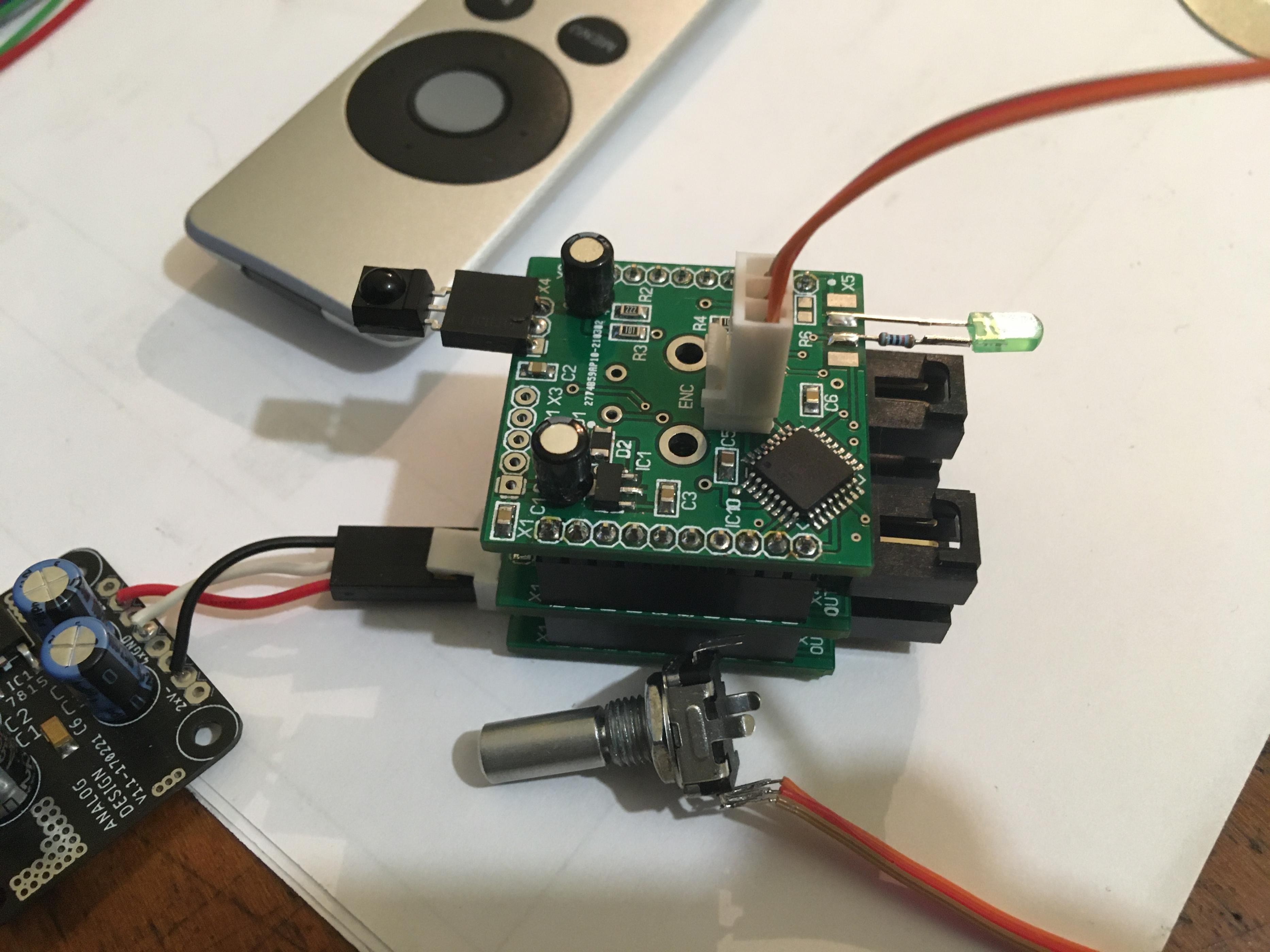

Still nothing, LED no blinky, anode to X5.5 with 10K resistor.
Power all good, everything perfect. This was without inputs connected but just want to check if it's alive. Please don't say it's the MCU....

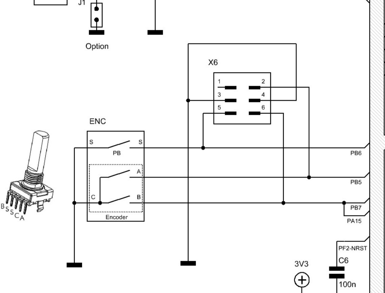

I think that what Daniel mean is that the switch of your encoder is not connected.
Edit: just saw that Ripster beat me to it

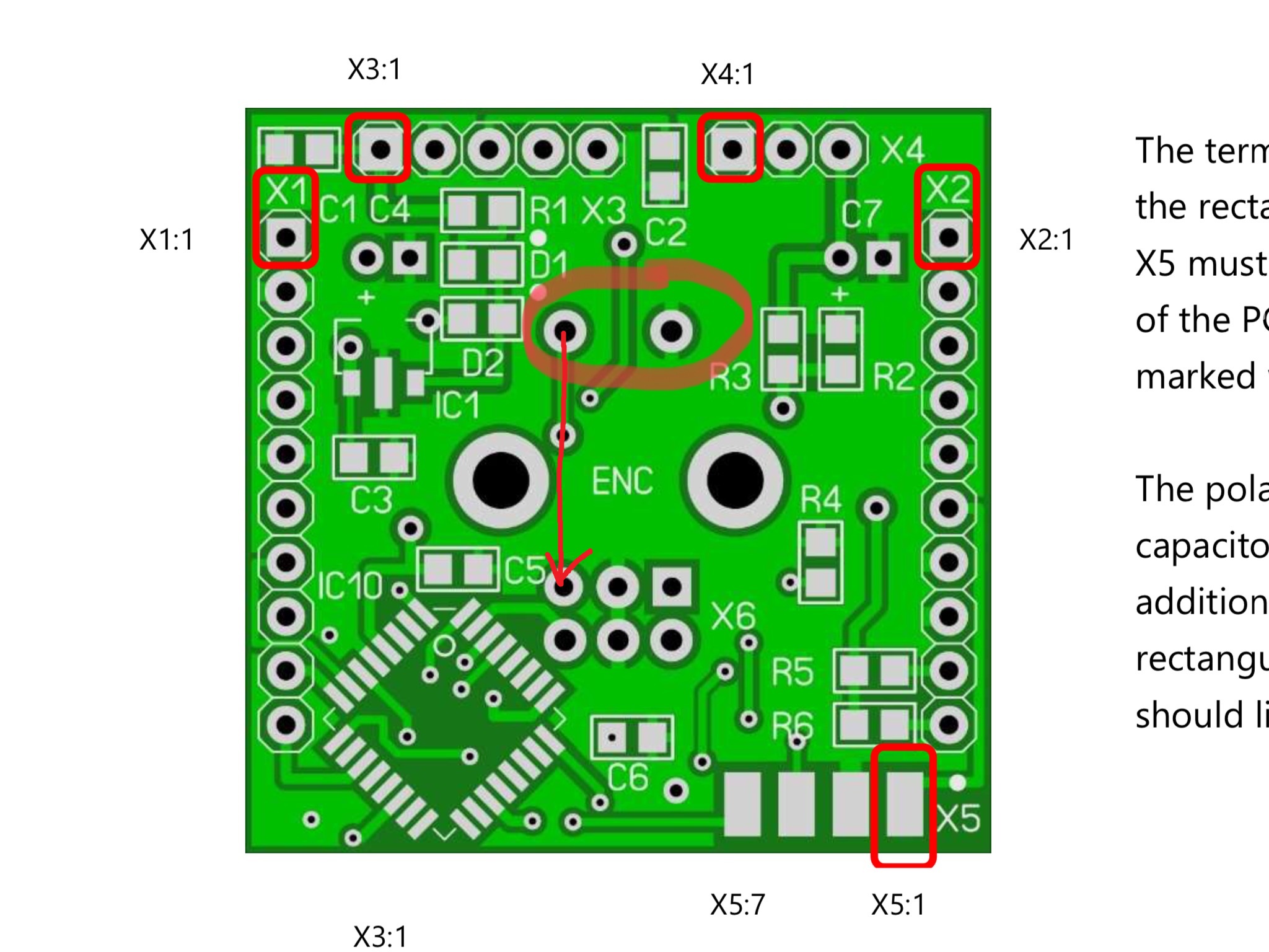

Thank guys, looks like I misunderstood again. Looking at the traces on the PCB, one of the two pins is gnd, the other is directly connected to pin 3 of the encoder pins below. So I need to bridge across pins ?
A continuity test proves it - the pins are connected.
I thought Daniel included the new row of encoder pins to accommodate a single header? it should work...
I can't make sense of it - can someone look at the traces and confirm? Attached the same pic to show
