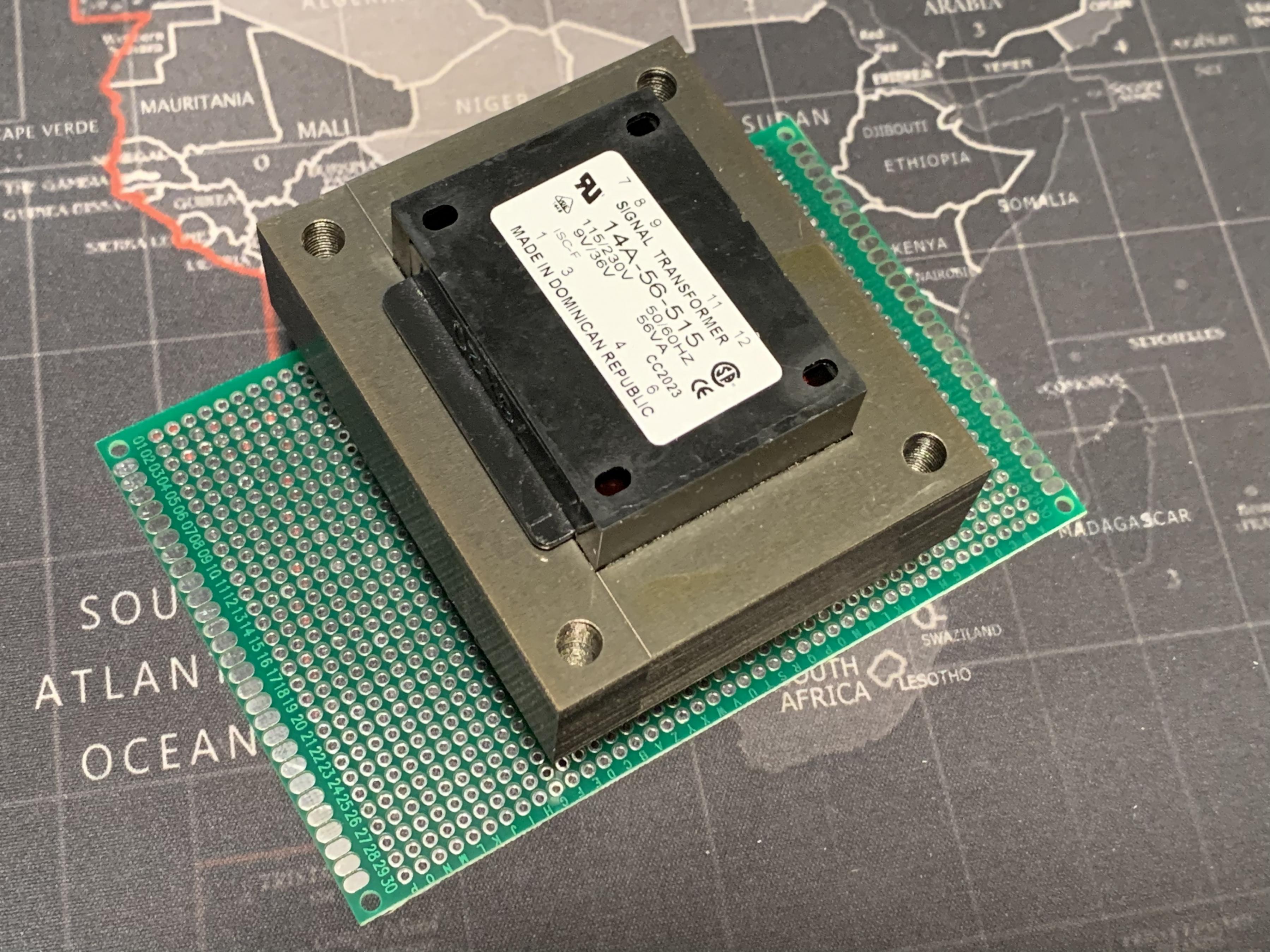

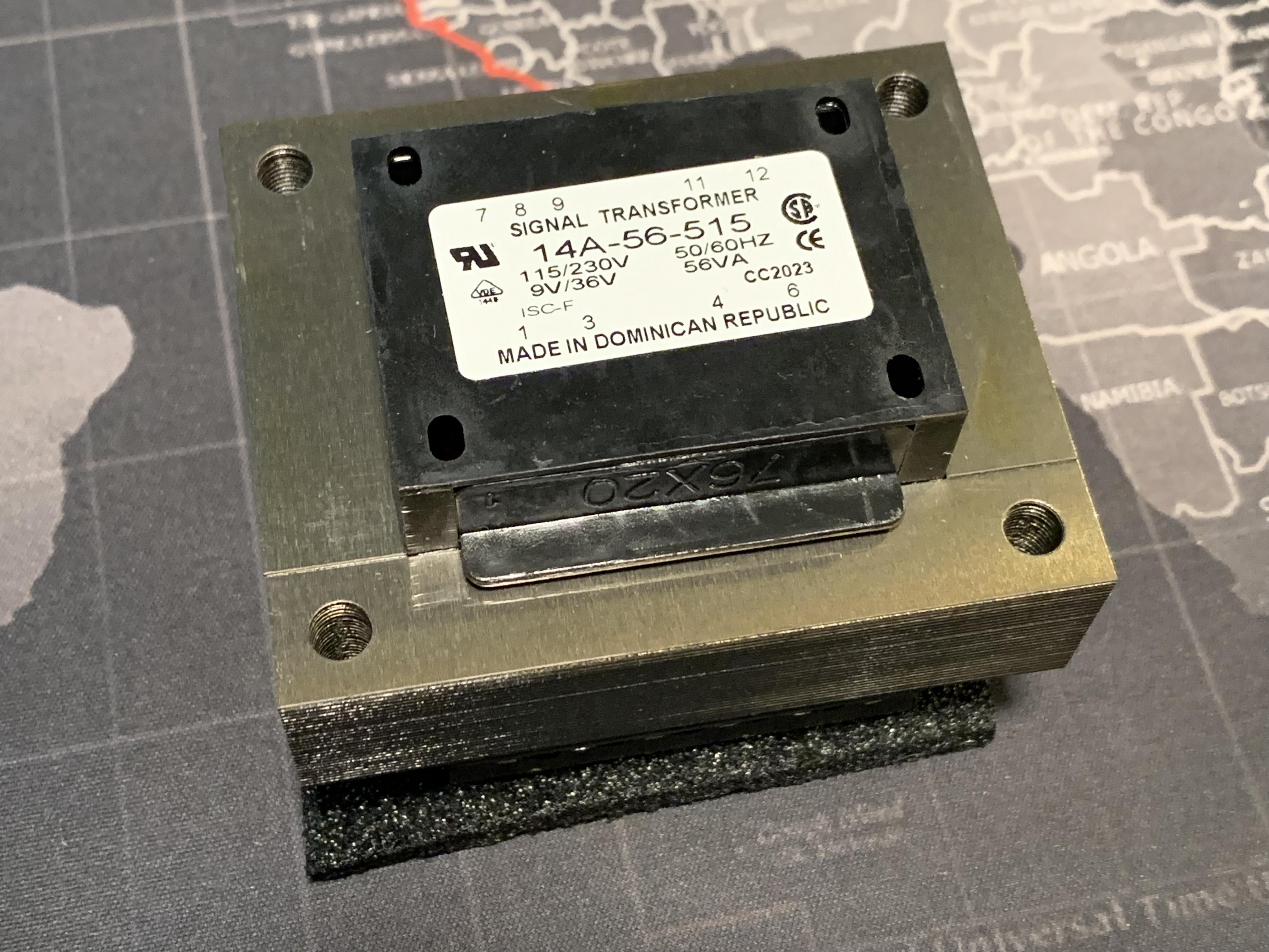

56VA 9V/36V (18V x2) transformer came in today. Should make a fine source of AC for the volume control. Might even be a good choice for some other devices. I’ll mount it to a proto board, add some Euroblocks—instant power source. Not terribly beefy boards, but should be satisfactory until I want to build something purposeful.
Part number is a few posts up.

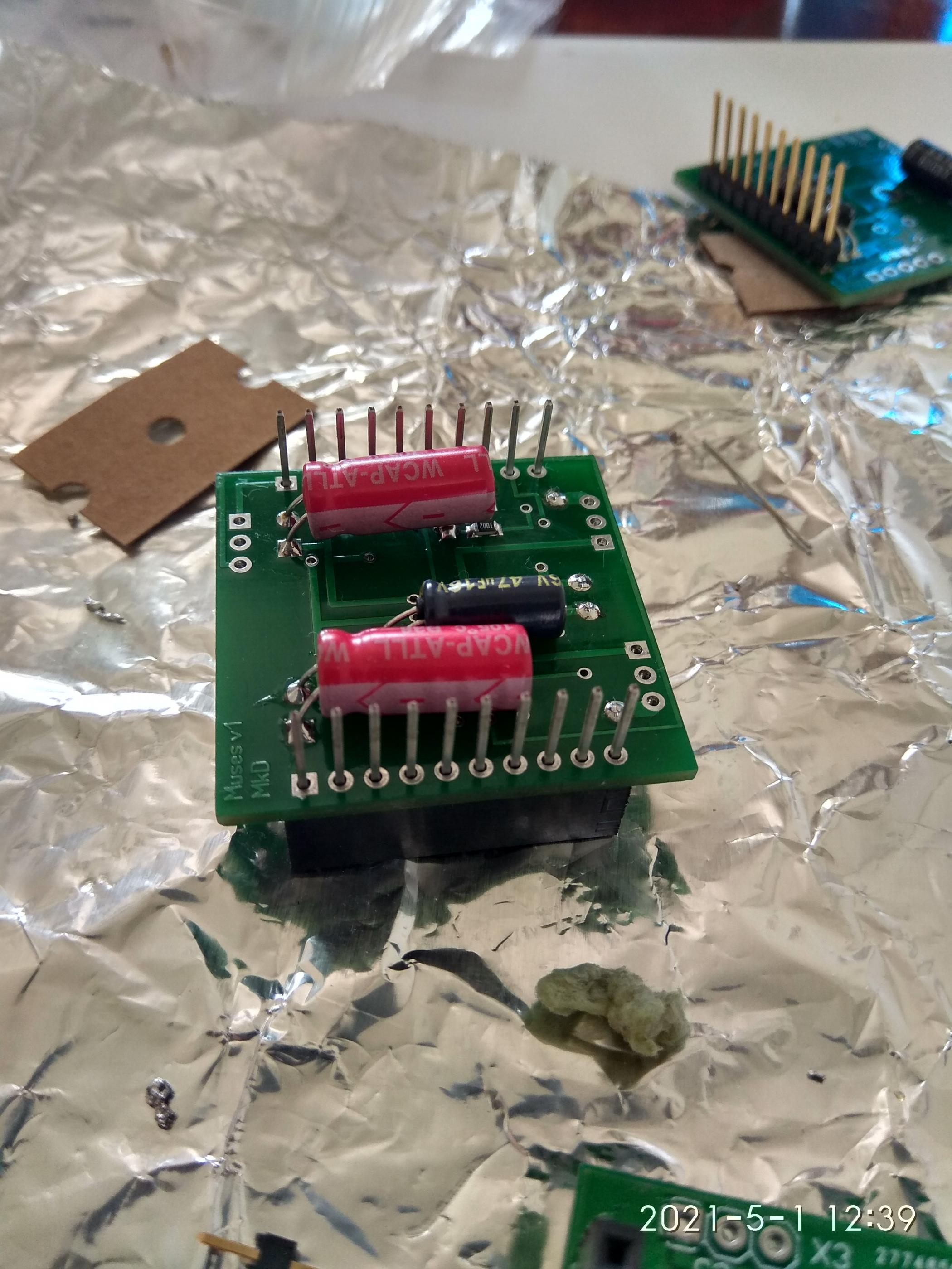

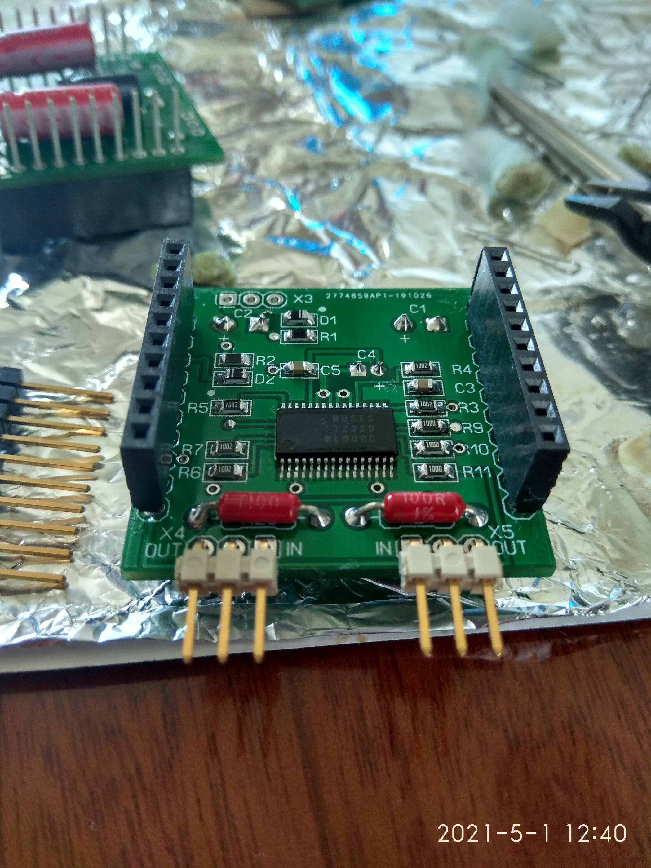

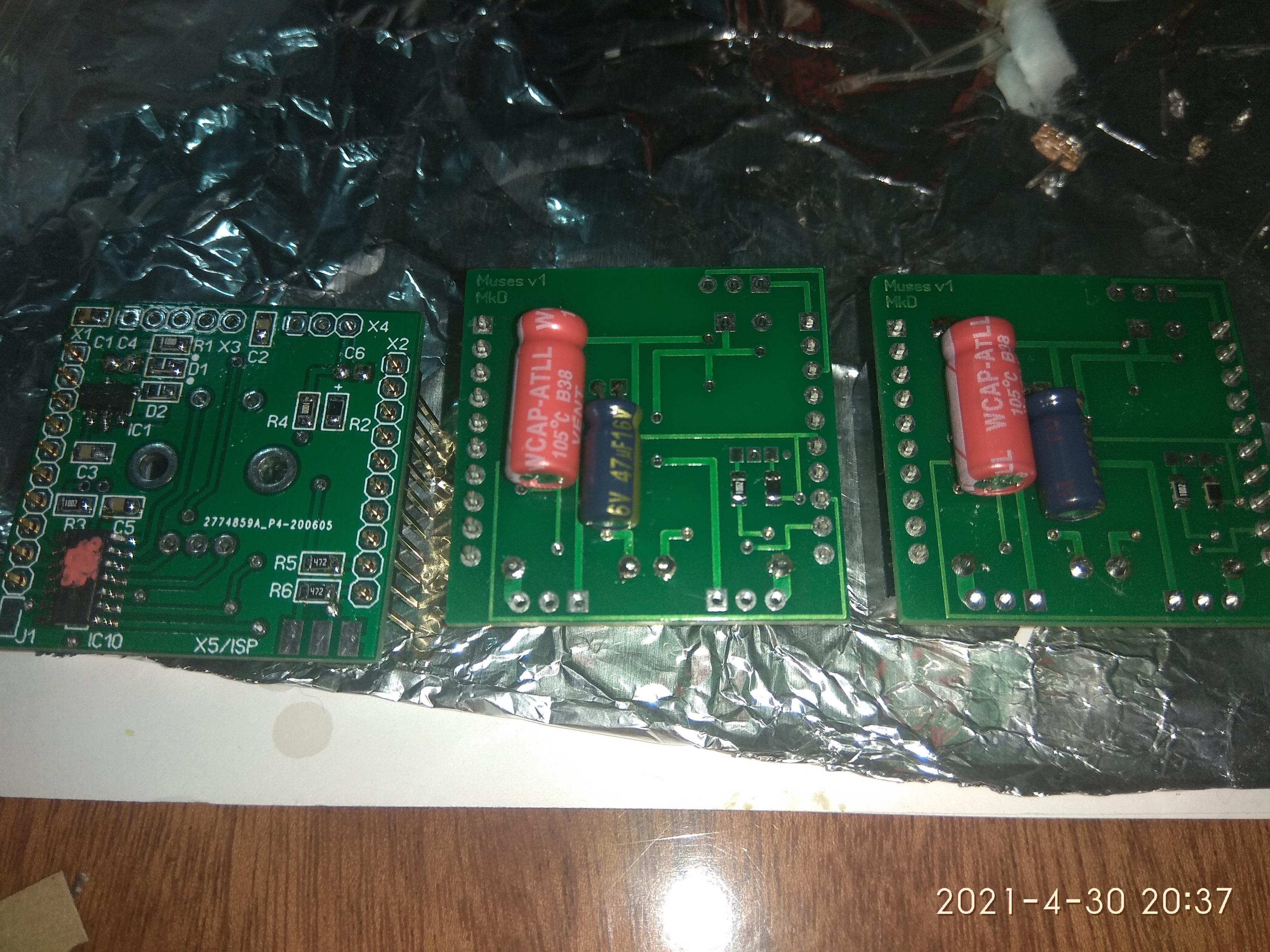

This is my progress, my friend will wait for a little.
Hand made, no oven
Not cleaned yet..
That's impressive Thimios!

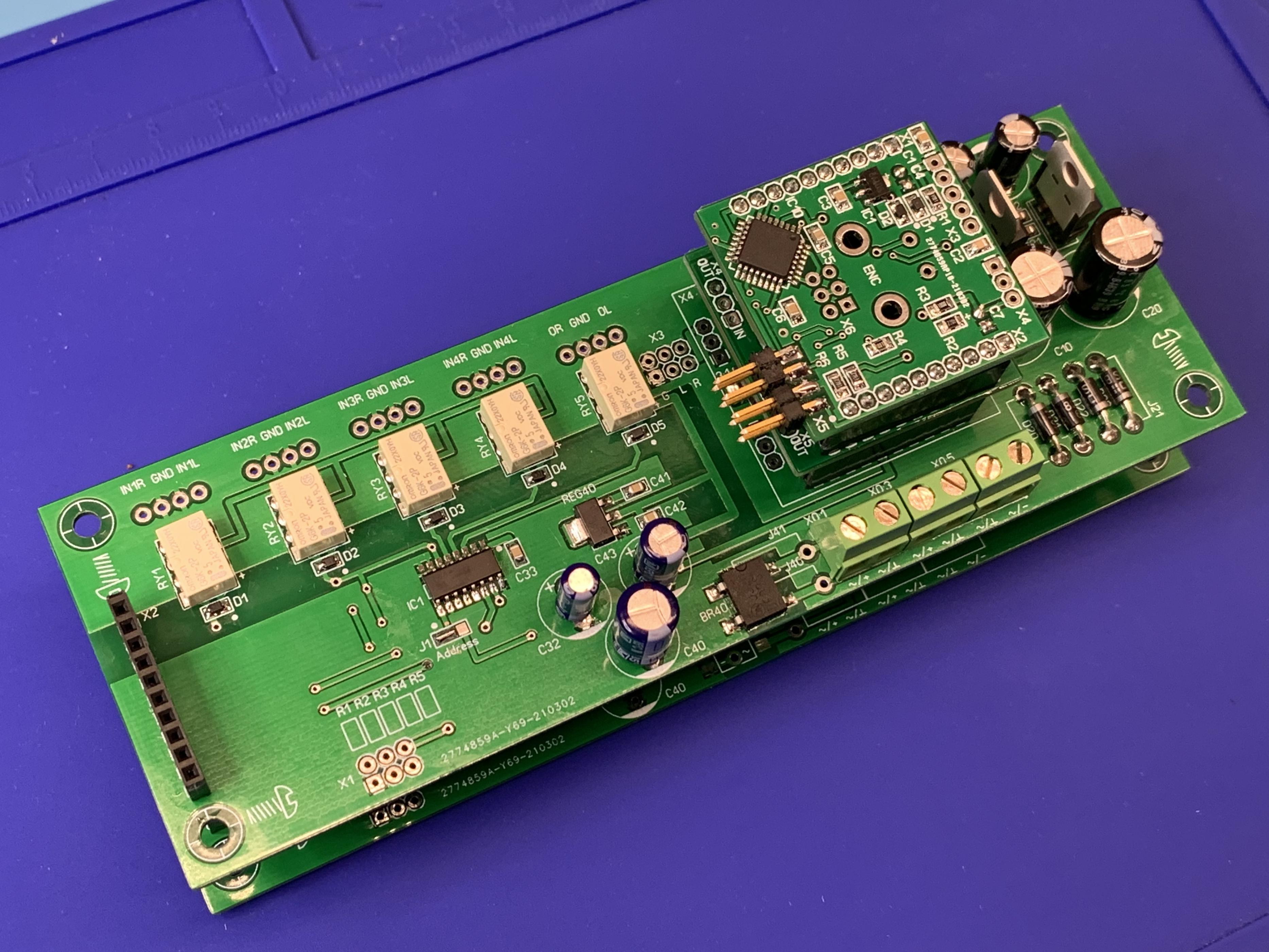

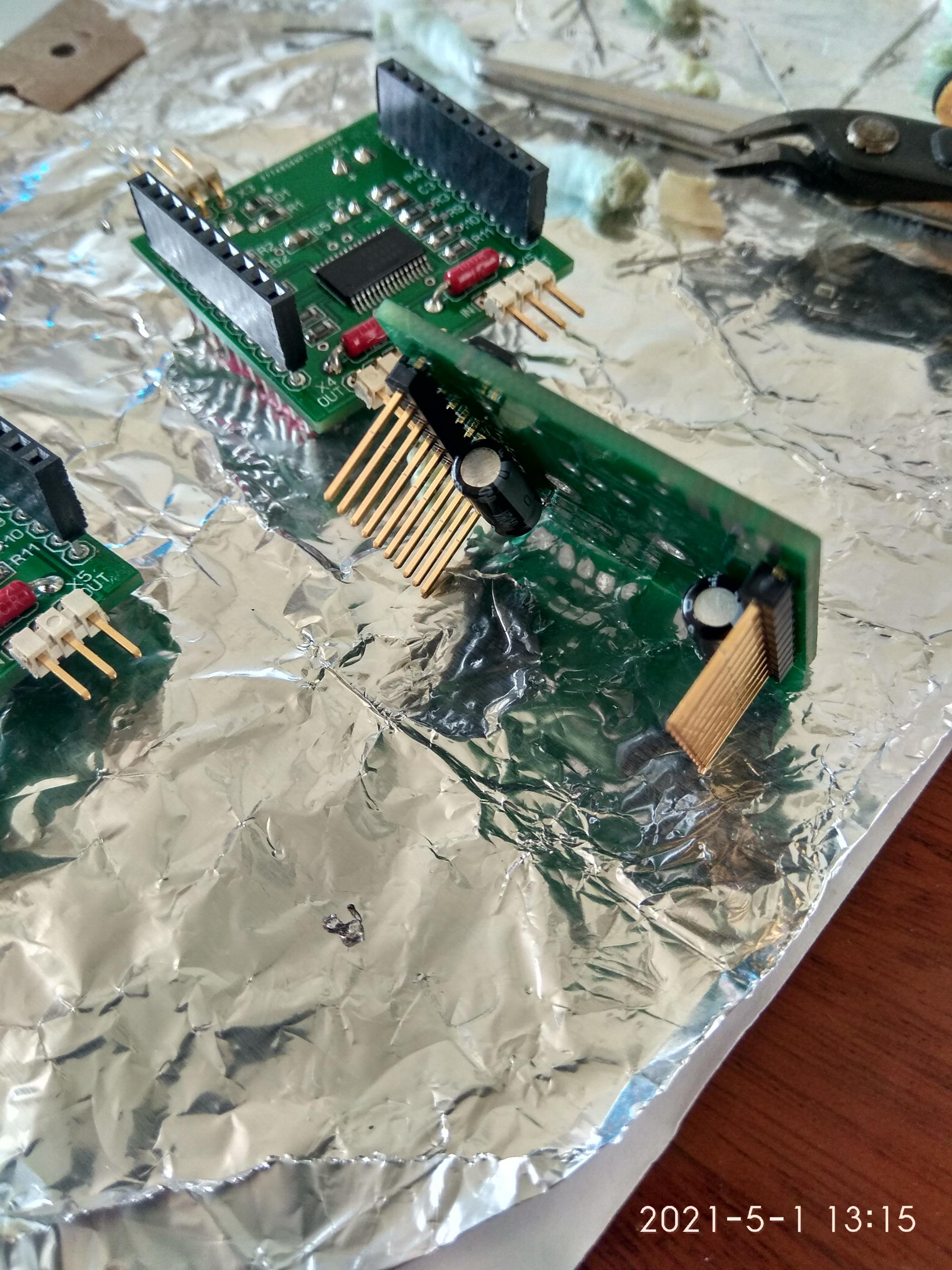

Got as far as I can today while waiting for the last couple of connectors and the rotary encoder to arrive. Got 'er packed and stacked. I had to desolder some connectors and replace them with Arduino-style stacked headers so that they could nest together.
For those familiar with this setup, you'll notice that connectors X3, X4-3, and X4-4 aren't installed. I'll be capturing the audio at a non-standard location for a special integration in my project. So I've left those connectors out of this set as I'll be wiring directly to the board(s) at these locations.
When the encoder is installed, I imagine it will look like a steamship
Nice work. It looks great. Has a little lego look to it.

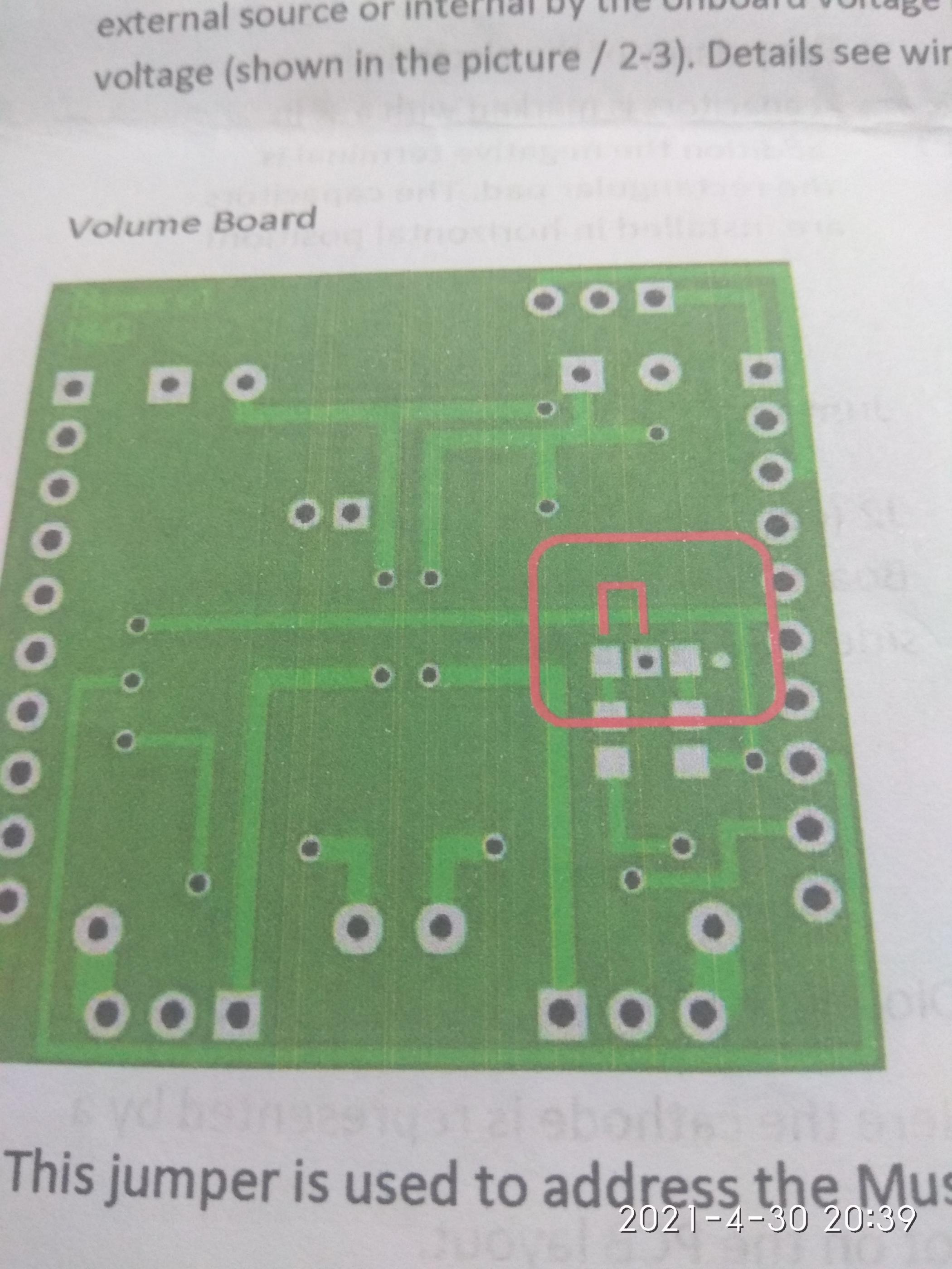

How must be set the jumper adress in two boards?
Same as in photo 2?

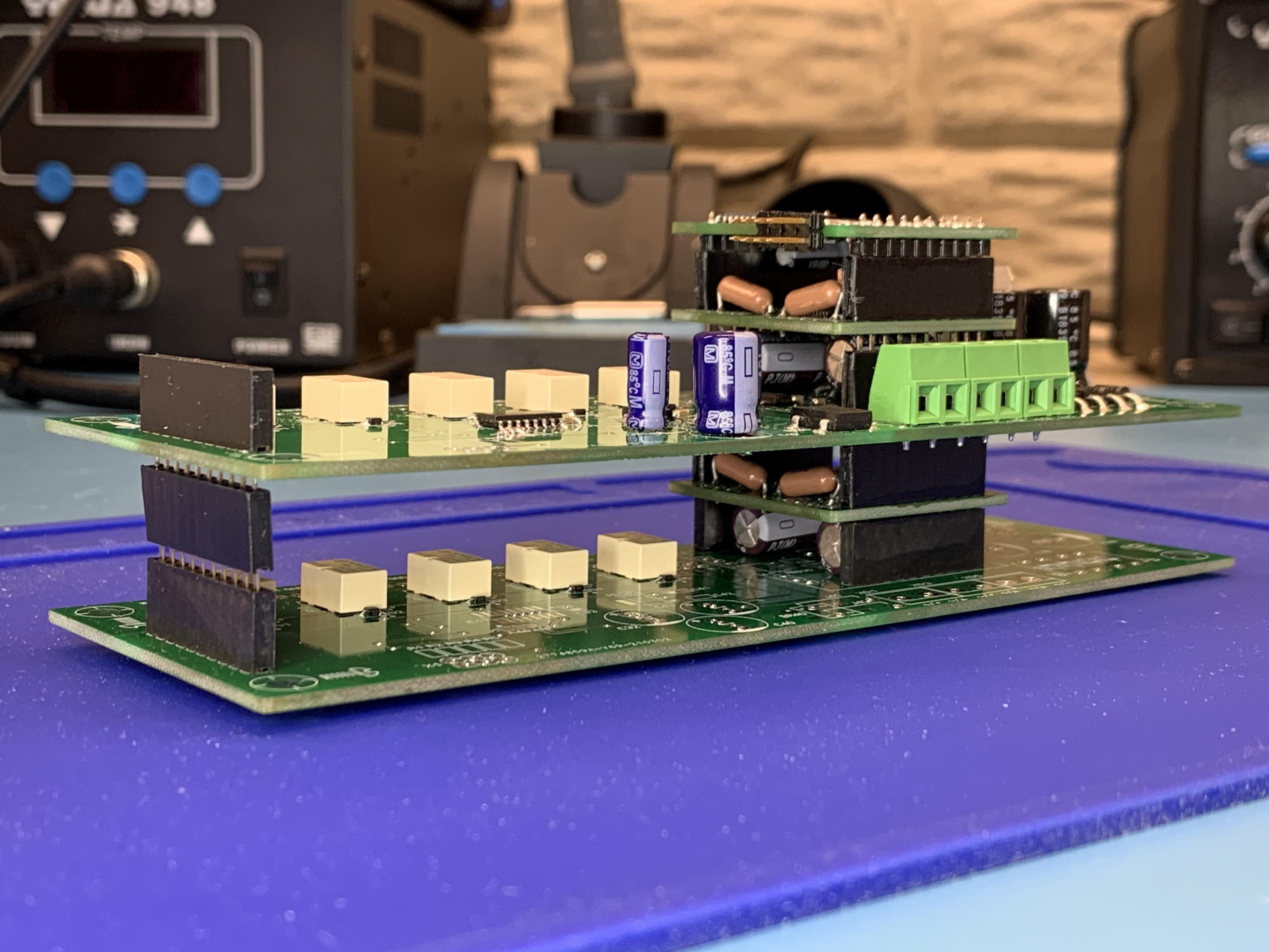

Nice, very nice Work!
I see you have two volume attenuators boards there. Are you building a 4-channel unbalanced system? If so (meldano will correct me if I’m wrong) then I believe that one set of stackable Arduino-style headers are needed on one board, and a regular female (non-stacking) header on the other. That way signal and voltage can pass to each board.Please can you explain a little
Thanks again!
I’d have to double check the documents, but I believe you’re correct with your photos, presuming the above is true. If you uses stackable headers on both boards, you may just end up cutting off the long leads you don’t need on one of the boards.
