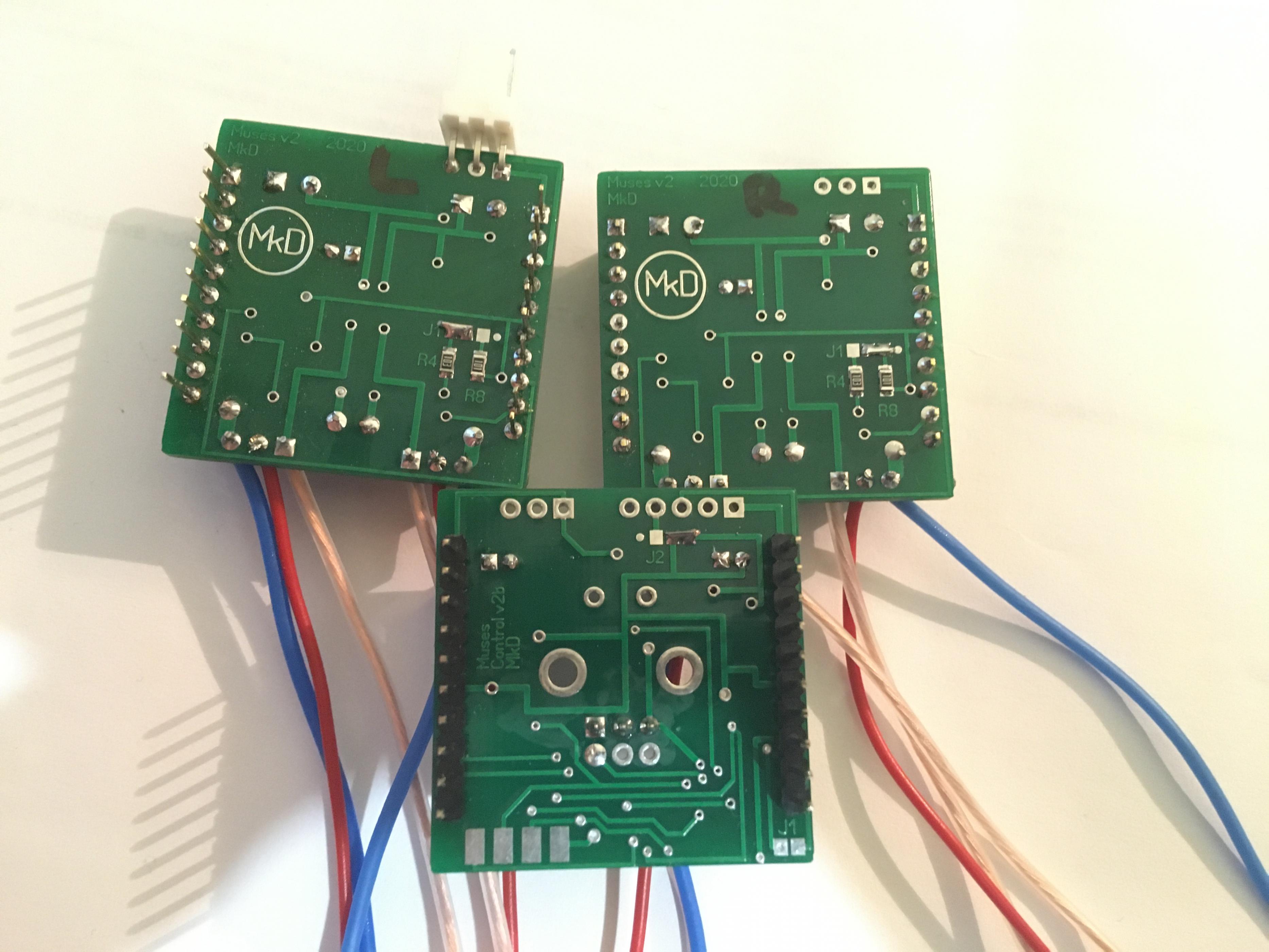

Thimios is very kindly assembling these boards for me.
In simple terms it will be a four channel volume control with both of the volume boards controlled by the single control board. All four channels need to be controlled with the same volume levels from the controller signals.
The volume boards will be mounted at the rear of the chassis and the control board on the front panel, connected by a ribbon cable.
My assumption is that the volume boards will be stacked.
I think the easiest way to think about the stacking requirement is to assume there is no separation between the control and volume boards, so it is a simple three-layer stack. In that respect it doesn't really matter whether the control board has pins or sockets on its rear face as long as the other boards have their headers to enable them to be stacked correctly.

Got a problem, no sound, Can someone spot something?
L channel selected pins 1 & 2
R channel pins 2 & 3
Controller board 3.3V supply selected pins 2 & 3
I'm getting +/-15V at X1 connector pins 1 & 3 ok
Getting 3.25V from controller reg ok
All pins are soldered, tried both types of encoder.
R5 & R6 pull up resistors on controller board are omitted, J1 is open
