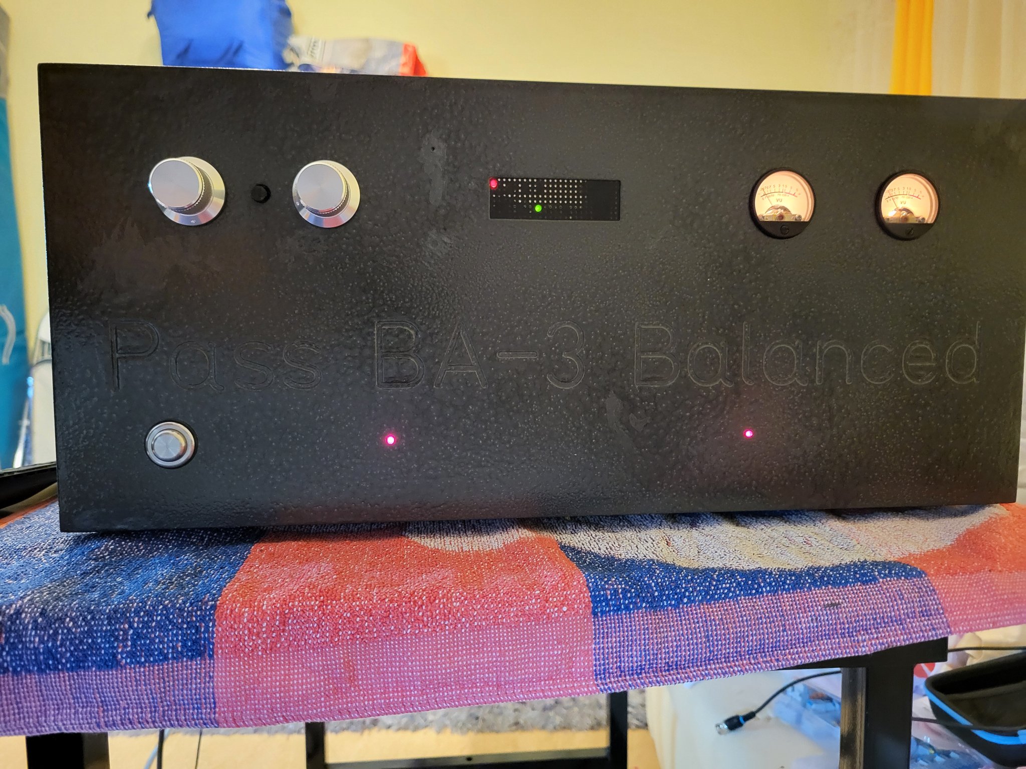

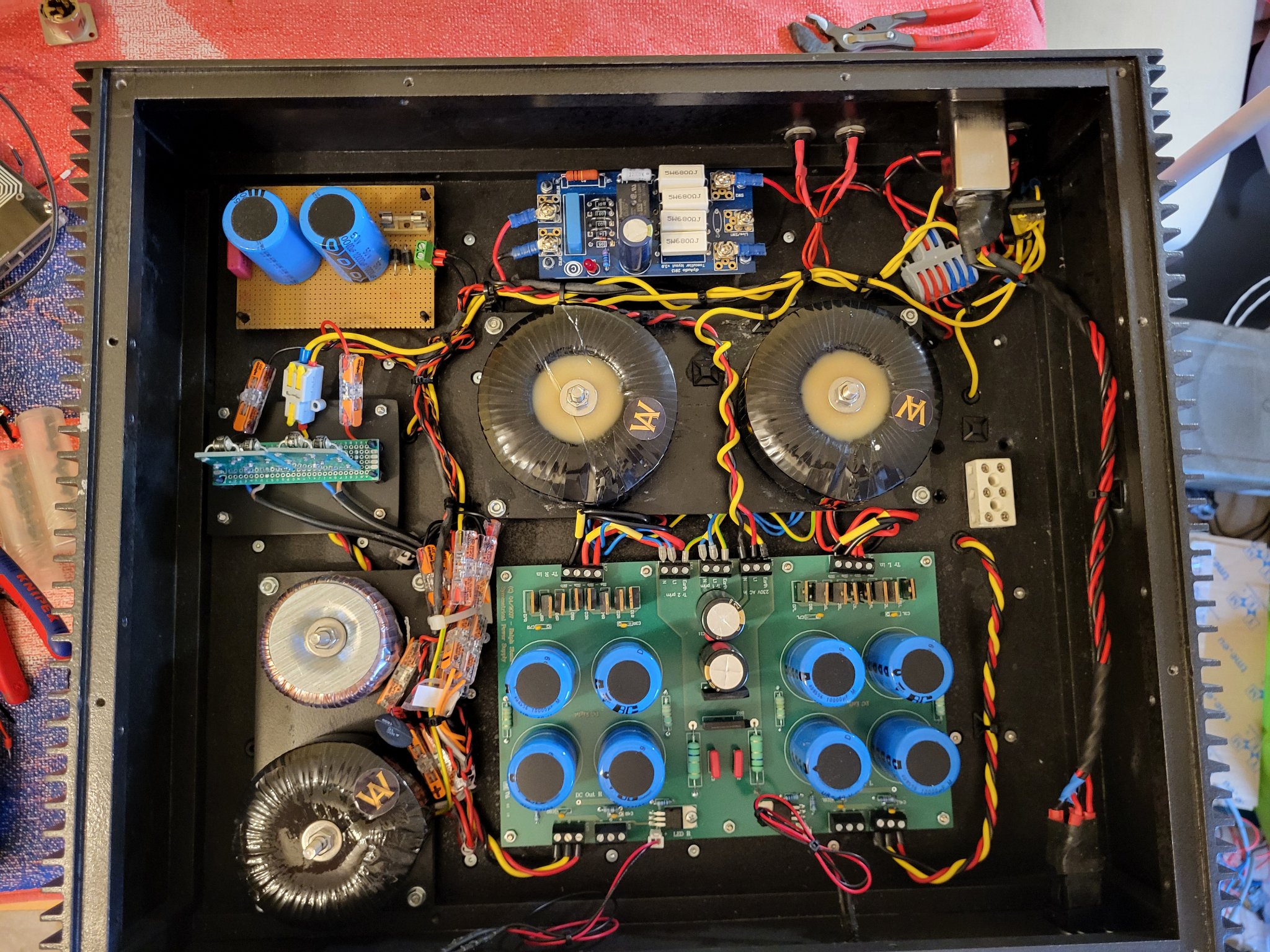

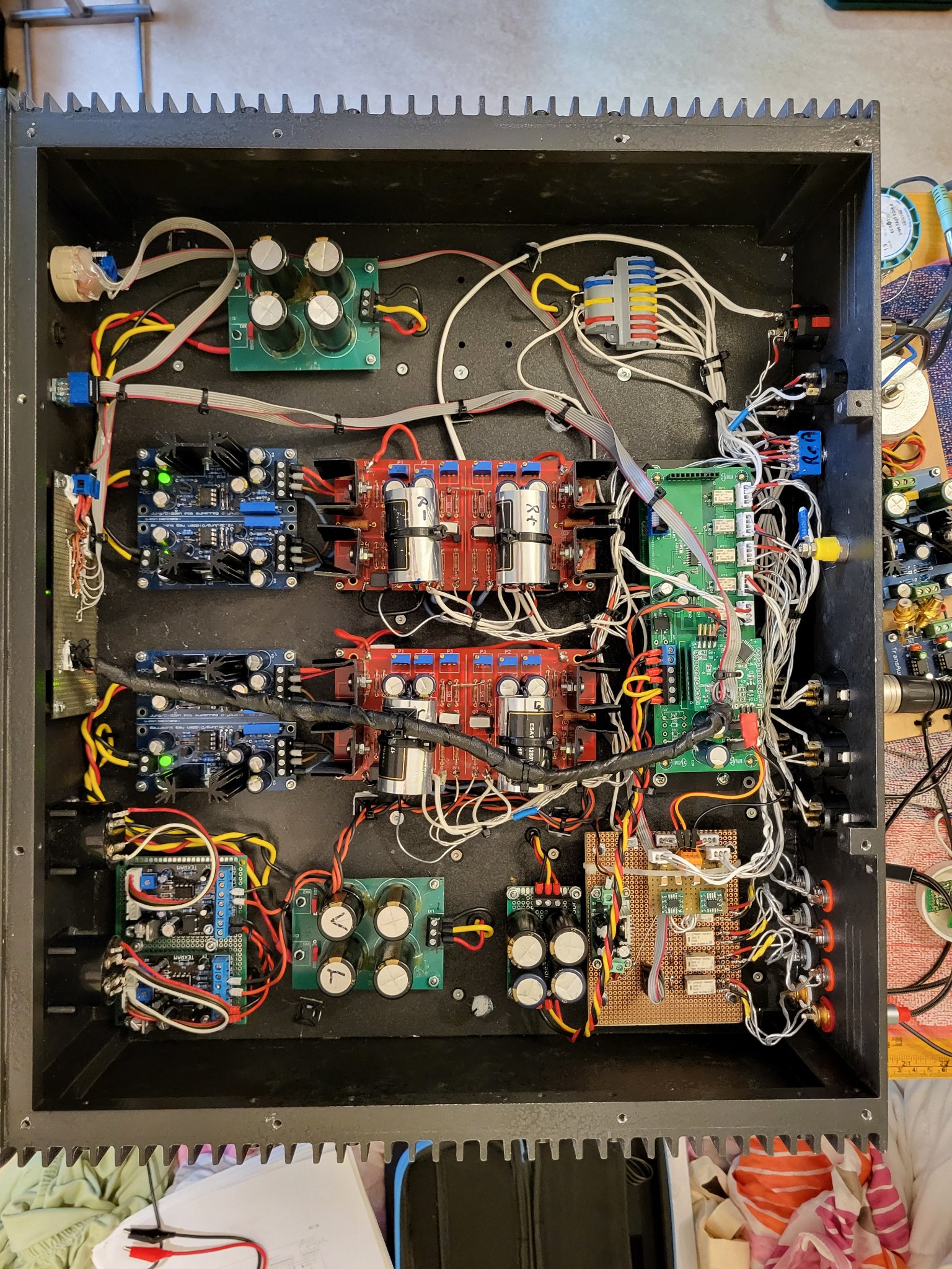

Hello,
unfortunately it took a little longer with the pictures, I have a strong hiss at 7250 heart. After I shielded the cable from the IR sensor, the hissing disappeared.
When it's warmer I'll have to paint the front again.
