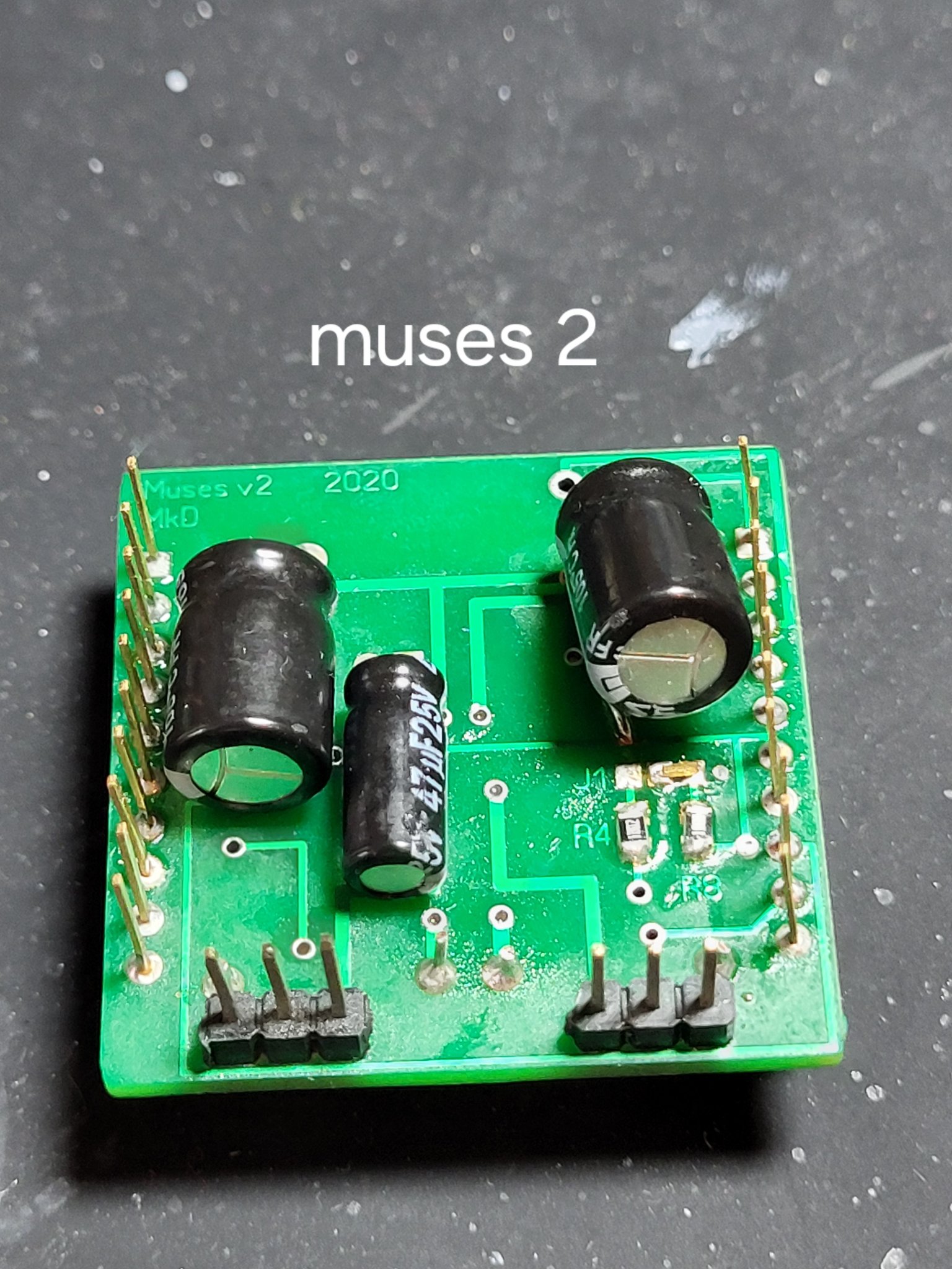

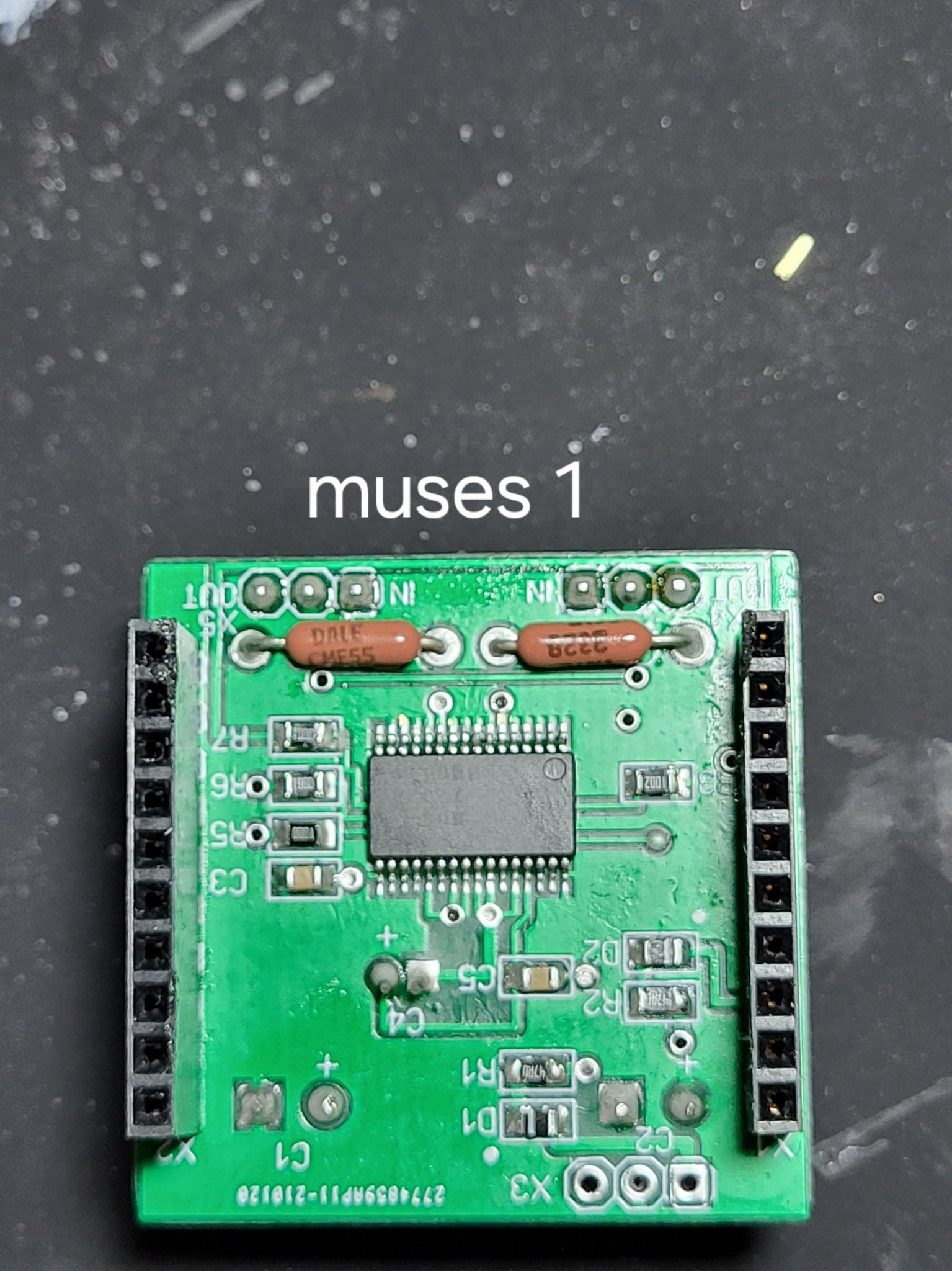

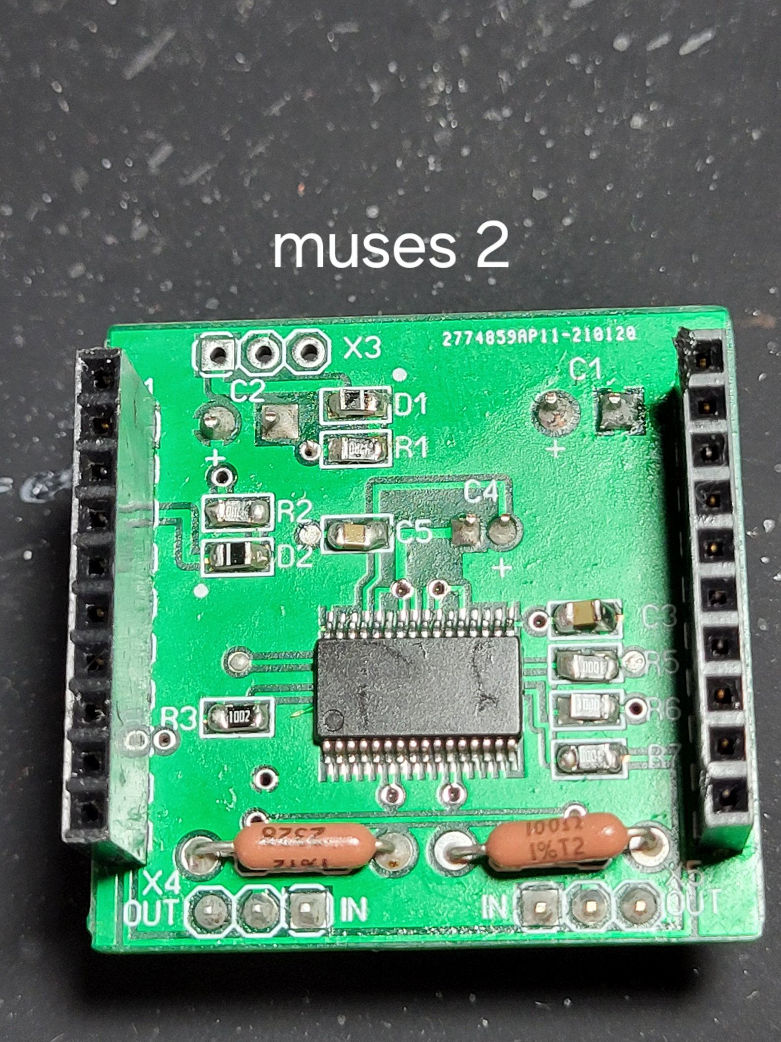

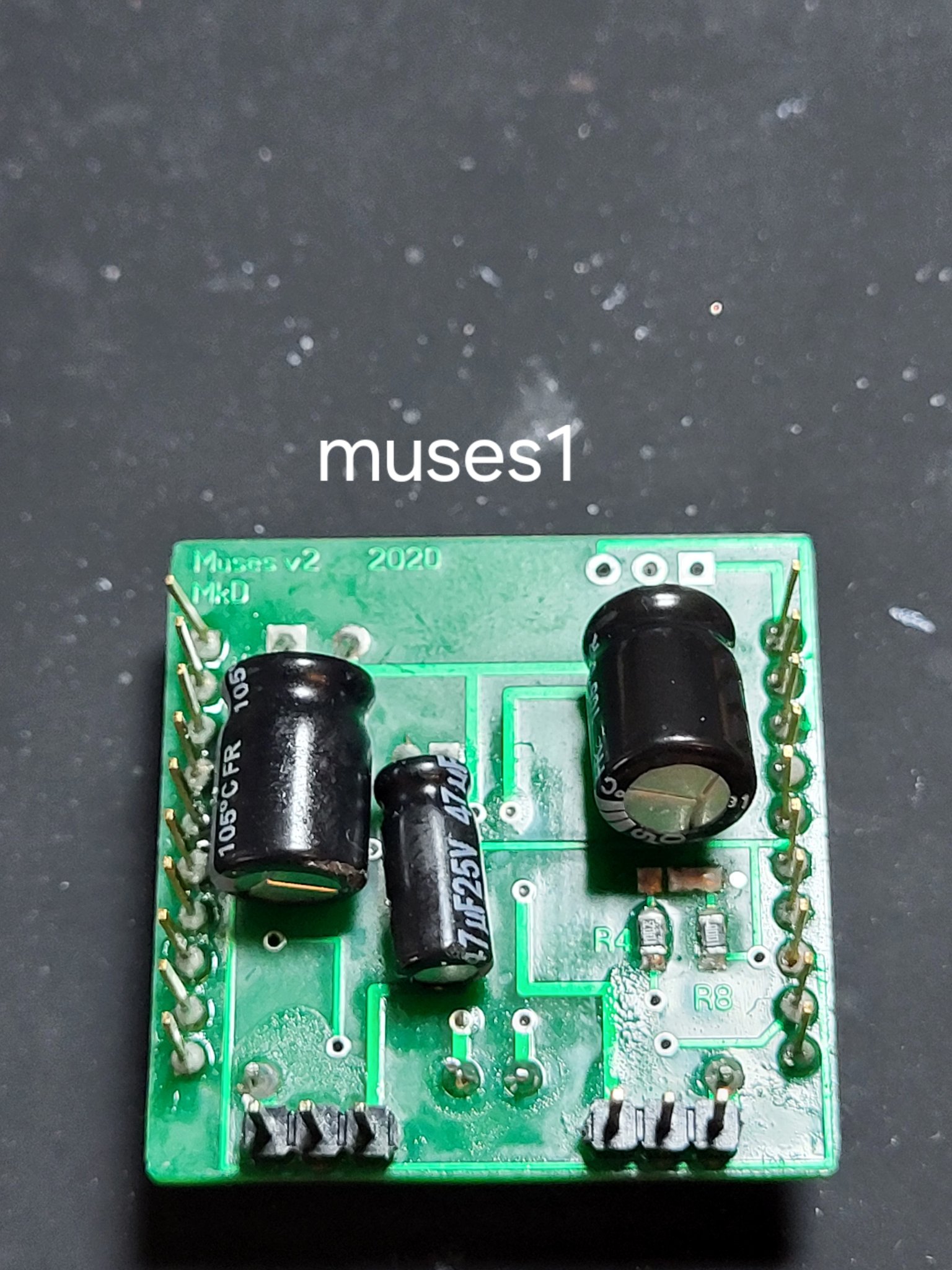

Hello,
please help me I can't get any sound from my two musses boards.
Tested:
Controller i.o accepts all commands.
Mainboard i.o with controller and musses tested, settings 4 = 000 404, 8 = 000 800 all channels and led`s are switched and show, input signal arrives at the muses boards.
Muses board tested individually, no signal is passed through the muses, controller board setting default on se test.
Muses board J1 to 2+3, controller board voltage via X3 J2 to 2+3.
Muses re-soldered twice.
Tested:
Do you use Muses 72323 or 72320?
Did you check the muses only with the controller board (without main board)?
Daniel
Daniel
Then J1 should be set from 2 to 3.
Page 8/23:
„J1: This jumper is used to address the
Muses72320.
This jumper MUST be set from pin 2 to 3
for unbalanced mode (see parameter
settings)!“
Page 8/23:
Muses72320.
settings)!“
Thanks Daniel,
I thought the jumper was 2 to 3. I'll change that at the weekend and test it.
Dirk
Dirk

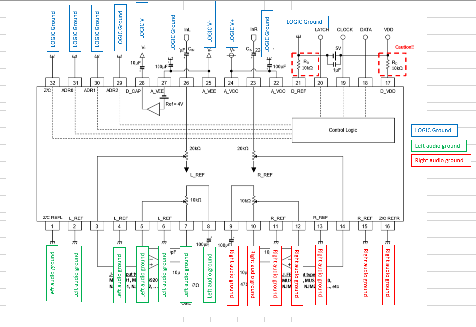

Failed to find a reply in the pages of this thread, what would be suggested supply configuration for a Meldano balanced V1 in a dual mono preamp build?
This is a large field. I have experimented with various integrated voltage regulators. Depending on the environment, I use an LM317/337 NJR or an ultra-low noise model from TI.
Provided I still need to solder this up and I am a bit trembling at this thought, its psu is a broad topic indeed, I am trying to narrow possibilities to - best and simplest - effectively power the meldano muses volume controller for my Dual Mono preamp;
I would at least think that separating muses analog psus between channels is not a wrong idea..
And what about the 5Vdd for the muses chips, does it make a lot of sense to separate these? Or these can just be powered together with 5vdc regulator on controller board and be good?
I plan to use also a display and an input switch (with a 7805 onboard regulator..) so need to keep these in consideration too..
I raised the question to NJR (Muses manufacturer), whether Left, Right and logic ground can be disconnected from eachother. I never receveid a good answer from them. I also did not try myself (quite expensive chips).
