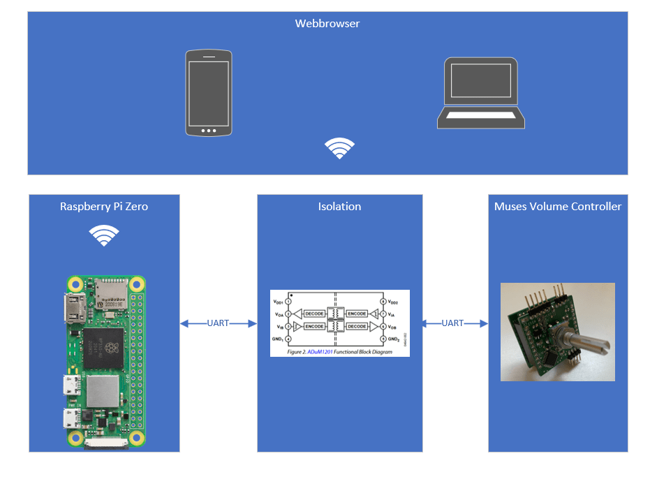

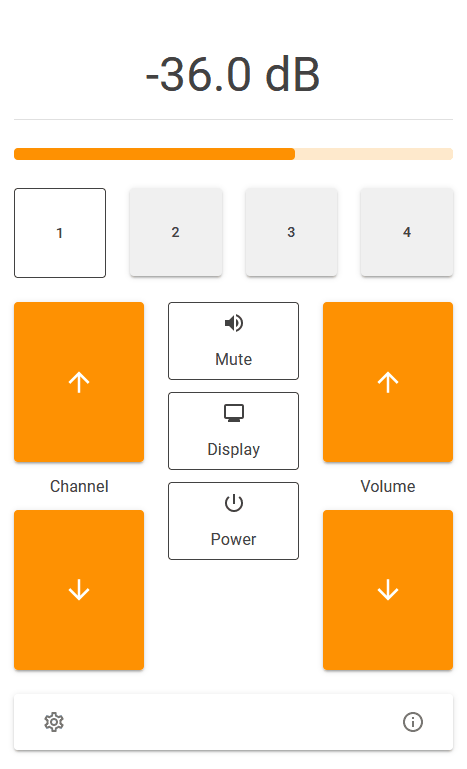

I have developed a web interface for my big preamplifier.
The web interface runs on a Raspberry Pi Zero.
The Pi is electrically isolated from the preamplifier controller.
The web interface operates bidirectionally, meaning the status updates on the web interface even when adjustments are made directly on the preamplifier using a rotary encoder or IR remote control.
Here's a sneak peek.
Is there interest in using this as a controller update for the Muses from the thread?
