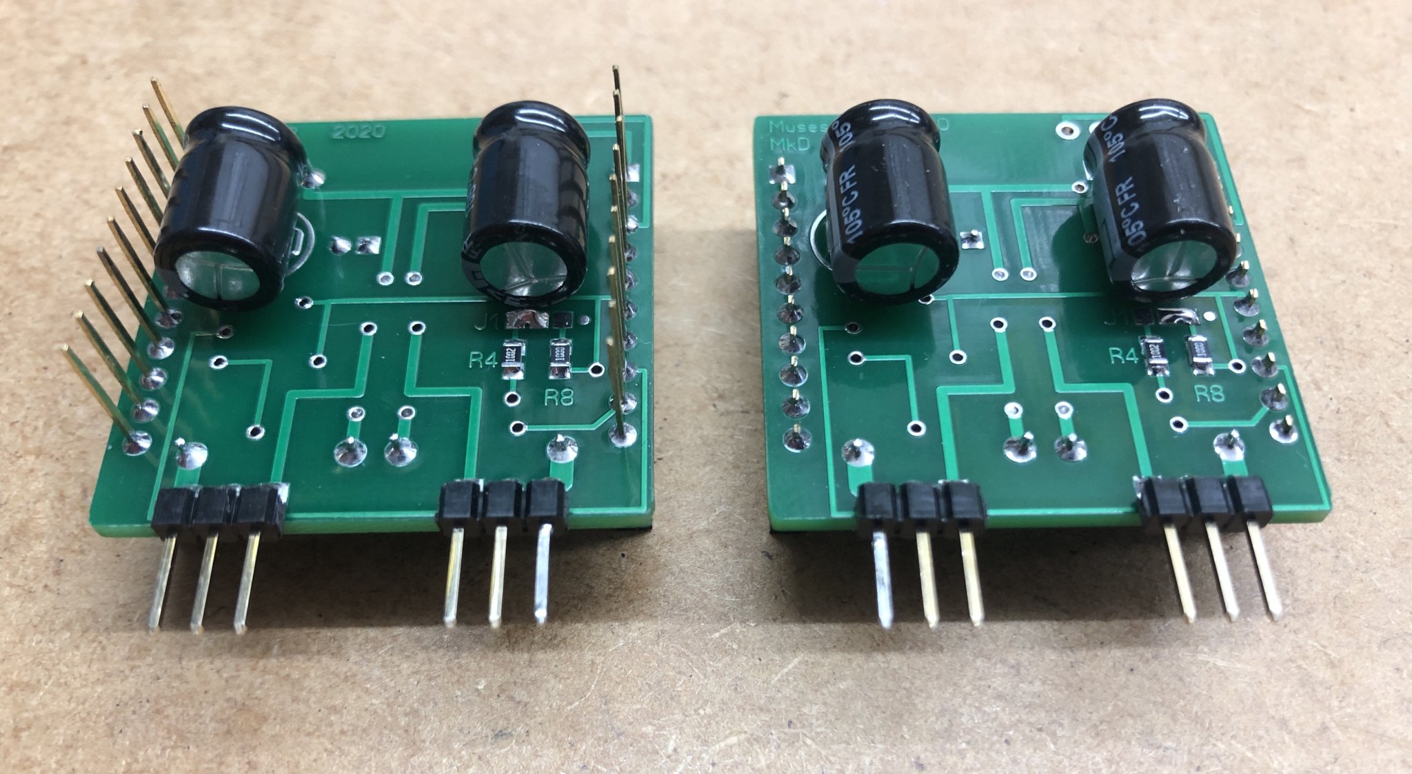

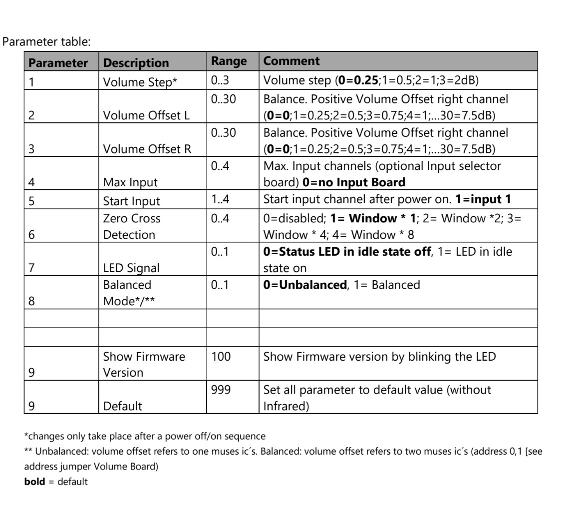

I saw the defaults and this is why I am asking if the software will prevent any output if no programming has been done. But the i/o pins would be different in case of single ended is the default.
I need to look for a remote and teach it first, I wasn't planning using one and this is why I am asking.
But looks like there is no way around. Thanks!
Maybe there could be two different versions of ST chips, pre-set for SE or Balanced...

Set software to balanced mode via
1. Press key “0” three times (LED blinks 3 times)
2. Press key “8” (for selection bal/unbal mode)
3. Press key “0”
4. Press key “0”
5. Press key “1”
LED confirms saving by blinking 4 times.

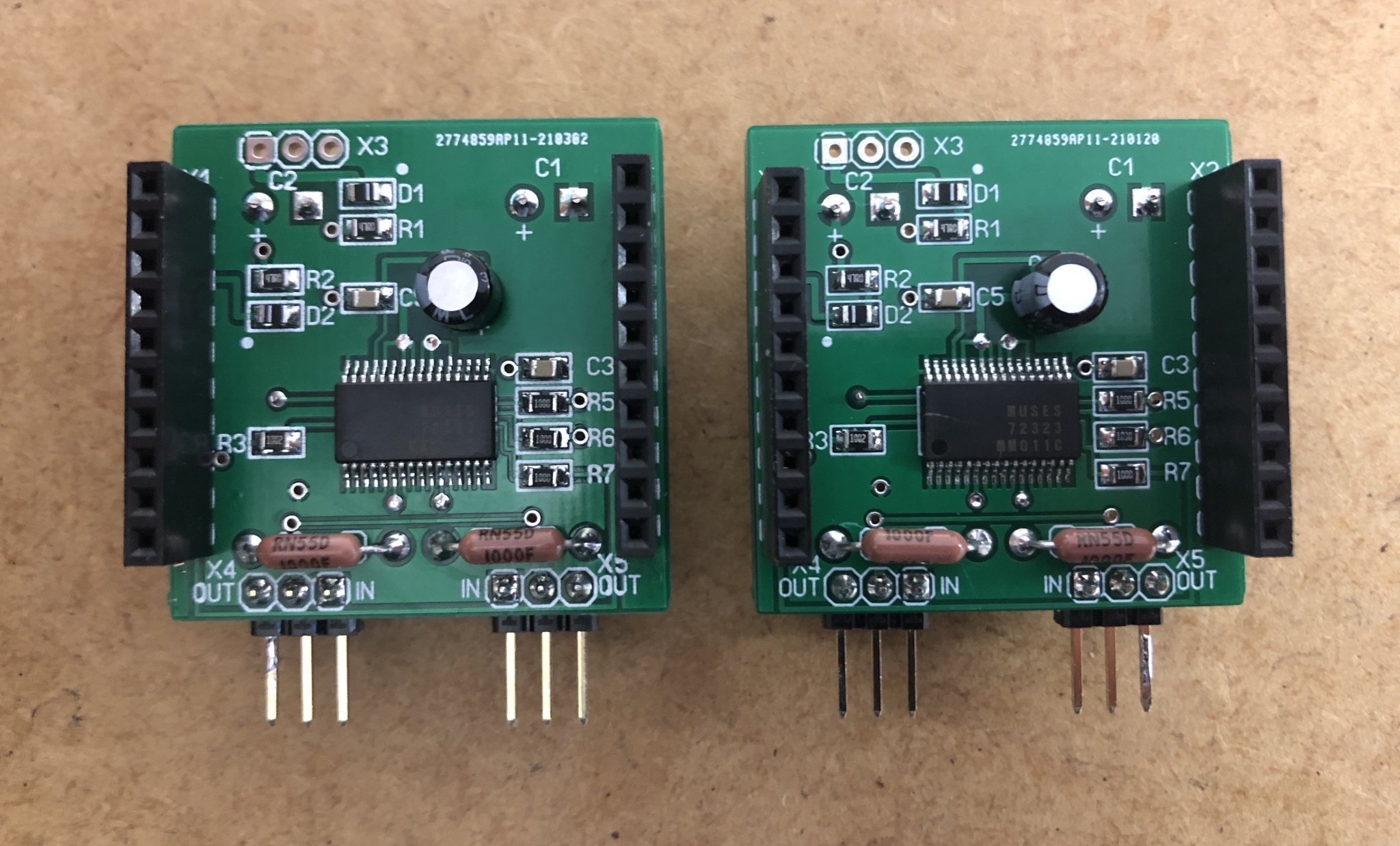

Jumpers are set on the volume boards for left/right bal channels.
Boards are receiving power.
Input is 1kHz 1V, balanced.
But nothing on the output.
Hi Daniel, thanks for your ideas!
a) I don't have R5 and R6 on the controller board populated as I am not using the mainboard, right.
The R5/6/7 (X1 pins 8, 9, 10) on the Muses boards for DATA, CLOCK, LATCH... what should I look for?
b) all perfect, done under microscope
c) rotated multiple times (as step is 0.25dB). I also used the IR remote to increase the volume. Checking output on the oscilloscope, input is there but no output, from both boards.
I really want to try and build another balanced set of these but two Microcontrollers failed on me too a while ago. It's expensive to try again. I see lots of people having trouble. Is there any way of sending the ucontroller in better fashion Daniel? They leave you fine but fail once soldered to board even with static precautions.
