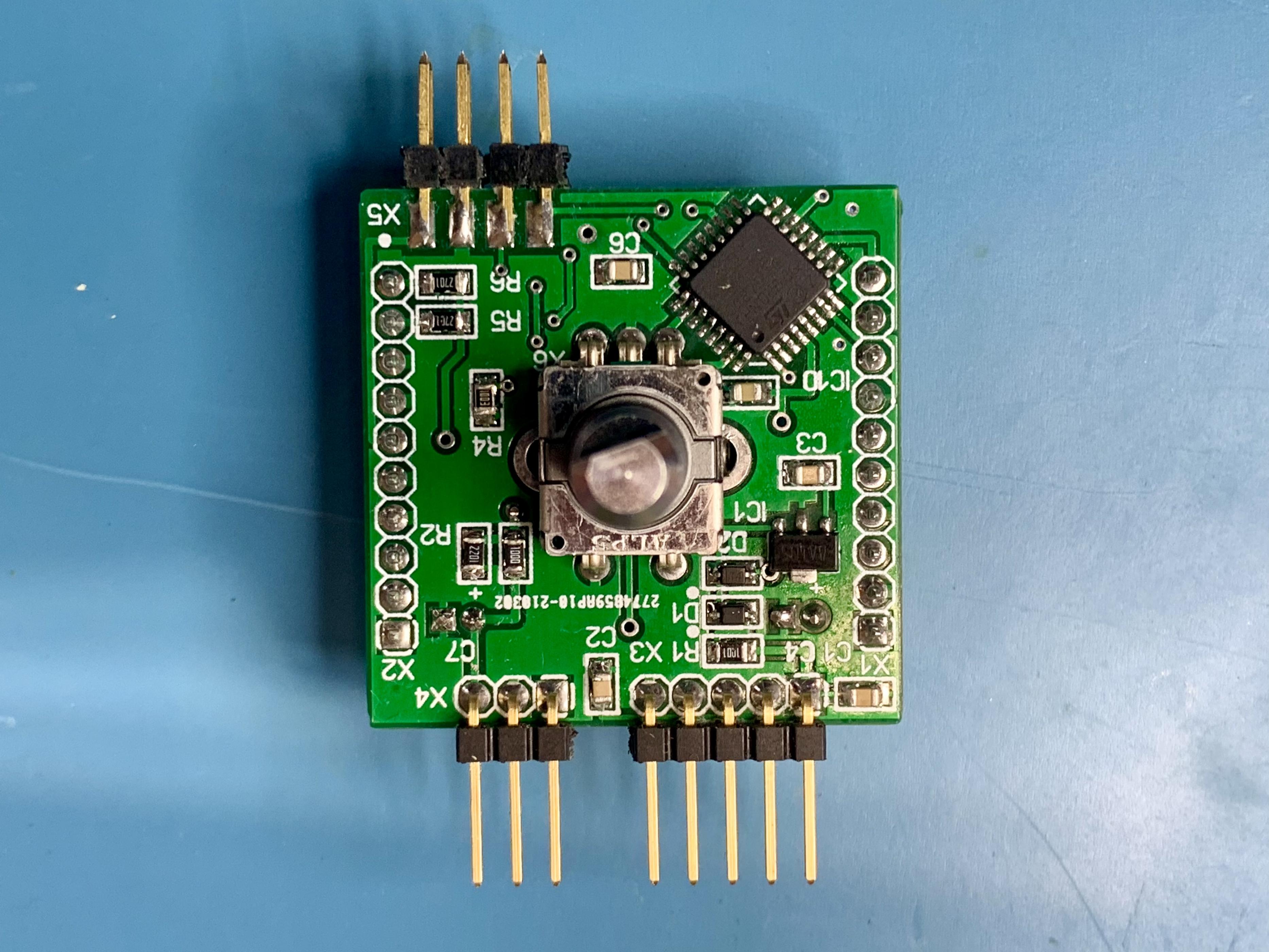

Hi Chris,

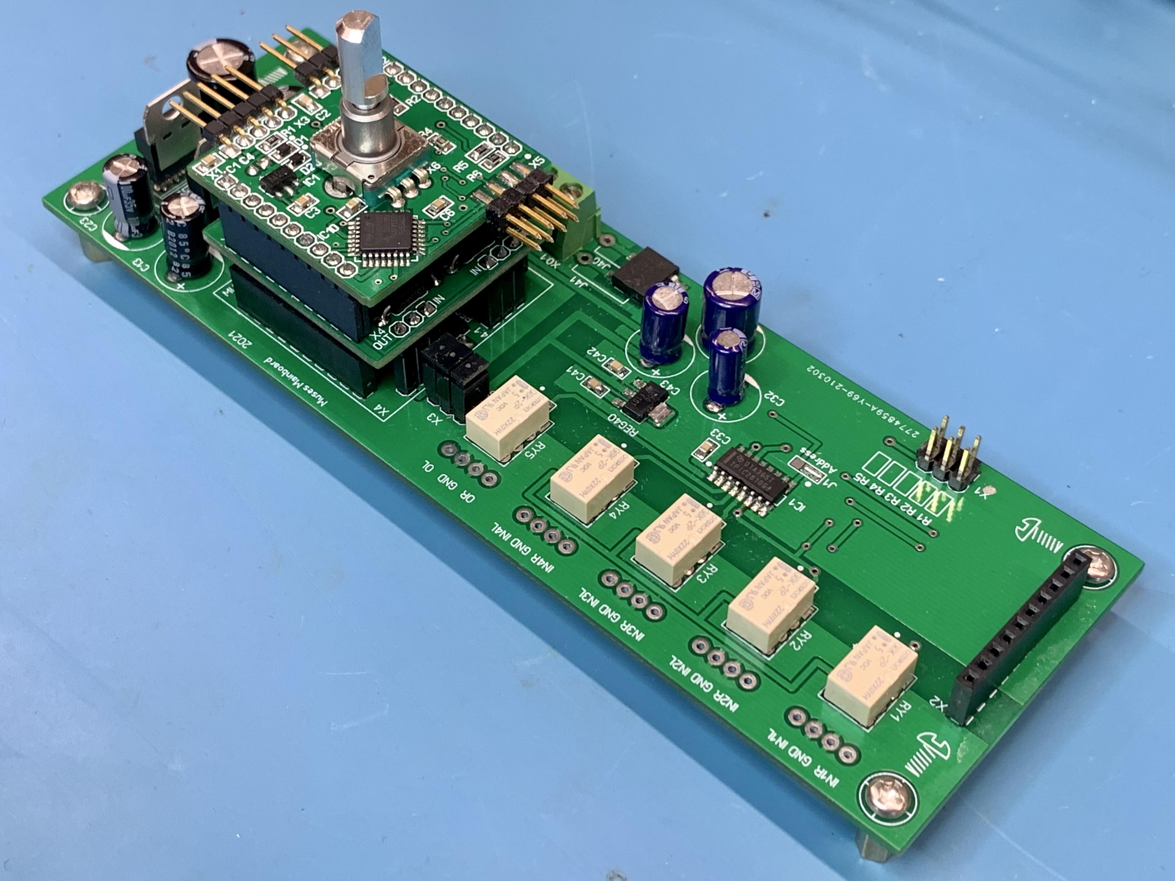

do you use the pre programmed controller? I can´t find a marker on the top.
Troubleshooting is always the same:
-3,3V power supply to the microcontoller
- connect status LED
- voltage on
- push the encoder button
If the LED toggle => everything with the controller is o.k.
Yes sir. The marks came off while cleaning the boards. The voltages all appear to be good at the micro and elsewhere. No status LED light up, however. I presume the pull-up resistor additions were installed correctly and hopefully aren’t an issue. Both boards are acting the same, so perhaps they share a common problem.
Should I pick up a programmer and see if we can reach and possibly reprogram the microcontroller?
Hi Chris,
- voltage on

Just throwing out options and reprogramming was one. Probably a dumb one.
I did have 3.3V on Vdd. Vss is shown as ground on the schematics, and I was reading zero there. I just lost my +15VDC regulator, so it looks like I've got a little more work to do now. 🙁
I'll wait until my new 15V transformer comes in before I do anything else. And get some new regulators on order. :sigh:

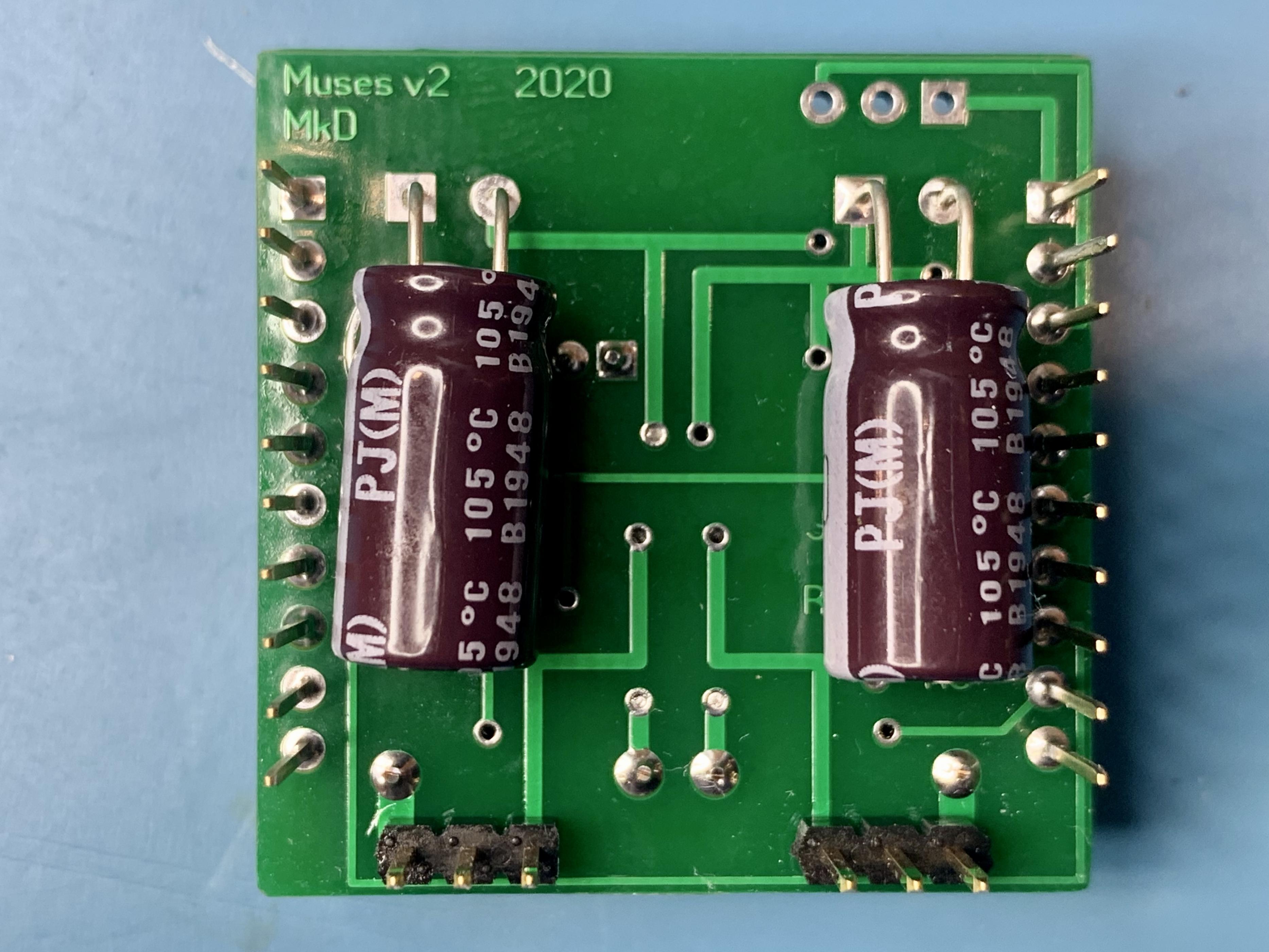

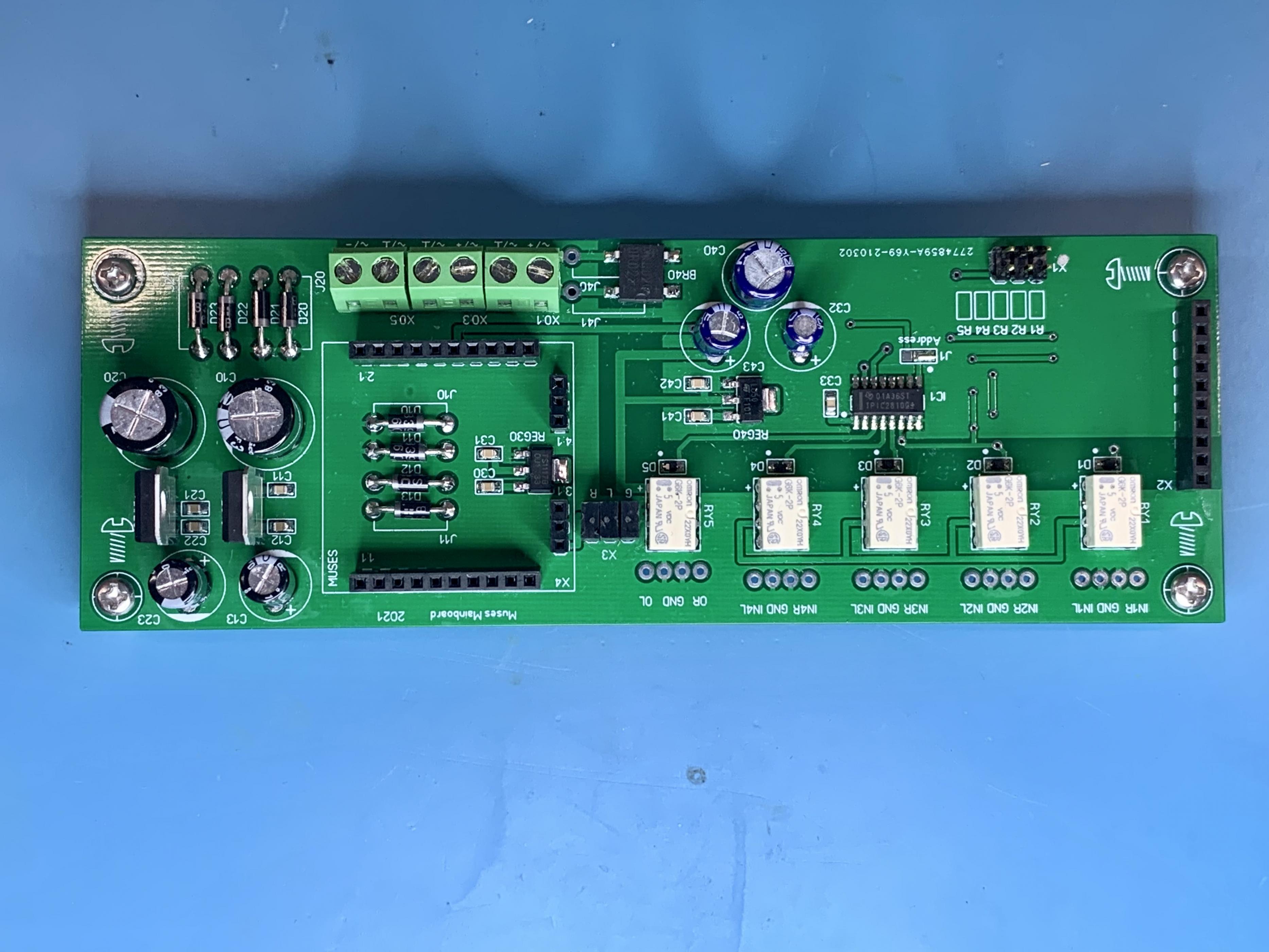

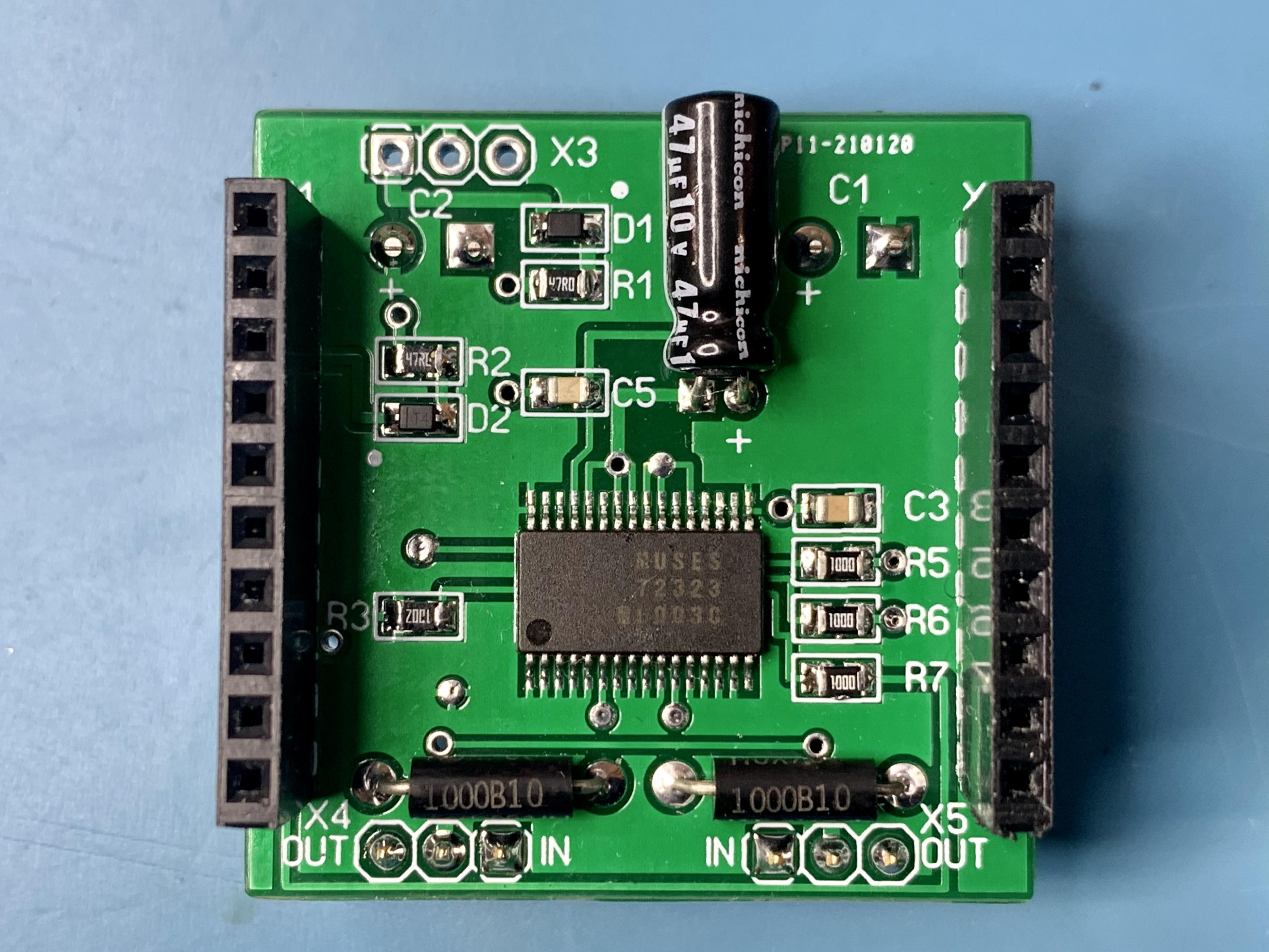

Thanks Carsten. Let’s start with the unbalanced set.

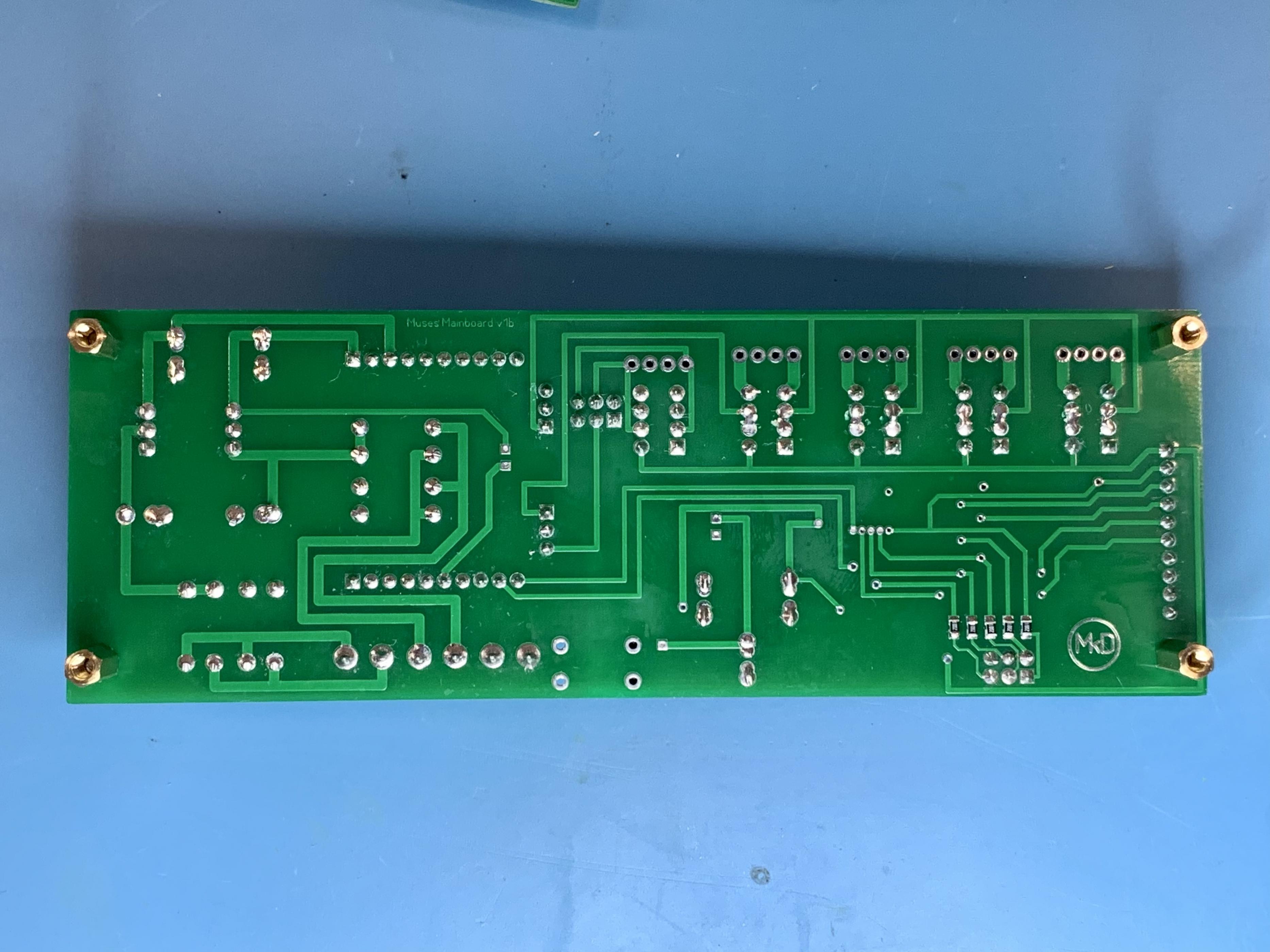

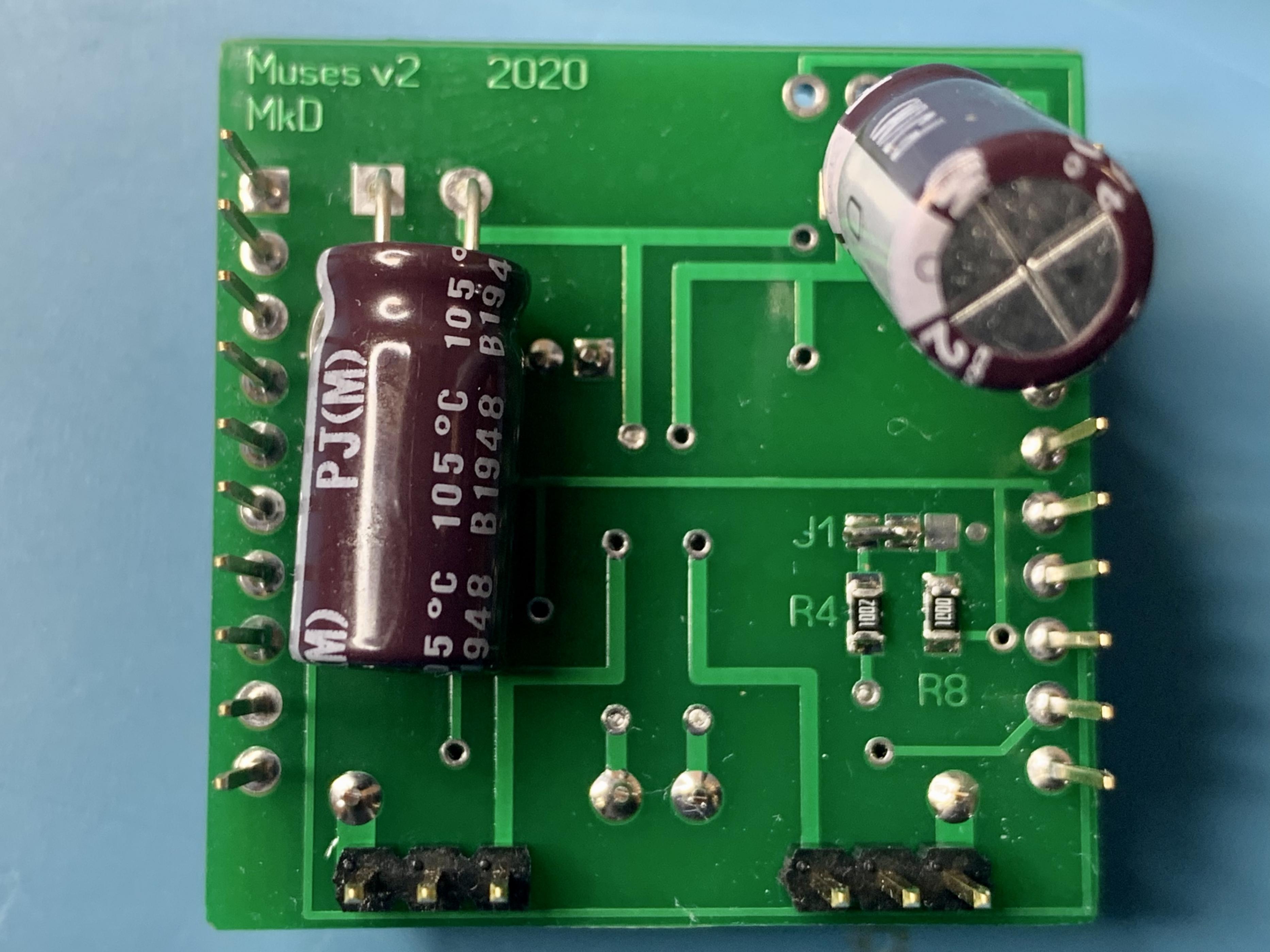

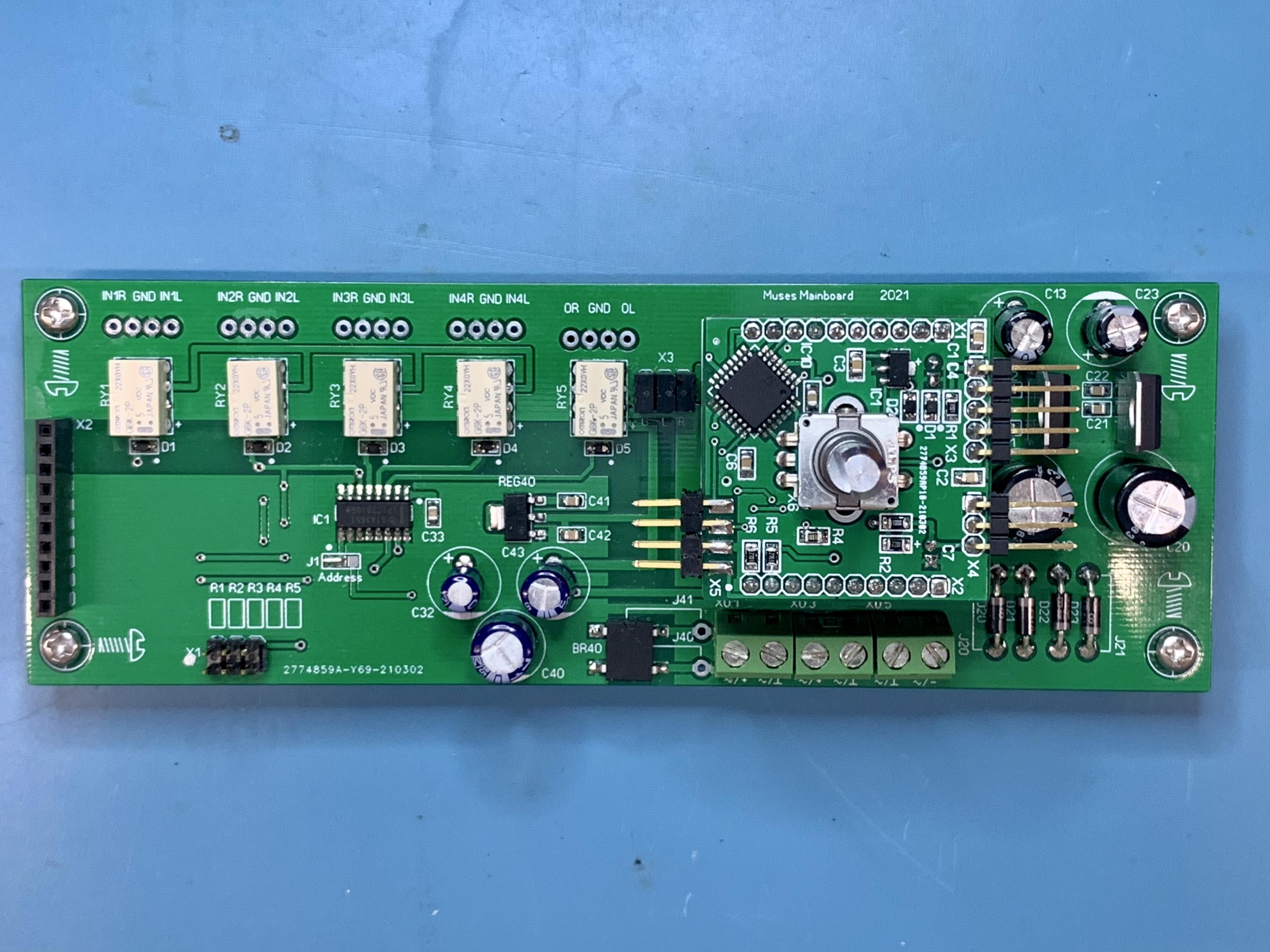

Good news! After re-reading the adjustment procedures, it turns out I’m just slightly blind and impatient. 😛
The status LED is quite dim with the suggested 2K resistor, so I just hadn’t noticed it blinking at me. I watched closely as I powered up holding down the encoder button, and I also didn’t wait long enough for it to signal me. It works as expected and the remote control and parameter tables program as designed. So the micro is good! What a relief.
I still have a bad -15V regulator, and those are on order (or in transit from dB-Key 😀 - thanks dB!)
I’ll see what other features I can test with positive voltage only.

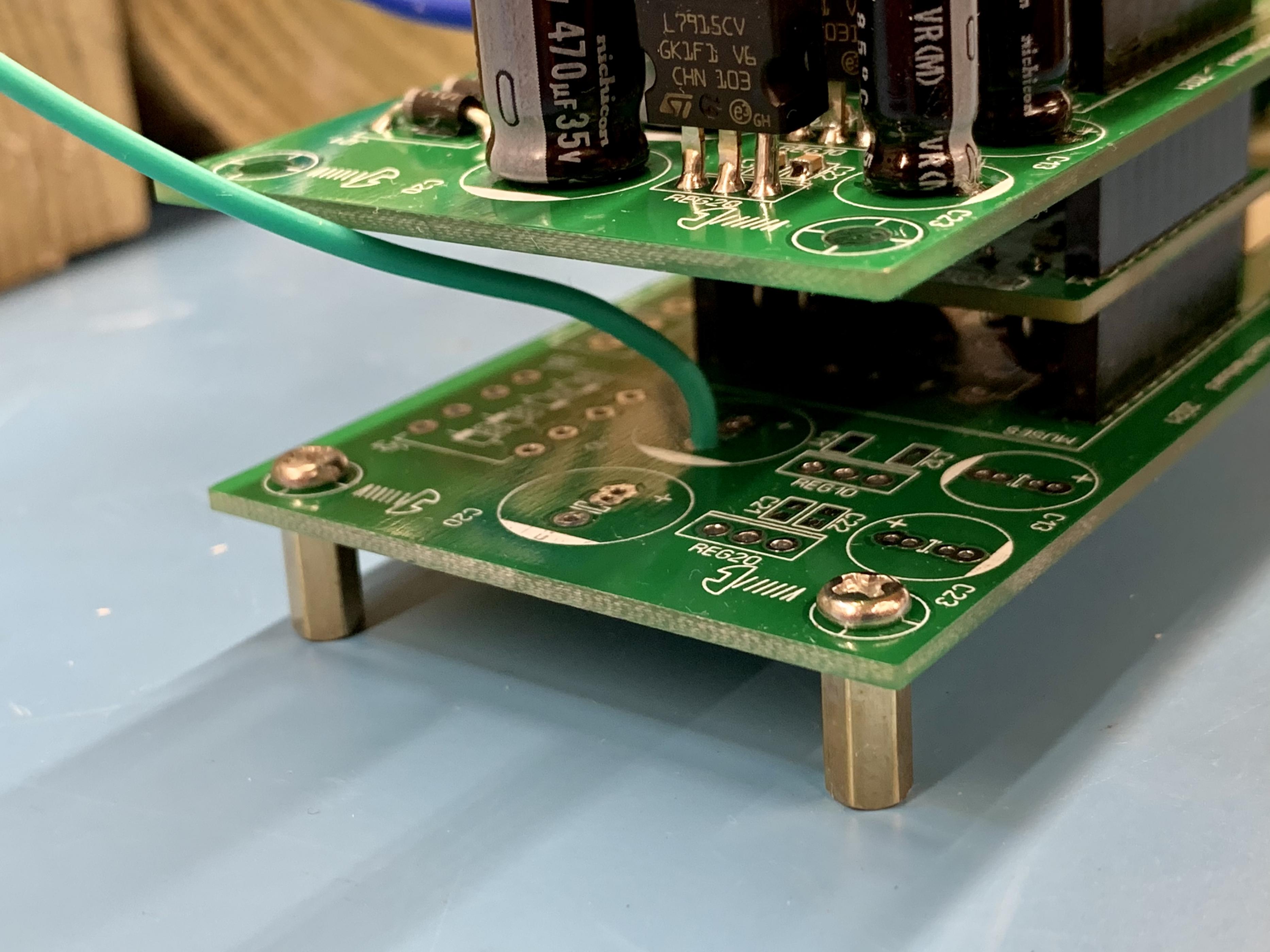

Oh, although it worked without it, I also provided a proper ground from my secondary main board on the balanced set since there were plenty of holes available from which to choose. We’ll see if it’s a noise generator and if I’ll need to move it closer to the power source entry point.

Relays:
Did you set the parameter
4, Max Input >0 and restart?
Yes, the driver provides an active low to drive the relays.
Have a look to the schematic.
Controller Board J2:
Set the jumper to 2:3 because 3,3V supply from mainboard is connected.
LED:
I will remove the value. It was only an example.
We share similar relief!
I did not set that parameter. I left everything defaulted first go around. I’ll double check that setting.
Your schematics are great. Thanks for the detail! I’ll update the jumper position and report back when I get the regs installed.
After a second thought about the ground I installed for testing, it will likely be grounded through the audio ground of the stage it connects to. Probably going to introduce a ground loop like this. I'll take it off when installing it in its home gear.
Appreciate your support!
Edit: After inspecting pictures, the jumper on the micro board should be in the correct position. The board is upside down in the photo. 🙂 I’ll still double check, though.
