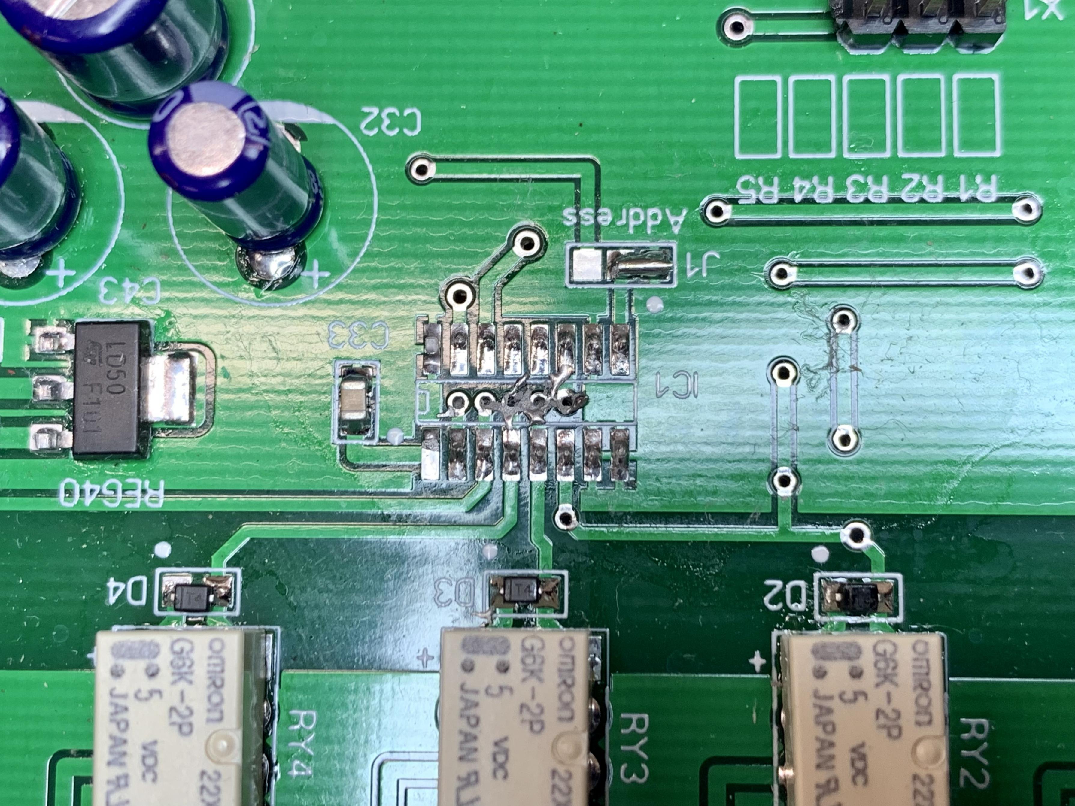

Have a little problem here unfortunately and would appreciate some food for thought.
Have the unbalanced system with motherboard. And the whole thing 2x. Unfortunately, the remote control does not do what it should, actually it does nothing at all. The processor runs and flashes as it should. Only on inputs of the remote
It does not react. Strangely enough on both boards the same problem. Have already tried several remote controls. I have also replaced the sensor (TSPO 4838). Voltages are present. The strange thing is that the signal line is "almost" on ground. Am unfortunately with the digital not quite so fit. Maybe you have a tip for me.
Thanks greetings Markus
The signal line should toggle in case of pressing a remote control key.
Please check the connection between controller pin and ir receiver.
Daniel

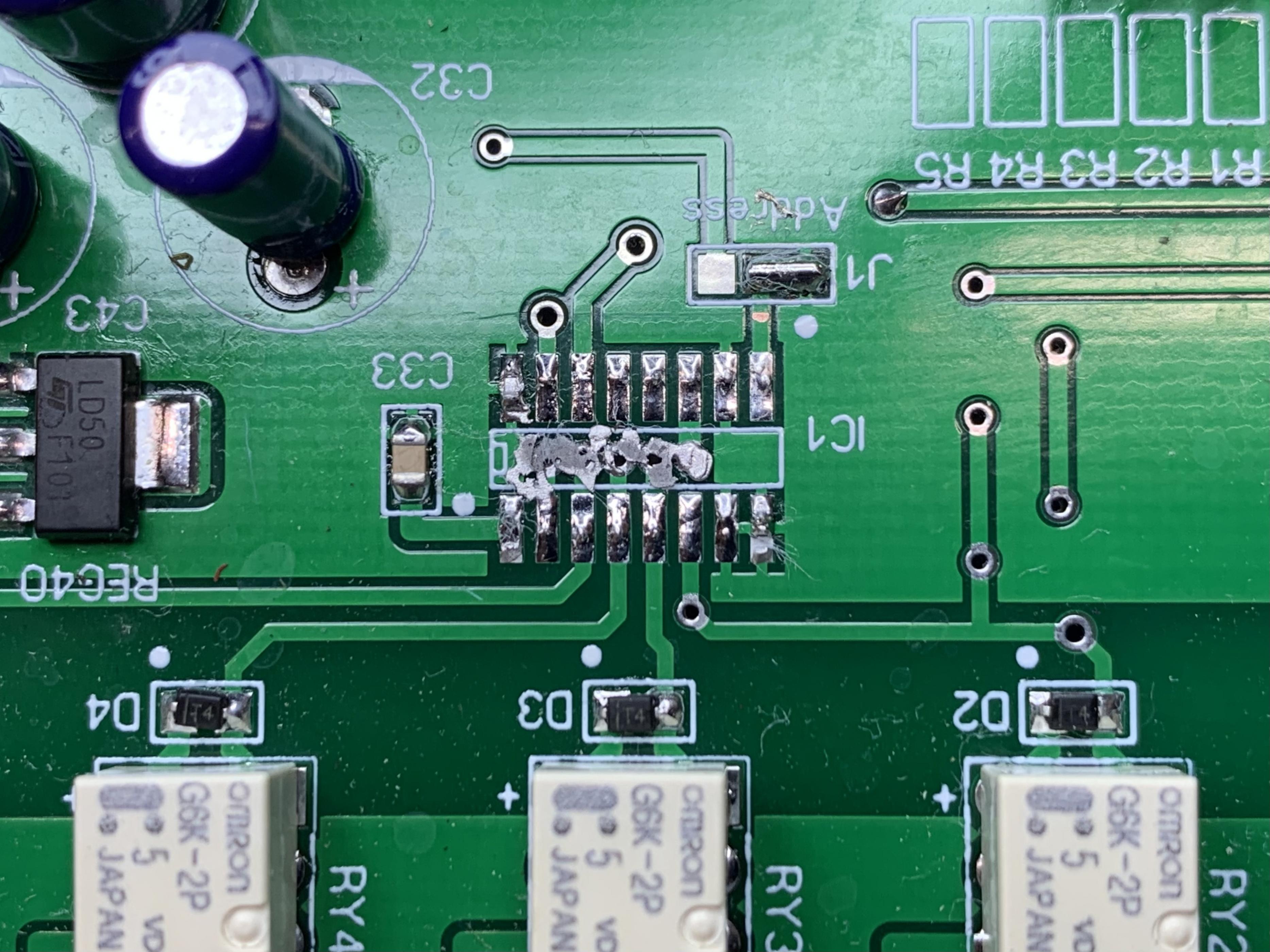

Replaced a bad microcontroller chip and both sets are now accepting remote commands and operating correctly. Still not switching, so I did some additional probing and discovered voltages I didn't see as correct. Not sure why it didn't come to me the first time I saw them, but today something told me to check some more. So I desoldered the driver chips to a mess beneath! Embarrassing n00b SMD soldering job using airgun and too much paste!
After fixing that little disaster, all is working well. Many thanks to you, Daniel, for accommodating me! My apologies for asking you to search the Earth for STMs! You're the best!

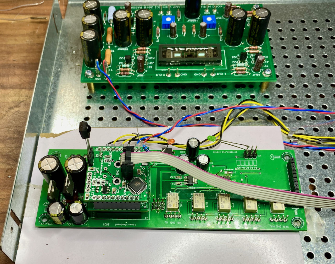

Hi everyone,
I just completed the V1 model, fire up fine, vol encoder can turn up and down the display counter.
However, when I had it connected to the system, I hear only distorted music at a constant level, even when the encoder is turned either way.
I didn't see any solder bridging on the muse chip, any idea where can I go from here?
I may have overheated the chip, as I spent a long time soldering it by hot air solder station. I Will but another chip to replace.
