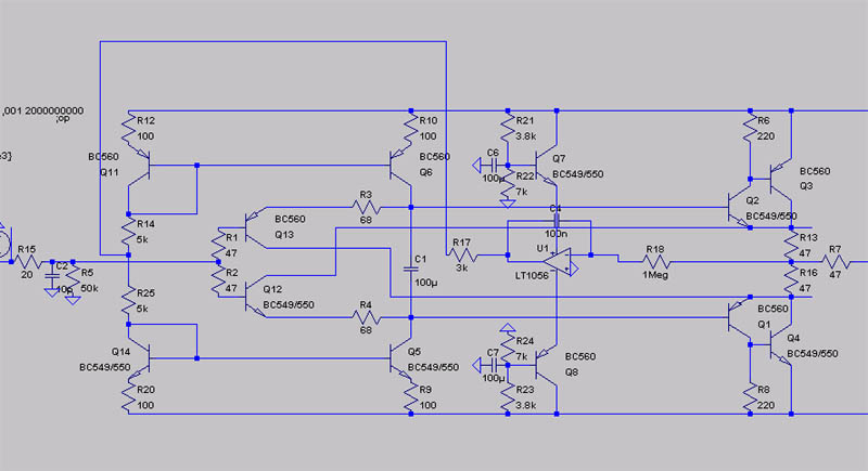

The LEDs bias the cascode transistors. Inspired by this here thread.

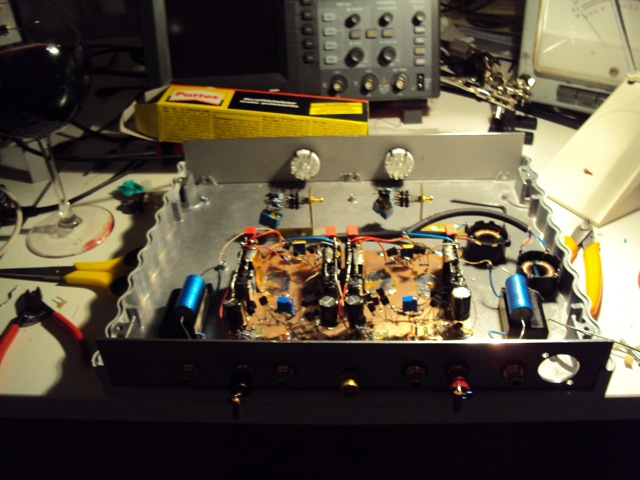

All six regulators are emitter followers. All supply currents are nominally constant, the front-end innately, the opamp too: the 637 drives its normal load and at the same time an inverting opamp with the same load, both in class A.
The supply itself is another box, in fact a commercial Michell/Trichord Never Connected with regulated +/-22V.

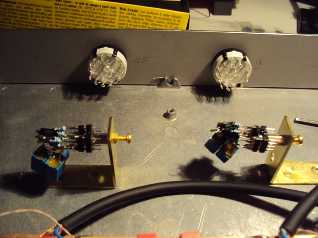

Here are some photos of the prototype. More explanations will come.

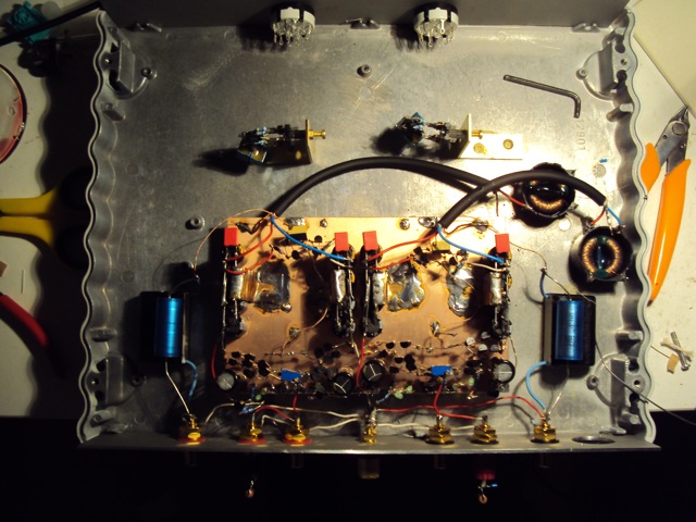

Yes. No naughty currents are mixed up with the nice ones.
What are the golden/black boxes above the 637's?
NOS styroflex caps.
I did not understand your comment what exactly the second opamp does, do you like to elaborate?
An inverting amplifier (TL071) hangs off the output of the OPA637. It is so configured that, for a given load impedance (my ADC), it pulls a current from the supplies that is the inverse of the 637's current. So the net supply current is zero.

The Transconductance-Transimpedance stages i am working on get more and more gain by raising the output impedance of the current mirrors. The cascoded current mirrors i have shown here are only a beginning. You can imagine that DC offset gets a real problem when you feed the output current into a high impedance network like an RIAA shaper. As a consequence i am looking together with another engineer at novel ways of DC management without the use of Servos or big coupling caps. In fact we got a prototype working. What we need is a high speed buffer with very low input capacitance, exactly a gain of one and ideally zero output impedance plus low intrinsic self DC output. This can be made near perfectly with a good OP amp used as voltage follower and that is what we use in the prototype. Somehow this was too easy and the better i get at designing discrete circuits the more uncomfortable it feels to go the easy road by restoring to Op amps. Unfortunately my usual Fet-Darlington buffer that was based on a JLH design is not good enough for that task. It sounds very well but it has still some input capacitance, an non zero output impedance because of the presence of resistors in the collector chain and as a consequence a gain of less then one.
So i redesigned it. First i cascoded the input Fet´s. I use the Hawksford cascode here, a rare sight and i have never seen it being used in a buffer. It feeds back the base current of the cascode transistors into a low impedance joint of the amplification chain and gives an improvement in speed and distortion at the expense of some gain. Gain i have a lot in my design so i thought it could be beneficial here. The second change is putting the resistors into the emitter feed of the output darlingtons and not into the collector feed. This way i make a kind of "Super Szikley". This whole "thing" is theoretically damn fast and the old buffer with a -3dB point of 16MHz suddenly seems old and tired. How much of this speed i can rescue into a stable circuit has to be seen because Szikleys are famous for oscilation. Of cause i have and idea how to fix it when it ocures, so let´s wait for tomorrow when i put this circuit through it´s paces.

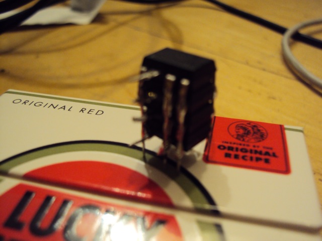

I do not know how good Burkhards ears are but i will publish that circuit tomorrow and you can make your own test. the second chage i made is that i used only 4 stacked NEs because i am soldering them directly over each other and when the circuit does not work i loose 16 chips that are hard to desolder. That buys me a worcening of Signal-Noise of 3dB and i thought i can live with that. Actually the circuit is still some 5dB better then a single OP27 that i see here in very alaborated phonos. It surprises me that stil at the noise level of the OP27 the users are extremely happy and pleased with the result. I can only asume that they listen at much lower volume then me on speakers with under 90dB efficiency. On the other hand "When the stone hits the plastic" as our chief moderator Salas whould say a hunt for extremely low levels of noise is rather academic. Well, i enyoy the spooky silence that my new Transconductance stages have the the Phonoman AC as i will call it with a stack of 4 is no match when i cranc the volume full. The noise is not particular agressive because the shuntfeedback RIAA nicely shapes it but there is a culmination of noise audible, i whould say i the upper midrange just under the presence region so it does not sound forward but slightly back. Its hard to describe but it does not go on the nerves like flicker or popcorn noise does. It´s like the sound that the wind makes when Boris Becker plays tennis ( was i the one that wrote this down ? ). At my normal listening level it is well surpressed and just audible, faintly in the backround from the midle of the speakers. That is much better performane then a 20€ stgae like that has any right too.Well i have not counted the time it needs to make it but i whould say, the next time i build it, i need 2 hours max. So how does it sound ? The first think that was obvious and i knew that from the discrete INA where i use stackes of NEs in shunt feedback is that typical robust bass. I had to turn down my sub a bit after i switched from the lates Transconductance stage. Wel actually i got a lot of noise in the beginning on one channel. After substituting the 4 Nes everything was fine so i thought they, or one of them was faulty. Actually i had taken the NEs from the considarable waiste that was left over from the development of the Discrete INA so that was a logical explanation.

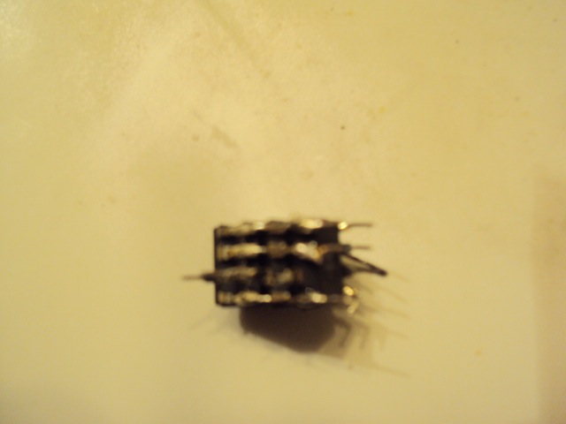

I was wrong. I had forgotten to solder one row of contact but i found that out much later until i looked again at the object to photograph it. See the atatchement.

The innitial gain of the input stage is defined at 2 x Gm x RL. RL is the output impedance of the cascoded current mirror. The cascoding raises the output impedance of the mirror
by the beta of the cascode transistors. In the case of the BC550C-BC560C beta ( or hfe )
is ca.500. The factor of 2 in the formular comes from the fact that the gain in a parallel symmetrical stage is double then the gain in a single ended stage. So you see, the mirrors do not add gain but raise the gain in the input stage by raising RL. Actually the bipolar cascodes shield the Fets so the gain comes from the bipolar cascode transistors. In that case the gain equation is (( beta x RL ) : ( Rbe + Rbv )) x 2. RL is the output impedance of the uncascoded mirror times the beta of the cascode transistor If we asume that the output impedance of the uncascoded mirror is 1kOhm then RL is 1000 x 500 = 500.000 Ohm. Rbv is zero in case of that circuit because i shunt the base current AC wise to ground with a capacitor. Rbe is ca. 35 Ohm with the cascode transistors i am using so we get 500.000 : 17,5 = 31.847. Bandwidth of the input stage is 1Mhz -3dB so gain-bandwidth product is 1M x 31.847 = 30GHz. Now you know what a beast that is.
Well i think 30Ghz is rather optimistic because i did not take stray effects into account but still in praxis we end up in the several GHz range. That gain now is shaped by the RIAA filter to ground. I have to calculate the input impedance of that filter at 1Kz and then you have to total gain of 500.000 : Ohm @ 1kHz.
