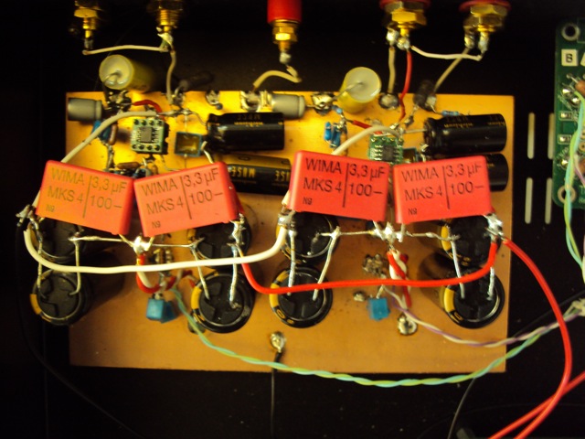

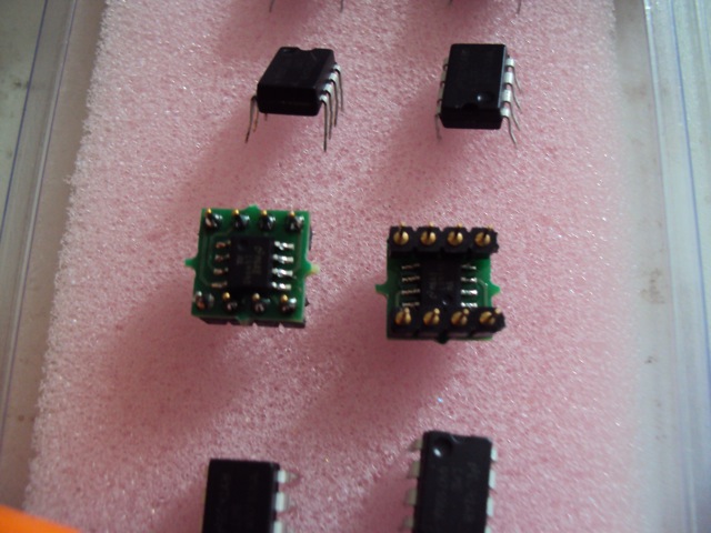

So this is what i did: I substituted the LME49720 with two single LME49990 on an adapter made by Stefan Horwege for me. The LME49990 is much more quiet with MC, has lower distortion, higher bandwidth and better PSU rejection. I prefer it over the AD797 or LT1028 i used before. I recalculated the RIAA and put an RC filter at the output that makes the RIAA curve flat over 20kHz. The old values gave the following time constants : 75.2 usec ( 0.3% off ), 291.8 usec ( 8% off ), 3000 usec ( 5% off ), that does not sound as bad as it looks because it gives only a small lift ( ca. 0.5dB ) in the fundamental tone area. The new values give : 75.2 usec ( 0.3% ) , 306,6 usec ( 3.5% ), 3200 usec ( 1% ). It is no problem to get the 75 usec and 3180 usec time constants but the 318 usec is much harder with standart values. Considering that i do not use exotic values i am satisfied with the result. I raised the 2200uF elcap to ground to 4700uF plus a 2.2uF foils cap for lower distortion and more extention in the deep bass. The Neumann Pole was added. It is switchable.
Circuit diagram with commend, picture of LME49990 adapter and a photo of a deluxe version of the USAIG 2.0 is added.

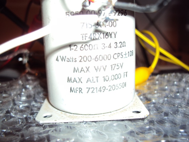

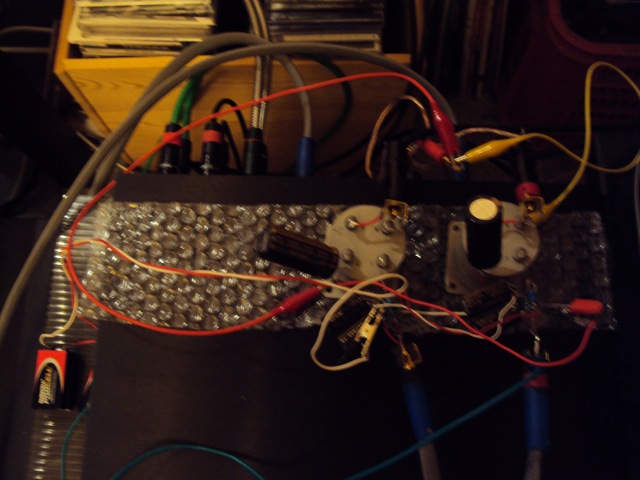

My first experiment with Zero Field technology was successfull after some playing around with values. As transformer i used a 600 Ohm - 3.2 Ohm transformer that a friend of mine bought at a Ham Fest. It must have been used for talkback to transform 600 Ohm to a little loudspeaker. The specs say 200 Hz to 6kHz +-1dB. I use it "up side down", so i use the secondary as primary and the primary as secondary. That way, the primary DC impedance is around 0.15 Ohm and the secondary is 27 Ohm. You can imagine that this gives a really worst case szenario because this transformer has very little "primary" inductance so without the Zero Field trick it gave vitually no bass. I have a little hum problem but otherwise the sound with Zero Fied was surprisingly good with decent bass and treble extension so i am really looking forward to use this technology with a better transformer. I use a cap in series with the transformer to avoid DC through the coils. In fact it was not that bad. One channel measured 27mV, the other 3.5mV so the "bad" channel gave 1mA through the transformer. This is not much and i could jumper the cap but i have not tryed that.
Theoretically i can use now a very small transformer and the OPamp compensates for any low frequency distortion. Let´s see how this develops.

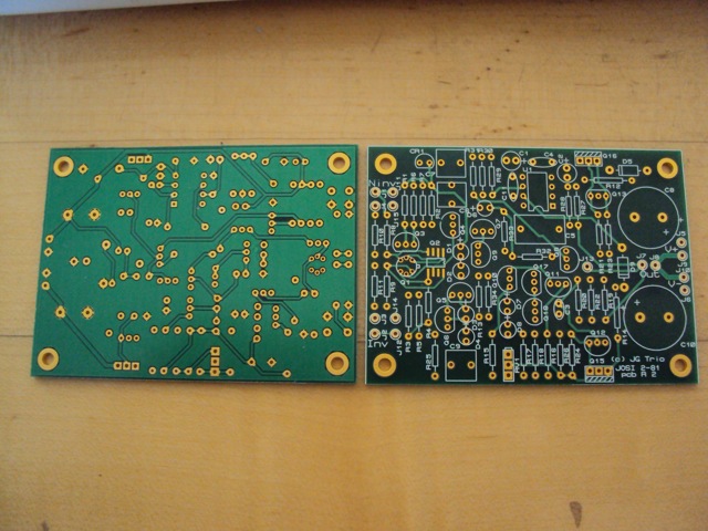

Today the PCB boards of the JOSI discrete OPamp arived. The JG Trio ( me, Sigurd Ruschkovski and Jan Didden ) has worked silently on perfecting the design. It is now version 2.81 Rev.2 so a lot of hard work was put into it. I came up with the fundamental design, Sigurd simulated and optimised the circuit and choose most of the active and passive components and Jan did the layout and the servo design.
We got the following performance : GBproduct 40MHz, Open Loop Bandwidth 40kHz, Voltage noise 1.5nV/qHz, Open Loop Distortion up to 100kHz 0.01%, Supply Voltage +-15V to +-24V, Max Bias Current in the output stage 70mA.
The circuit can put out more then 3W in Class A in theory. To make that posible the board is quite big ( 60mm x 83mm) and we use strong and fast Sanyo video transitors at the output that can be bolted to a heat sink.
This is the first PCB i hold in my hand since i started this thread, so it needed over one year to get something finalised. In fact the first circuit i designed that got a PCB was my discrete INA. It will be available from Pilgham Audio but so far i have only seen a picture and the artwork. In fact several people are working on PCB boards for my designs. I keep you posted if there is any news.
In use the Josi is very flexible. It can do what an integrated OPamp can too but also much more. A phonostage could be made for medium output MC´s and it can also be used for MM work because the double input Fet does not only have low voltage noise but also low current noise. This could be nice for the top Grados.
A headphone amp can be build, so does a line stage or a line buffer. An INA can be made from 3 JOSIs. Active filters and equalizers come to mind too.

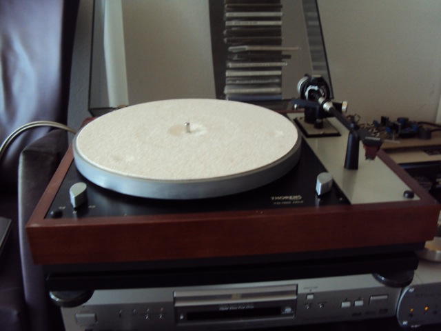

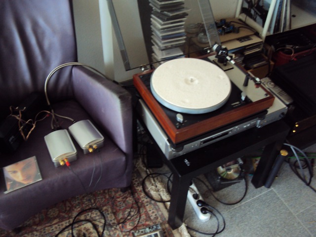

I have not listened to a good MM cartridge in ages. The last time was one of the big Grados at Wittmann in Stuttgart in an unfamiliar system. Because a friend of mine undusted his Thorenz TD160 i had the chance to mount the top Clearaudio MM, Maestro Wood. It was not easy to adjust correctly because the Maestro has tapped holes and the Thorenz arm has another mounting scheme. I used small diameter screws to circumvent the problem. The sound i got with the Inductive RIAA was a surprise. A lot has happened in MM design it seems. It had more dynamics and resolution then i hoped for but still there was this imposible to describe homogenious sound that a good MM makes. This Clearaudio is certainly the best of it´s type i heard. One problem remains.
The motor of the Thorenz made a clicking noise that was also audible thruw the loadspeakers at low level. It is the typical cogging problem that older Thorenz have so i have to repair that. Otherwise the sound was very musical and entertaining. As linestage i used my Velleman 8020 that i had rebuild to an Aikido Buffer with very good success.

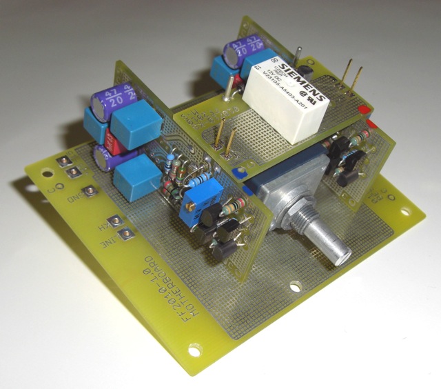

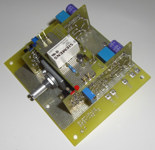

JG-Self Linestage
A fellow DIYer has put the JG Self linestage on a PCB so this is one more circuit i posted here that can now be build easily. Actually it is a modular system with a mother board, two line boards, the stereo-mono switch and the potmeter.
