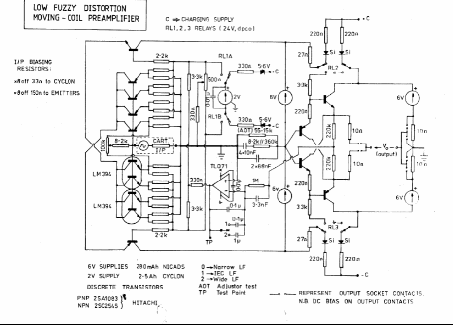

For example i published this circuit at the biginning of my thread that also uses current soures for more gain and could be a candidate for AIOG.
Dear Joachim,
looking at this circuit please let me comment that pots P2, P3 should
probably be connected to the emitters of T5, T9 and not their bases
in order to ease offset adjustment (but one pot and a change in one
resistor is sufficient). P1 should be substituted by a 10 Ohms pot (or
R8, R10 changed to 10 ohms) in order to drive the Fet pairs equally.
Where can I find the "harsh critique because of potential DC into the
cartridge"? I don't see the point, because it will simply not happen in
a working circuit. This may be the reason for your care in residual input
offset (as opposed to switch on/off transients), but in my opinion the
leftover of some dc millivolts is not worth considering. Any need for
adjustment means additional complication "Bias stability" is a different
matter.

Dear A. !
You are right and i did that changes in various disguises later. This circuit is what i call an Alfa. A concept that was never build. This thread get´s rather long and i myself have lost track of all the details. I just wanted to show that i had that constant current idea too and actually optimised it in my Discrete INA. I was searching today for half an hour to present my transimpedance solution again but i did not find it so far. My 8G stick has crashed and i lost a lot of material. It was posted somewhere here so i will find it.

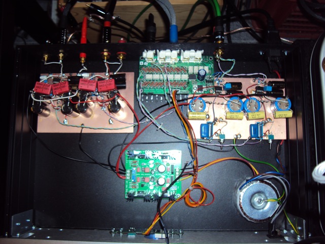

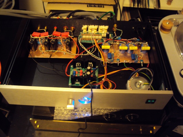

Today i finished another preamp for a friend. I call it USRC for Ultra Simple Remote Control. I used my USAIOG phonostage and my "new" USLS ( Ultra Simple Line Stage ).
Actually there is nothing new with this line stage. Just a good Opamp with series feedback.
I choose the feedback resistor value to be able to insert a current feedback Opamp like the LME49713 which i like much. Actually i build this version with an LME49710 that is a conventional voltage feedback type of modern design. With this OP i did not need a servo or a coupling cap. DC offset is under 0.5mV and no switch on and off transients.
Stil this preamp is not without some comfort. It has a passive output that can feed a subwoofer and a switchable filter that takes of some burden from the main speakers when the sub is connected. I use a Tent Labs volume control that i find comfotable and transparent sounding. Actually i had some trouble first. There was a terible hum and during experimentation i somewhow distroyed the micro processors in the volume control. I drove to Guido Tent that did repair and tried to fix the hum problem. Actually
after his modification it looked good on the scope but back home the hum was back too. I needed two full days to find the problem. The Tent Labs has a floating supply that i supplied from the transformer of the Placid PSU i am using. That created a hum loop.
Why i do not know but now that i supply the volume control board from a seperate transformer the hum is gone. Actually that pre does work well dispite it´s simplicity.
I think one of the reasons is that i choose good quality parts and took care in the PSU and generous lokal decoupling. Anyway, if you need a quick and easy fix this USRC is not the worst you can do.

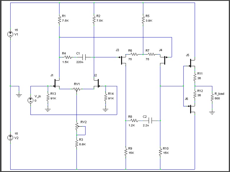

This is an example of a two stage transimpedance RIAA by Mr.Evil. In a strict sense this is no transimpedance RIAA because the filters are not fed by constant current sources so the drain resistors form a voltage devider with the filters. I will show a posible solution soon based on my High Z MPP. Nevertheless i find this circuit elegant and effective.
MPP Nova Transimpedance RIAA
Here comes my solution for a one stage transimpedance RIAA. The circuit is a modified MPP Nova. The collector resistors of the input cascode are substituted with current sources. The input stage works on 14mA and the folded cascode on 21mA. The current sources give much more gain. I have shown two alternative versions to do the RIAA.
One is used by the Essex Equalizer and one is the LC Audio version. I have not calculated this values and may come up with my own version. I have not build this circuit but it should work. The buffer can be trimmed for offset.
