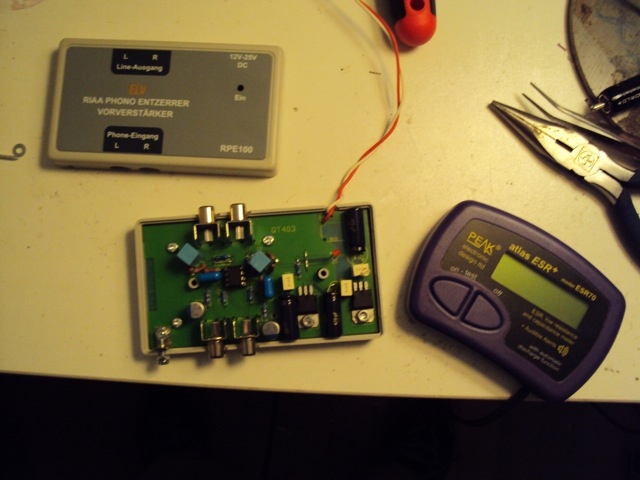

I simply used the ELV phonostage for modification. It costs only 19.90 € and has all you need on board. The version you heard is done with a double LME49720 Opamp. You could use the LME49990 for even lower noise but it is not available in double so you have to use a jumper board if you take the ELV case. Elcaps are Pannasonic FC or FM. The 2200uF to ground is a Nichicon LG polymer you get at Farnell. It is critical for success. Resistors are Dale 0.1% antimagnetic from Schuro. You can use Holco from Farnell. Caps in the RIAA have to be 1% tolerance and best Styroflex or Silver MICA.
I use LCR Styroflex from RS or Farnell and Silver MICA from Reichelt. You find the MICAs under Styroflex on the Reichelt webpage ( silly, isn´t it). MKP1832 ( or even KP ) from Vishey-Röderstein are also very good or buy Styroflex from Oppermann. They cost virtually nothing.
The circuit as shown is good for 60dB of gain so no transformer for MC is necesary. For MM use 270 Ohm instead of 27 Ohm. Yes, it sounded great on your system. I liked your

my system the preamp was a JGSELF. The MC input is a Hybrid INA and the RIAA is made with the values as the Self Precission Preamp. I use OPA1641 FET instead of NE5532 ( plus a lot of other changes ) so i can in total avoid 9 elcaps and two foils in the signal path. The JGSELF has being documented here before.

Here is the MC input and two alternative MC inputs i tryed. The simple balanced was implemented and i could switch between it and the hybid Ina. The MM circuit has a mistake. It needs 5 10nF instead of 4. Servos in the headamp and linestgae are not necesarry. You can connect that node to ground. The MM stage has a passive pole that makes the RIAA perfect until supersonic and it is all in one go after Self but with Fet Opamps for lower DC offset. The subsonic filter has the IEC pole switchable and is optimised for my Lyras in a medium mass arm. Actually the stage sounds best with the IEC switched off. You can leave out the whole subsonic filter but then you need one coupling cap. To avoid the cap use a servo. I like the sound better with subsonic filter. It is cleaner and faster in the bass.

The Nichicon LG is availlable at Farnell. In the search engine type in 2200uF and voltages under 6V and then you find it. It is hard to find an alternative because there is not much space on the ELV PCB and we need the low ESR. There are some low impedance SMD caps that could fit. Nichcon, Elna, Rubicon and others make them. Maybe you can find a subtitude in the Frolyth range in the Bürklin catalog. You could use a low voltage Pannasonic FM too.
Yes, simply parallel resistors to the 56k. I did not do that in my sample because it sounded fine right away. I build a circuit like that for a friend with 300 Ohm loading that sounded fine in his system. Yes, when you supply the circuit with more voltage you get more overload margin. When you go over +-13V the noise gets a bit up. Stephan Horwege and i prefer +-13V but other like Syn08 like to supply the Opamps with the highest posibe voltage to get more dynamic range. I simply used the inbuild voltage regulators in the ELV, so that is the reason for the low voltage. My friend that as a version of that circuit in his preamp has a +-13V Placid Twisted Pear supply.
You know, this little stage was never ment to be High End but funny enough it actually sounds mighty fine. Modern Opamps are good enough to work with high gain without audible distortion and elegant simplicity is often a good recipy for fine sound.
