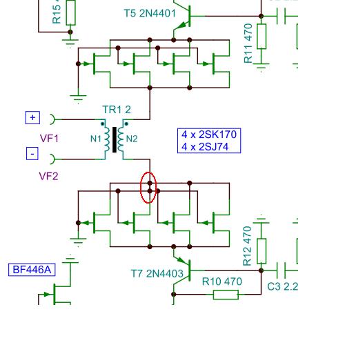

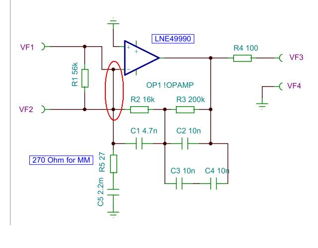

Joachim,
You've done a lot of work here, I just caught up with this thread and am
amazed how much you get through.
WRT the transformer IP version, a few comments:
- With the transformer connected as such between jfet sources, in common
gate config there will be significant DC current running through transformer
secondary. This will cause added LF distortion, especially with a high nickel
core as it saturates easily. Not a good idea IMO.
- The reflected impedance to the transformer primary, even with a low
ratio (1:2) will be very low, is this your intention? Prim Z = whatever Z
the secondary sees / turns ratio squared. Obviously DC winding resistances
have to be factored in aswell.
- The schematic capture program appears to be making connection errors.
Ref below.
For the transformer version, why not take advantage of the free gain the
transformer provides and simplify the whole CCT. You should be able to
basically scrap the whole discrete front end and just run a 3 low noise
opamp INA straight after transformer. Also since the secondary has low DC
resistance, you should be able to get by without any coupling caps or
servos, possibly just an offset trim. Do the RIAA eq around/before 3rd 'summing' amp.
cheers
Terry
Thanks for finding out the connection errors. Yes, very good idea to get rid of the input stage. Maybe then i use a transformer with x 5 or x 8. For the INA OPs i am planning to use my JOSI discrete Opamp.
