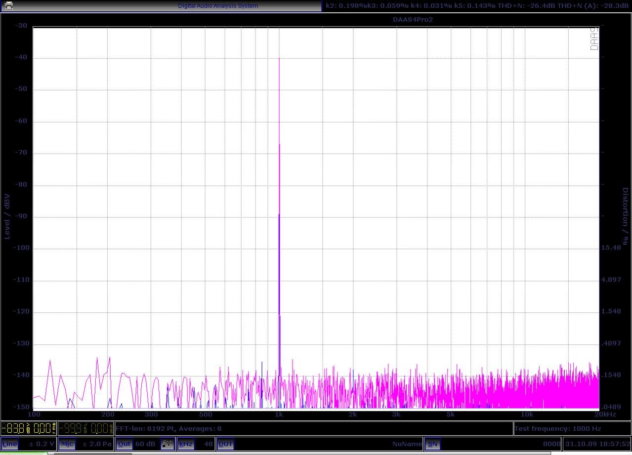

Measurements
As promissed i will post some measurements i made on the MPP prototype, the Aksa-Aspen Paris and the Quantummusic Goldstandart.
First i whould like to show you a loop measurement of my measuring equipment. i use the DAAS Pro 96kHz/24Bit measurement suite with modifications to be able to measure at low level. the modifications i made are quite similiar to the sytem that Douglas Self proposed to measure low level distortion artifacts. you can see that arangement on his website
The Douglas Self Site under "Science and Subjectivism"
by the way very funny reading. i love that english pragnatism and he drives a hard bargain
the difference to his solution is that i made the curcuitry works in pseudo balanced with 5 Ohm Johnson resistance to mimic my reference cardridge, the Lyra Titan i i also use the Olypos, the Helicon and an older Clearaudio Signature. for reality check i have a Goldring MM that came with their turntable by the way i am able to measure the resistance and inductance of cardridges without destroying them but sofar at least the low impedance designs have such low inductance that you can drive them into more or less any load without loosing much treble. i did not measure the higher impedance Clearaudio though and whould love to get my hands on a Benz LP.
It is promissed to me from the German importer as soon as they have some spare.
you can see that the resolution is around -150dBV if you ignore some intermodulation producs from the powersupply and other radiating equipment on my workbench. i dressed the cables as good as posible but this is the limit. as you can see the distortion of the chain is at ca. -140dB.
i find that adequate for my purpose.

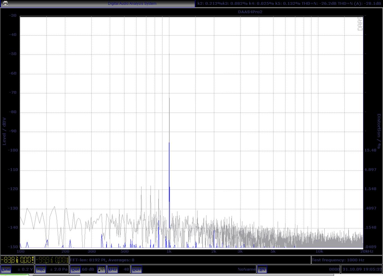

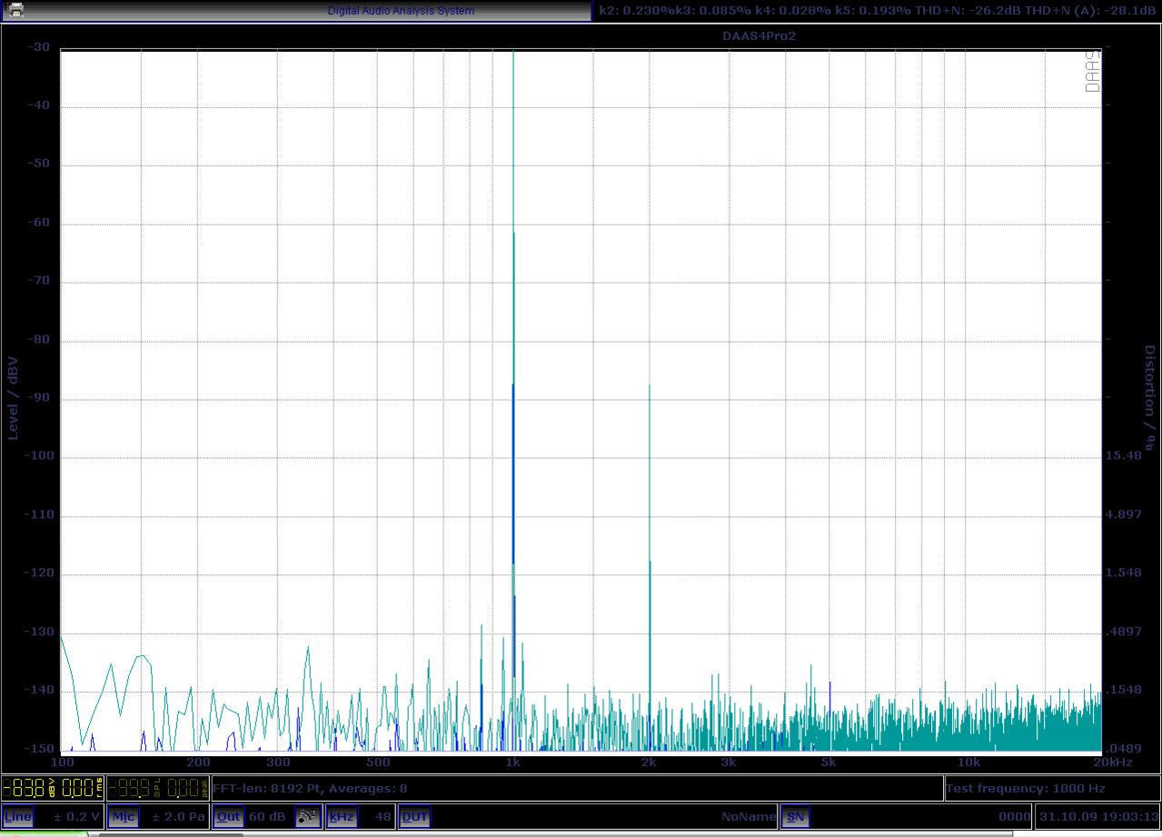

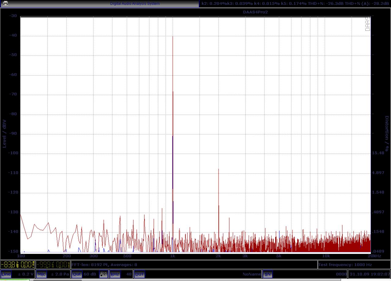

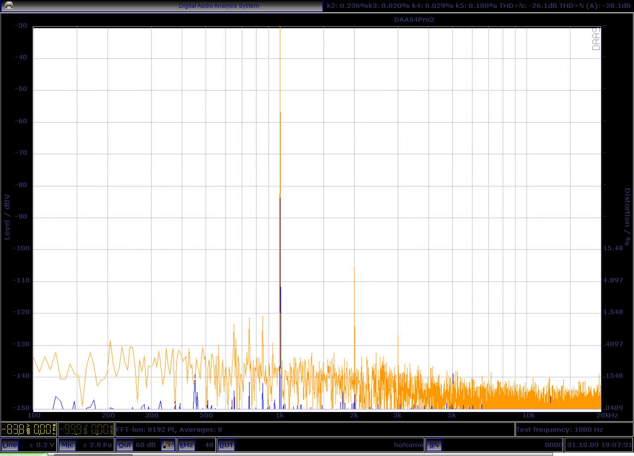

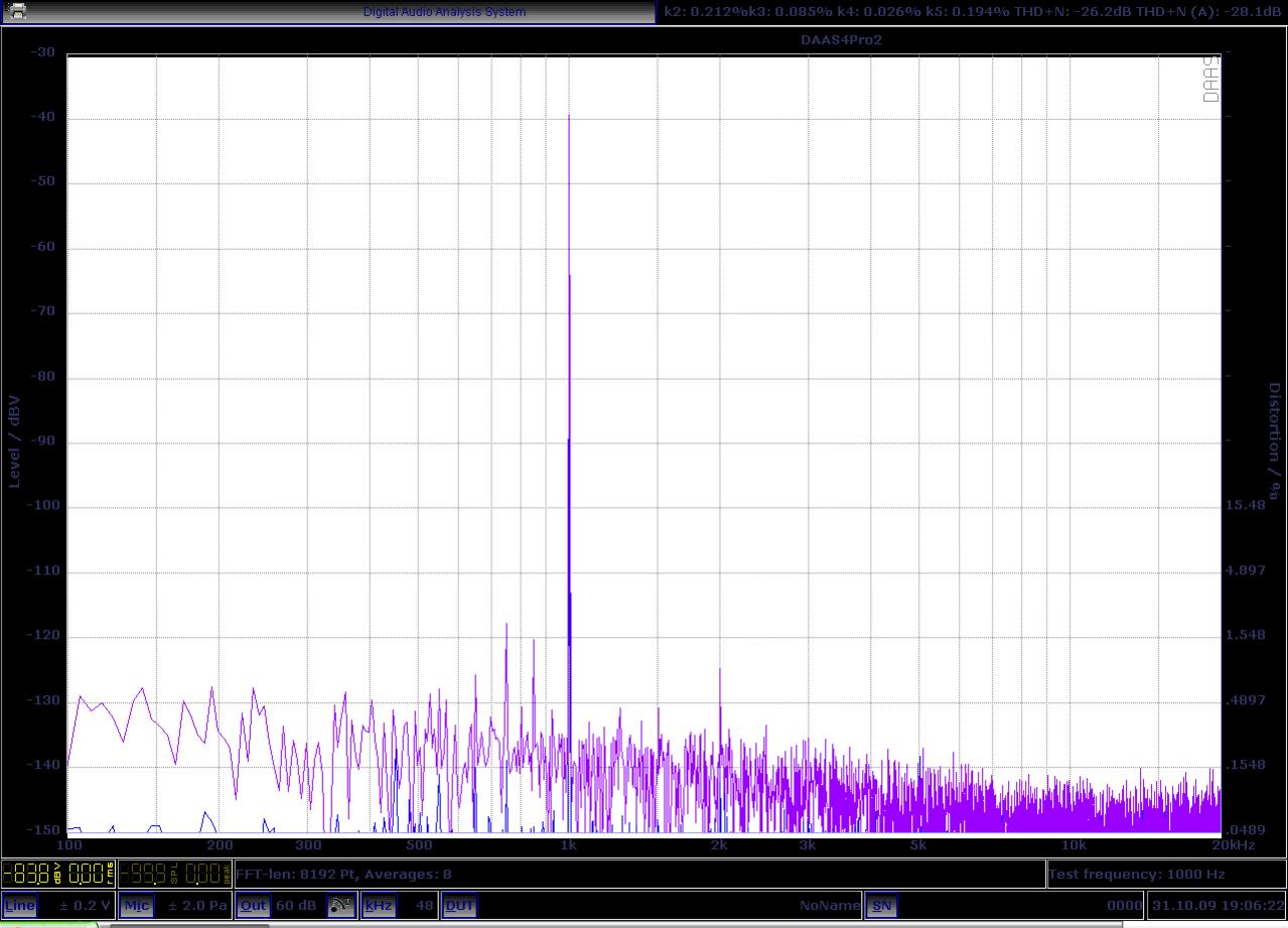

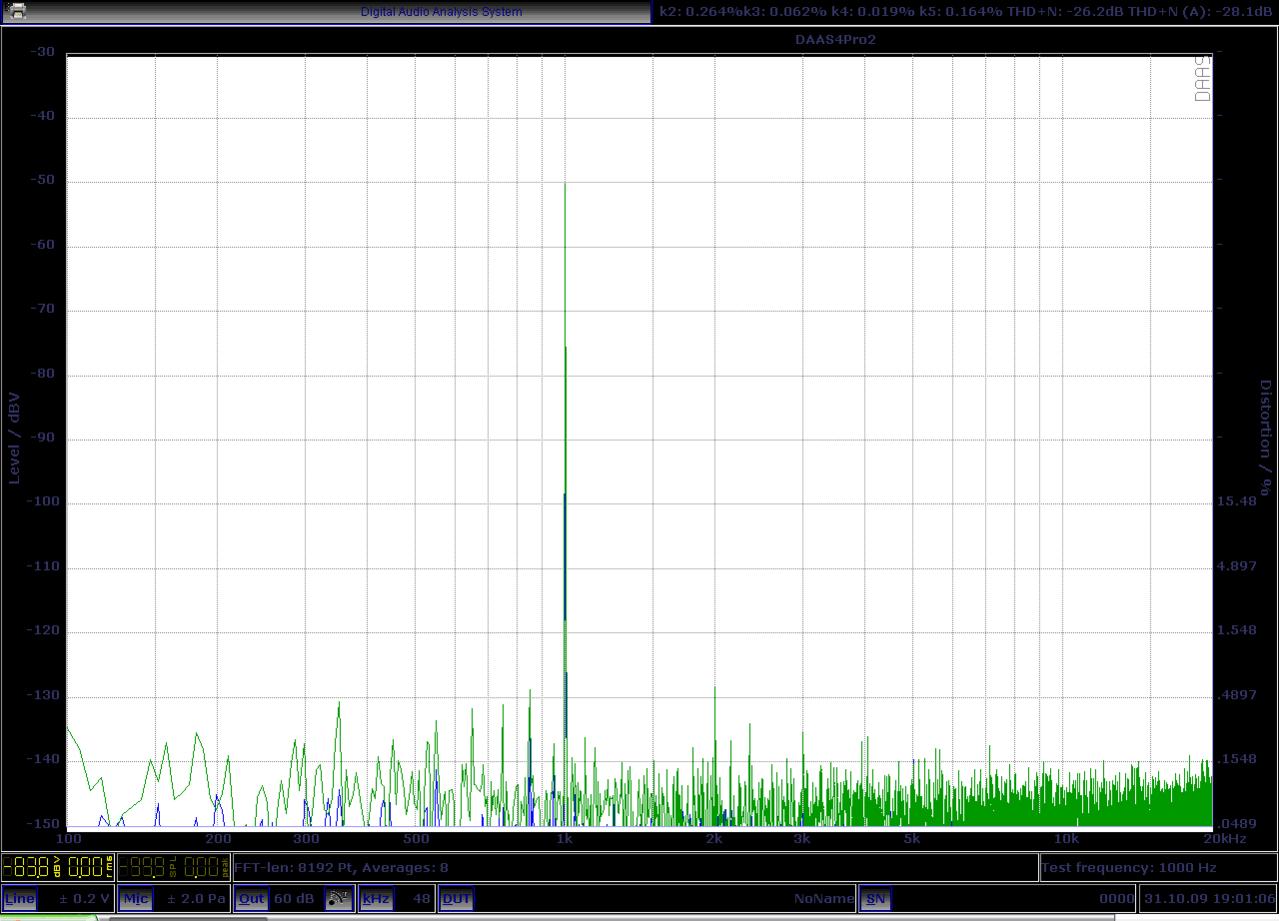

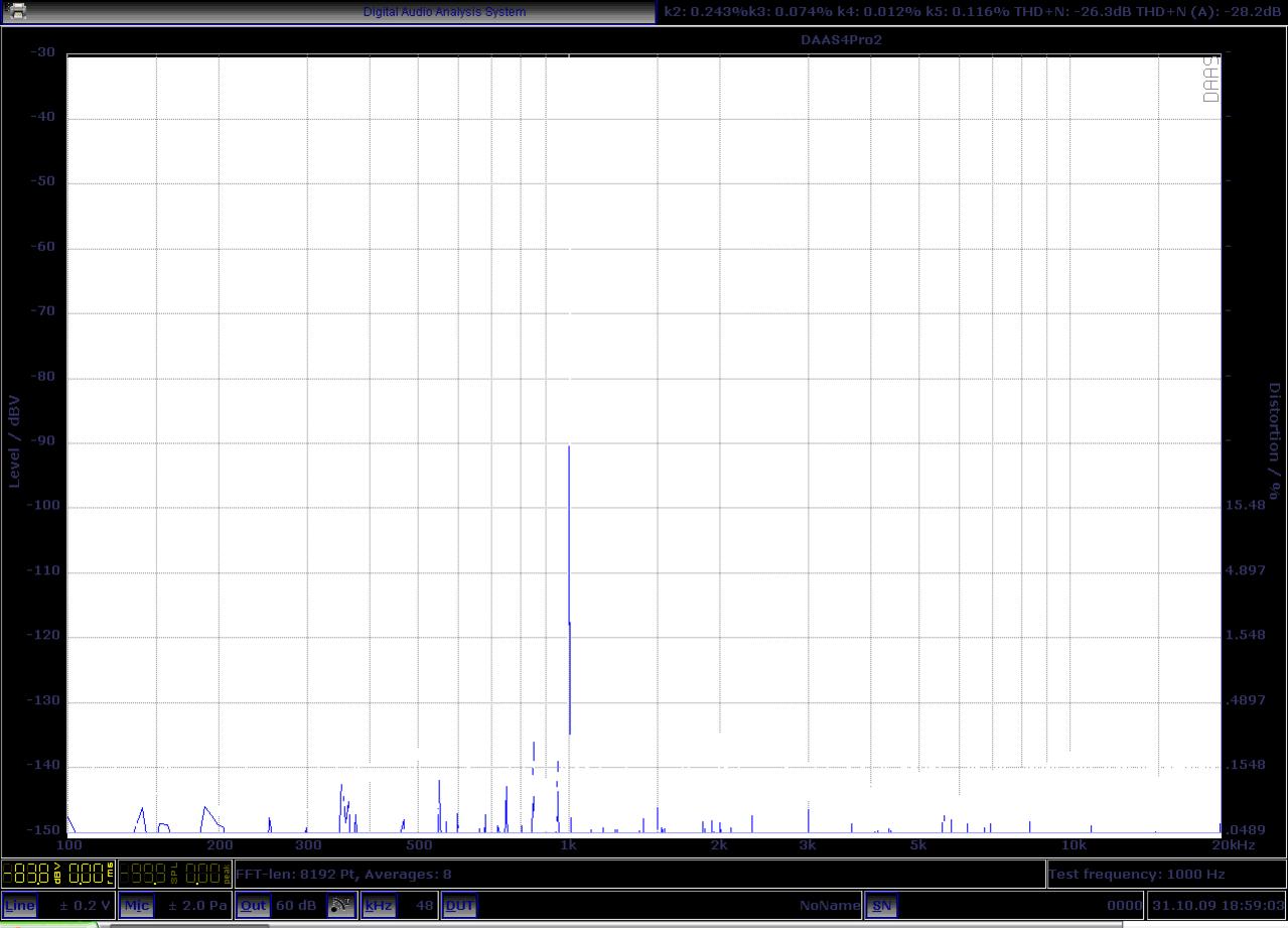

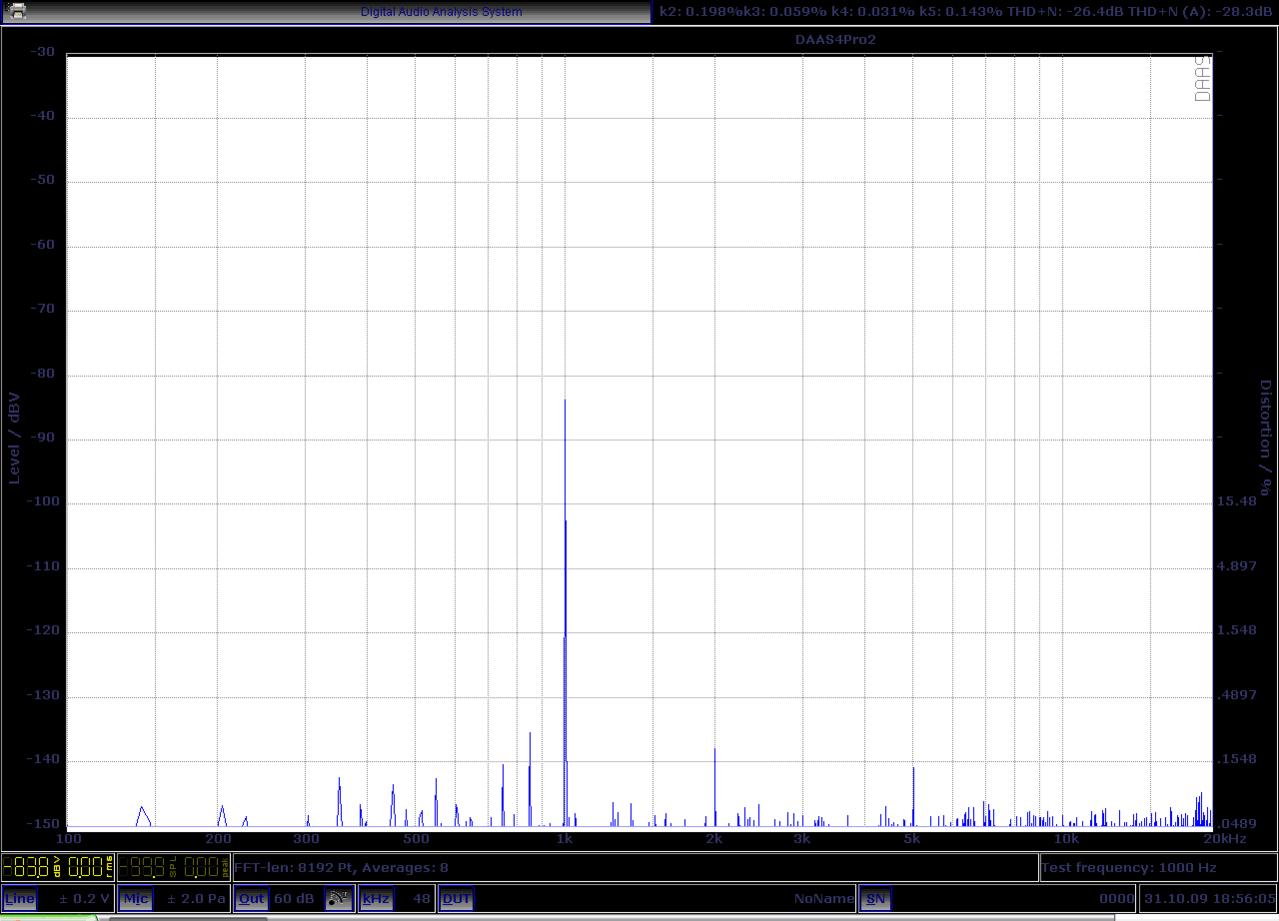

Measurements First Installment
Today i whould like to post some measurements.
I will show noise and distortion of the MPP prototype, the Quantummusic Goldstandart and the Aspen Paris.
Usually i start to measure at -50dB/U, that whould represent cruising level of a typical modern MC cardridge in my case a Lyra Tiatan i with 5.5 ohm impedance putting out 0.5mV at 5.0cm/sec, zero to peak, 45 degrees.
-50dB/U is a level of aroud 3mV so what we see in this measurements is the low level resolution of the compared design`s subjectively it is not that easy because human beeings can listen into the noise.
a sinewave with -30dB level under white noise can still be heard.
sharks are particular good at that to be able to detect far away prey in a noisy environment the phenomenon is called Stochastic Resonance. is it to this day not fully understood and has attracted some researchers in the past years.
i am using stochastic techniques in the commercial version of the Goldstandart and the effect can also be used to lower the noisefloor. this is particular important in the goldstandart because it is a balanced differential design and as John Curl explained so convincingly in his Blowtorch thread such a circuit has a theoretical noise disadvantage of 6dB against a parallel symmetric design with the same component count
that leave me of cause with the option to use more components, i hope to good advantage
but jokes aside, i am not able at that moment to penetrate my -150dB/V noisefloor and can not measure better then -140dB distortion so can not tell you what the resolution under the noise is.
i am shure clever people at Audio Precission or Rhode&Schwarz know how to measure distortion under the noise and when somebody here on the Forum has an idea i have an open ear. so speak about the ear.
my option is to listen so i will try to discribe the sound of thoose phonostages subjectively too. i think my music system differentiates quite well and i will later offer more details of my listening room and my components.
so here are the first measurements:
the Paris at -50dB/U
the MPP at -50dB/U
the Goldstandart at -40dB/U the Goldstandart is my lab sample, the commercial version has 4,5 - 6dB less noisefloor
i measure with a 1kHz sinewave, i did a sweep to 20kHz too to detect any rising high frequency distortion but there was nothing to worry about with the coosen designs
ceaveets: The MPP was measured with the 75usec equalisation in place
that explains the lowered noisefloor in the treble
I measured the Goldstandart at -50dB/B but the distotion was
completely swollowed by the noisefloor so i omitted that
measurement
I will give you some time to digest this and will comment on the measurements in my next post
this will also include measurements at higher levels

Hi, I'm sure you know this already, but time averaging can lower the noise floor. Taking two time records and adding increases the signal by 6dB but the noise by only 3dB. Each doubling of time records buys you 3dB reduction in noise floor.
Anyway, please continue. I'm interested🙂

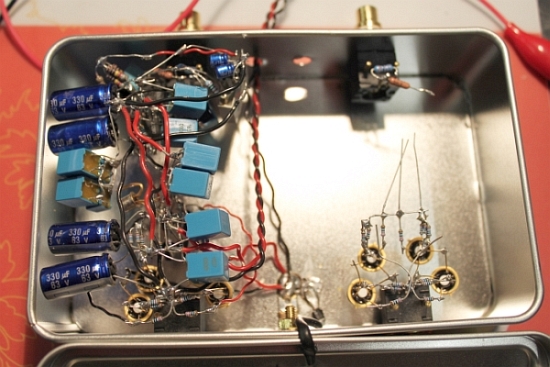

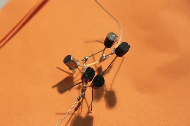

Air Dialectric Construction
Here you will see how the prototype of the MPP is made.
I use two groundplanes. One for the Input Stage and one for the Intrumentation amp.
I connect these planes in series and then to a single "star" that is also connected to the soft steel box and the ground jack.
I decouple locally with 330uF Panasonic ECA and 0.1uF Vishay/Röderstein MKP1837. The promo literature says that the ECA series is made for high quality audio but my measuements show nothing special. there are lower impedance
devices awaillable like Panasonic FM or Rubicon ZLH that should perform even better. Some people may prefer to bypass this arangement with a ceramic capacitor to lower impedance a higher frequencies even more but i had no stability problems although this design has very high speed and reaches several megaHz. If you use a ceramic i whould recomment 10nF as NPO or COG. Lesser varieties may produce distortion so can Tantals.
I supply the prototype with 9V alkaline blocks so this is not really a high end solution more a kind of worst case scenario. the noise under 1 kHz can be lowerd at least by 10dB with a more sofisticated powersupply.
this setup i only use for my own pupse so when the design is finished i whould like to put the input stage on a copper piece with the transistors thermocoupled and mechanically decoupled with soft springs. i also will put the MPP in a nice box so please do not take this prototypes as products.
On the other hand this kind of prototype construction gives quick and good results and the circuit can be changed quite easyly.
So enjoy the photos.
from left : Parallel Cascode Stage with FET constant current source,
Open box with working channel on the left side and the
rudimentally inputstage with MAT02/03 on the right side,
closed box
P.S. in fact a did a small aditional groundplane over the Servo section with 10uF ECA series connected to the Instrumentation Amp groundplane
